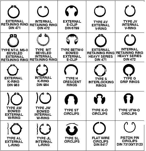

Does anyone know what kind of circlip this is? I have a box of internal circlips and none of them seem to fit.  The ones I have seem to be the right diameter but too thick.  I took this one off to clean out the mechanism and it broke while flying in two different directions.  I've found a ton of types like in the image below but none that look like what's in my picture.

A DIN472 should do the trick if you select the proper thickness.
McMaster Carr or WW Grainger should have what you need.
https://www.bigtoys.org/IMAGESBOULON/45-CIRCLIPS%20USA.jpg
As much room as there is there you could use either a std internal or external circlip of the proper dimension.

I guess I gotta call the manufacturer.  If they don't have some I can buy, they can probably tell me what thickness to use.

I can't compress any of the external clips enough to get them even close to fitting.  The internal ones I have are too thick across the smallest dimension to fit under the lip.

I bet a DIN471 will work.
What you have is cheaper to manufacture with less waste.
