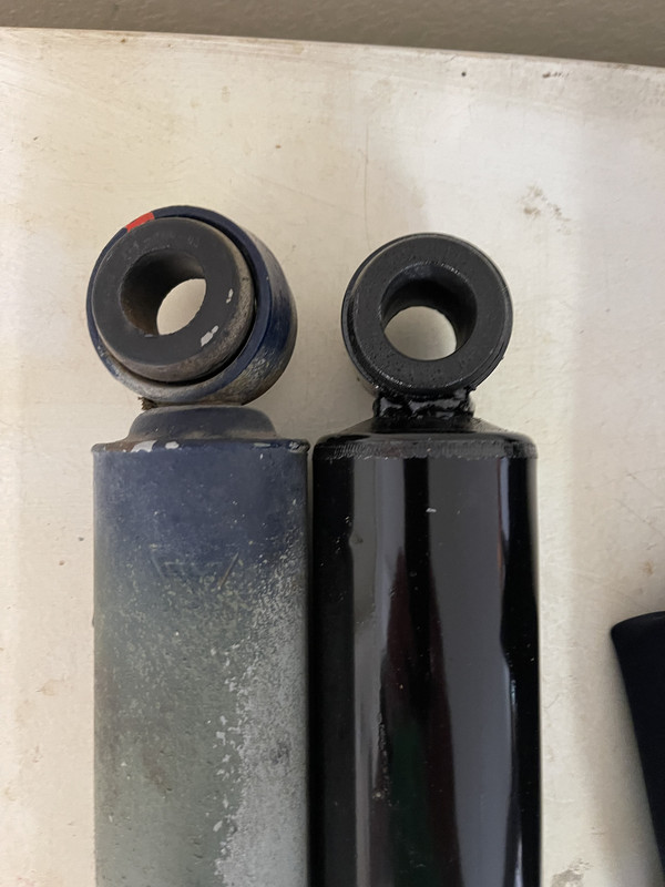

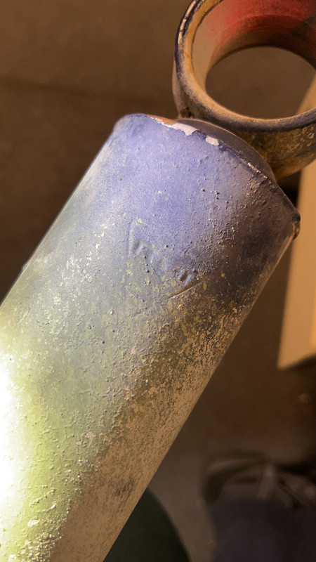

Koni 88 series shocks
The bushing on it says Koni 151-180-04
They appear to be Koni 88-1006 models,  but No longer made
Look at the logo here

The biggest hurdle so far is finding adequate replacement shocks. They're made in Europe and stopped being produced in 2001.
The nearest replacement from Koni is about 3/4 inch wider but almost the same in every other way.

So after countless painstaking hours of research and discussion with a Koni CS rep I did indeed successfully identify the Shocks on the roland AND get some specs for a baseline:
Model-88 1006
MinL – 331mm (13.03”)
MaxL – 502mm (19.75”)
Dust cover OD x Shock body OD – 64mm x 55mm
Damping forces – Tested at .33m/sec (13in/sec)
Compression – 300N
Rebound – 3450N
The 88 1006 went out of production in 2001 in Europe. The closest I have been able to find is this:
Brand:
Gabriel
Manufacturer's Part Number:
89461
Part Type:
Shocks and Struts
Product Line:
Gabriel Heavy-Duty Shocks
Summit Racing Part Number:
GAB-89461
UPC:
043645752651
Ride Height:
Custom
Extended Length (in.):
19.96
Collapsed Length (in.):
13.31
Adjustable Valving:
No
Gas Charged:
No
Upper Mount:
Eyelet
Lower Mount:
Eyelet
Bushing Material:
Rubber/Steel
Bushing Color:
Black
Boot Included:
Yes
Boot Color:
Blue
Body Diameter (in.):
2.370
Quantity:
Sold individually.
The upper OD is:
I checked front, rear, and in the front with the steering at full lock and no clearance issues what so ever. It's only .125 larger on both sides, 2.75 vs 2.51 OD. No issues with clearance at all. And unlike the brand Koni suggested to replace it this is only 80$ each shock. A bargain. The Koni 88s the CS rep suggested to replace the originals were about .75" larger so closer to not fitting and also 220$ each. The other models in the Gabriel 89400 model series were made for frieghtliners, class A motorhomes, GMC 4500/5000/5500 trucks, so I think these will be perfect for a "truck" grossing at 4700Kg max.

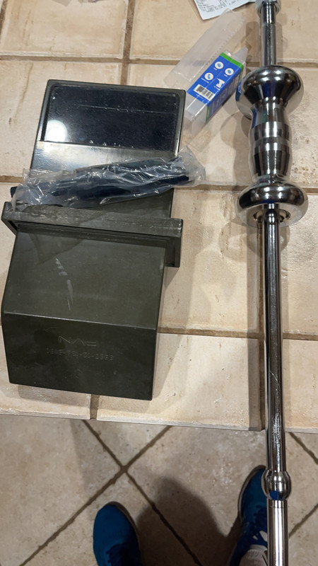

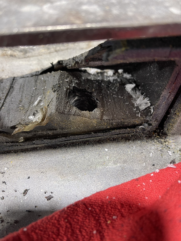

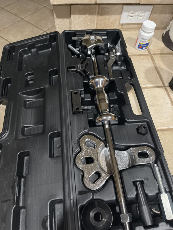

Looks like my answer to the stuck periscopes is a slide hammer and a 12” 1/2 drill bit.
Harbor freight here I come.

I should have more work done here soon in regards to the periscopes coming out.
I have a slide hammer, a 1" drill bit, and a plan

4/17/2023 5:28:15 AM EDT
On today's episode of man vs periscope....
..The periscope won
Drill 3/4 holes in the periscopes. Put the slide hammer in it. Jerked it like I was a lot lizard with a nasty drug habit.
Didn't budge one bit.
Hit it a bunch with a hammer and chisel. I think it budged a tiny bit on one side or maybe it was my mk1 eye balls.
It won today.

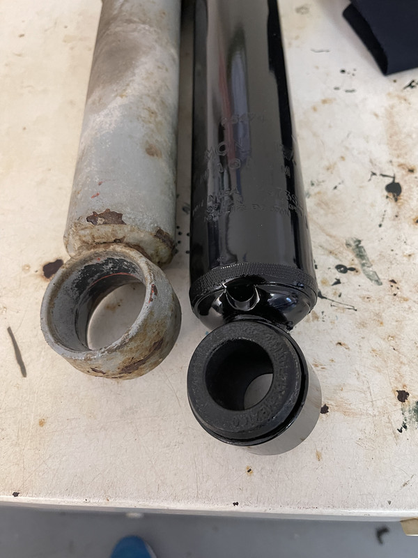

Ordered the shocks today.
Monroe 65474
It’s made for Peterbilt COE and other semi trucks so it should be okay. Mounts match up, dimensions not sure on but the length compressed and extended is perfect.
Arrives on Monday, I’ll test fit and order more if it’s a good match

The monroe shock tech line is absolutely worthless.
Worthless.
They had no information on rebound or compression rates other than they were made for older peterbilt trucks. Atleast they had the OD of the upper and lower body mounts. 2 3/4 and 2 3/8ths for upper/lower.
It'll fit.
It'll get here monday, so I'll test fit it and install one and if it fits, order 3 more.

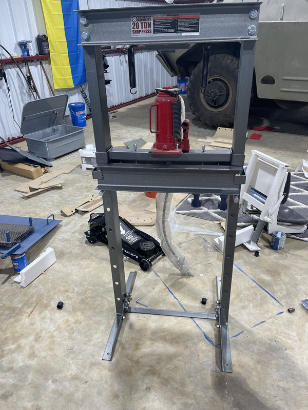

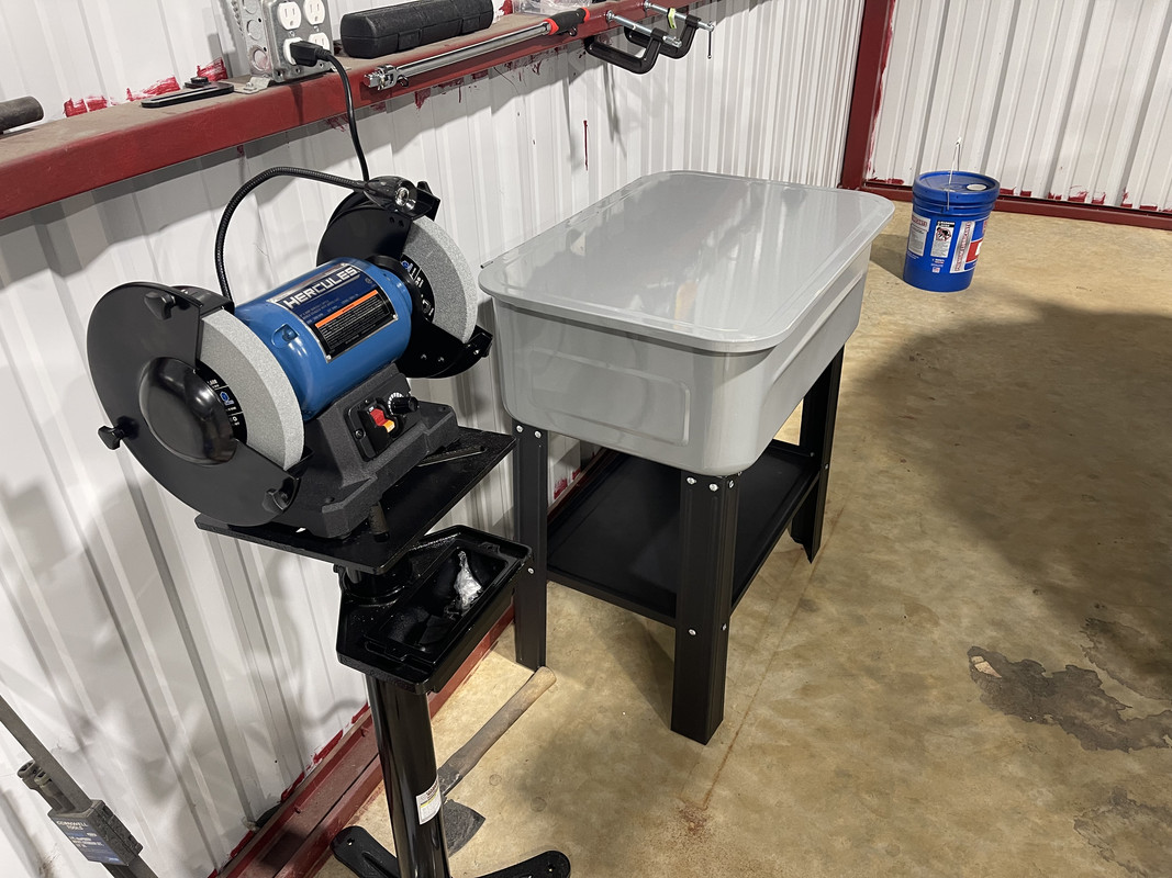

20 ton shop press assembled and just waiting on the tap and die kit to thread the mounting plate for the air jack
Parts washer bench grinder and pedestal assembled
I’m determined this next week I’m going to finish the interior of the Roland. I just have so many other things to do-cut the grass, chop down some trees, change the oil in the wife’s car, rotate the tires, take the dogs to the vet.

I spent the night assembling some of the tools I bought the other day:
20 Ton shop press (bearings, etc)
20 Gallon parts washer
I calipered the new shocks at 69mm upper/ 61mm lower and the old one at 65mm/59 mm. These are gonna be a perfect fit.
The new ones are about 3/4-1" longer extended but that matters little.

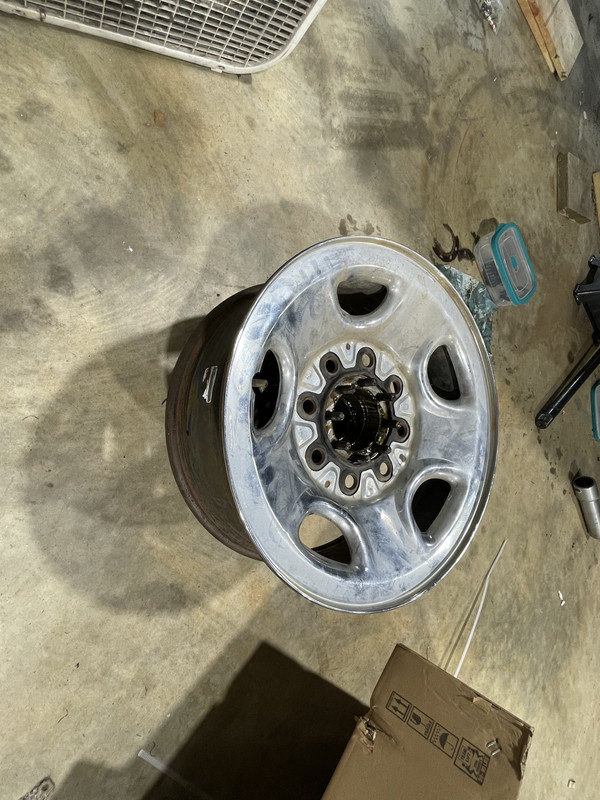

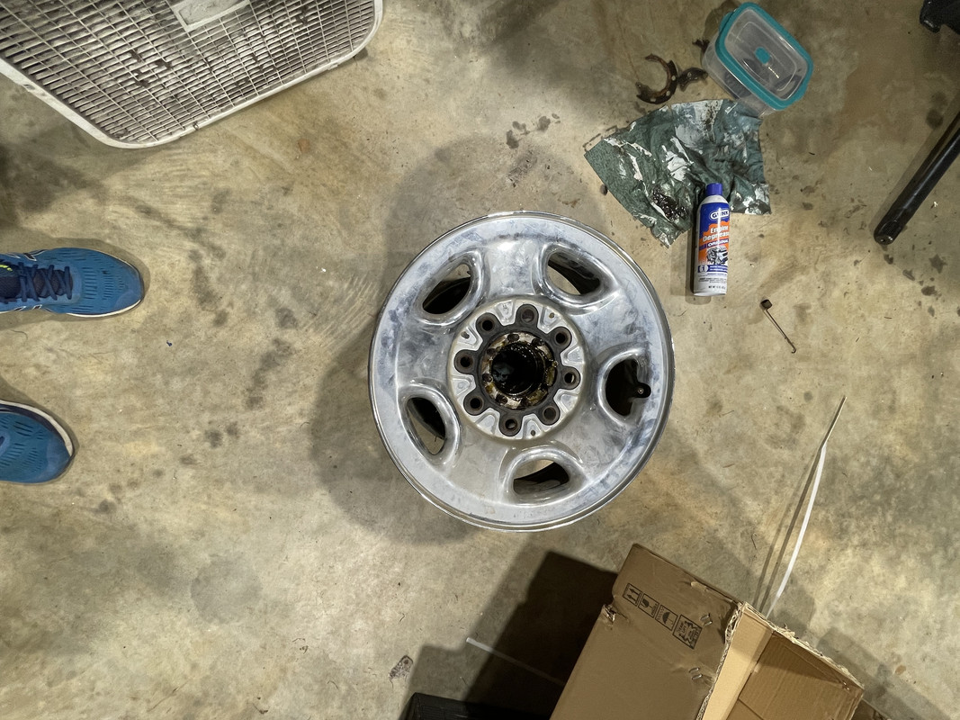

Goals for today: See if Discount tire can match up the tire/rim to a commonly available tire.
New lug nuts.
Funny, looking at page one and the shop and the floor it was so bloody clean. It's not like that now.

The tire shop in town gave me a dodge 3500 steel rim to test out.
Too small.

Success!
Dodge 3rd gen 17" rims fit perfectly and we have a wide variety of LT truck tires to choose from.
One of the nice things about shopping with a local business is they are local and not just employees. They are about 5 miles from my house so it's nothing to zip down there.
The owner of the tire shop gave me the 16" rim and told me to see if it fit. I asked him how much I owed him. He said nothing, just bring it back if it doesn't fit.
Well, it didn't fit. I had a hell of a day with my phone dying (dead mainboard, 4013 error code) and I went by the shop and they checked a dodge 17" rim..perfect fit. It's a steel rim with a chrome cover. I will wire wheel the rim, rip off the chrome, and paint it in the sloppiest manner possible
He charged 60$ for one and I asked him to get 4 more since in a month I would be getting the tires. That gives me 4 plus a spare. Perfect.
We will probably go with 275/285 tires in 12 ply. Plenty strong enough for an 11k vehicle and a semi-AT tread that is lightyears better than the NDT tires that were on it.
I left one of the roland tires there so they could find something in the same size and width.
because my phone died I don't have pics but the rim fits perfectly.
