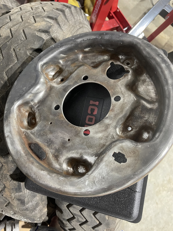

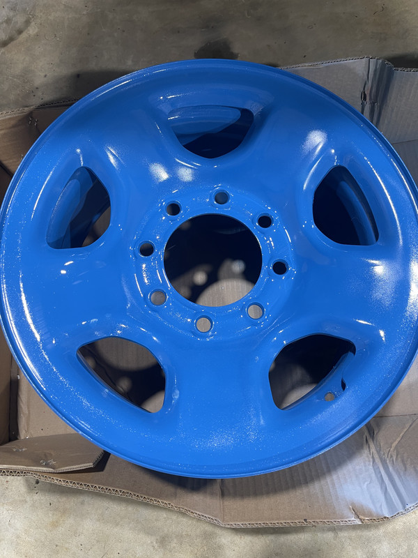

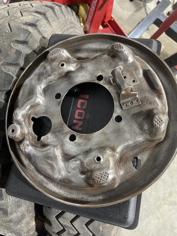

One rim 90% cleaned up. There are some spots on The inside of the rim that need to get cleaned up which the grinder can’t reach. I might get a water blasting kit and use a pressure washer to clean those areas up.
I opted for the original blue colors since that’s what the original rims were painted.
Heart and soul of a 75 dodge w300, shoes of a 2005 dodge 2500

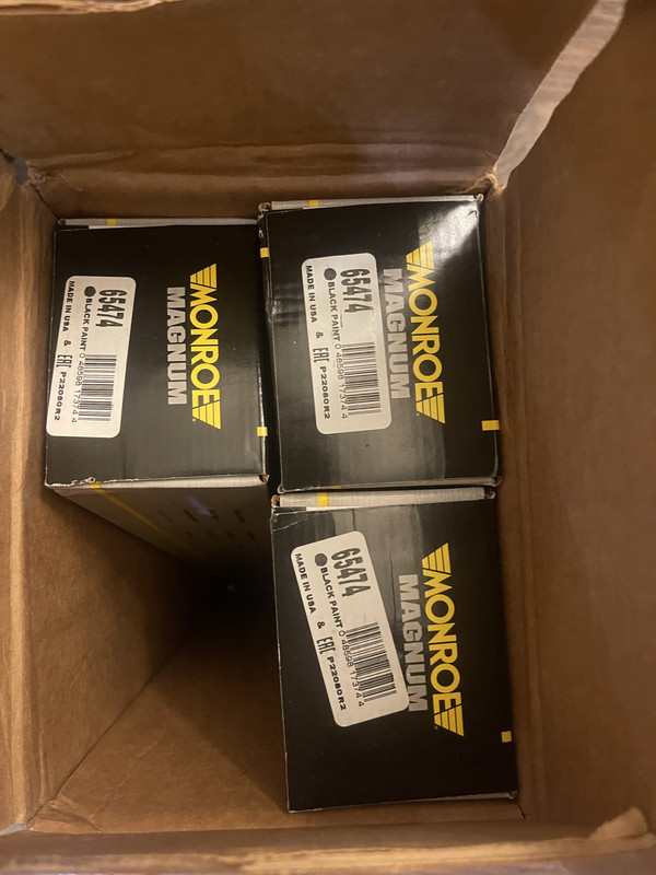

Last 3 shocks arrived.

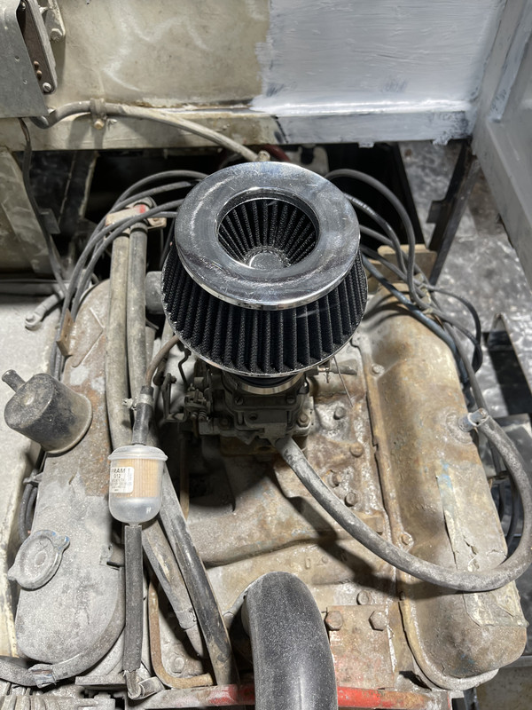

Fixing the fuel pump
Air filter? No clue.

You need a 3-D printer to print adapters for such.

You could print an entire air filter box for whatever air filter you'd like to use.
Easier to buy a spacer from Amazon and slap the surplus edelbrock from the brdm2 on it

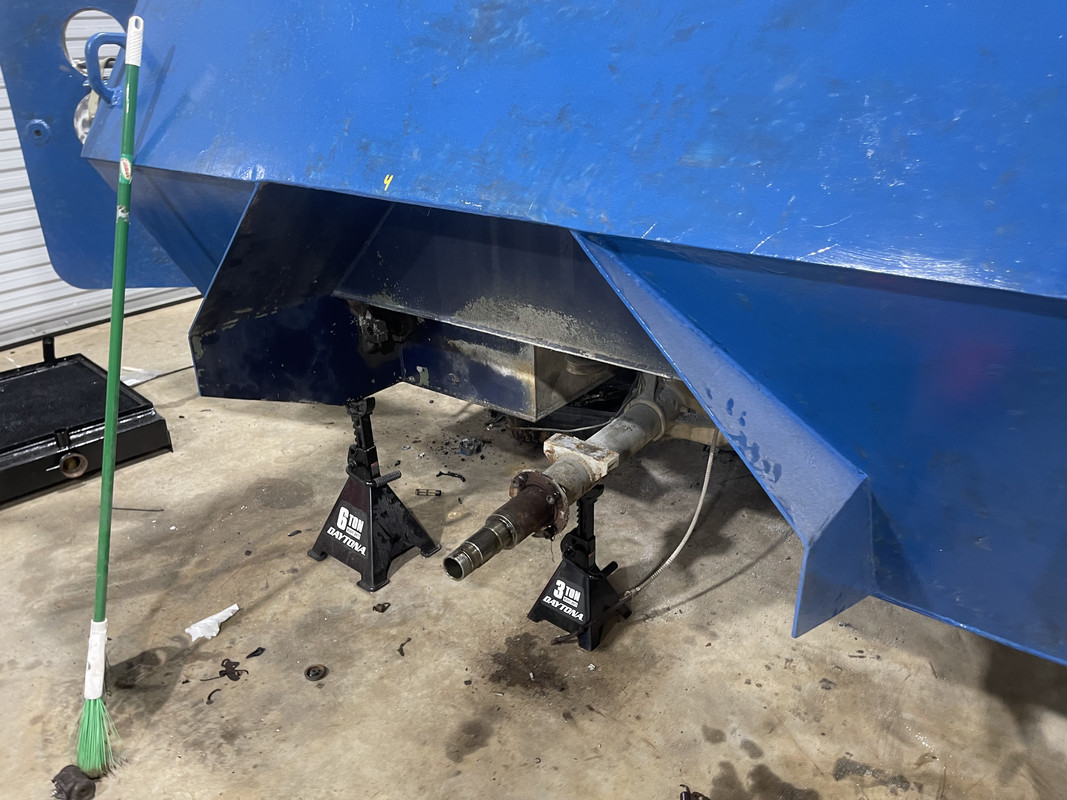

5/15/2023 8:11:23 AM EDT
Pulling the leaf springs off today
Going to plumb the fuel pump in

New shocks passed the cat scan

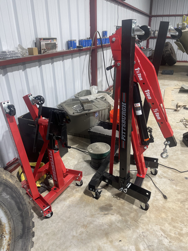

More tools ready to replace the engine one day and accept the extra gaz41 and transmission.

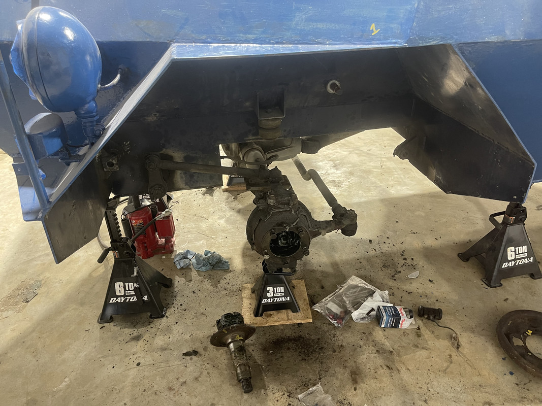

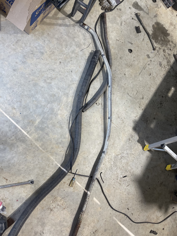

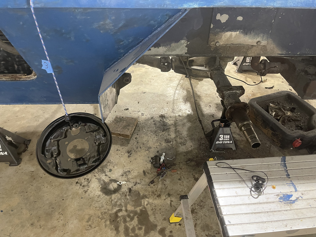

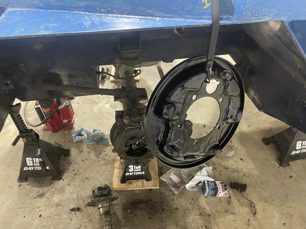

This Monday the goals are to remove the front leaf springs, yank the gas tank, redo the lines, install the air filter, and get the rims from the tire shop.

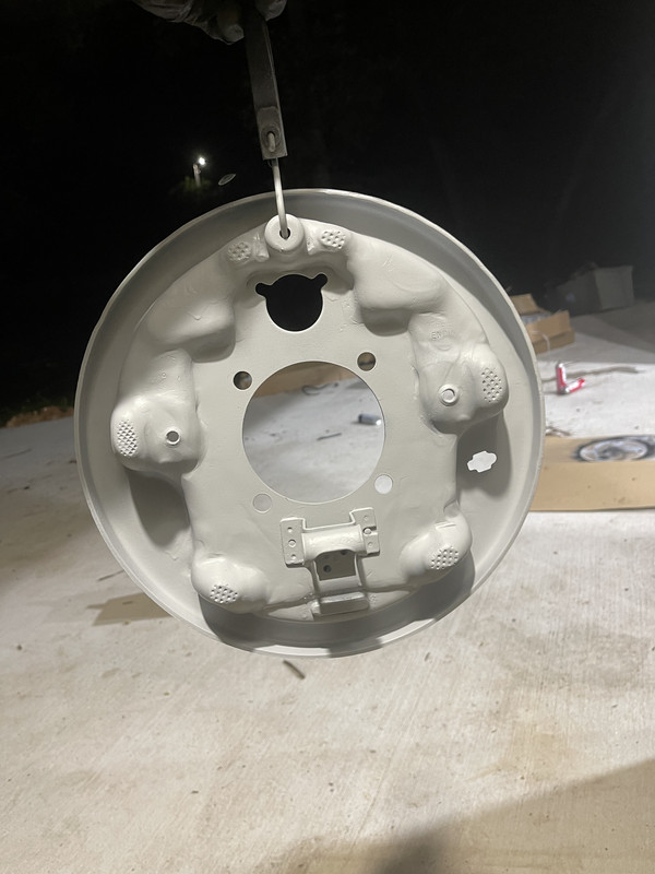

Tuesday do the brakes (new shoes, hardware), drop the springs off at champion spring

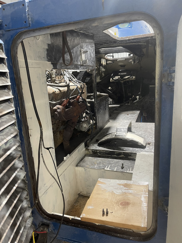

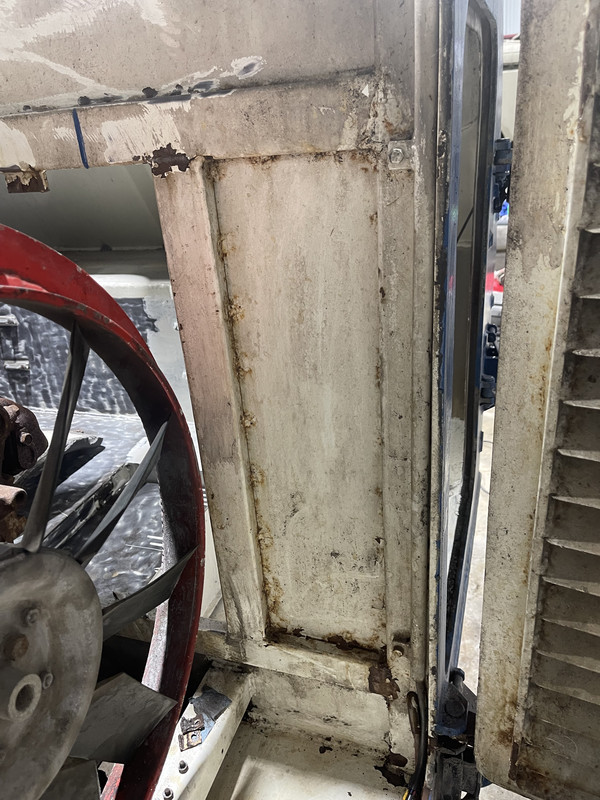

5/23/2023 4:08:15 AM EDT

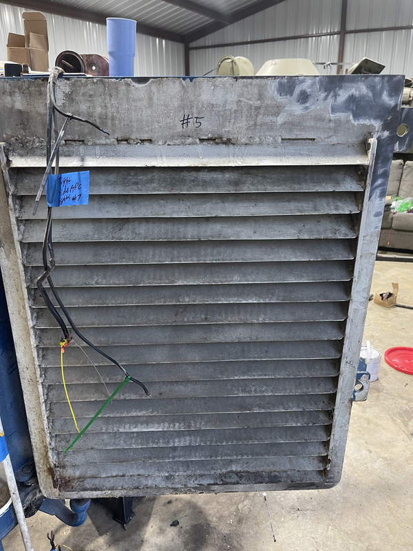

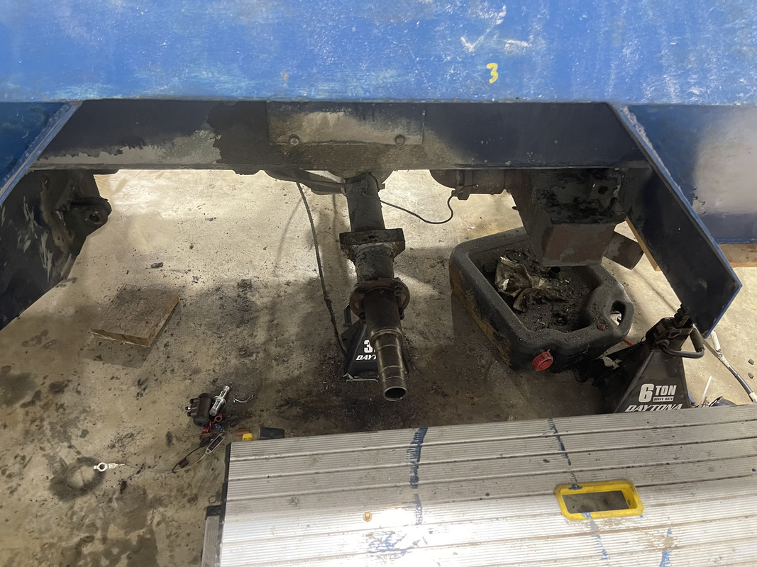

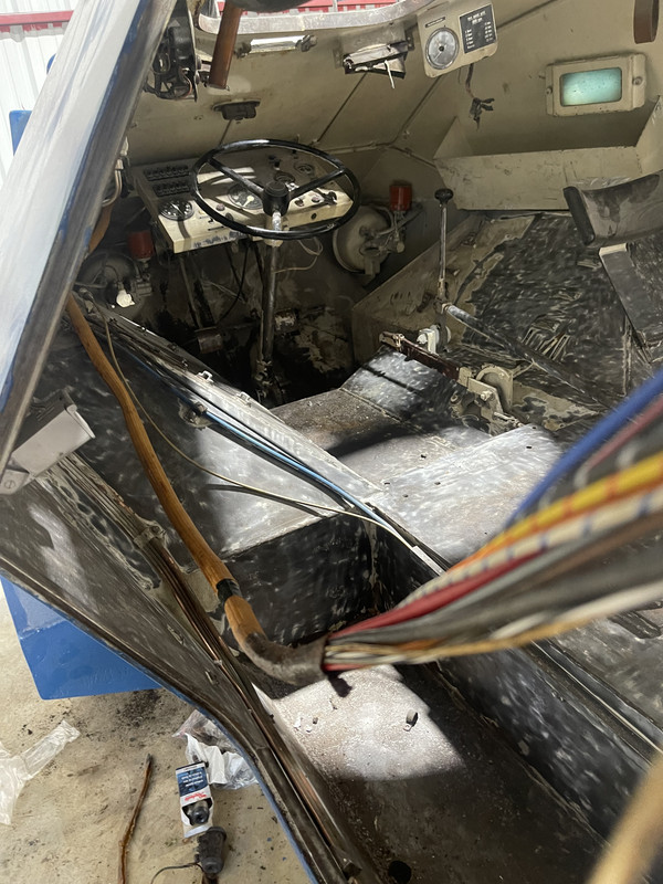

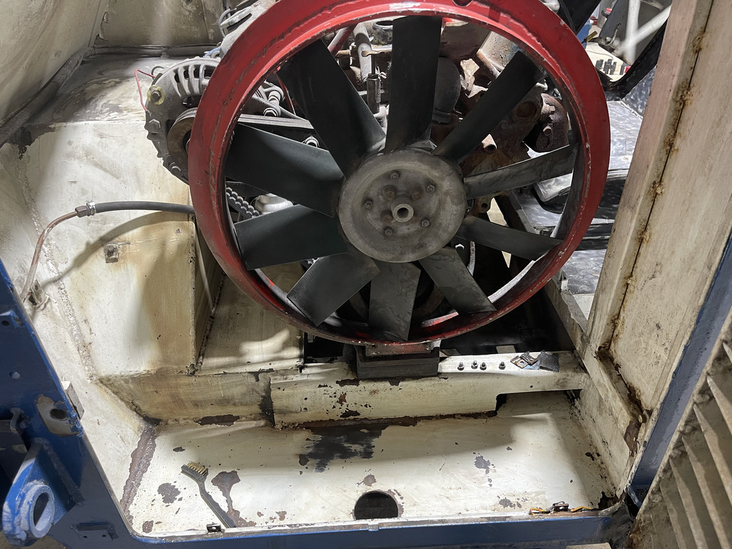

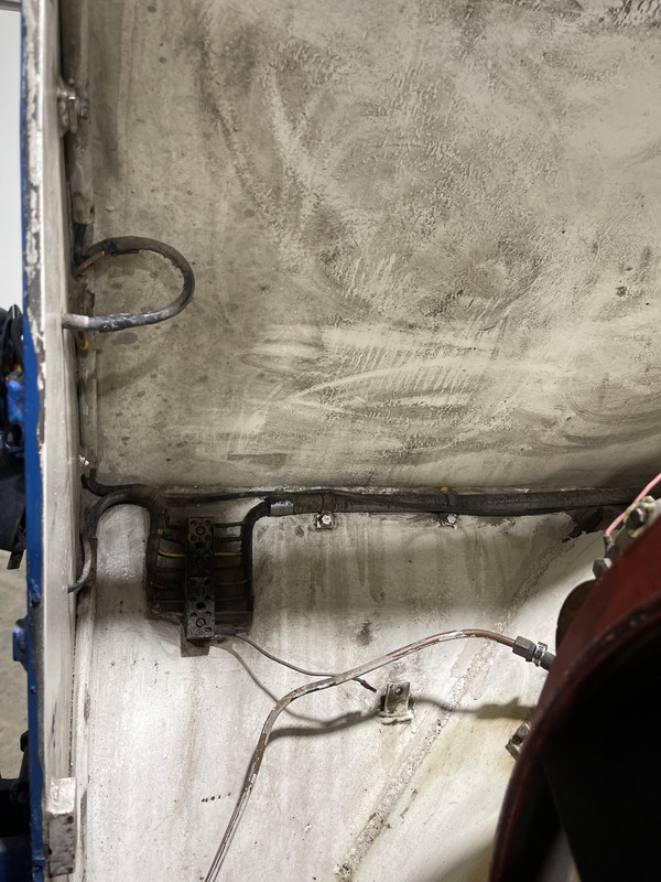

With the radiator, hood, and radiator shroud removed I can access the rear of the engine bay hull for cleaning.
It's very, very nasty.
Had to unbolt some wire and fuel line brackets but cleaned it mostly up. The rain cut it short.
Didn't take pics. Will later.
Blyat
Let's go Brandon
President of the Volodymyr Zelenskyy fan club
5/23/2023 5:44:42 AM EDT

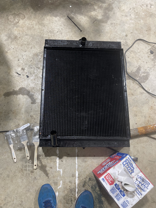

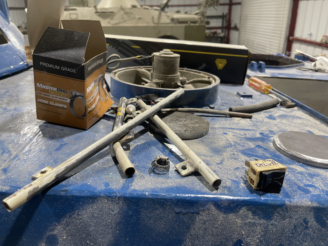

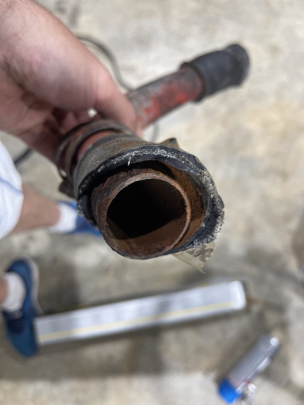

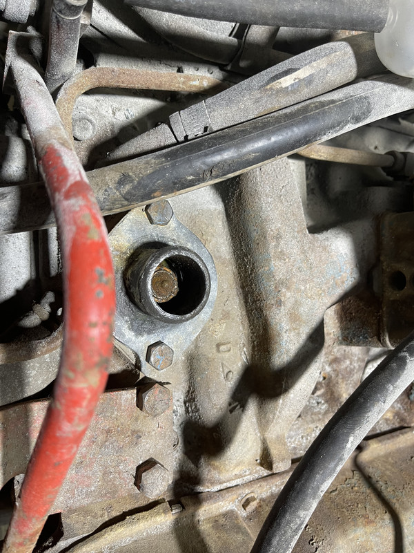

[Last Edit: fadedsun][Edited] [#19]
Pics

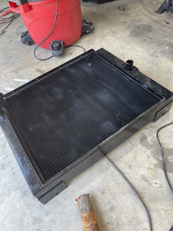

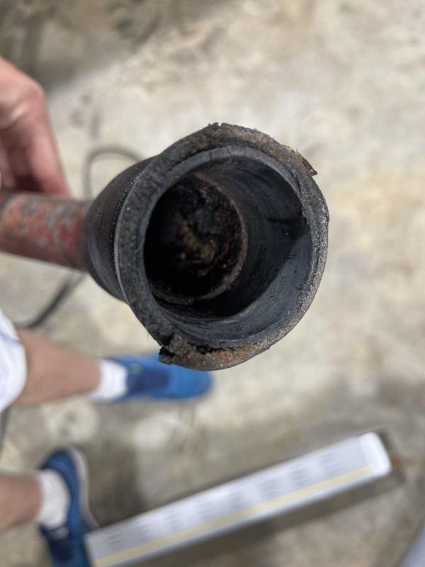

Pulled the radiator hose off. It’s
Horribly corroded. Will get a new one today.
The brass radiator is off getting repaired.
Compare before and after with this:

Front brake hardware kits ordered. ETA: Weds.

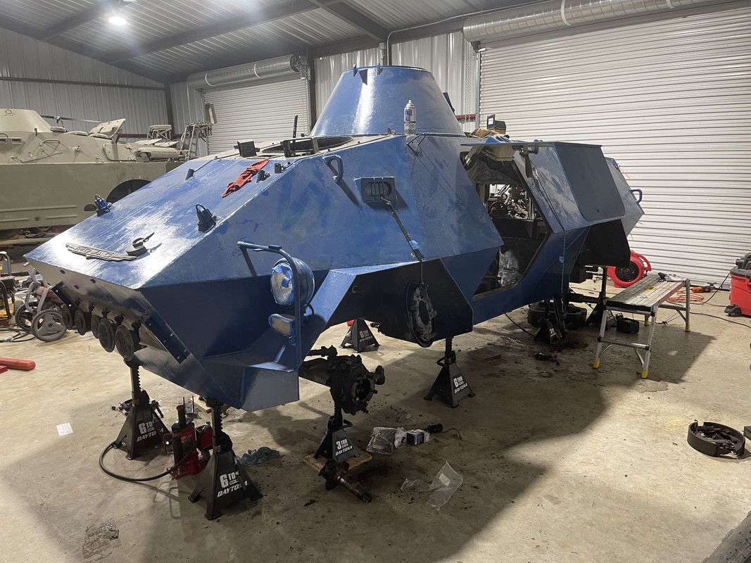

So with all my research there are roughly 5 Rolands in the USA.
One somewhere in the midwest that was converted to a SDKFZ German WW2 lookalike.
One in South Texas painted in Berlin brigade pattern.
2 in Michigan still with the seller of mine.
1 in North Texas-mine.
Once I am done I'll have the nicest roland in the USA.
By nicest I mean the most mechanically sound and cosmetically decent (my paint job is atrocious).

5/23/2023 10:52:50 PM EDT
Originally Posted By BPR:
to be fair, I'm sure any of the Rolands that ended up blue had atrocious paint jobs.  :)

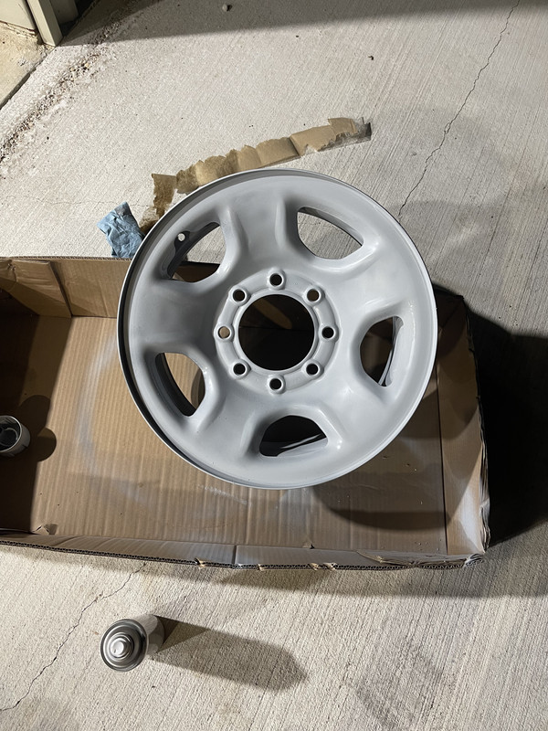

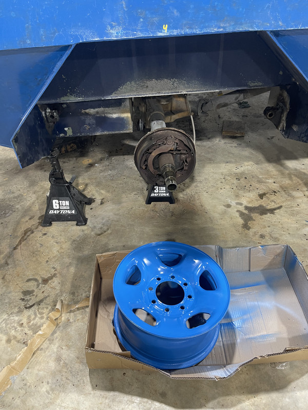

I'm painting the rims right now after my piss poor attempt at wet blasting them. Seems to be turning out okay so far. I'll post pics later.

[Last Edit: fadedsun][Edited] [#27]

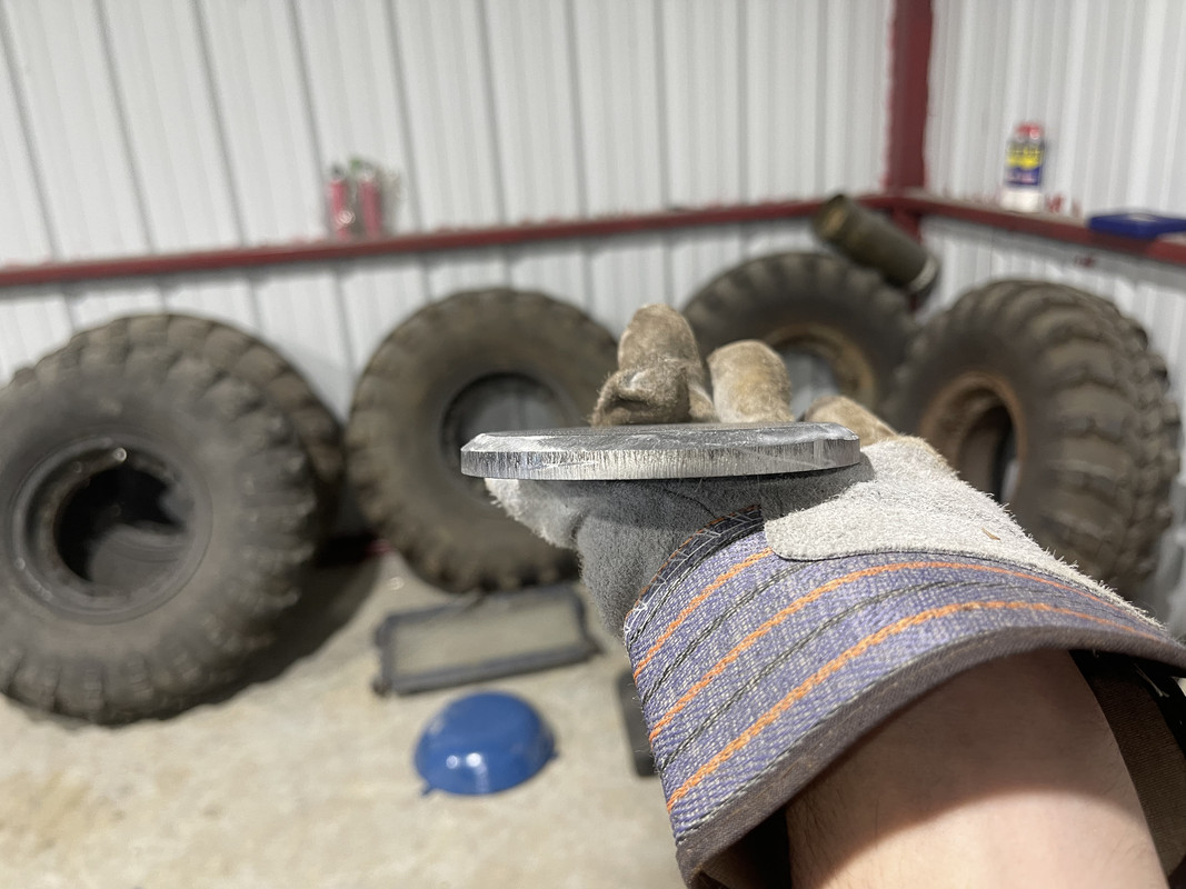

One rim down, 4 more to go. Need to pick up the other 4 from the tire shop and get started on them.
My experiment into wet blasting didn't work out so well. I think it was because the sand was too wet. Needs to be drier.

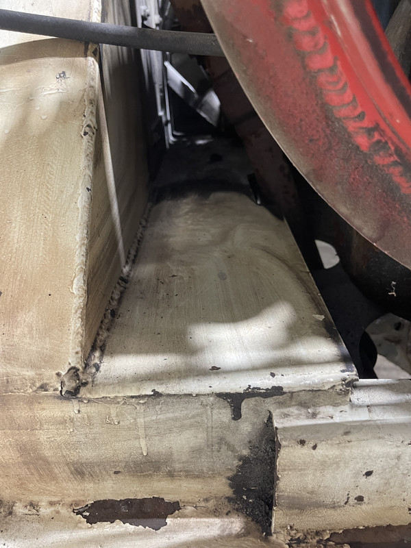

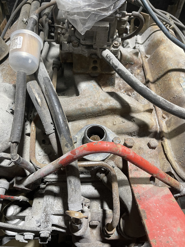

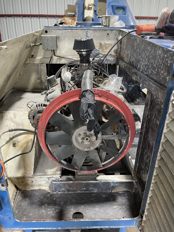

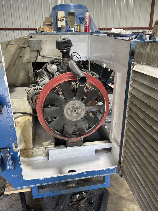

5/24/2023 6:35:56 AM EDT

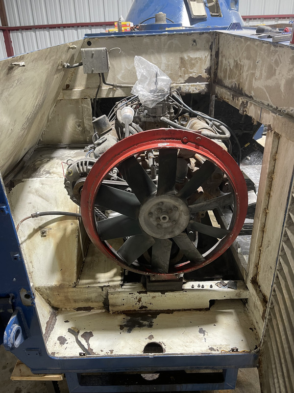

Everything looks great!
Except for the fuel line.

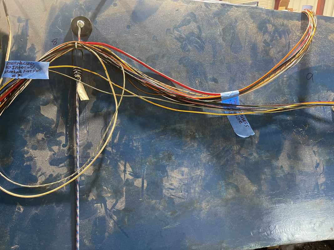

I don't know if it's the angle, but it looks as if the rubber fuel line is contacting the corner of the structure.
If that's the case, every time the engine moves, that line will be sawing against the structure.
It might take a long time to do it, but it's best to play it safe and re-route the line a little, maybe by bending the copper line lower and making a more direct shot to the engine.
If it's just an illusion, keep moving ahead!

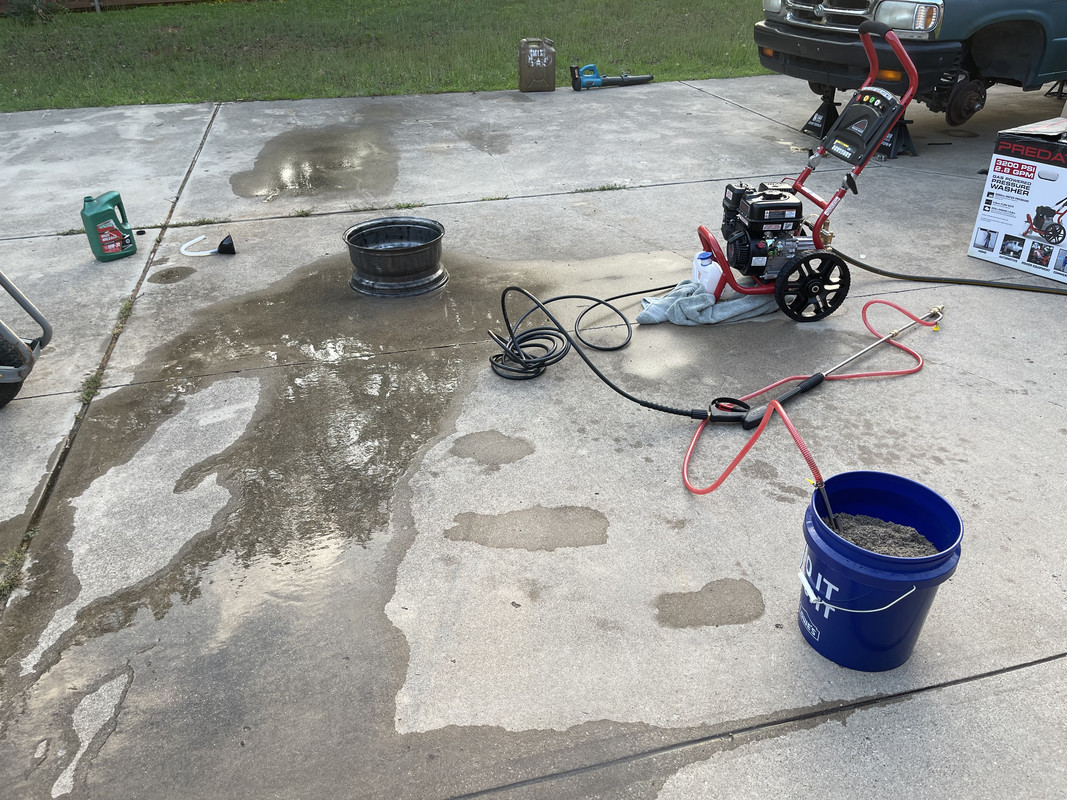

Tell me about your wet blasting setup. I also have some $50 wheels that need to be blasted and painted.
The hardest part about a zombie apocalypse will be pretending I'm not excited.

5/24/2023 4:24:08 PM EDT
400$ Harbor freight 2.8GPM 6.5 HP pressure washer
30$ wet blasting kit off amazon
4$ Lowes bucket
10$ play sand
Doesn't work too well, the sand is still wet so it clumped out

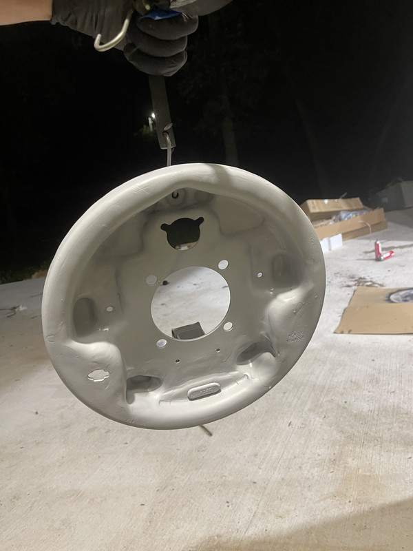

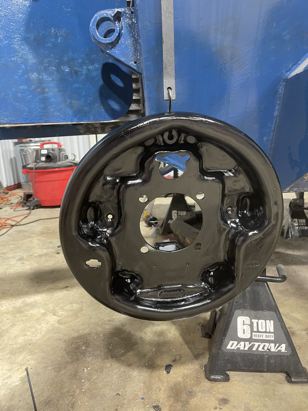

Brake parts from rock auto here
And because it’s Saturday here’s my wife’s brainless cat
Bonus round
Leaf springs are ready to pickup from champion spring. They called 3 times on Friday but I was dead asleep. Due to Monday’s holiday I’ll pick them up Tuesday

5/28/2023 1:50:29 AM EDT
It’s not. The copper fuel line does and is held in place by hangers/clamps that are bolt to the hull.

Can join you Tuesday, and bring the boy.  What time, so I don't wake you up?
Depends if I get those rims or not. They have to be wire wheeled and I still need to wet blast the backing plates, prime,
And paint

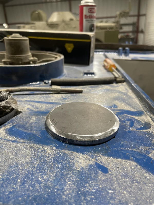

5/30/2023 1:20:58 AM EDT
When the vehicles were in service the Greeks cut holes in the top of the hull for the addition of Motorola radio antennas.
I’m not doing this with mine, only using either bolt on or magnetic mount antennas.
So I’ll weld these on later.

5/30/2023 11:04:52 PM EDT
[Last Edit: fadedsun][Edited] [#41]
Radiator back from the shop
It had a crack in the body by the top left mount. Welded, flushed, and painted
Wiring pulled to replace the conduit since it had rusted through.

5/30/2023 11:08:46 PM EDT

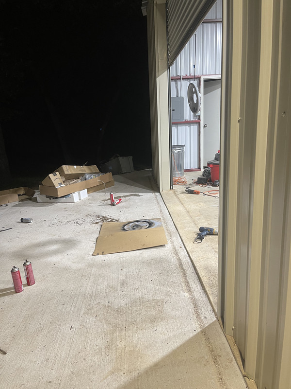

Lot
More painting to do tonight and annoy the neighbors as I work at 3am.

I can't believe you found a radiator shop!
They're just as hard to find as a good machine shop.
5/31/2023 6:22:40 AM EDT
I was pleasantly surprised too.
They did a good job and I'm happy.
now to get the lower radiator hose. Conduit. Parking brake. Gonna go take some pics, BRB.

5/31/2023 8:35:54 PM EDT
OP fell asleep.
Yeah.

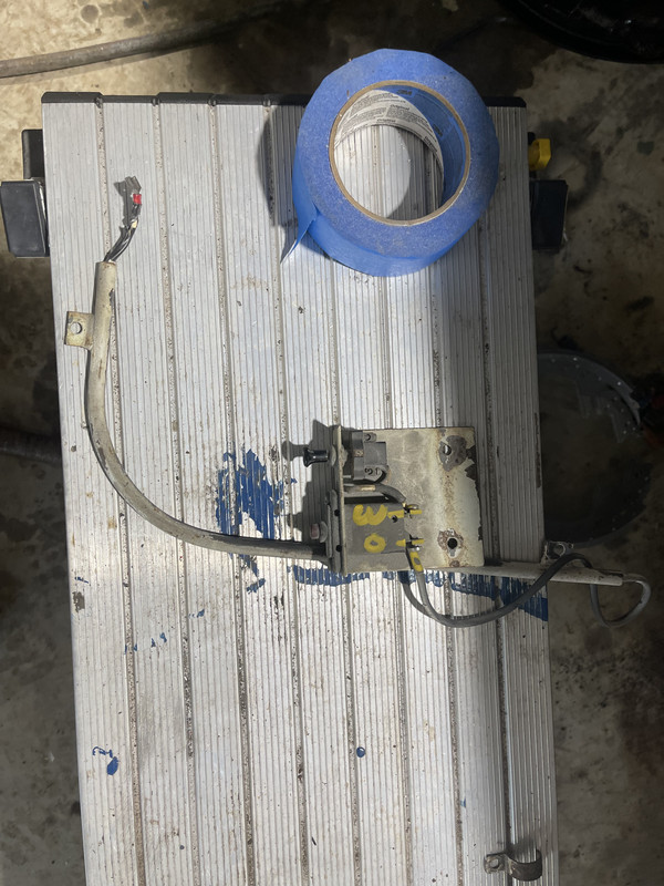

Conduits out. Going to be replaced. Tach will be fixed too.

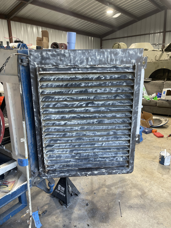

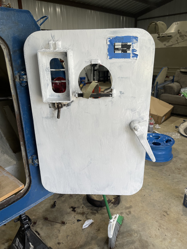

6/1/2023 9:53:22 AM EDT

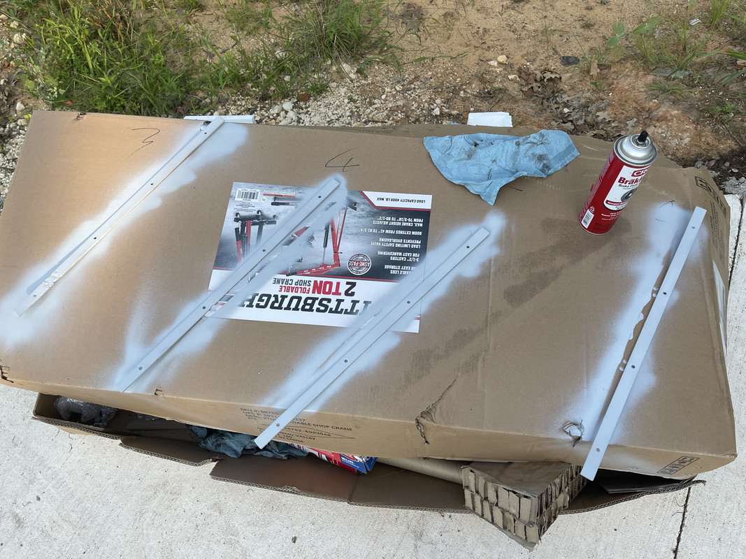

Back door painted
3/4 back plates removed and painted
M

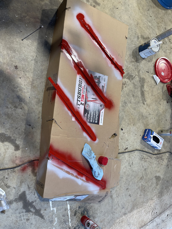

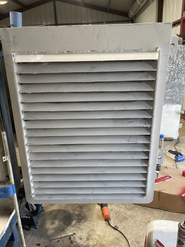

6/2/2023 7:20:35 AM EDT
Time to go paint. BRB. Painting the cooling vents in the back and and the radiator alluminum supports.

6/16/2023 12:16:23 PM EDT
I've still been working on stuff on it, just not as much since I've been gone for most of june on my 2 weeks of Annual training.
I have the new rear brake drums. The front ones are a bit harder to find and are possible off a mid 60s ford or international truck. I might just clean them up with a grinder since they aren't too bad, just the leaking brake fluid ate away at the paint.
