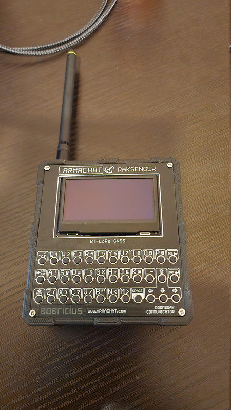

Latest build:
Two more need to finish:
Brought to you by Carl's Jr.
