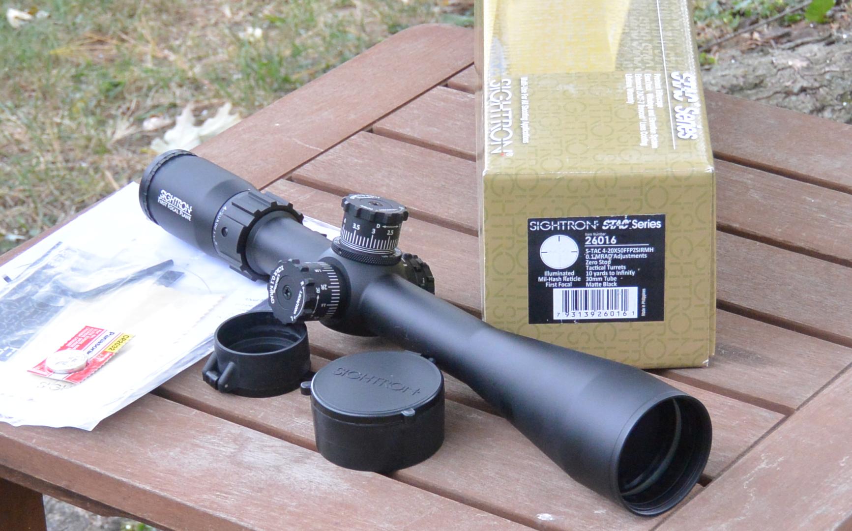

Unboxing and Physical Description:
At first glance, the S-TAC 4-20X50FFPZSIRMH appears to share a lot of similarities with the SIIISS624x50LRFFP/MH. They are both long and light scopes with very plain and subdued styling. The S-Tac comes in at 15" in length and 25.6 oz weight. Both scopes’ turrets are also very similar, being 5 mil / turn with similar styling and feel. The S-TAC, however, comes standard with the better labeled and higher visibility text found on the "tactical" turrets which were an aftermarket option on the SIII and also include a zero stop. I should note that you can now get these updated adjustments (zero stop and tactical labeled turret) in the SIII with the SIIISS624X50LRZSFFP/MH model. These are the only changes from the SIIISS624x50LRFFP/MH I reviewed last year. Unfortunately, to get these additions adds a hefty $150 to the price. To that set of features, the S-Tac additionally has illumination and a flip-up throw lever on the power ring. Neither of these features is to be found on either higher cost SIII scope.
In the box with the S-Tac is a lens cloth, plastic flip-up covers, two hex wrenches, a battery, and the same generic-to-all-Sightron-scopes manual that I received with the SIII last year. Said manual was supposed to have been updated to fix a minor error pertaining to angular and linear measurements in the windage and elevation movement table section, but evidently was not, as they are identical manuals. This update not happening could be worse, as it is basically a typo. However, each scope also includes a second supplemental sheet which has a reticle diagram and dimensions for said reticle, as well as a mil ranging formula. The ranging formula was wrong in the SIII's supplemental sheet and is now somehow wrong in a different way on the S-Tac's. These are not mere typos either, these are incorrect, non-functional, and non-sensical formulas. The correct formula should be: (target height (meters)/angle subtended (mils)) *1000 = range to target in meters. I am dismayed at both the persistence of the Sightron folks in getting this wrong and the misplaced creativity demonstrated by getting it wrong in a different way.

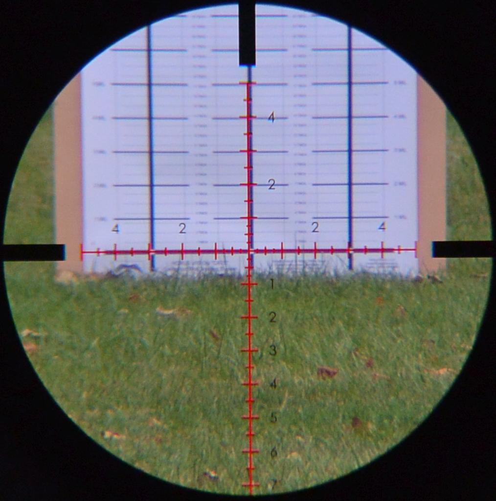

Reticle:
The Illuminated MH-4 reticle on the S-TAC 4-20X50FFPZSIRMH is very similar to that which was on the SIIISS624x50LRFFP/MH. Both are very simple mil hash reticles with .5 mil subtensions over most of the reticle and .25 for the first mil from the center. The MH-4 in the S-TAC improves on the reticle in the SIII by adding some number labels for the divisions. This may seem like a minor improvement but in practice it helps greatly in avoiding mis-counting and can also save valuable time when making adjustments. Neither reticle has a Christmas tree section, which I am not sure is a bad thing as tree sections can interfere with how well you can see the splash on a miss. The reticle on the S-TAC is also illuminated and it is substantially thicker. I expect these two may be linked since the SIII had a very fine reticle that I doubt would have illuminated well. The illumination on the S-TAC is not just on the center area but instead on the whole of the graduated section of the reticle. I prefer this arrangement. In general, I feel very much the same about the S-TAC's reticle that I felt about the SIII"s. There is little to either enthuse or repel a prospective buyer in the design.
In testing, the reticle was correctly sized and showed no cant relative to the adjustments.
Sightron S-TAC 4-20X50FFPZSIRMH's Mil-Hash reticle on the HORUS CATS target at 20x

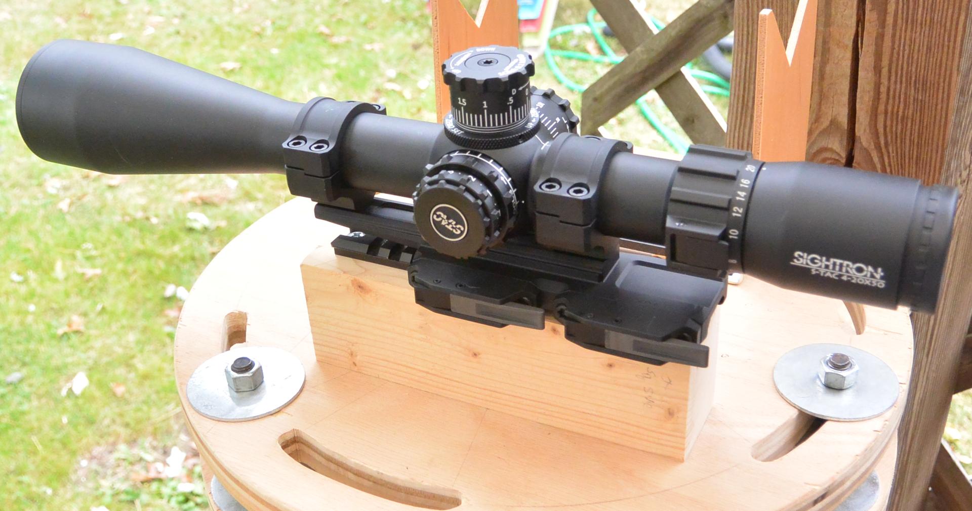

Mechanical Testing and Turret Discussion:
The S-TAC's knobs are very similar to those on the SIII with the addition of a zero stop. The knobs are 5 mil / turn and have clicks that feel and sound positive, but are not so stressed out that they will skip over detents and make you miss count. I would therefore say that the feel is a win. As on most of the sub $1K series, the zero indicator adjusts independently of zero stop. In this case, you loosen the top screw to change the indicator setting. The knob is only fastened to the adjustment by this screw and so can be easily turned when it is loose but must be carefully lined up while being tightened as there is no indexing. The zero stop is a collar under the knob that locks into place with three set screws. Once you have zeroed the scope, you just loosen up the set screws on the collar and turn it until it snugs under the knob. The actual threading for this collar is above the section that the set screws interface with so the set screws won't mess up the threads. Probably the best thing about this system is that the zero stop collar has a line on it for each turn above zero. This is very handy, especially since the 5 mil / turn knobs mean you will often be a few turns above. I find this a substantial improvement over designs that have lines but where you are already several up from the bottom at zero and often also at some odd increment between them. Because the lines are on the collar piece that is the zero stop, they always line up right. The least attractive feature is that the collar feels a bit like a jam nut in that the knob will jam itself onto the stop when you turn to it and stick a bit pulling it off. Overall I like the adjustment mechanism with the exception of being only 5 mil / turn and only being labeled for that first turn.
When tracking, the adjustments deviate from true in a non linear fashion.
Going up from optical center:
-At 5.0 mils on the adjustments, the scope is at 5.1mils on the target.
-At 10 mils on the adjustments it is at 10.1 mils on the target.
-Its full range is 11.5 mils on the adjustments at which point it is at 11.6 mils on the target.
-It returns to zero fine and shows no slop in the adjustments going back to center.
Going down from optical center:
-At 6.0 mils on the adjustments, it is at 6.1 mils on the target.
-At 10.0 mils on the adjustments, it is at 10.1 on the target.
-Its full range is 11.9 mils on the adjustments 12.0 on the target.
On the windage, it also seems to deviate a little, showing ~3.05 mils on the target when it is 3.0 on the knobs. I expect it would prove to follow the same pattern as the elevation if I had a target that went out that far.
There is no zero shift with parallax, diopter, or power ring and I saw no reticle cant. The reticle graduations are also the correct size.
This degree of deviation from true in the tracking is about average for all the scopes I have tested over the years.
