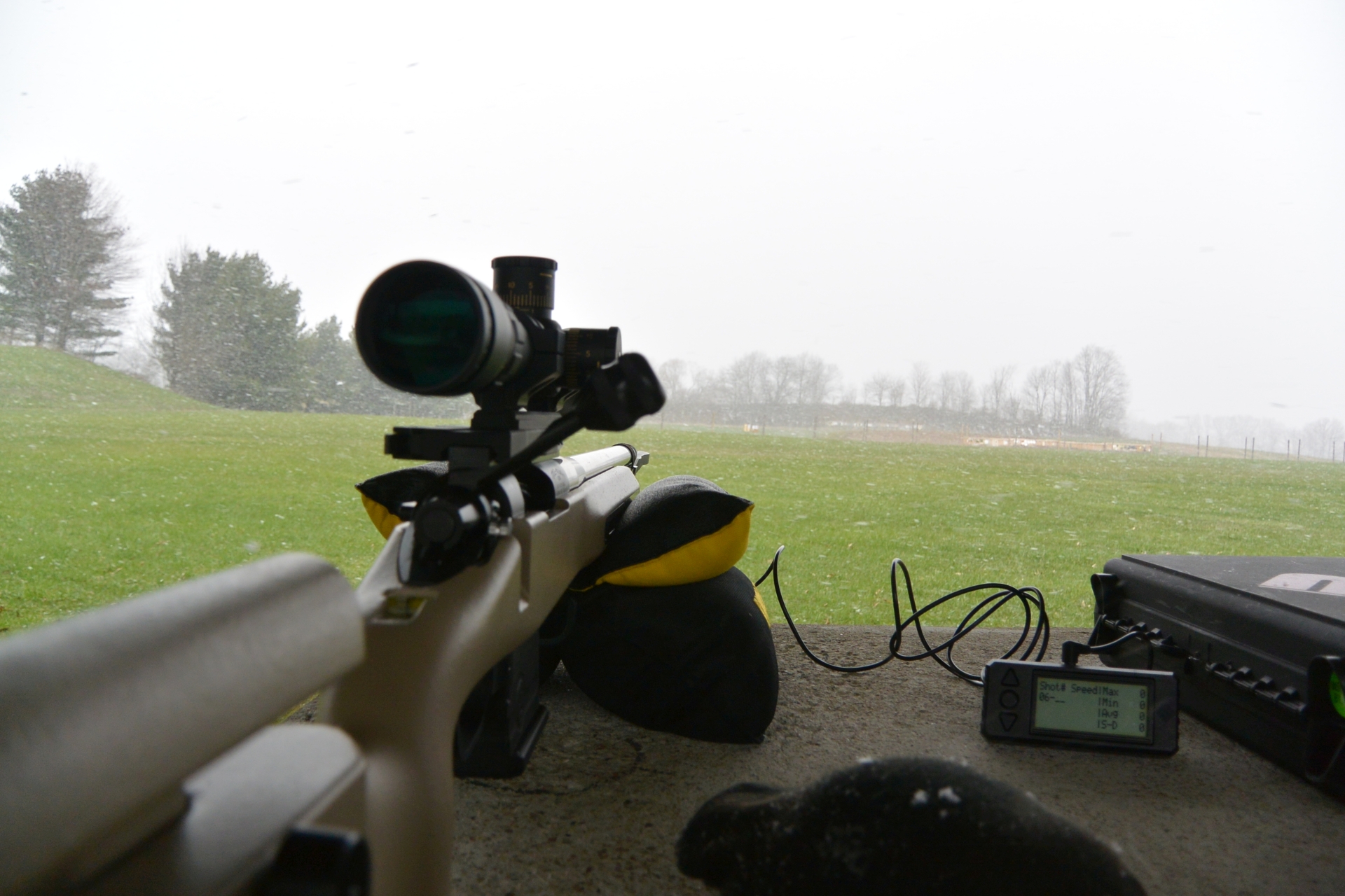

I carried out the accuracy testing with factory ammo over the course of three shooting days with the bulk being done in one marathon 7-hour day when the weather was just right. Testing was done  at 100 yds shooting from a concrete bench with a Bulls Bag front and a rear bag of my own design. I tried testing both with and without the magnetospeed chronograph and saw no accuracy difference so did all of the long day with the chrono. All rounds were mag fed five at a time. I took a break every 30 - 40 rounds when the barrel started to heat up and mirage. I cleaned during each break because I had nothing else to do and wanted to keep as close to uniform conditions for each ammo as possible. The scope I used was a Sightron SIIISS624x50LRFFP/MH set to 24x mounted in a Bobro dual lever precision optic mount. Magnification, rests, and non-free recoiling position considered, I think it would be fair to say that my hold is not reliably better than .25" in this configuration.

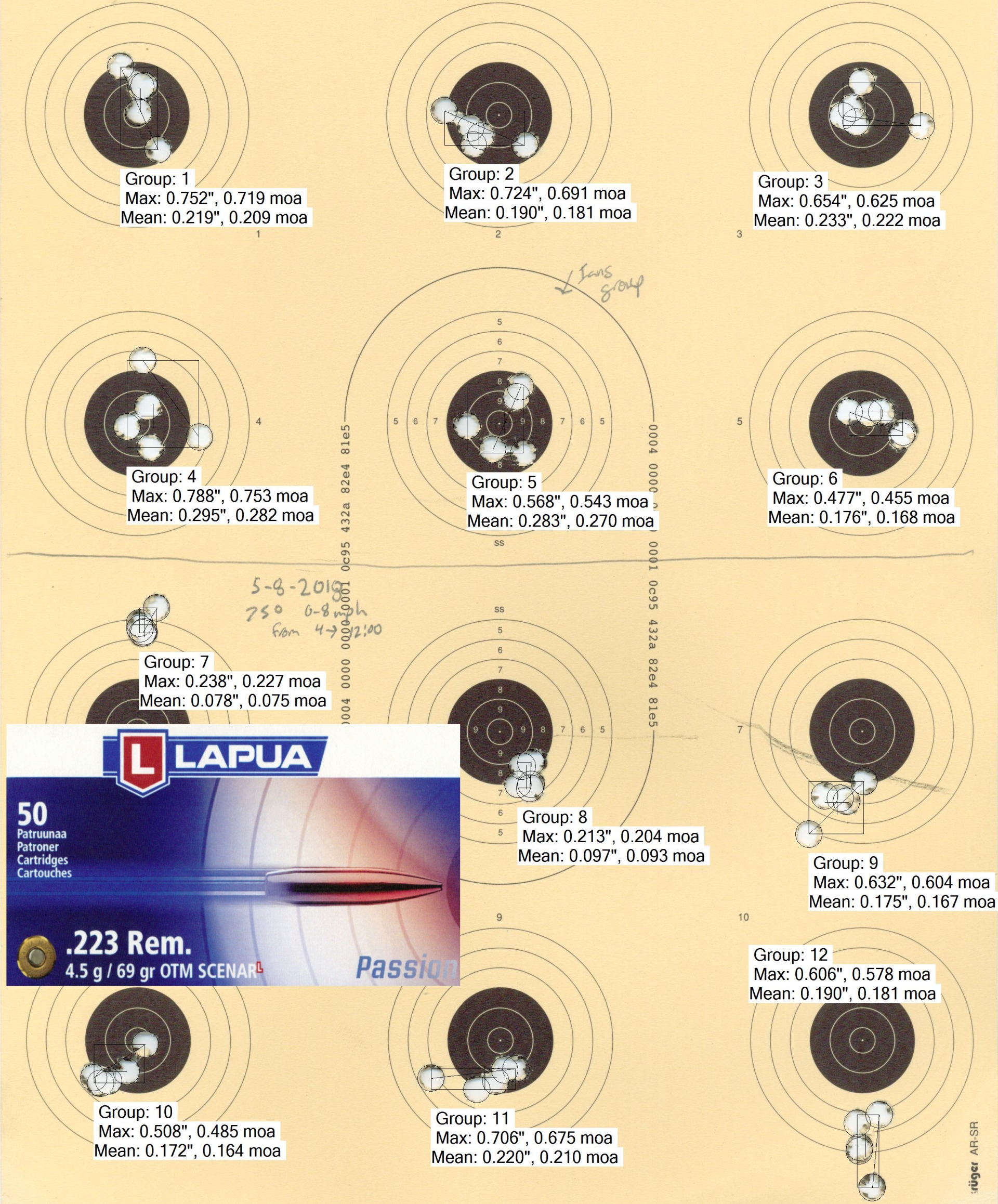

Lapua
Lapua is a Finnish company. This is significant as Finland is a country with a population roughly the same as Minnesota but which defeated the U.S.S.R. - in war, not hockey, which Minnesota might actually be able do. The Lapua ammunition factory, at that time a state entity, was the primary supplier to Finland for those conflicts during which sharpshooting became a key tactic of the vastly outnumbered Finnish forces. Long range precision shooting is now baked into the culture. Lapua has found a great deal of success in the U.S. market, primarily in precision .22lr and in ammunition brass. They have seen less penetration with their bullets not because they are poor but because there is actually stiff competition in domestic precision bullet manufacture. Lately, Lapua has been expanding their loaded ammunition offerings and I had heard very good things.
Lapua was the best performing ammo in my rifle by a huge margin and, on the best shooting condition day, averaged better than .5" at100 yards with the best group being under .25". The average of the Lapua groups on that day was actually slightly better than the best single group from anything else. In general, I would be very impressed with any factory ammo that averages sub .5", but it is even more impressive with .223 because .223, with its short neck and long skinny case, is one of the trickier things to get right.
The Lapua factory 69gr ScenarL target from the second two Kelbly's rifle factory ammo testing days.

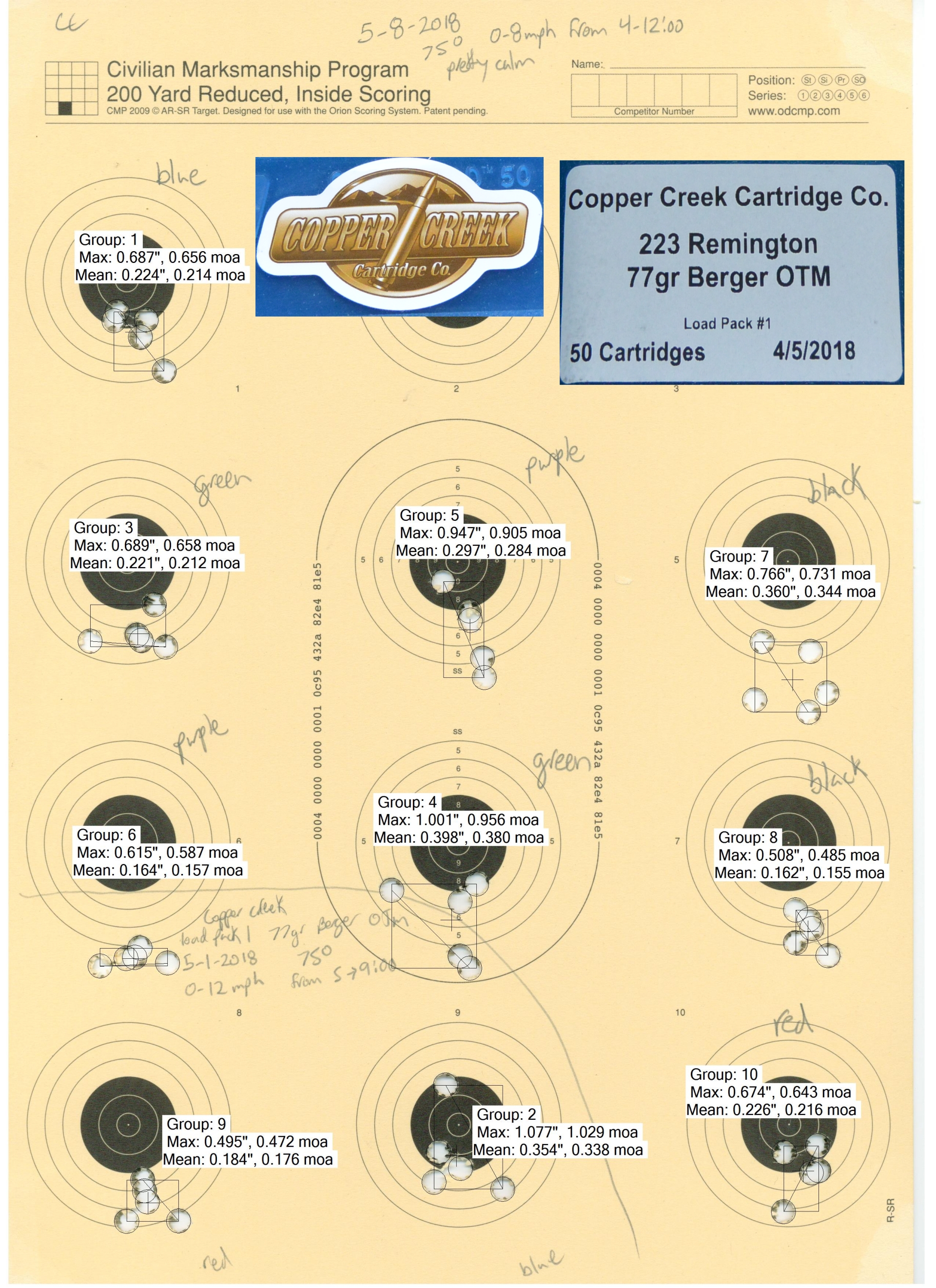

Copper Creek
Copper Creek Ammo is a relatively small scale U.S. maker that offers both standard loaded ammo and a unique two-stage load development option that sort of approximates the handloading procedure by varying first powder charge and then seating depth. In the procedure, you fire one group with each of 5 charges, pick the best, measure your chamber with the Hornady OAL gauge, and have them send you a second set of loads. These next 5 loads each have the charge you chose but with a different depth of seating. I was intrigued by this as it attempts to overcome the biggest challenge that factory ammo has, namely, the aspect of fit to the rifle. Since it has been my experience that something always goes at least a little wrong, I had them send me 10 instead of 5 of each charge weight. Basically, a double load development pack.
In practice, the Copper Creek load pack put me right into my handloading mindset. What I mean by this is that there were specific things that I wanted to do based on what I saw and felt. For instance, one of the blue rounds closed hard and then, not surprisingly, flew out of an otherwise tight group. The Kelbly rifle has a tight chamber and it probably bumped the lands a little. I wanted to try that load but bump the rounds back a little. The purple and black charges both were OK but not great, leaving me to think that perhaps there was a node between them and I wanted to split the difference in charge and try that. What I am sure of is that, although there are certainly times in the load development process where I have only fired 5 rounds with a particular combination, 5 is only enough to make a negative call and not a positive one. I might move on from a bad 5 but I would never stick with a good one without confirming it with a few more groups. The 10 rounds each that I had instead of 5 was immeasurably better, though, and I can confidently say I am satisfied that the red loads were clearly the best. Some of my motivation for wanting more is because of this in that, at 2413fps, the reds are the lowest charge and provide a lower effective range for the rifle than I could have if there does happen to be a node between purple and black. I guess that the most insightful thing I can say about the Copper Creek load pack experience, beyond that you need to buy more than one, is that I think, on average, it will yield a better load for users than not using it, but that users may not feel like it does because the limitations of the process will be so obvious.
Speaking of options and removing limitations, Copper Creek gives you a lot of options as they can simply make ammo for you to your own already tested load specifications. They also keep the load data for any ammo you've developed with them on file permanently and will give you the load recipe after you have purchased only 100 rounds of loaded ammo. This is a pretty astounding degree of customizability.
Copper Creek 77gr Berger OTM load pack 1 testing w/ Kelbly's Atlas Tactical

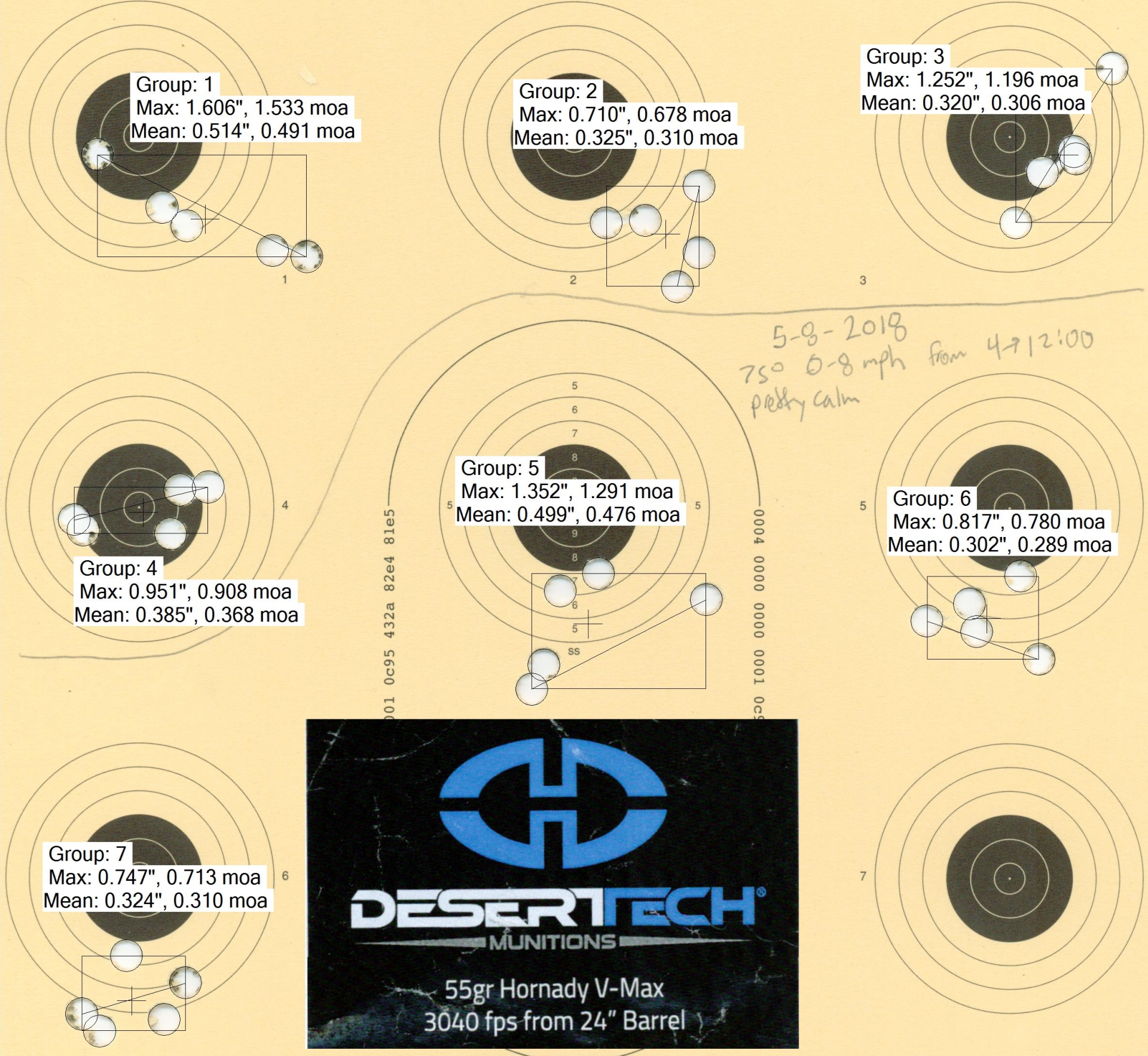

Desert Tech
Desert Tech is another smaller scale U.S. maker. They are probably better known for their rifles, which are totally unique designs that are unusual both in their focus on bull pup configurations and in their easy caliber convertibility. The rifles are quite innovative and have a very good reputation. The ammo has likewise been gaining an excellent reputation, particularly in the 6.5CM caliber which has a .5MOA guarantee. I am doing a review of a rifle in 6.5CM later this year and so contacted Desert Tech primarily for that ammo. Desert Tech was good enough to provide some .223 for this review as well. Their .223 is a much lower cost ammo than the 6.5CM ammo, is a varmint rather than match round, and uses a 55gr crimped Hornady v-max bullet. In practice, the mid priced 55gr varmint round performed pretty well for the cost at just under 1" at 100 yds.
Desert Tech 55gr Hornady V-Max testing w/ Kelbly's Atlas Tactical

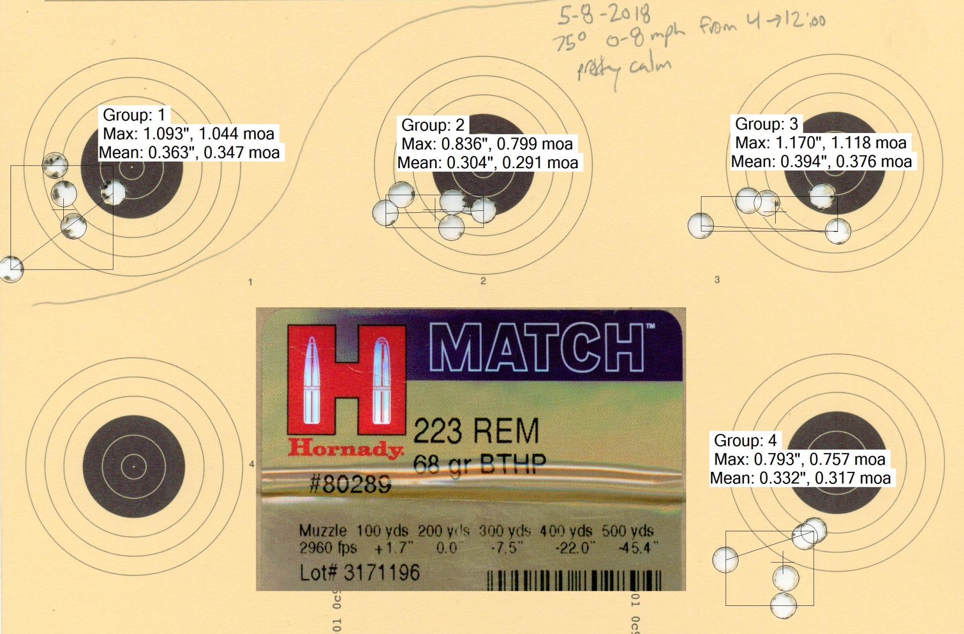

Hornady
Hornady has been making a big push lately into long range precision shooting with their 6.5CM cartridge and the support they offered it at launch by providing high quality, affordable, loaded ammo for it. Hornady has also done a good deal of work on polymer tipped bullets, overcoming the intrinsic accuracy challenges in order to realize aerodynamic advantages. True to its general trend, the Hornady match ammo used here was very affordable at 75 cents a round.
Hornady 80289 68gr testing w/ Kelbly's Atlas Tactical

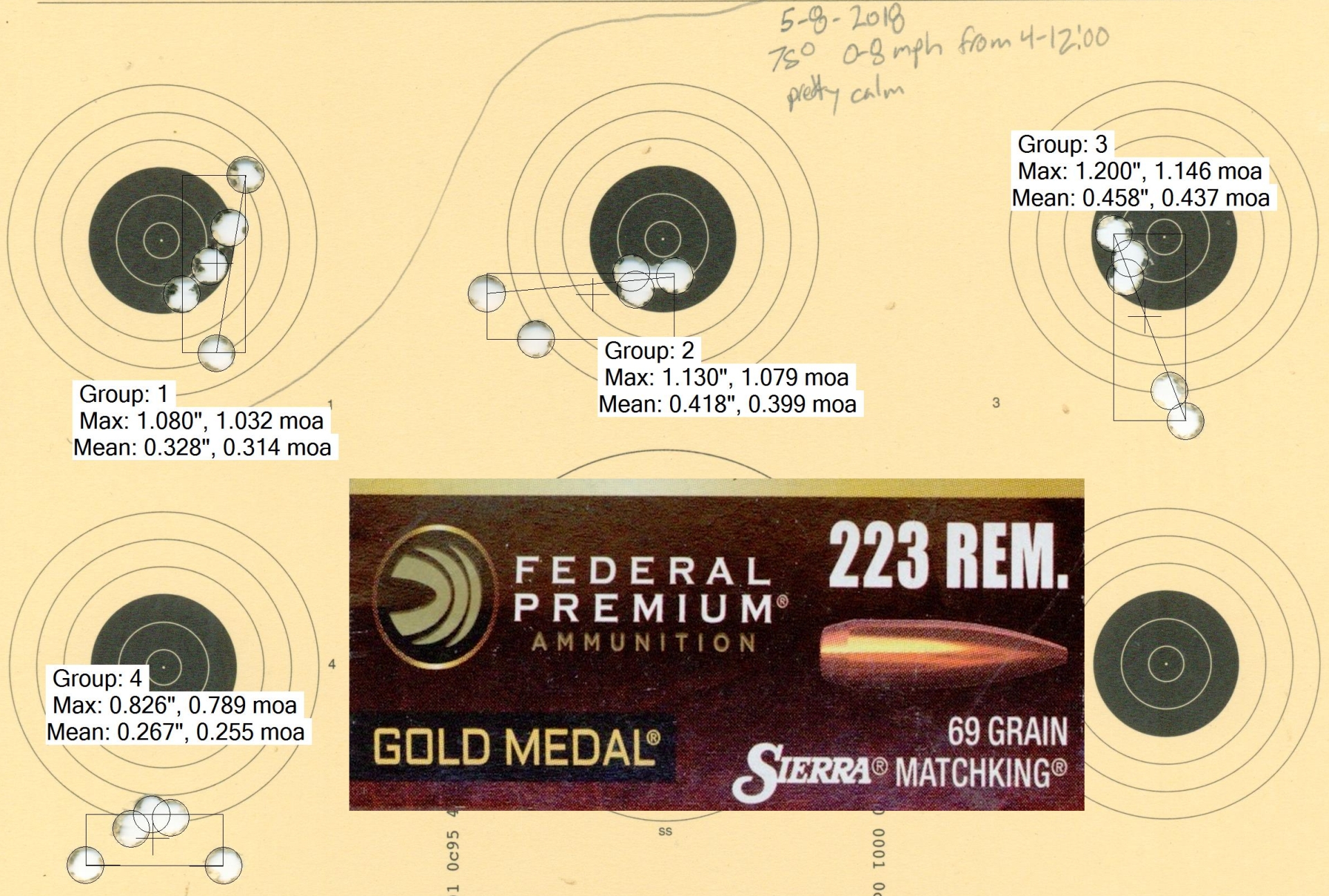

Federal
It was not that long ago that Federal Gold Medal Match was the only "premium" option for most users. There were not many quality factory loads and FGGM was the only one likely to be carried by your local retailer. Of course, a dramatic increase in interest in the shooting sports coupled with the widening of options made possible by the internet has changed all that. Strangely, though advertised as a match round, this ammo featured a sealed and crimped primer pocket. It also neither looked nor performed particularly well being the only ammo to average over 1" groups.
Federal GM222M 69gr SMK testing w/ Kelbly's Atlas Tactical

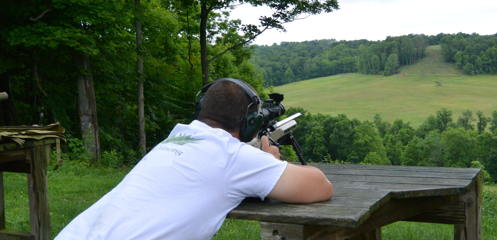

Looking through your scope at a tiny little piece of steel on the other side of the valley, there are so many ways to miss and so few ways to hit. Having all these things to think about can tempt you to doing so. Paradoxically, thinking about all of the things you must do right is also one of the many wrong things so do. To hit with any reliability, you must be focused on just the few things unique to this shot. To get this done, you have to have a lot of confidence in, and comfort with, all equipment and data involved. You need to be certain just how the whole package, rifle, scope, ammunition, and even trigger, are going to behave.
I mention all of this by way of trying to explain the pleasing confident feeling I have had shooting the Kelbly's .223 rifle at range. It is predictable, precise, and comfortable. There are a lot of parts involved in this. My scope is one I have tested and verified. The Lapua ammo is sub .5moa and I have taken good chrono data on it to produce a good chart. I have laser verified the target ranges. Even the trigger break of the Bix'n Andy plays a part and cleanly breaks with the same feel of pressure each time I actuate it from the thick, ugly, wart of a palm swell I have screwed to the stock. The rifle is an important part of all this machinery working together to punish that little 6" plate at 675yds. Yea, I'm enjoying shooting some steel with this rifle.
Punishing a little 6" plate @675yds with the Kelbly's Atlas Tactical

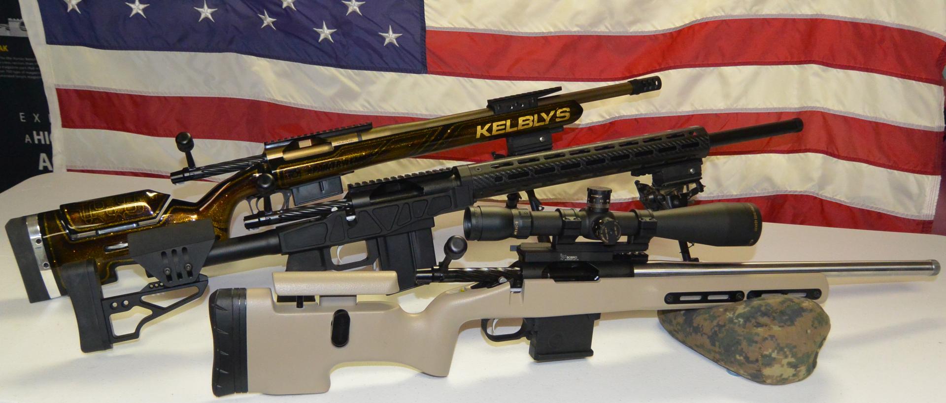

Kelbly's does make a few rifles that are closer to models. These are the NYX, which is an Atlas tactical based rifle in an XLR chassis for $3,300 and the Arcas Tactical, which is an Atlas tactical bedded in Kelbly's KTS composite stock for $4,500. I expect that, now that they are making the Black Bear action, the Arcas rifles will be commonly based on that.
