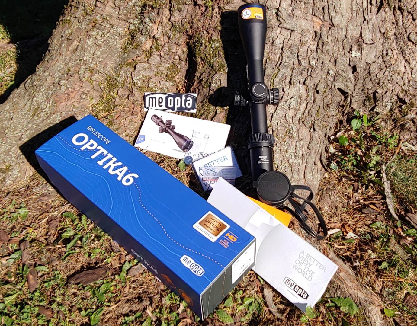

The Meopta MeoPro Optika6 5-30x56 RD FFP comes with a nice scope bra, lens cloth, battery, sticker, hex wrench, some spare screws, and a detachable throw lever that threads into the power change ring. There is also a manual, but it is not particularly useful. It has some stats on the scope's specifications, but it's directions on use are quite minimal and difficult to follow.
I find the Optika6 to be an attractive scope. I am not sure exactly what makes some scopes attractive and others less so, or if there is any universality to what people find good looking in a scope or not. This one looks good to me though. I would describe it as having a softened tactical appearance. This is both figurative and literal in that the knurling on all the controls is rubber and so will not try to strip the flesh from your hands. The stiffness of each knob (paralax, power, diopter, and illumination) is right on. We will discuss elevation and windage adjustments later. Being a 30x 56mm optic with 34mm tube, it is pretty large. It weighs in at 38oz and is 15.4" long.

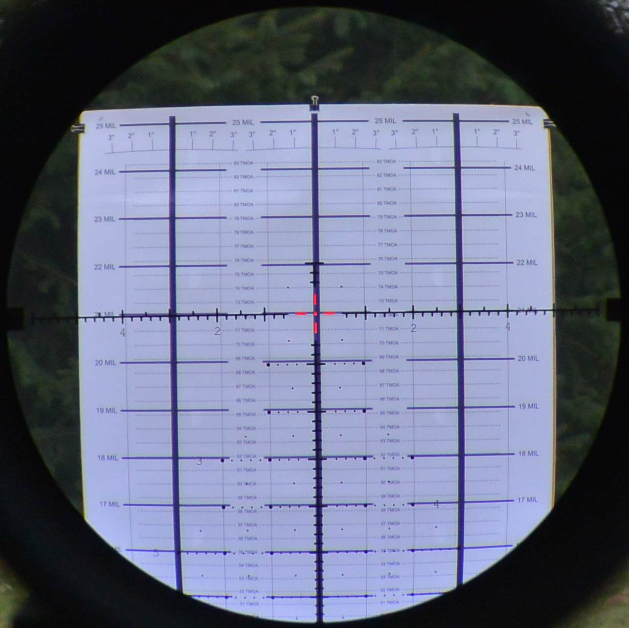

The Meopta Optika6 line comes in several different reticle options. For the 5-30x56, these include a plex reticle, generic BDC with dichro elements, .308 drop reticle, and ILya's MRAD RD. It is a pity the MRAD RD does not have any dichro on it, as I would have liked to try that concept out. That is secondary though. Having a reticle that can hit at range is the important thing, and the MRAD RD is by far the best option for that.
ILya's MRAD RD reticle follows the general trend of .2mil graduated, floating dot center, Christmas tree reticles, but with a few distinctions. The first such distinction is that it only has only 1 mil of graduations in the 12 o'clock sector. I like the open top section as it gives you some space to observe a target area through with no obstructions. The second departure ILya has from the norm is that he does less funny business with graduation increments. Pretty much all the graduations are .2 mil increments and there are .2mil graduations in all sectors of the reticle, including the center. Many other scopes keep changing things up. This causes more mental overhead and more mistakes. I never found myself second guessing what a marking was on ILya's reticle and that is really the goal. Lastly, the line widths used for the graduations and crosshairs on ILya's reticle are significantly smaller than the average. I'm a fan of finer graduations so I will take it. This leaves the reticle very fine indeed at 5x, but at 5x you’re really only using the scope for observation anyway, so I don't see a problem with maximizing the reticles use for 15x and greater.
This brings us to the Christmas tree section. At first I was a big proponent of Christmas tree sections. The concept appealed to me because I really like more utility in a reticle. I thought that trees would make for faster measurement of shot correction, give you a faster way to make corrections in a pinch, and extend your total drop compensation range. In practice though, I have experienced less gain than I expected in these areas, and found a big trade off when it comes to seeing splash. Even when using a reticle with a tree section, I have continued to find it more accurate to measure for shot correction by moving the reticle to get read outs at right angles. Using the tree is both less accurate (big vertical gaps) and only works if your miss lands in the tree section. Not shooting strictly timed competitions (or ones that specifically contrive to disallow adjustment of the scope on some sections) I have found no speed advantage. Finally, most scopes now have adjustment range sufficient to any distance that I am confident of hitting at anyway. I really don't do more than 15mils in drop ever and virtually every scope will give you that on the elevation turret. So, I have become uncertain as to whether or not I want a tree section at all and very certain that if I have one it should be minimal. The section in the MRAD RD is very thin but does have a lot of measurements. There are dots every .2mils and also dots at the .5mil increments between lines. For me it does interfere some in my ability to see splash. Less tree is desired.
In testing, the reticle showed only the smallest deviation from correct dimensions. It starts a little larger than correct and then at about 8 mils crosses back to be very slightly smaller. At no point is it off more than .02 mils. That is to say, it is very good. The reticle is canted only very slightly relative to the adjustments, .03 mils in 10 mils of adjustment, in the counter-clockwise direction. This is also pretty good and of a small enough magnitude that it should not cause any problems.

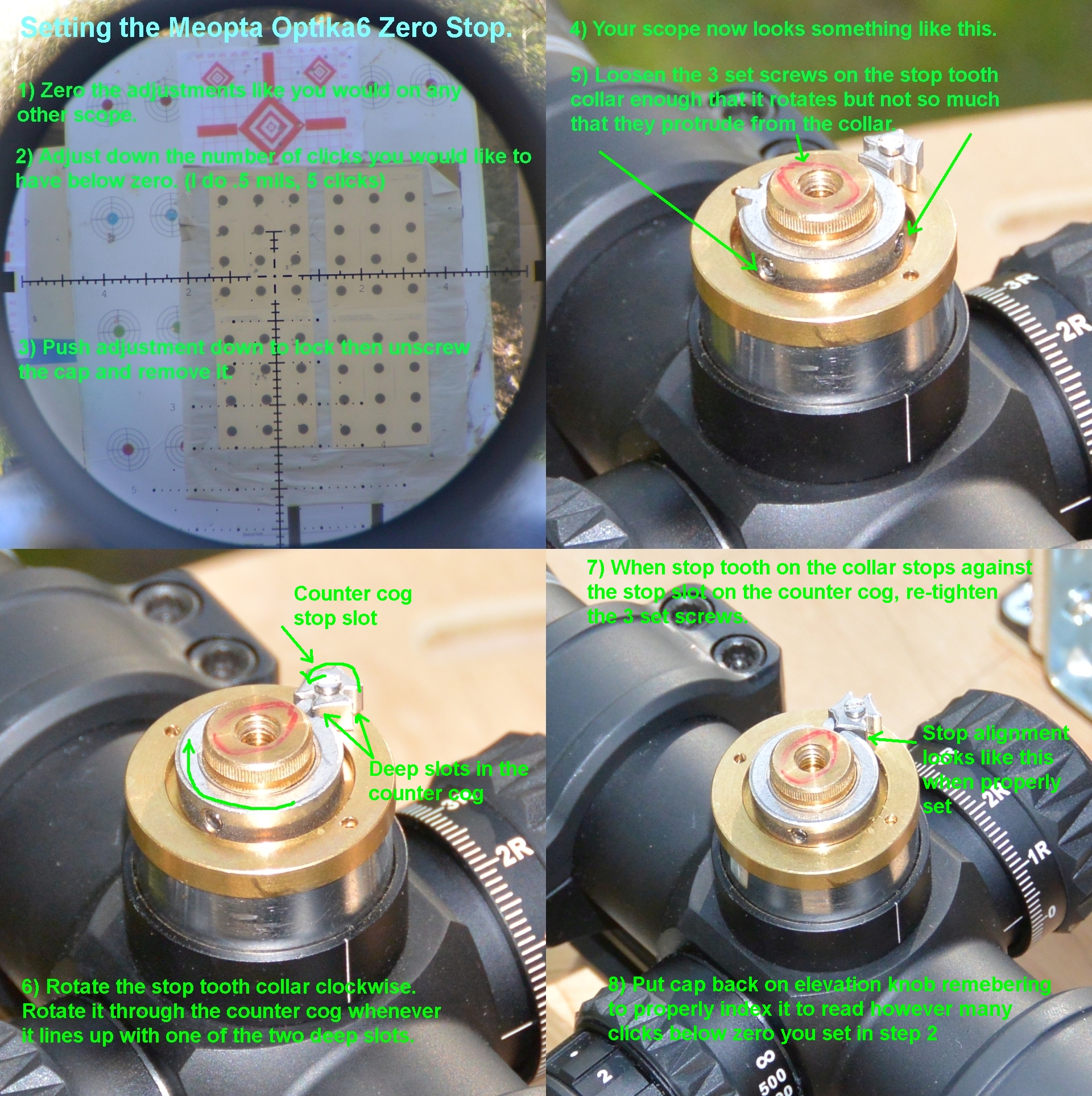

First we will start by talking about the unique the Optika6 has. The elevation pulls up to adjust and pushes down to lock. Oddly, the windage is neither capped nor locking. The zero adjusts on both knobs with the removal of a single screw in the center of the elevation adjustment and then removal and repositioning of the outer sleeve.  Meopta has made this single screw easily removable without tools for the elevation knob which is nice. The windage knob's requires a coin or screwdriver.
The zero stop on the Optika6 scopes is a unique system. I have illustrated how to change it in the illustration below. You will note that, due to its unique cog-based system, use of the zero stop system will limit the maximum elevation range to a little less than three full revolutions. This comes out to somewhere around 28 mils total travel, which is a lot. You also may feel the zero stop cog as you rotate past it moving to your 2nd and 3rd revolutions. It feels sort of like a loose mechanical part. In fact, the first time I felt it I thought something felt loose and broken. Eventually, I realized what it was and that it is not an issue. Really, it is a pretty clever zero stop system and solves the difficulty that adding the locking mechanism to the elevation knob created for making a zero stop system.
Setting the Meopta Optika6 zero stop

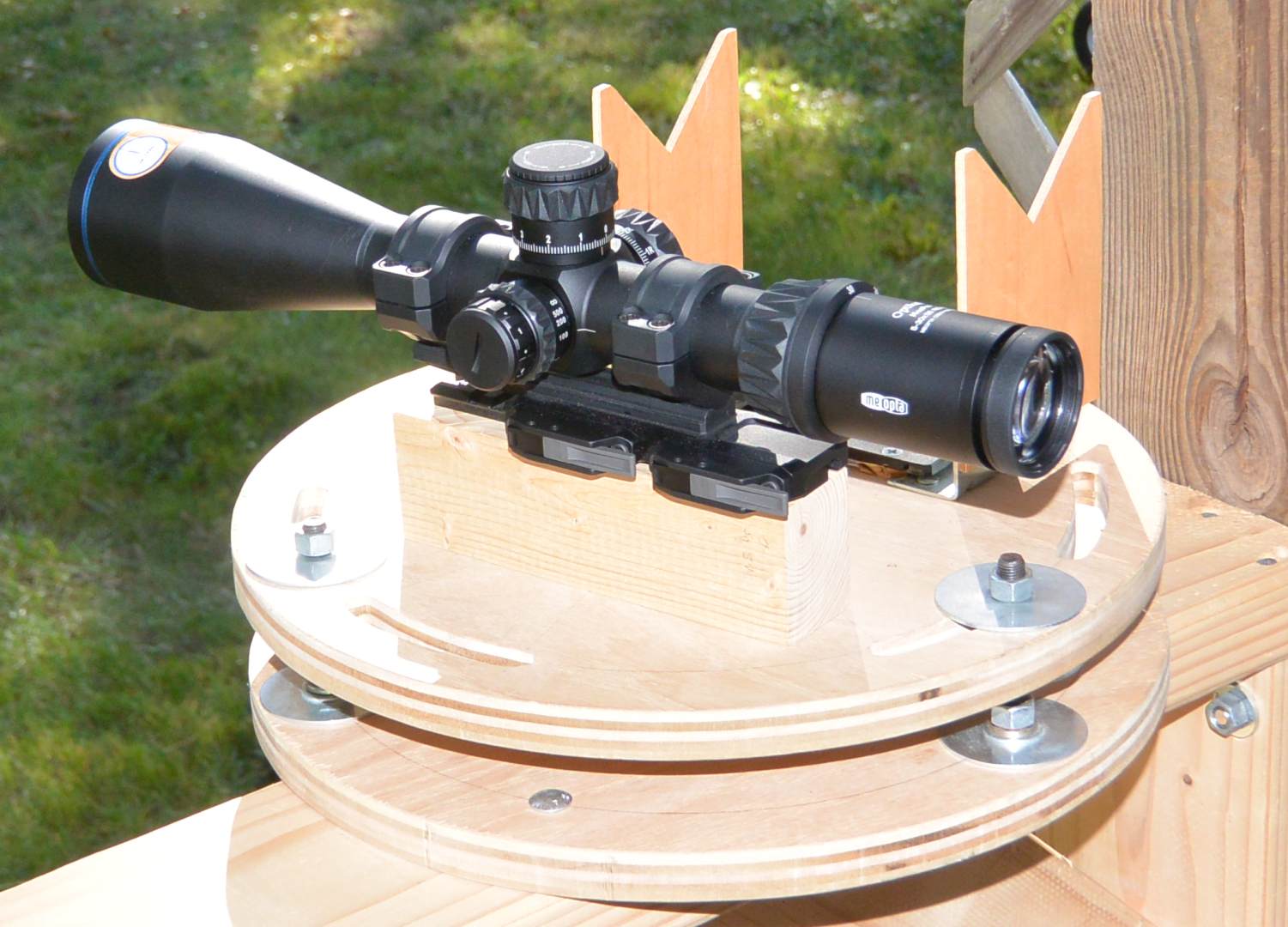

Now on to the tracking. The first thing to note in the tracking of the Meopta is that there is some slop due to the locking turret design. Internally, there is some sort of spline sleeve that allows the outer part of the adjustment mechanism to raise and lower to lock and unlock whereas the inner portion contains the adjustment threading. In this design, the outer portion also contains the click detents. As such, it is the outer portion that you can both see and feel. You cannot see or feel that there is just a little movement in that spline sleeve joint. The effect of this is that there is about .07 mils of slop in the system. So you might adjust up 6.0 mils on the knob and have the reticle at 6.0 mils on target. Then, you reverse and go down to 5.9 mils on the knob but your reticle will be at 5.97, having moved only .03 mils because of the slop. So, whenever you are adjusting up, your adjustments will always read .07 mils higher than when you’re adjusting back. This is a bit annoying, mostly because it means that whenever you reverse direction for a shot adjustment, you get less magnitude of adjustment than you think. I understand this is a common behavior for locking turret designs. The windage, which does not lock, does not display this behavior.
Now for the tracking. Going up from optical zero, the scope tracked clean to 6.0 mils. At that point it starts to loose little by little. At 13.9 mils on the adjustments the scope has optically moved 14.0 mils. It adjusts a total of 15.7 mils up from optical zero. Of course, going back it is +.07 mils reticle position at each knob reading.
Going down from optical zero, the adjustments go to 18.0 mils. Going down they actually look good at that 10 mils but, of course, when you reverse and go back up, the .07 mil slop now makes it look like you’re a click off.
Overall, this means that the adjustments are quite well calibrated, notwithstanding the .07 mil of slop you have because of the locking turret. They are never off by more than .1 mil from what they read. The scope shows a 33.7 mils total elevation adjustment, but remember that the use of the zero stop will limit you to a maximum of about 28 mils.
Going left to right on the windage turret that does not have the locking feature, you notice no slop. It adjusts cleanly for the 4 mils each way I have on the target and has a total range of 17.0 mils right from center and 17.3 mils left.
Testing for lash in the parallax adjustment of scopes is not one of my regular procedures but I noticed it while shooting with this scope so I have fully investigated. For those who don't know, lash in the parallax knob refers to when there is enough slop in linkage inside the scope that adjusts for parallax that it can noticeably shift position under recoil. Important to this is that the movement will only occur if you adjusted one way (typically coming up to your distance from minimum focus distance) and not the other (coming down to your distance from infinity focus distance.) This is because the slop basically represents the internals shifting from one side of their adjustment channel to the other. If they start on the side they would be shifting to, they have nowhere to go. On this Meopta, if you focus up from min distance to your range you will notice that after a number of rounds fired you have gone from zero reticle movement with head bob to about .06 mil of movement because the parallax has shifted a little. There is no shift if you adjusted from infinity down to your range.
To round out the mechanical testing of the Meopta, no reticle shift occurred with change in power, diopter adjustment, or parallax adjustment. So, all good on those tests.
I would say there is a trend to all of the mechanical observations on the Meopta Optika6. That trend is that the mechanisms were all calibrated and working properly but there was a little bit of play in them. Realistically, this is not going to effect the use of the scope for long range shooting or hunting. You won't fire enough rounds at the same range to move the parallax even if it was adjusted the direction that has a little slop. Similarly, the slop in the elevation adjustment due to the locking feature never causes things to be more than .1 mil off. The only way you will notice the slop in these adjustments is if you are testing it on a humbler apparatus such as I did or are shooting many rounds at the same distance.
Meopta Optika6 5-30x56 RD FFP during mechanical testing
