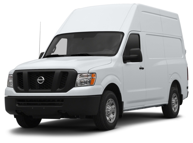

Check out the Nissan RV2500/3500.
The ugliest fucking thing on earth

Nissan is out for no other reason then it is the ugliest damn thing I have ever seen. Ack.

8/11/2013 6:26:25 AM EDT
Pictures are deceiving, these things are huge fucking misshapen eyesores in real life.
I disagree
They are huge fucking misshapen eyesores in the pics too

I disagree
I disagree
I can deal with the ugliness for $12,000 dollars less on the sticker price plus cheaper maintenance.
8/11/2013 8:37:58 AM EDT
I've seen them on the road here. Basically a Titan front end grafted to a van. I'd buy one. Plus one comment I read made sense. The engine is out front, meaning more rom in the cab, and a large engine bay is easier to work on instead of having the engine buried in the dash.
8/11/2013 8:50:52 AM EDT
It is too bad they missed the styling mark. The concept is great. I loathed working on the E150, the engine was completely under the dash. Chevy was a tad better. Taking the doghouse off on the ford got you to the bellhousing, thats about it. Having the engine in the front is a cool idea.
Perhaps a revised version will be a home run. Bones are good from what I have heard, just sooo damn ugly.
8/11/2013 9:13:26 AM EDT
Actually, the pictures convey their barfitude quite nicely.
