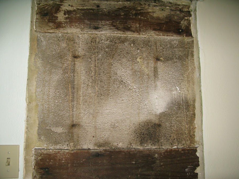

I am working on a kitchen in a rental property of mine that was built in 1956.
The wall material has me baffled. It has the consistency of plaster in spots, cracks like plaster from the house settling, but in the kitchen it looks like concrete. I am trying to identify what it is, and hopefully it doesn't have to much asbestos in it.
This was behind a wall cabinet.
Overview of kitchen. Notice around the drain it looks like a concrete patch.

Looks like mortar and lath
This would be my guess.

Maybe a plaster over a button board with fir strips for the cabinets. Just a guess. I would definitely be concerned about asbestos. And get rid of that soffit

Could it possibly be brownish scratch coat plaster without the final white plaster finish coats?
Around the pipe is almost certainly a Quik-Patch repair from when the trap and drain were replaced.

Button board with out finish coat is my guess.
My kitchen has the same setup with the boards for nailing cabinets to walls.
Could be gypsum lath? Some of my house has what looks like rough cement board that was plastered over. It's more
Crumbly then cement board and has a expanded metal mesh running through It.
The country on a whole wasn't really standardized with how things were done untill the 60s. Before that a lot of building techniques were regional. Way more then they kinda still are. Started in on the coasts in the 50s and worked its way into the midwest. Deepening on where your at your walls may be from what most would consider an older technique.
As an example my house was wired with knob and tube and it was built in 1940.  I have yet to find a single resource that stays K&T was used past the mid 20s.
