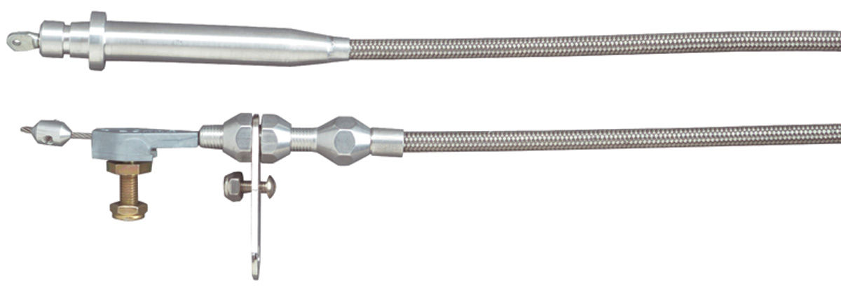

Update. TH400 and transfer case are in. It took all day but we finally got it. It was a trial and error day, lots of error. I may have to have thr exhaust done as I think it's going to hit the transfer case when it's all said and done.
Tomorrow we will finish drilling the holes for the tcase mount,  and getting it secure.
I do need to figure out what I need in regards to the kickdown cable. I also need to figure out what wires need to be hooked up. There were two that went to the old trans.

The steering column is in, the neutral safety switch is also installed. It took me a bit to figure out the wiring for that one but after I got it done, it wasn't that bad of a job.
The dash and steering column are back together.
Lokar transmission linkage is installed.
The Lokar kick-down cable is mounted on the side of the transmission and wires have been run to the appropriate places.

Hookup Lokar kick-down system.

If you're working with the stainless "rope" such as what's in bike cable sheaths when not hydraulic, the only thing there is either casting lead onto it like a lawnmower throttle catch, or a crimp.
We used the crimps to put the keys to a car locked around steering column so they couldn't get lost.  Something like this, but the cutters were the expensive bit, Klein double joint ones to get a clean nip of the cable then the aluminum ferrule to put on and loop back and a zig-zag tight crimp so it couldn't be pulled out of the crimped ferrule.
I suppose you could just crimp a ferrule on without looping it back to finish the end but I don't know how that would effect it.  This is just what I found on Amazon to give you idea of what I'm referring to, the higher quality in the second two are closer to what we use since getting a good crimp needs the high leverage pliers and the cutters are the most important bit to not chew up the wire when trying to make a clean cut.

There's some details on that with a certain flux and lead mix as well as not pure stainless wire rope.  I guess you're not aware of what it is since it came at a length/mount.   Meantime could use  one of the little bolt on "u bolts" that you can crank down on for a stop, I'm not sure if you're needing to use the end of the wire or looking for a decoration on it to make it seem neat.
The crimpers and bits are cheap enough, relatively, by using a Dremel cutoff wheel to get a clean end.

The end of the cable does have a crimp nut at the end of the cable, I just want to keep an extra few inches of the cable past it from unwinding.
https://www.opgi.com/product/image/OP/170174/kickdown-cable-th350-lokar-brushed-ch27221.jpg

Small diameter heat shrink, white or black, depending on background desired, about 3/4" plus another 1/4" off the end makes a nice taper and stops it from unwinding if it doesn't have to hold anything other than the springy rope intact and not unwinding ugly (not to be used as a stop/attachment/lever/etc)

OOH! Good call on the heat shrink. Why didn't I think of that???

I only know of it because somebody suggested it to me when faced with same problem.
I was just crimping two of the loopbacks one after the other, one to set the length and loop, then another with the end just halfway crimped into a second connector to hide that end.    Heat shrink instead made it more streamlined in addition to saving a dime a cable when doing one for every car coming on the lot (parts cars).
I guess "Heat shrink" is only associated with copper wire for most of us, so those pretty obvious solutions don't pop to top of head, kind of like the youtube "120 life hacks in 5 minutes" video tips where using something in a  totally obvious but unintuitive way makes a light bulb go on.

There are not really any electronics. I do have a lokar kick-down cable hooked up to the transmission. The cable was adjusted per the instructions.
