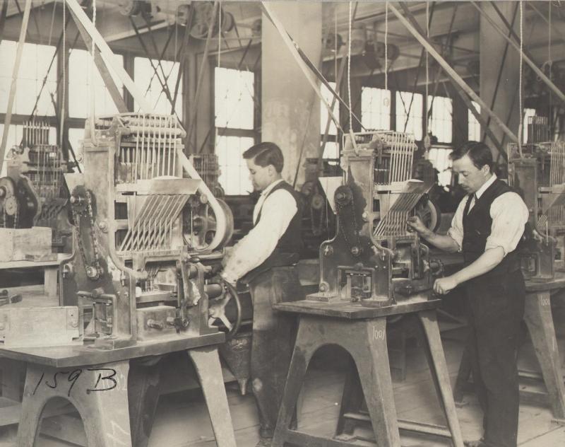

Quoted: Edison Historic Site in New Jersey: http://www.nps.gov/common/uploads/photogallery/ner/park/edis/8AD6238D-155D-451F-678D4811F63B4CE1/8AD6238D-155D-451F-678D4811F63B4CE1-large.jpg The driving shaft is up at the ceiling. Quoted: Quoted: one of those wheels was hooked by a belt to some kind of drive device, steam, water, dog on a treadmill, whatever the rest of the wheels feed relays of belts to drive stuff, like mills, lathes, fans, grinders, whatever they needed to drive im not sure where you are in ga, but they have an example of an old school one at the savannah train museum that ran the entire metal fab and wood working shop via steam power Edison Historic Site in New Jersey: http://www.nps.gov/common/uploads/photogallery/ner/park/edis/8AD6238D-155D-451F-678D4811F63B4CE1/8AD6238D-155D-451F-678D4811F63B4CE1-large.jpg The driving shaft is up at the ceiling. Just like the original Boeing factory: |
