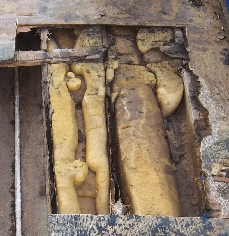

This is what you need to be aware of and figure out if it affects your boat.  My floor was soft and rotten.  When I cut it up I found that the stringers had rotten away too.  Had the stringers been in good shape I could have glued new plywood down and put a layer of fiberglass over it to protect it.
http://www.afterhourtechs.com/boat/rot.jpg
The stringers in a Chieftan are aluminum. They are beefed up around the hold with wood to secure the engine mounts.
I removed the foam flotaion in mine and left it out. That stuff just turns into a giant sponge and weighs the boat down.
Hot coated all the wood and then painted over it.
