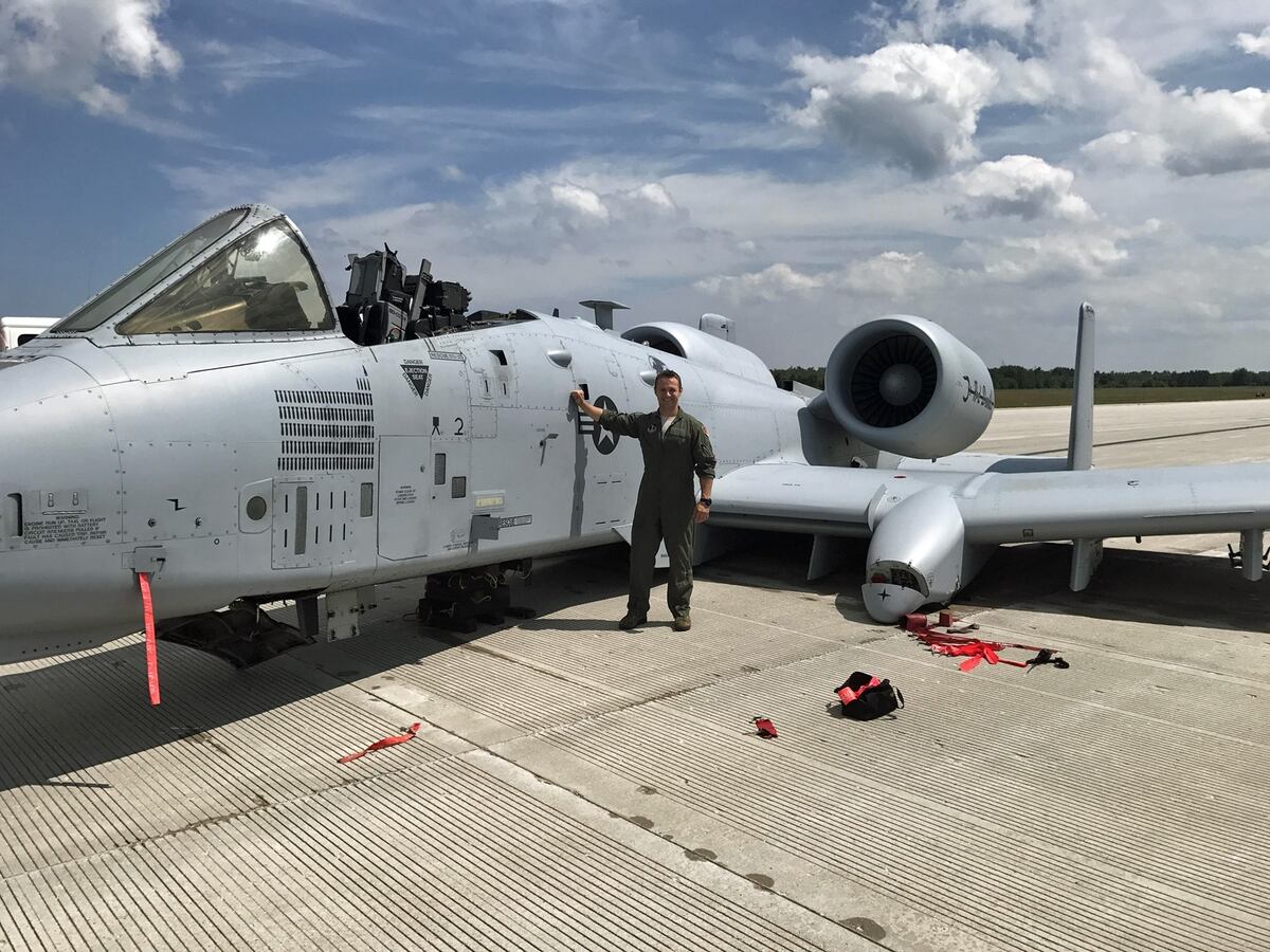

Apparently, the gun kaboomed bigly.
http://www.airforcetimes.com/news/your-military/2017/08/15/air-force-capt-lands-a-10-with-no-canopy-no-gear/
WASHINGTON  Capt. Brett DeVries was 150 feet off the ground on a strafing run when the 30 mm gun of his A-10 misfired at the same moment the entire canopy of his aircraft blew off.
DeVries, a pilot with the 107th Fighter Squadron of the Michigan Air National Guard was training July 20 with wingman Maj. Shannon Vickers and two other A-10s over Michigans Grayling Air Gunnery Range. DeVries was in the middle of his second run when a donut of gas enveloped DeVries gun and aircraft.

I'm wondering how it blew off the canopy without blowing his ear drums.  Maybe it set off the charge that blows it?
Link Posted: 8/16/2017 8:01:22 AM EST
The external canopy jettison handle is adjacent to the gun drum area.  I suspect when the gun system malfunctioned it took out the hot gas initiator as well.  Only logical explanation to me.  First I have heard of it ever happening.  I suspect there will be a TCTO in the near future to keep that from happening again.

It sounds like the equipment on the aircraft was poorly maintained, and not inspected properly
Link Posted: 8/17/2017 1:38:58 AM EST
That's a bit of a leap.  Sometimes stuff breaks.  It could have been a bad round, or any of probably 20 other things.

A-10 gun systems are meticulously maintained. They have a strict maintenance schedule.  By its very nature the GAU-8 is controlled chaos. Considering it fires at 3,900 rounds per minute and is powered by two 3,000 PSI hydraulic systems its amazing that it doesn't self destruct more often than it does.  Sometimes shit happens, mechanical stuff breaks. In this case it was dramatic and it took out a few other systems in the process (Nose gear and the canopy jettison system).  I remember as a young airman, an A-10 came back from a training sortie with a gun light indicating a failure.  The weapons load crew popped open one of the quick release panels and about a dozen unfired rounds dropped out and bounced on the ramp (one of the feed chutes had ruptured).  People scattered, and for good reason.  The 30mm is percussion and electrically primed unlike the Vulcan 20mm rounds which are electrically primed only.  I have seen my fair share of "learning" experiences that can be attributed to the A-10 gun system.  Some caused no grief, one was seriously gruesome. A weapons loader lost all the fingers on one hand when they got in the way of the feed system during an ops check.  That's how Warnings, Cautions and Notes make it in the Technical Orders.

For sure. If you look at one with the gear up, you will notice that roughly the bottom third of the tires are exposed. It was designed for a gear up landing.
