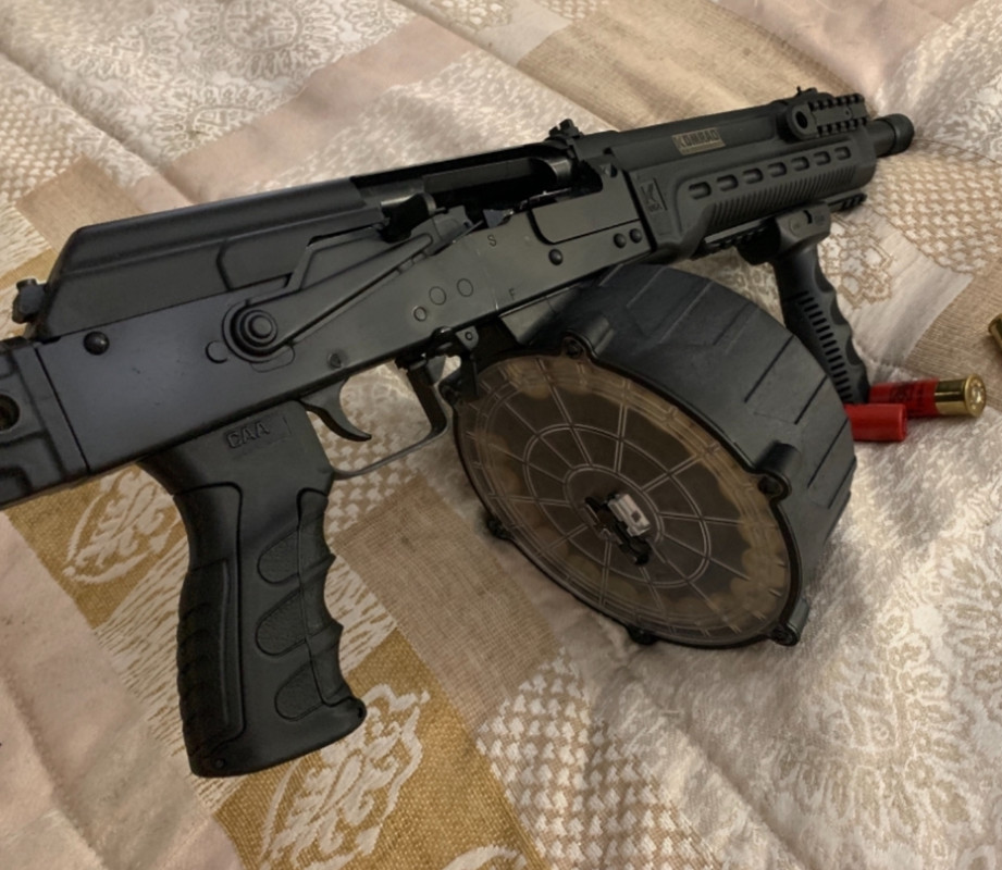

Yeah I went with a Komrad with 12" barrel. Form 1 SBS. Removed the pistol brace and installed a side folding stock. Did need to polish the bolt and hammer and feed ramp. Installed an adjustable gas system. Now it runs very reliable even with cheap birdshot. Before it would only run with higher pressure loads. The 20 round drum is awesome!!
https://i.postimg.cc/gcS6Kbnh/IMG-8619.jpg
Nice!  Another vote for the KUSA Komrad-12.
