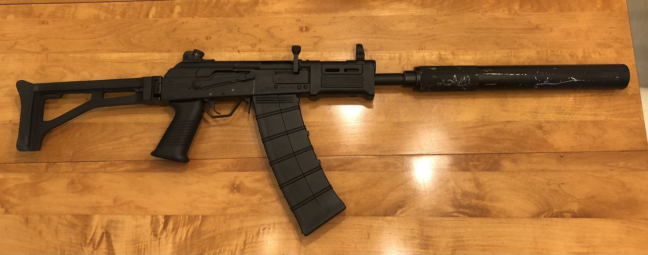

I didn't find it to be a very difficult conversion process, when I did this one about...  20 years ago.
Now I feel old.
I kid you not - I pulled this out of the safe the other day and the red dot still worked on the original battery.

https://www.ar15.com/media/mediaFiles/60523/saigasbs002-3626798.jpg
@kallnojoy
What length is that?
Gas system looks stock?

I picked up a Chinese Lynx 12 that is a Saiga clone. Mine works fantastically at emptying out my collection of 12 gauge ammo.
https://www.ar15.com/media/mediaFiles/41568/Lynx_12_folder_JPG-3626488.jpg
https://www.ar15.com/media/mediaFiles/41568/Lynx_12-3626489.jpg
I considered buying one of those but had heard some bad reviews.....how is yours ?

I have a Saiga, Lynx and VEPR as well as many other shotguns - The Lynx is fine.  It always works.  I can't think of any problem with it.  Not sure if the steel is as good as a Saiga - but seems fine.  Thinking of SBS'ing it come January along with some others like a JTS AR12.
9/19/2025 9:58:58 PM EDT
I also missed out on the Saiga 12's.
Mine has been great, and other than a different stock and forearm, is factory. I've ran slugs, buckshot, the cheapest game loads I could find locally, and it has functioned fine with everything. Not an especially large number of rounds, but I think enough to clear up and break-in it might have needed. I paid $400 for it several years ago through Bud's, and as reliable as it has been, I think it was a good deal at that price. I haven't noticed any weakness in any of the metal, bolt lugs, or anything else that would make you think anything was soft and prone to wear out fast.
The only minor issue I ever had was mag-related. There was a decent amount of flashing on the follower, and a bit inside the mag itself, where the mold seams come together, but cleaning them up with scraping with an Xacto knife and sanding with fine wet-or-dry cleaned it right up. Works fine now.
Mine eats everything - low brass and high brass. Plus uses all Saiga mags. It has an adjustable gas plug that I have never adjusted. It does kick though.
