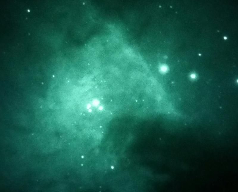

Here is my report and pics of Orion from a few nights back.
Sky Conditions - Very transparent, but a lot of turbulence due to a storm that just passed a few days earlier. - City sky glow Location - Southern Kalifornia - Elevation at location, 2100ft. - Temp - 52deg F - Humidity - 20% - Time of Night - 2130hrs Equipment Used - Celestron C11 CPC Series - 11" (279mm) Aperture - Focal Length - 2800 f/10 ***1764mm f/6.3 reducer not used in this session*** - Alignment Method - 2 Star - 40mm Tele Vue Plossl (1.25" adapter used with Tele Vue 2" Star Diagonal) - 21mm Tele Vue ETHOS - Tele Vue Proto PVS-14 Objective Lens Adapter - TNV-14 installed with L3 Mil Spec Omni 8 White Phosphor Filmless - 38.2 S/N - 82LP - .8 EBI - 2563 Photocathode - Galaxy S7 Edge on-board camera - Tele Vue FoneMate No narrow band H-a filters were used in these shots below of M42 Orion Nebula. The views below are in no way represented on how good the native eye through the eyepiece looked. It was stunning. No special doctoring of the photo's where attempted, nor any photoshop work. These are the raw images from the Galaxy S7. The gain was turned down on the 21mm ETHOS pics to mitigate some scintillation. The 40mm Plossl, the gain was full up and a bit nosier as you can see. 40mm Tele Vue Plossl ![]() 21mm Tele Vue ETHOS ![]() |

Really good stuff Vic!
I haven't seen too many photos that come close to replicating the actual eyepiece view. One guy that goes by JDB_Astro on Youtube has published a few processed photos that are very close to what the eyeball actually sees as opposed to the camera. I've thought about trying the stacking technique to process photos but this NOD astronomy is too new to me and I can't tear myself away from the views long enough to do any serious photography. |

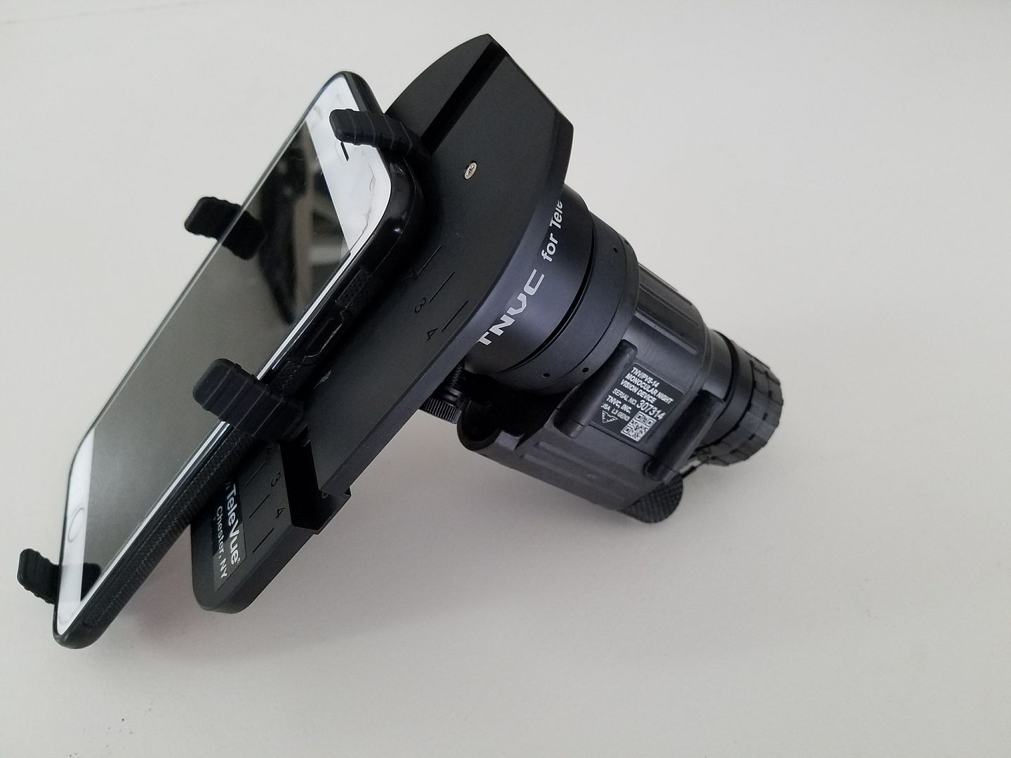

Here is a recent Florida Star Party in the Keys with a video of our L3 TNV-14 White Phosphor Al Nagler was using with this users 32-inch, f3.6 Dobsonian telescope. Obviously the real time views of this EP were so MUCH better than what the Vid shows, but still pretty cool all the detail that is seen that cannot be seen naked eye though the scope without any light amplification. Enjoy...
![]() Tele Vue at the 2017 Winter Star Party: FoneMate with Image Intensifier |

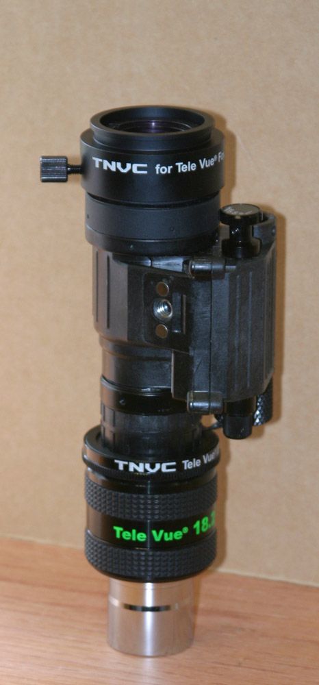

Tele Vue and TNVC telescope adapter will be realessed at the end of this month. Price will be announced in a few weeks. Thanks guys.

We are getting very close. Everything is complete, we should have the new adpaters up on our web site by this weekend with final pricing etc. We are VERY pleased how this turned out in the form fit and function arena. Enjoy some of the new pics.
This is the PVS-14 objective eyepiece ring, The thread side threads directly to the PVS-14 lens and the other securely clamps to the telescope eye piece. ![]() ![]() This is the PVS-14 rear ocular adapter that allows the use of Tele Vue's FoneMate which I feel is the best smart phone adapter to date that allows for just about any smart phone out there. Androids, I-Phones, etc. The adapter has a brass compression ring insert that allows the adapter to clamp down on the rear diopter ring without marring and still allows for diopter adjustment while the adapter is in place! ![]() ![]() ![]() ![]() ![]() The FoneMate/Adapter will also be sold separately as well to fill a niche for all those stand alone PVS-14 owners out there! More to come... |

Now live and available HERE.
