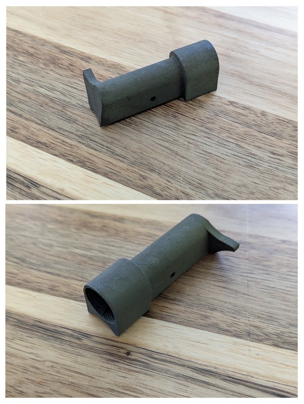

Originally Posted By 7insert: Absolutely the case, especially with the reduced locking piece and an upgraded spring you should be installing first. Couple thousand live and blanks with that setup so far and no signs of dents/things coming apart. Is this the one you’re talking about? Or the bigger one that comes in the SG/1 stock? Attached File |
Originally Posted By 7insert: Nothing for scale there but yes that looks like an oldschool G3 heavy buffer FWIW there are newer heavy buffers can be found in the same format as a standard length G3 buffer. HK Parts new production heavy buffers, bill springfield and DPM Systems of greece all produce small heavy buffers. https://www.hkpro.com/attachments/img_2588-jpeg.432133/ https://www.dpmsystems.com/en-gb/heckler-koch-g3-buffer-assembly So I asked my buddy to look through his email. They’re HK made MSG-90 buffers. I’m still going to use it. Anything is better than the buffer currently in the gun (original FMP that does still have give….but not much travel at all. |
