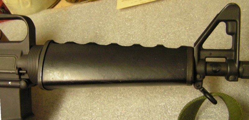

Standard handguard cap:
Handguard cap with M203 clearance cuts. Pictured is a early variation on a 727:
Regular production handguard cap with M203 clearance cuts. These were used on later 723 Carbines, and on the 727 and M4 series.

The forward M203 cut out on 700 series Carbine and the M4/A1 are a bit different. The angle slopping into the cut out is sharper 700 series Carbines. Model 727 on top, and M4/A1 on bottom:
607 handguards, note the rear handguard cap (photo by Ordnance):
Handguards, 600 and 700 series on left (excluding the 607), early M4/A1 in the middle, and late M4/A1 on the right. Early M4/A1 handguards are double heat shield, and late (1999 on) M4/A1 handguards have glued in double heatshields and are more matte.

I've been promising Ekie for a while that I'd post some photos of the 607 in the Oregon Military Musuem collection. Actually, I really don't like that factory model number and prefer the Military designation, GX-5857. This SMG is in about new condition and is left over from the 1960s Infantry Board tests at Fort Benning.
Sorry the images aren't a bit better but conditions weren't too favorable in the vault for quality photography. Hopefully, some will be adequate to add to the variation guide.
http://photos.imageevent.com/ricklarson/gunparts/large/GX5857%20markings%202.jpg
Handguards. It's not that apparent from the photo, but I think the gage of the sheet steel used in the rear retainer ring is heavier than what is normally seen in the reproductions. Not by much but maybe .010 or .015. I'll try to verify that later.
http://photos.imageevent.com/ricklarson/gunparts/large/GX5857handguards.jpg
Barrel markings. Note that the barrel is new enough that the dab of black paint is still present to cover the bare metal in the proofs.
http://photos.imageevent.com/ricklarson/gunparts/large/GX5857%20barrel%20marks%202.jpg
Suppressor
http://photos.imageevent.com/ricklarson/gunparts/large/GX5857suppressor.jpg
Better view of the receiver markings.
http://photos.imageevent.com/ricklarson/gunparts/large/GX5857%20left%20side%202.jpg
Stock
http://photos.imageevent.com/ricklarson/gunparts/large/GX5857%20butttstock%20front.jpg
http://photos.imageevent.com/ricklarson/gunparts/large/GX5857%20buttstock%20front%202.jpg
Buttplate and latch.
http://photos.imageevent.com/ricklarson/gunparts/large/GX5857%20buttstock.jpg
