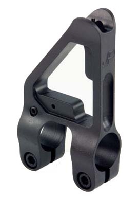

i want to replace it with something like this.
http://www.bravocompanyusa.com/v/vspfiles/photos/JPGS-2FS-2.jpg

The site that you had pictured is a clamp-on site, and would simply tighten those two screws on the side, to clamp it down...
