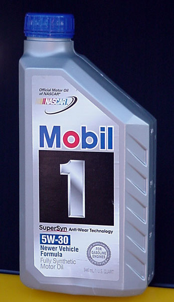

This is what you save over the life of a rifle if you shell out the cash for a pissedin upper. I'll just spend the $6 on the oil. I might even shell out more for some fancy space age gun oil, but pistons belong in commie guns and internal combustion engines.
Link Posted: 1/22/2010 4:10:49 PM EDT
http://www.wildtoys.com/vehicross/VX_Mods/ModsMobilOne_600.jpg
and m1a's
No i never got the piston ar thing.  theres aks, g36's, ect.  if i want an ar its gonna be di....
