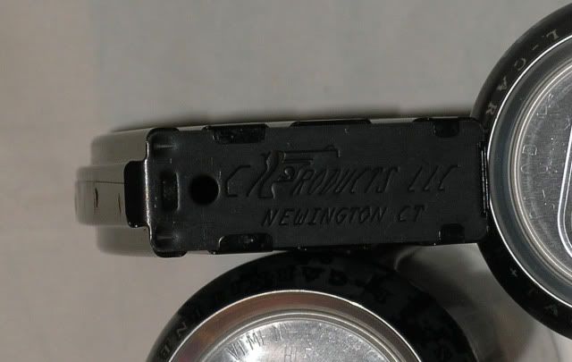

[span style='font-size: 12pt;']CProducts[span style='font-size: 12pt;'] [/span][/span][span style='font-size: 12pt;']AL[/span]
Capacity: 30
Follower: Grey polymer no-tilt
Body: Aluminum
Disassembly: USGI-style
Weight: 113.1grams
MSRP: $12.50
Looks just like a USGI magazine, except with black Teflon.
Base plate, also aluminum. "CPRODUCTS LLC NEWINGTON CT".
