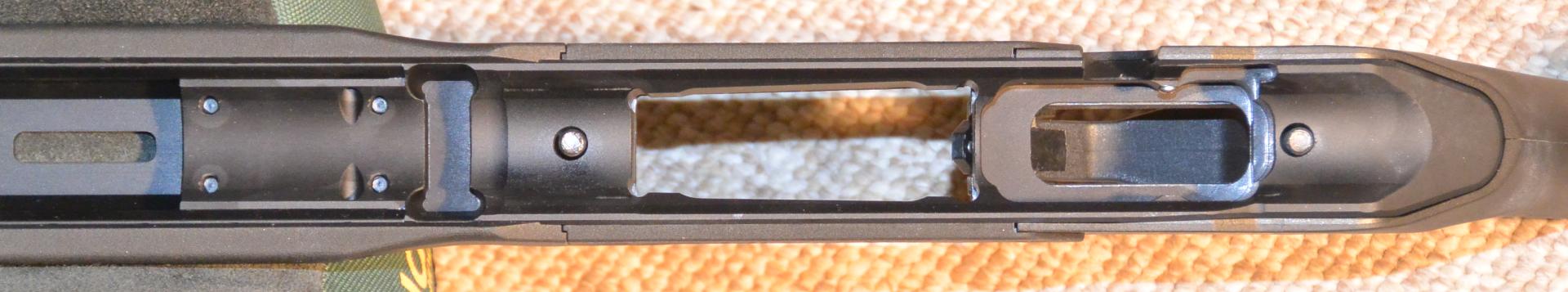

The Chassis itself looks very clean. The plastic moldings have good definition and the color on all the plastic moldings and the cerakoted aluminum match. The inlet for the action is massive and, I expect, will accommodate any Rem-Clone with or without trigger hanger, oversized trigger, or thick-ass recoil lug. The stock also does not come up to the ejection port, so receivers with a longer port will not have a problem either.
The very roomy MDT XRS factory inletting should accommodate about any Rem-Clone action.

The XRS’s captive action screws are a feature that sounded nice initially but were one of the few things lacking in execution. In practice, the slot you have to fit your 3/16" hex wrench though is basically no wider than the wrench and very deep. The bit you are probably using on your torque wrench is not near long enough and a normal extension is too wide. The slot is too deep even to use on the shorter, higher torque, end of simple “L” shaped hex wrenches, if you were willing to just forgo using a torque wrench. I did not actually have a suitable tool to apply 65 in-lbs to a fastener so located and you probably don't either. Realistically, this leaves three choices. You can Dremel out the plastic around the holes so you can fit your extension in to use normal bits on the action screws in which case your action screws are no longer captive and your new stock looks a bit buggered. You can order a custom very long and thin 3/16" hex bit. Or, you can cut the “L” bend off of a simple hex wrench and couple what remains with a 3/16" socket, 1/4" socket to 1/4" hex adapter, and then to your torque wrench. In other words, you can make the custom bit. I did that, and it really seemed to be a lot to have to go through just to be able to screw in the action. If your company is going to require such an unusually dimensioned tool to interface with your stock, you should really just include the bit.
