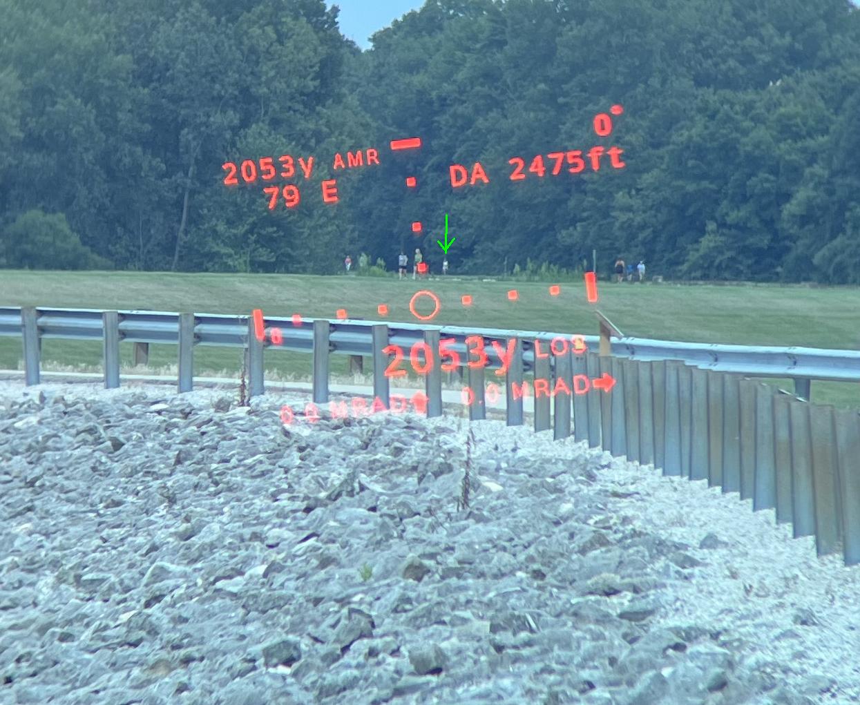

Aligning the reticle on the Sig Kilo 10K-ABS HD rangefinding binoculars in the BDX software using a rectangular industrial light for the target

As with every other range finding bino I have encountered, the rangefinding display in the 10ks is in the right barrel only. This display is quite complete. As pictured below, you can see that the pre-range main display includes the bearing, density altitude, reticle, ballistic profile loaded, target mode, wind setting, and battery remaining. The screen brought up after ranging is equally complete and includes angle modified range, inclination, bearing, density altitude, reticle, yards to target, drop, windage hold, velocity of the round at target, and energy of the round at target. This incredibly complete HUD is made possible by Sig's unique 304 x 256 pixel AMOLED screen. I should note that originally I thought the display in my test binoculars was canted a couple degrees counterclockwise. You will note that it appears so in all of my images. This is because I have a giant head. The display is leveled for the average, 66mm inter-pupillary distance. Mine is 75mm and adjusting for this tilts the display. This is more noticeable in the Sig than in other binos because it features long lines of straight text and also a reticle with a crosshair. There are no functional impairments resulting from this melon head induced display cant. Sig's pixel-based display makes possible the excellent onboard menu system which does not need to use obscure three letter acronyms you will inevitably forget for everything. The menu makes it easy to utilize the binoculars without being connected to the BDX application in the field. This is even so when needing to use multiple ballistic profiles, as the binoculars have the memory to store thirty profiles. The displays and menu system are simply excellent. Remember this when we get to the blue tint in the optics section. All things in optics are tradeoffs.
Sig Kilo 10K-ABS HD ranging a person at >2k yards

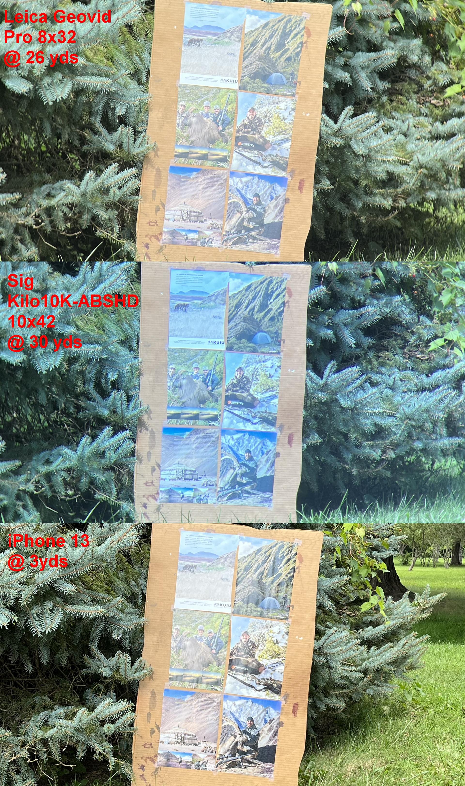

So, just how blue is the blue tint? I've actually had a good bit of difficulty coming up with a set of photos that I think fairly represents this. The below combined image was actually the result of my fifth attempt at such a comparison shot. The earlier attempts all proved either too overwhelmingly blue, or not enough blue to give what I considered an accurate impression. As you can see, I eventually opted for a synthetic photo montage subject with a natural backdrop. Generally, you notice the blue most with light solid color backdrops or against sky and notice it less when viewing darker and more varied color natural objects. The reticle alignment photo early on for instance, looks really blue. The Great Blue heron photo above does not seem tinted at all though. Hopefully, by providing this range of different photos I will have done a good job of conveying the impression of actual use as well as possible.
A Hunting Photo Montage through the Sig Kilo 10k-ABS HD 10x42 Binoculars Contrasted with the same shot through no optic and the Leica Geovid Pro 8x32 Binoculars
To test the optics of the Sig Kilo 10k-ABS HD 10x42 rangefinding binoculars I compared them side by side with Zeiss Conquest 10x42, Vortex Diamondback HD 10x42, Vortex Fury 5000 10x42, and Leica Geovid Pro 8x32 binoculars. I really wasn'tsure where the Sigs were going to land in terms of optical performance because the tint was unusual enough I didn't really trust my initial impressions, so I cast a wide net. Shout out to the good folks at Cabela's for allowing me to set up some optical testing instruments outside of their store to facilitate this. It turns out, I was right to suspect those impressions as the 10ks performed better than I thought. One other note, I suspect that particular pair of Vortex Furry 5000s were not collimated as well as they should be:  Both eyes weren't syncing up as easily as they should be with that pair and I felt some strain and discomfort with substantial time behind them. Take the comparison between them and the Sigs with that caveat. This was frustrating, as it ended up the most important comparison and I don't completely trust it.
Optical testing with the Sig Kilo 10k-ABS HD 10x42 and the Zeiss Conquest 10x42 with the help of the good folks at Cabela's
Obviously, there is a good deal of difference in the optics I was comparing in terms of price, and because three of them are also rangefinders whereas two are only binos. Lastly, the Geovids are 8x32s instead of 10x42s. Unsurprisingly, given the huge price range, there was a good bit of difference in performance and some clear brackets. Setting aside the blue color of the Sigs for the purposes of comparing other aspects, the Leicas are better than the Zeiss Conquests, which are a little better than the close-running Sig Kilo 10ks and Vortex fury 5000s, which are both substantially better than the budget Diamondback HDs.
Looking up from the Sigs, the Conquests were really just a bit better in just about every aspect. Resolution, DoF, chromatic aberration, FoV, and edge-to-edge clarity were all just a bit better on the Zeiss than the Sig 10ks. When compared to the closest competitor, the Vortex Furry 5000s, the Sigs had substantially less chromatic aberration, a slight advantage in edgetoedge performance, an even slighter edge in resolution, the same FoV, and a good bit less DoF. Over the budget Vortex Diamondbacks, the Sigs had better resolution, far better edge-to-edge performance, and better FoV, despite what the published specs in this regard claim.
This brings me to my overall thoughts about the optical performance of the Sig 10ks in the limited context of hunting and shooting sports for which they were designed. In such context, they are mid-ranged optical performers: Clearly better than the sub ~$500 budget binos and also clearly not competitive with ~$1k+ glass. The Sig Kilo 10ks are also quite close in overall performance to what may be their closest overall competitor, the Vortex Fury 5000 laser range finding binoculars.

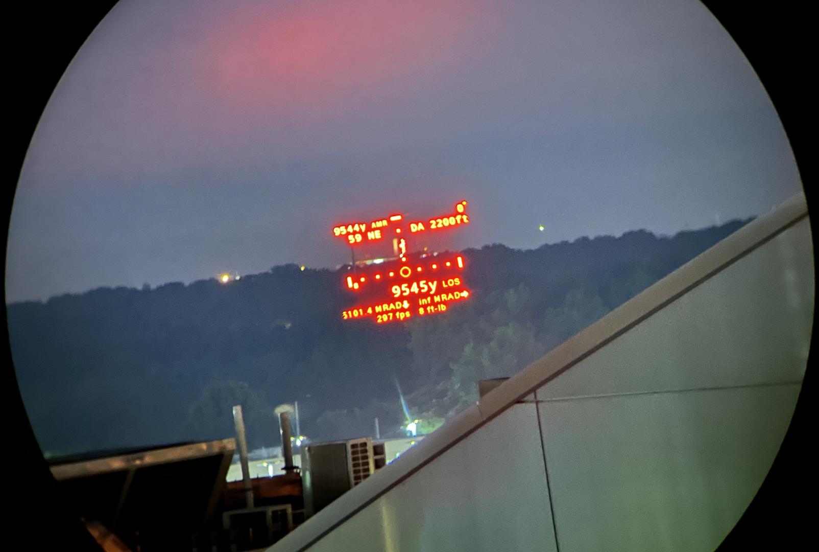

I'll admit to having my doubts when I read 10k in the product name of these binos. 10,000 yards is simply a lot more than competing 905nm laser products. Quite frankly, though, they will do it. It took me a long time in near flat, tree-covered Ohio to find a place you could see far to test it, but eventually I got a sight line on the Budweiser factory from a parking garage at 9,545 yards, and the binos ranged it every time. To be fair, it was night, but we’re looking best case scenario here in every way. During the day, the max range is certainly less. For instance, I could not get a well-defined bridge abutment at 6,000 yds no matter what I tried, even on a cloudy day. Still, they justified the 10k model name, and their other range claims were achievable in daytime overcast conditions.
Now, the question of how Sig is getting remarkable range accomplished. That comes down to a combination of four factors. The first is that the Sig Kilo10K-ABS HD binoculars are not a class 1 laser product. They are a class 1M. What this means is that the laser is simply more powerful than a class 1 eye-safe laser and is eye-safe only if the beam is not focused. So, sort of eye-safe-ish: Safer then the class 3R found in a couple handheld rangefinders, but a bit less than the pure class 1 found in most consumer rangefinders. You really shouldn't point any laser rangefinder at anybody’s eye anyway, I might add. At least not at close range. The second factor in the 10k's impressive performance is the longer duration, larger space between laser pulses, XR ranging mode that can be chosen in the target mode menu setting. The unique 1.5x.06 mil beam divergence vastly minimizes the vertical beam divergence resulting in typically stronger signal return spikes. Lastly, the 10ks have excellent signal processing. When all of these factors are combined, you get some maximum distance results that are frankly multiples of what competitors products are doing.
Budweiser factory tower @ 9,545 yds through the Sig Kilo10k-ABS Laser Rangefinding Binoculars
Ranging a huge factory building at night nearly 10,000 yards away is impressive, and makes for a nice round number in the product literature, but you are probably more interested in what it can range smaller squishier things at during the day. As you saw in the photo earlier, the Sig 10k can range a person past 2,000 yds on a cloudy day. I actually got as far as 2100, at which point the binos started to return only the treeline behind at 2,300 because the 1.5mil wide beam was hitting so much more tree than person at that point. I am truly impressed with this result, though, especially when you consider how relatively narrow a person is at that range compared to the beam width. That is some really good signal processing. As for treelines, I got as far as 3,700 in lightly overcast conditions and >5k at night. Grassy gentle hillsides were a big focus for me, as my great hope was that the very low .06 mil vertical dispersion would mean you could clean up ranging even gentle hills under targets. In this regard, I was a little disappointed. The Kilos are a good bit better on treelines than gentle grassy hills. Even on hills well aligned horizontally with the ranger, you could start to have issues as near as 2,400 yds. In other words, if you’re trying to range a 3,000 yard ELR plate that is on a gentle grassy hillside, you may have problems hitting the plate because the plate itself is just too small relative to the beam width, and the hillside its on is just not steep enough to produce a strong enough return. This is not to say the Kilo 10ks are not hands down the best 905nm laser rangefinder for ELR. They are unquestionably that. You just still might not get a range on the furthest ELR targets. Of course, from what I can gather, only a few ELR matches go past 2,500, and I expect you will reliably get ranges at that. Keep in mind I'm not an ELR shooter myself. I'm doing my best to give you educated estimates of what you will find based on performance in similar situations.

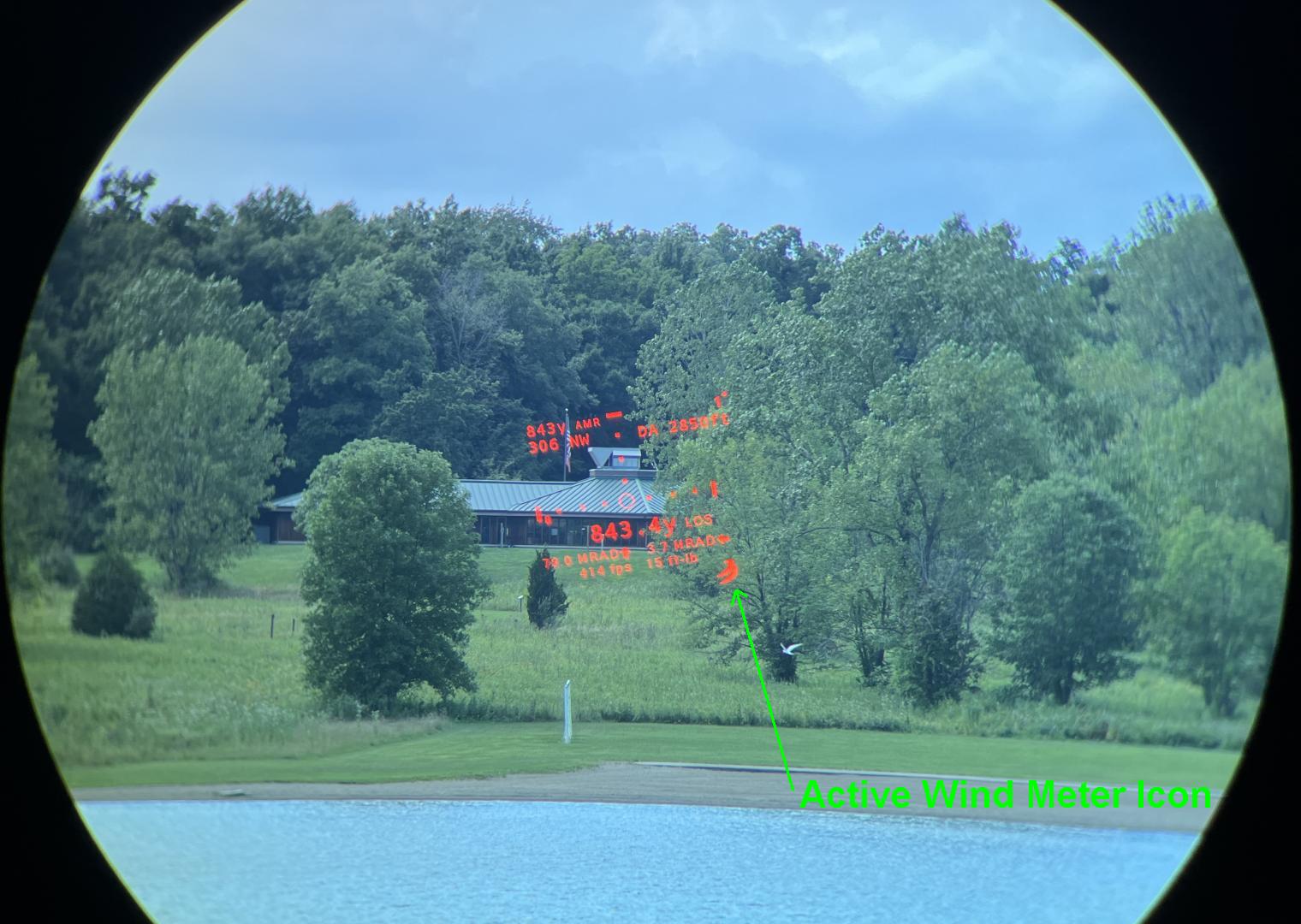

Of course, a laser rangefinder is not the only sensor in the Sig 10ks. There is also an atmospheric pressure sensor, temperature sensor, humidity sensor, angle of inclination sensor, compass, and optional wireless wind meter. Some of the appeal of an all-in-one rangefinder and ballistic solver is that all these sensors can be automatically integrated into the calculations for great accuracy and speed. To do this though, the sensors have to be reasonably accurate, so I tested them. With its remarkably thorough display, much of this data shows up to the user while ranging. What does not who up is visible in the smartphone app when ranging in connected mode or under the onboard sensors section of the excellent menu system in the binoculars. I found over several different sessions that the temperature sensor was always within the range about five degrees of the local weather data from the airport quite near my home. As many have noted, the temperature sensor is very slow to adjust, taking 20 min or so to acclimate to its location. The atmospheric pressure sensor appears proportionally even more accurate. Together, these sensors yield DA readings that agree with those of the airport within 500ft or better. That seems pretty good to me. Incidentally, there is also a relative humidity meter on the 10ks that they may have added into this equation as well, though it has little effect on the result. Relative humidity can be pretty micro-location. Based on that, and the relatively small effect it has on calculations, I didn't test its accuracy. The Sig 10ks also have an angle of inclination sensor. This tested within a degree and a half or so of correct, which seems more than sufficient to the purpose. The 10k's compass is less impressive. Subsequent measurements taken of the same point often vary by as much as 10 degrees, and these measurements typically do not even center in their distribution around the correct bearing. There is no pattern to this. Some directions it is erroring left, some it is erroring right. More on this in the BaseMap section, but it is important to note that an inaccurate chip size digital compass is not an issue unique to the Sig 10ks. Cell phones include this same technology and have the same issue. Tiny little chips just don't measure the earth’s magnetic field very well.
As mentioned before, the Sig Kilo10K-ABS HD binoculars include a WeatherFlow wind meter. This can be paired with the binoculars during the pairing process with the BDX phone application. Once paired, you can incorporate its readings into the ballistics calculations by simply turning it on while ranging with the binoculars. The BDX application does not have to be in use for the WeatherFlow meter to communicate with the binoculars after pairing. Activating the WINDmeter while ranging by pressing its single button will bring up a small wind icon on the ranging screen and replace the wind magnitude in the calculation with the magnitude read by the meter. However, it will not replace the wind direction. The WeatherFlow meter does not know what way you are orienting it, so you must orient it correctly if you want the calculations to be correct. You must orient it in the direction the wind is blowing and also in the direction you have selected and input into the binoculars. I will also mention here that the communication range of the WINDmeter is limited to a couple meters and it can be a bit spotty at maintaining those communication as well. I tested its wind metering only in so far as I verified that the calculations were changing. I did not test the accuracy if its readings. It is notable that the binoculars do not actually give you the wind speed value they are reading, but rather directly change the amount of wind drift in your ballistic solution. I didn't like this limitation. I would have liked to be given a live feed of the current wind speed reading, as it changes all the time, and I would like to know the relative range of speeds it is moving through.
WeatherFlow WINDmeter active icon in the Sig Kilo10K-ABS HD Binoculars

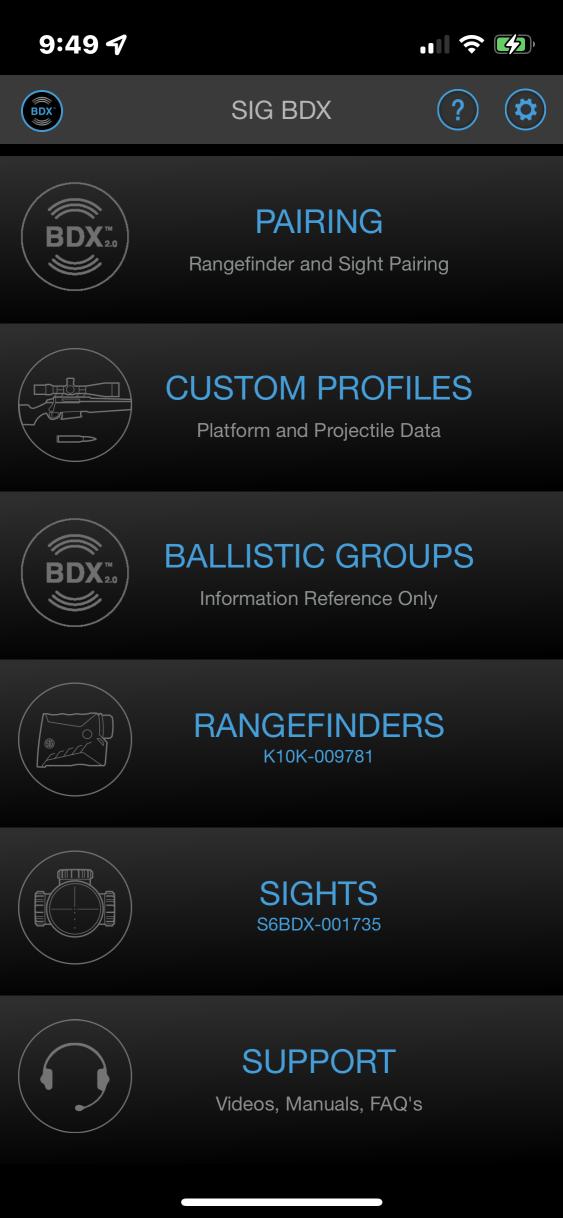

All of Sig's BDX rangefinders and scopes use the same BDX master app whether they are based on AB elite or AB Ultralite. The App's startup screen is indicative of the breadth of stuff the app is intended to do, having sections for the different devices you have paired with the app, as well as your ballistic profile creation section, the pairing menu, and a couple informational sections. Note that the video and manual section is actually just a hyperlink for your web browser. This is a bummer as it doesn't work offline, and I suspect more than one person has really, really, needed it to do so while on a hunt. Note to Sig:  our phones have enough memory. Integrate the manual into the app so it works offline. It is an excellent manual by the way. The only thing strange about the startup screen for the BDX app is that it is not totally clear what to select when using the rangefinder in connected mode. This is under the rangefinders tab, which makes sense, I guess, but it does feel a little like that tab might be just for rangefinder settings, which it also does. It might be clearer if this was the top tab instead of the fourth since it certainly feels like the option you use all the time should probably be the top one.
Sig BDX Application Start Page

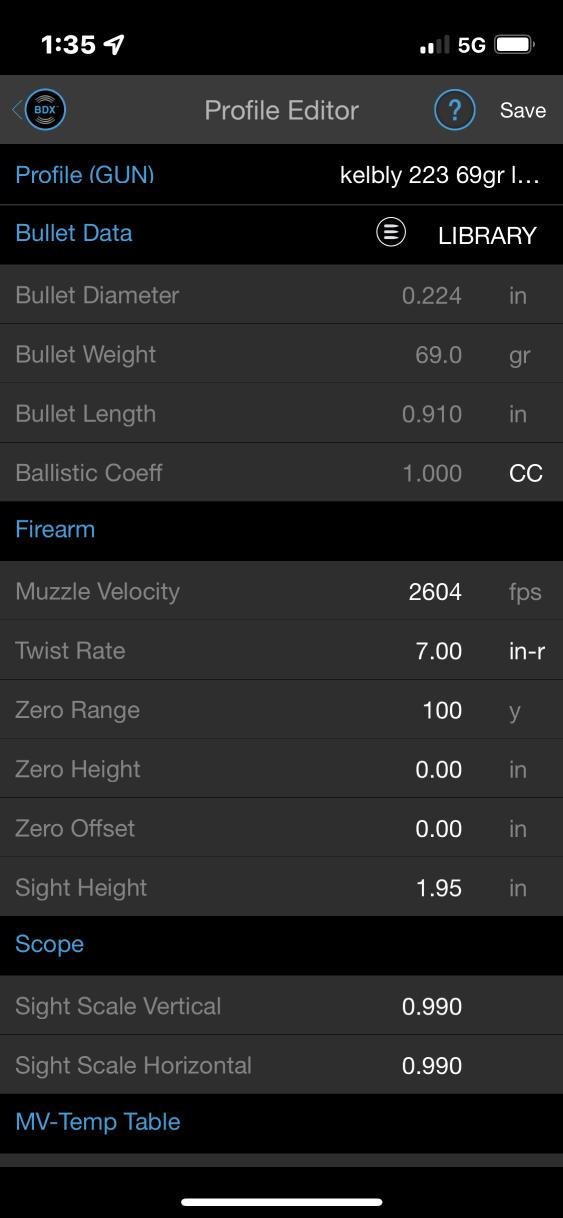

As the Sig Kilo 10k-ABS HD comes with Applied Ballistics Elite, and my basic assumption in this review is that is what you’re going to use. I should note though that the binos do have other ranging modes, including LoS, AMR, external ballistics (for Kestrel or external device calculations), and even a new Archery mode (for high angle long distance archery shots).  With Applied Ballistics Elite, the BDX application has a few more options in the Custom Profiles section than those using this application with a rangefinder only equipped with AB Ultralite. These include access to custom and personal ballistic coefficients within the AB library, adjustment for twist rate, sight height, sight scale (quite important as most scopes adjustments are a little off in adjustment magnitude), some velocity scaling for temp, and a few other offsets you will probably never use. Of course, it also gives you ballistic solutions for >800M shots. You will note that there is no section in the ballistic profile screen for truing muzzle velocity to field data or adding a drop scale factor for supersonic to subsonic transition. These functions are actually accessible from the live rangefinding screen and only work with ranges you have just taken, live. You cannot input previously recorded data. This is not my favorite choice. I would like to be able to more easily mess with these things when not at the range and be able to both mess with them and the range card to see how the data is lining up with my field-recorded data. While I can certainly still mess with the muzzle velocity in the old-fashioned, non-automated way, there is no other way to access the drop scale factor. If I, a person who really doesn't shoot past supersonic much, want to do that, I am sure the ELR guys do as well, and lots of them are going to be looking at this product. Make it so we can manually enter this stuff and futz with it. This inability to use the truing function unconnected from rangefinding also makes it too cumbersome to be feasible to true both BC and MV. This is something that you can do without too much difficulty only if you have an automatic truing function for one of the two. Lastly, I should note here that the same system exists in the BDX software for truing MV (though not DSF) for those with only the Ultralite version of AB. AB Ultralite does not usually include any automated truing function. That, coupled with some integration with atmospherics, is probably why truing is a roundabout system on the Kilo 10k, even though is comes with AB Elite. I still want to be able to easily manually mess with this stuff, though, and therefore disagree with Sig's choices in this regard.
Another note on the Sig BDX MV truing system is that, at this time, it doesn't actually work. When I trued a 5.8 mil correction at 624yds to 5.5mils, the program spit out a 3246fps MV as the corrected MV. This MV results in just a 3.4mil correction at 624yds and not the correct, 5.5mil one. So, way off and not even internally consistent. I had found this same glitch in the AB software before when doing the Leica Geovid Pro review a couple months ago and convinced the software team AB uses to fix it in the Leica iteration of the AB software. Evidently, they did not also fix it in the Sig iteration at that time. I expect it will get fixed now, though! It only took a few days to fix in the Leica app when I pointed it out before. Bug fixed 9/26/2022. Note: For the fix to work on an existing ballistic profile you must change something substantial in the profile so that it gets overwritten in the binos. Switching the bullet to a different one, syncing, switching back, and syncing again fixes it.
Applied Ballistics Elite Profile Creation Screen in the Sig BDX app

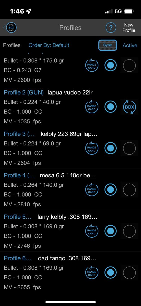

The Sig BDX application gives you a good deal of control as to what and when you sync information with the binoculars. This gives you the ability to hold more profiles within the app than the 30 that can be simultaneously in the binos. Because of the Kilo 10k's large display capacity, a large amount of text can be displayed for each profile name, making it quite easy to keep track of which one is which. You never have to remember just which data is stored under some generic ‘Profile 1’ designation. I'm telling you, the menu system in the binos is so good you will rarely feel the need to connect them to the app.
Sig BDX Ballistic Profile Management Screen
It has been a few months now since I last poked around in the AB personal data model library when I was doing the Leica Geovid Pro review. At that time, there were basically just hundreds of redundant profiles for the same couple of bullets. AB has added quite a lot of profiles since then and there is now a good deal more variety t. While there are still a huge number of 6mm Berger profiles, I now see quite a number of ELR focused profiles, a great deal of .22lr profiles, and a meaningful number of profiles in other calibers as well. The AB guys have been busy this summer and the choices are really starting to add up. They now also include a lot of rounds for which a "custom" profile had not been made. For these cases, they are effectively that profile. These personal profiles are really starting to prove their value. I'm especially excited to dig though the .22lr profiles, as the AB "custom" one was not a great match for CenterX in my Vudoo.
