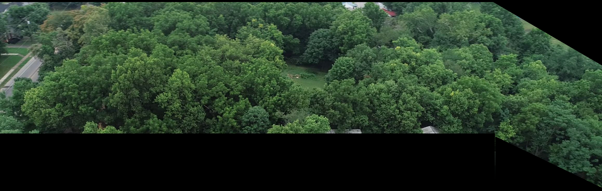

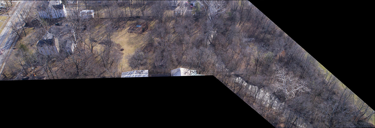

Here is one of the updates that I've been wanting to do for awhile.  The first picture was taken in Feb 2018 with leaves off the tree you can see most of the property and get a decent view of the creek.  Now all that is visible is the center part of the back yard and the rest is all green leaves.
Feb 2018
July 2018 - Not the exact same angle but either way you aren't seeing much this time of year.

https://www.AR15.Com/media/mediaFiles/680/drone_looking_towards_creek_jpg-709867.JPG
Such a pretty place.  Peaceful in the middle of a somewhat more urban environment. (I know it's probably technically not urban).  That view to the creek is so nice.
The crazy neighbor may be gone.  I hope so, no more fumes filling the entire back yard or a mentally ill man walking around holding his Glock while staring at people.
The creek will only be visible from the flat roofs of the house, in my long list of "nice of haves" A deck on the roof so I can get that exact view that the drone has would be awesome!
How sacrilegious would be it to turn a an original window built in 1812 into a door to the roof?  The lower window sill is completely rotten and leaking water into the house.  So I need to do some major reconstruction either way. The window sill rotted enough the storm window frame shifted and the storm window is broke.  Not even sure where the original house window frame is.  So I could spend $500 to repair the window or spend $500 and put in a door that access to the flat roof and future roof deck.

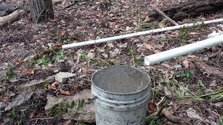

I finally started work on the well project.   The history is that a hand dug brick lined well was carved down through the bedrock 50 feet.  At some point it was capped and a casing put in place.  The property had an old hand operated well pump when I purchased it but the pump was rusted and would not work.  I pulled it out and the pipes had holes rusted completely through all over it.  Earlier this year I tried to pull a water sample but at 25 feet I hit dirt.  I left it alone until now.
Today I build an very simple air lift pump.  It uses pvc, compressed air, and water.  I put together 3 ten foot sections of 1 1/4" pipe, ran the air hose into it and down the side of the pipe, and fasted a couple bolts as agitators to the end of the pipe.  Then blow compressed air into it.  The air expands and pushes the water/dirt upwards.  That is method I was using when I broke through the dirt layer.  It looks like debris from the well hole collected on the surface of the water and bridged over.  The air lift pump worked and after about 5 feet of dirt the pump broke through.
This is a picture of the blockage that I found in the well casing at 25 feet.
A quick video of the air lift pump pulling up the silt at the bottom of the well.
Cleaning Well - Air Lift Pump In Action
Around 6 hours later the water was coming out clear.  The air lift pump does not move much water and takes awhile.
Cleaning Well - Air Lift Pump Running Clear
Some pictures.
My "well inspection" camera.  I cheaper IP camera connected with a long network cable.
The air lift pump equipment.  Very simple.
The water samples.  The one on the left was at 40 feet first thing in the morning.  The middle are at 50 feet.  The one on the right was after I injected air into the well and was able to get down another 4 feet.  It was collected as I first started pumping all the silt up.  The other bottles had time to settle.
The bottle on the left is the 54 foot with silt bottle.  The bottle in the middle is from the exact same depth and position just hours later.  The right is an unopened bottle of water from the store.  The well water has air bubbles in it but is clear as the store water.

We didn't have much for fall colors this year.  The leaves didn't start changing until the end of October and then we had several days below freezing and they dropped.
Fall Colors 2018
