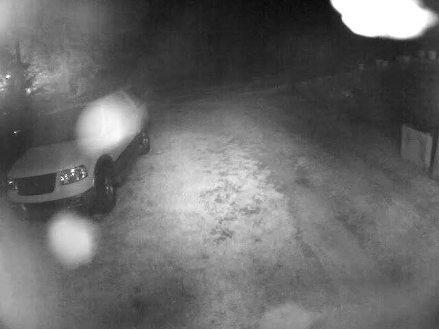

I finally got around to getting the ACTi ACM-3701 you suggested up and running. The image quality looks great.
Edit ********
Looks great in the daylight. At night, I thought all my lights in the back yard would make it useable, but it not at all. What looks like a well lit driveway, two flood lights on the garage and a lamp post, looks almost black to the camera. Now I've got the bug and want to spend even more money on something with better night vision
End Edit********
I ended up mounting it into an electrical box and double sided sticky taping that to my back door. It looks kind of goofy, and is very conspicuous, so I may move it, but that turned out to be the best possible location for the field of view I wanted.
The second best spot was actually inside the house and looking out the window next to the door, but the problem with that one is that I wouldn't be able to see an image of someone just standing at the door that way. I could see who's knoncking via the motion capture pictures, but I'd rather be able to just glance at the feed. That way did have the advantage of the camera being virtually unnoticeable from outside.

I got an outdoor camera which looks really nice during the day buy it has these white blobs at night.  I've cleaned the glass, but it did not help.  Any ideas?  Camera is a Toshiba IK-WB80A.
P.S.  I have purchased motion sensing flood lights for both sides of the garage door but they are not installed.  This picture is with no lighting other than ambient + IR.

It's catching the light from a nearby floodlight.  This is a dome camera, correct?

Bullet.  I'll take a picture of it when I get home today.

That lens looks like it's catching some kind of reflection from a nearby light.
