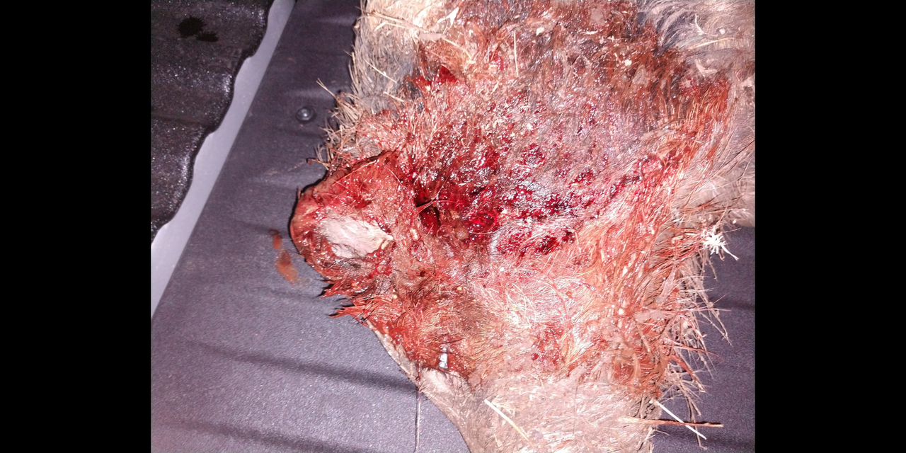

So far I'm still new to hunting with 300BLK and have only taken 3 pigs with it, all inside 100yds and under 150lbs. But all 3 were instant drops with no running or tracking. I aim for neck or shoulder and the 110 V-Max has performed admirably on body shots. One neck shot was a full pass through on the top boar, 40yd. One shoulder shot at a small sow, maybe 75lbs, that fragmented pretty good at ~60yds. Found a fragment of the bullet in the off side shoulder but didn't weight it because it was just a piece. It hit bone going in and made a huge mess of the shoulder.
My most recent outing I took another lone boar, last pic, which was maybe 80-100yds away, and aimed at the shoulder. Instant drop and he kicked for a minute before going still. Pulled a beautiful mushroomed bullet out of the off side shoulder measured 0.625" at the widest point (over 2x expansion) and weighed 64gr (58% retention).
Conclusion: Excellent expansion from the 110 V-Max inside 100 yards. Though pass through is unlikely when hitting the shoulder. Hitting bone results in sever fragmentation. Aiming a bit higher on the shoulder blade seems to initiate a nice mushroomed expansion, but without much sectional density, it still gets stuck in the hide on the back side. My intention was for head and neck shots most of the time, but 2/3 ended up in the shoulder. Good to know that if I go for a second hog in a group that a shoulder hit should yield a kill. So far I have been very pleased with 300 BLK terminal performance using the V-Max bullet, and if this continues, I'll be stacking V-Max's deep as my go-to.
Ammo: 110 V-Max handloads with 19.8 gr H110 powder, 2.050" OAL. No chrono data.
I have not tried any other bullets yet. Barnes 110 sounds great, but price turns me off.
