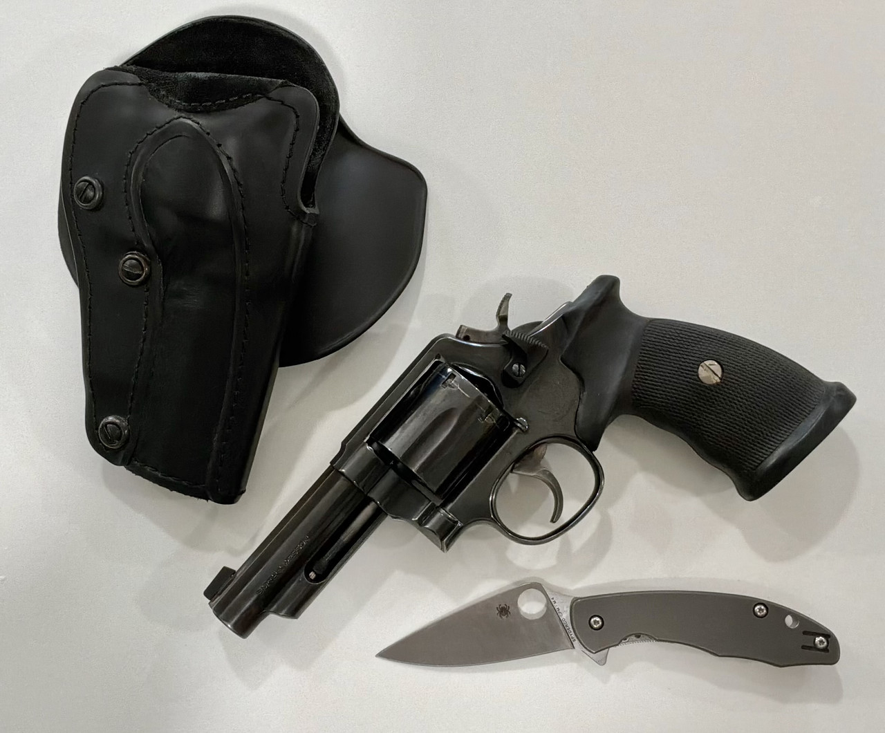

I'm gonna go out on a limb here... Buy a set of Pachmayr Gripper grips. They're fairly cheap, and the shape is perfect. I had some on my 1St 686, and on my 28-2, so I know they have some to fit both of your pistols.
I like to compete with my revolvers, and went down the grips rabbit-hole. For me, these  Grippers are perfect. I found the rubber Hogues too big, and not shaped well.
I was competing heavily with the 686 in the pic, and and was using heavily dremeled Hogues because the K/L Grippers won't fit my round butt 686.
Also, the poster who suggested an action job was spot-on. Comfortable grip and good trigger help a lot. Spring kits are a great cheap start.

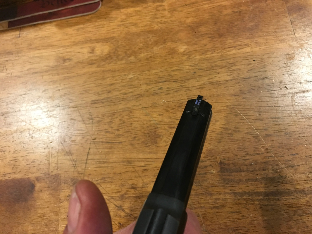

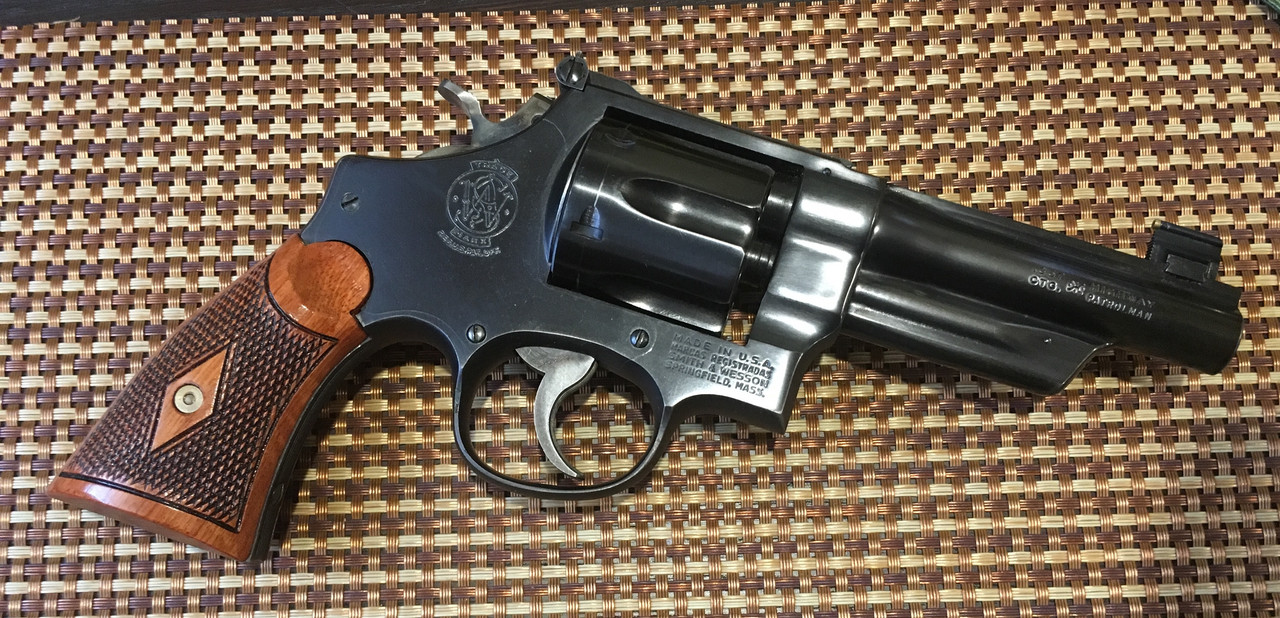

Another option is to mill or file the front blade off and have a novak dovetail cut into the base.
Gives you tritium and fiber optic options.
Had this done to a couple of my custom revolvers.
I had a 28-2 years ago that had a dovetail cut that had a marbles gold bead front sight mounted. Very nice sight picture.
581 with Novak tritium
28 with gold bead, barrel was also shortened, so couldn’t use the base.
Still have the 581, wish I had kept the 28.
Keep in mind, these mods were done when revolvers were cheap and plentiful. Your 28 will most likely lose resale value if you mod it. To me, I don’t let that get in the way of what I want.
