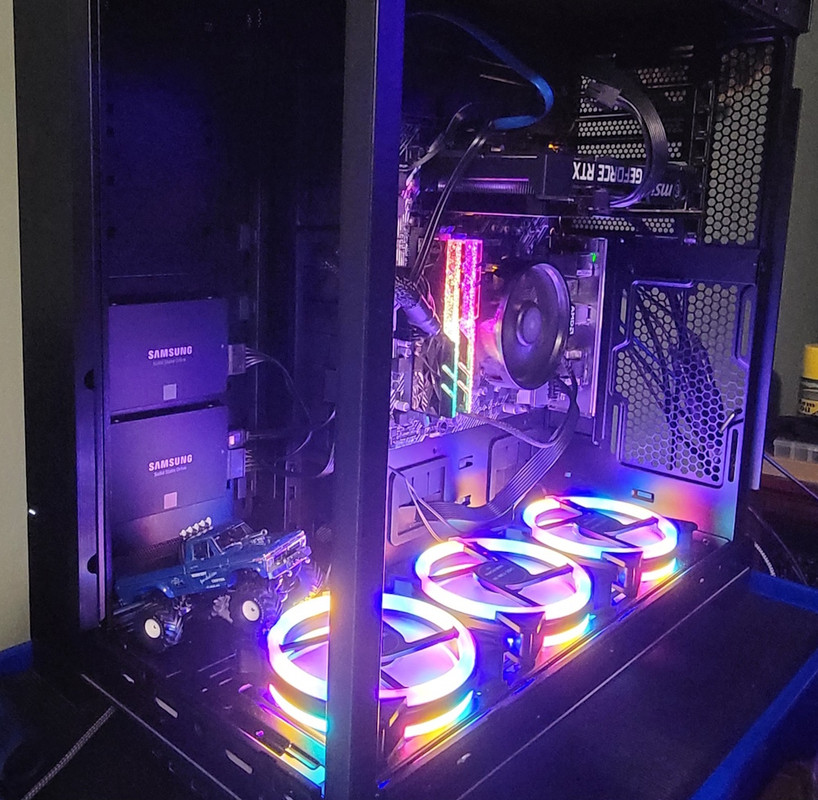

For about a week now, if I watch three or more YouTube videos the video will freeze, but the sound keeps going. Sometimes I can fix it by minimizing the browser, and when I bring it back up it starts going again. Other times I have to close the browser, and it works again when I open it.
I thought it was a YT issue, but then I got the same thing when playing the Microsoft Solitaire game, that's part of Windows.
Any ideas what could be causing it?
Oh, and when I right-click the trash can, the menu at first pops up as a dim rectangle, then shows up normally after one or two seconds.

Could be a lot of things.
To start why is your PC sitting upside down? Those fans are going to struggle to get fresh air like that. That's also a not great airflow setup.
How long has this PC been running with that stock cooler? Have you ever re-pasted it? HWInfo (the app) is great for checking system temps. Those stock coolers work 'ok' with lower TDP chips but they don't put that great of paste on them, and the paste doesn't last forever. If it's been running for years it's a good time to buy good fresh paste and redo it + make sure the fan is clean. Or install a different air cooler. Good dual stack air coolers are like $30.
You tried Edge and videos worked fine. Did you check memory use? Were these live streams with chat going? YouTube will give browsers the err out of memory page if you let a live stream with chat run too far. For whatever reason objects in the chat stay in memory and will max out the limit for memory used. IIRC I think it's around 6GB then the tab errors out. The more active the chat the faster this happens.
Try downloading the latest driver from Nvidia (not through the app) and when you get to the install screen select 'clean installation' https://www.nvidia.com/en-us/geforce/drivers/results/265874/
Do you have Samsung Magician installed? You can use that to check on the drive health. Those are older SATA SSD's and one might be on it's way out if that's where your OS is installed.

The three RGB fans are on the 'top' of the case but you have the whole case upside down.
You would have to put the case right side up and then flip the fans so they blow up and out. Heat rises so you want to use that to your advantage and use the fans to help warm air exit the case.

I agree with the folks mentioning your case is upside down.  If you want it in that position, consider some sort of riser to let air flow. Two or more inches.

I don't have any temp sensors, but the case is mesh on top and mostly open on the back and the bottom. After the fans were mentioned above, I looked into the case manual, and it does allow for fans on top, so I may add more fans. The case 1" feet on the bottom, but I'd rather add fans than put the case up on something. I'll do it if I have to, but I'd prefer to leave it sitting as is.

Lian Li does show a lot of fan options for the case, so I'll definitely add more fans. I may need to get a mount kit or something, but I'll work on that.
https://lian-li.com/product/o11-dynamic-evo/

What I don't think you are understanding about the case being upside down is things like the GPU fans are oriented where they pull air up through the cooler, and out the top of the GPU. Warm air rises so the heat ideally should go up and out the back.
When you have your GPU upside down the warm air goes down but wants to rise back up. It's not being exhausted in an efficient manner. That also means the fans on the bottom are blowing air up against the direction the GPU fans are blowing. You shouldn't have dueling fans blowing air at each other.
You can disable Game Bar. It's a stupid thing that comes with Windows. Go to Windows Settings and search for Game Bar. Turn the toggles off.
You may not know but do you have other apps that have game overlays? The Nvidia app is a common one that has a game overlay feature as are game launcher apps (Steam, EA, Xbox, Epic). The 2nd common source of game overlays are GPU/system tuning apps like MSI Afterburner, EVGA Precision X1, AMD Adrenalin, etc. Some chat apps can have them like Discord and TeamSpeak. You can create a situation where multiple overlays are fighting each other and instigate crashes.
I personally turn off all game overlays. If there is a specific reason you need to use one you can turn it on temporarily but its best to keep them off, and if you need to use one you'll know.
Also check in Settings for Startup Apps. See what is toggled on to auto start with your PC. Uncheck
Turn off things you don't need to run when you start your PC.

I'm working on it, but I don't even know what most of the things are. There are several NVIDIA things, but I don't know what I can disable.
I just now looked up, and my case lights are off again.
I checked in my extra PC stuff, and found a fan bracket that fits the top of my case. While I had the top off, I looked at the fans on graphics card. They weren't running at the time, but wouldn't these be blowing up, rather than down? (Pic looking straight down through the top).
4/17/2026 3:54:41 PM EDT
[Last Edit: Rebel31][Edited] [#27]
No, fans blow air towards the bracket side.
As I said before your entire case is flipped upside down. That last picture is from what should be the bottom.
4/17/2026 8:43:46 PM EDT
Originally Posted By Rebel31:As I said before your entire case is flipped upside down. That last picture is from what should be the bottom.
Yes, I bought a reversible case so that the side window and inside lights weren't facing the wall like all my old cases.
https://www.ar15.com/forums/general/Left-side-PC-case-/124-2804556/
I may get another fan, and mount it to the back. That would be about in the middle, carrying everything out the back, instead of (or in addition to) going out the mesh top.
