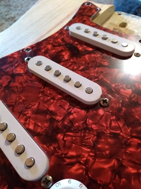

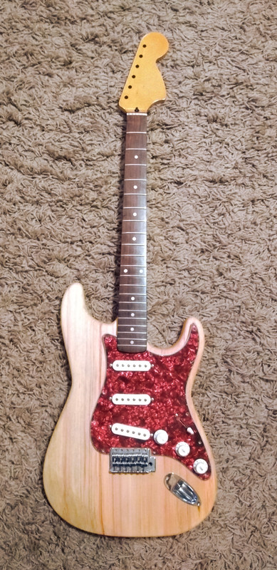

Put the electronics in the pickguard this evening, Decided to do a mock-up pic.
Think I'm gonna like it.
https://i.postimg.cc/fRP6tTRS/2021-04-21-18-47-14.jpg
That's my favorite flavor of pickguard!
Looks great!

I really like it. I think it's going to work out fine.
Interesting turn of events. The original pickup covers were panther pink.
So, I had a couple extra sets, an antique yellow set, and a cream white set.
And neither of them fit the pole piece spacing on the pickups. GRRR!
So, I figured I'd swap out the pickups. Cut the wires, resoldered the new pickups in place, put them in the pickguard.
These had been in another guitar, and they sounded pretty good when I used them last.
But, then I got to looking at the pickups I took out.
The more I got to reading, the more I thought I just removed a set of Alnico V's and replaced them with ceramics.
Nothing wrong with that, but I think I would like the Alnicos better.
Also, the pickups had staggered pole pieces. I believe these are Squier Alnicos and they're a good set of pickups for a cheap guitar.
So, I figured that if I could get the paint off of the pickup covers, I'd put the old ones back in.
Started reading about how to remove paint from plastic. Found the answer on, of all things, a model railroad forum.
Soak the painted parts in 90-100% alcohol, either isopropyl or ethyl, until the paint flakes off.
Worked like a charm. Hit it with steel wool in a couple of places to clean it up but they look great.
And, back in go the Alnico pickups. The bridge position pickup is different from the middle and neck. Wire is a different color and the pole pieces sit higher as well.
Hope it was worth it!

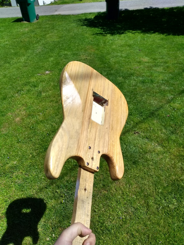

Base coat is done on my bass project. Clear coat to follow either Friday or Saturday. Brought it into the house (from the garage, where I have a makeshift "booth") in the meantime since we're supposed to have storms tonight and tomorrow, and figure it better to be sitting in a climate-controlled environment.
5/1/2021 12:18:45 PM EDT
https://www.ar15.com/media/mediaFiles/106617/IMG_20210428_130253_jpg-1922594.JPG
Sweet! Can't wait to see the gloss coat.

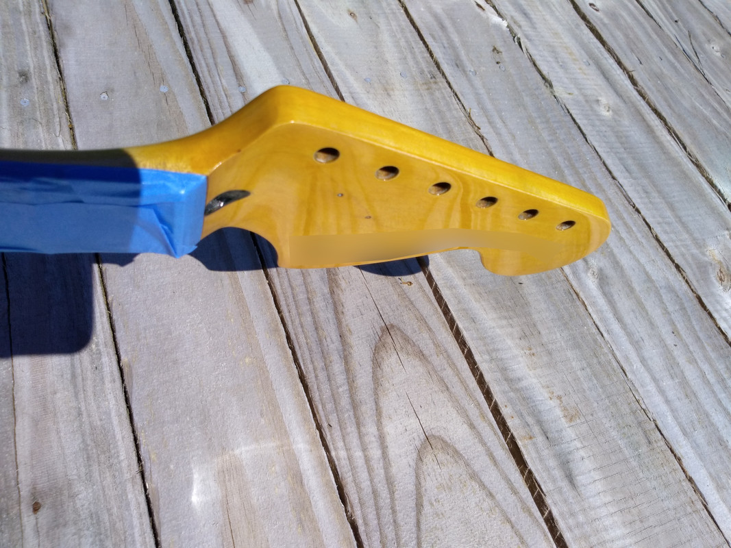

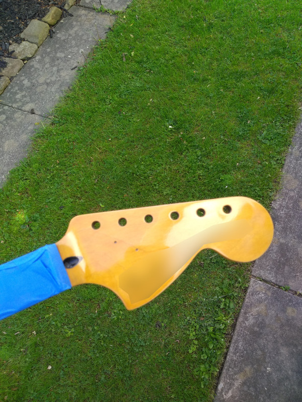

Speaking of gloss, I FINALLY got a good day for painting and finished the headstock.
Got me one of them fancy personalized headstock logos and buried it under 10 or so coats of poly.
Since it reveals personal info, had to blur it. But still gives you a good idea of how it turned out. I'm happy with it.

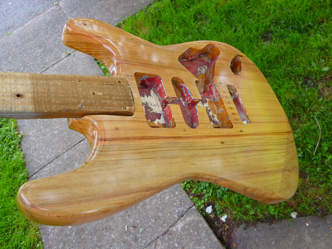

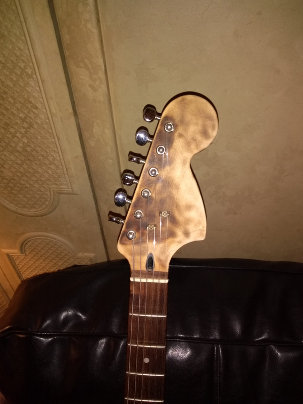

Quite the transformation from this:
Also, shot the first coats on the body. Not much to see, really, because the wood really soaked up the first coat, but at least I got it started.
It darkened it a little bit. I'm perfectly OK with that.
Going to get as many coats on as I can, but then I have to wait 72 hours before re-coating, so it will be Tuesday or Wednesday before I can really finish it up. And, depending on how many coats I want to do, might go into next weekend (the wife's going to be gone, so I'd have plenty of time to just sit around, drink beer, and shoot poly all day...and that actually sounds pretty fun!). Just going to put as many rough coats as I can today and build layers, then wet sand eventually and put a final finish coat on. If I can get that to look good, I might not have to polish much or at all.
One thing I learned a long time ago about finishing...you can't get in a hurry. From the first application to finishing the headstock took me two weeks. I figure I'm probably that far from playing this thing for the first time...lol.
