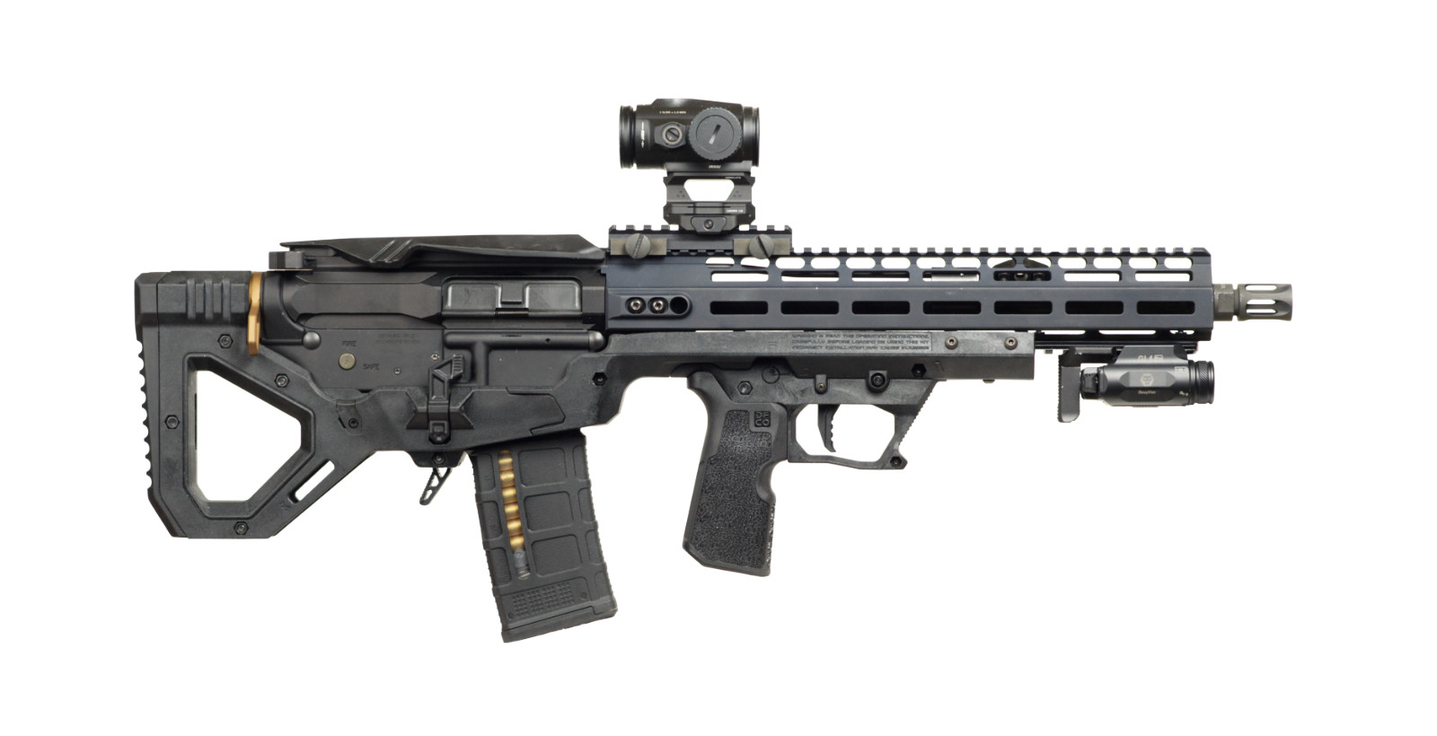

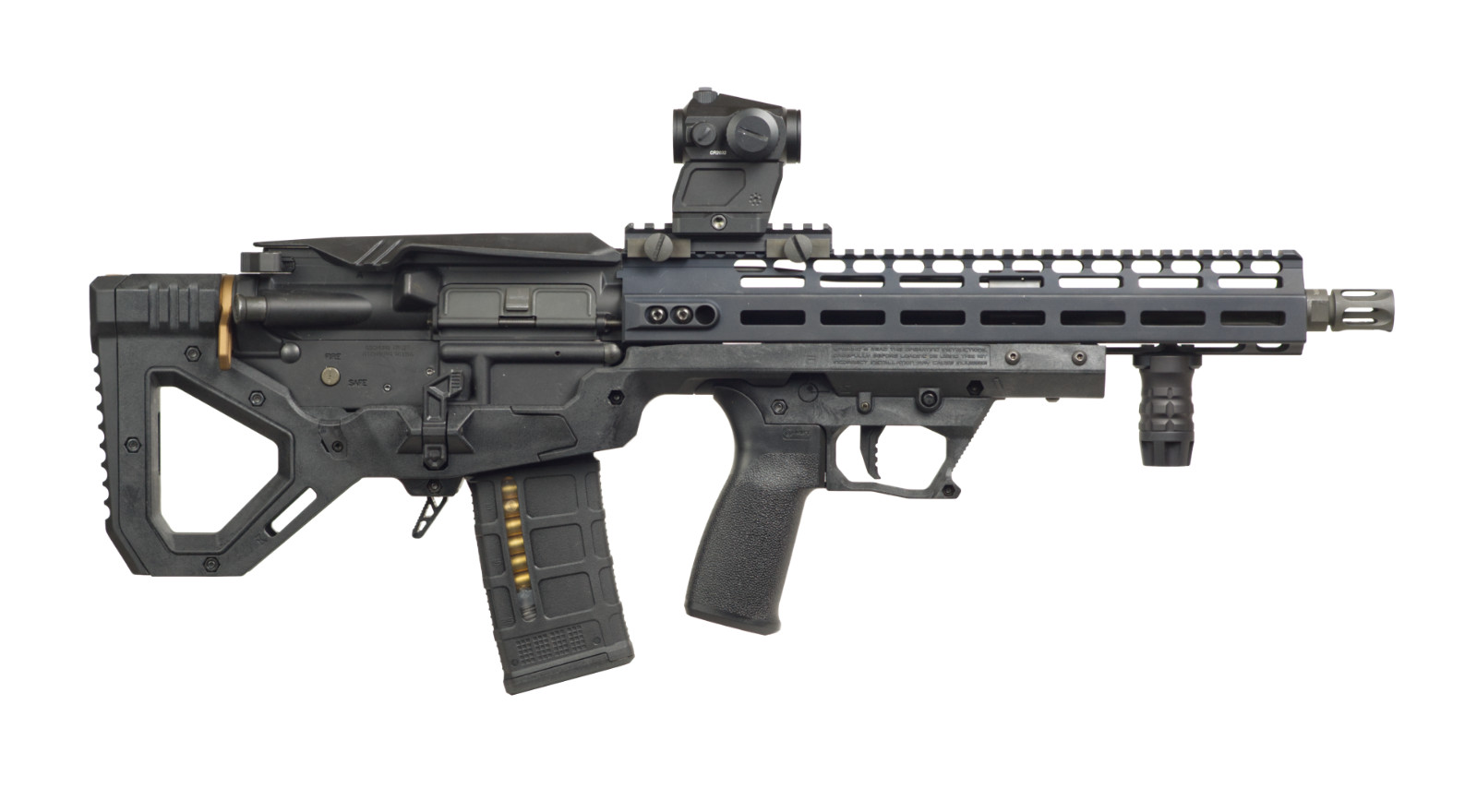

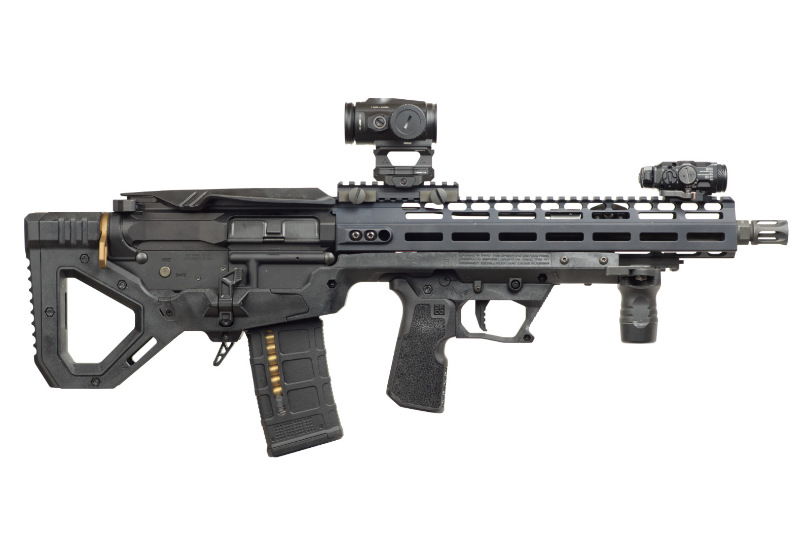

I’ll probably be ordering one of these to play with. Much cheaper than the other alternatives…though that didn’t stop me from buying the others, lol.
Reminds me of the Scy conversion kit, only the scy looks like the prototype of this. Curious to see how well built it is. The mag release hardware does look a little janky to me…interested to see how it’s built.
Two neat things:
It is compatible with milspec uppers if you use the Dead Foot Arms buffer system and works with the CMMG .22 conversion kit. This does increase the LOP but it can’t possible be any worse than the Hellion.
It has a paddle mag release behind the mag that should feel more familiar to us bullpup users.
Edit:
I’ve shot an email over to inquire on fat handguard fitment. If it’s a yes, I’m ordering. A milspec upper with DFA buffer kit, an Aero Enhanced 10.7 rail , 6” 300blk barrel, and tucked supressor sounds like PDW heaven.
Edit for new info:
- LOP is 15.3”
- 9.5” handguard fits flush to the end of the chassis.
https://www.sru-precision.com/
https://www.sru-precision.com/sarb-15

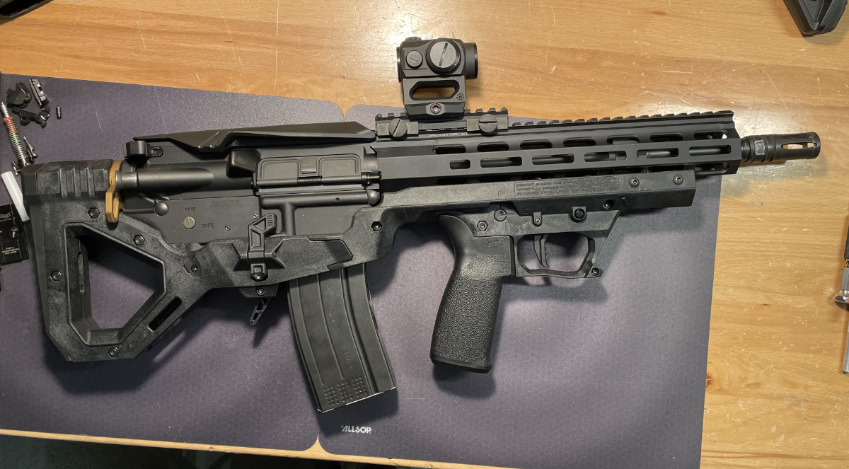

Ended up ordering a conversion kit, used an obvious coupon code so final price was $364 shipped Fedex Priority from Taiwan...
Not kidding around, ordered last Thursday got it today (Tuesday following).
The chassis is a bit on the flexy side when assembling, but once everything is together there is no play or flex. Trigger is pretty darned good; I have a Geissele SSA in the SBR lower I'm using. Clearing the charging handle with my face will take a little getting used to. I didn't want to spring for a full FM Products or Brownells side charging upper... And you'll need a riser or tall mount for your optic.
I'm going to try a 6.5 Grendel bolt in the ARIC; I'm probably in for a lot of pain and frustration, but maybe I'll get lucky...
12.5" Grendel barrel, 11" handguard:

Aside from the bullpup kit, I just bought a Law Tactical ARIC off the EE.
My SARB-15 required some modification to work with the ARIC. I had to hog out the ID of the stubby receiver extension by about .01" so the ARIC would slide in and out freely. SRU Precision wanted me to tap my ARIC in as sort of a force-fit, but according to Law Tactical that's a no-no.
I'm also trying to see if I can modify the mag release lever so it depresses the mag catch all the way. Right now it goes about halfway, which is not enough to release PMAGs.
I also ended up switching to a 5.56 barrel and using the ARIC in its factory configuration. Here's how it sits right now:

Thank you @Thor, spinning the mag catch out three turns did the trick; mags eject with no issue now. SRU Precision's customer service has been good - they answer emails promptly.
I ended up swapping the optic for one with a 1.7" mount; height is now perfect for a comfortable heads-up position with the rifle shouldered.

10/11/2024 8:17:57 AM EDT
Updated with a Rovyvon LAM, AT3 slick sided upper, Kung Fu grip, Vortex 3x prism.
Fun little package.
Scepticism is an exercise, not a life; it is a discipline fit to purify the mind of prejudice and render it all the more apt, when the time comes, to believe and to act wisely. -- George Santayana
Never mistake a clear view for a short distance.
10/11/2024 10:41:16 AM EDT
Fun little package.
https://personal.visualitymedia.com/personal/556_bullpupconv_lam.jpg
You've got plenty of room to put the LAM on top so that you can have a two-distance zero (50/200 or whatever works). Plus it won't get blocked by barricade shooting.
10/11/2024 12:17:39 PM EDT
Yeah, you're right.

10/23/2024 5:55:36 PM EDT
[Last Edit: Thor][Edited] [#39]
So I got it in. I haven't got all the parts yet as I'm still deciding on how to configure this.
I got a few handguards to test. I wanted something with a more solid lockup since I'll be mounting an optic on the handguard. Found the perfect one for it. Daniel Defense MFR XL. This is just outside SRU's specs for compatibility, but it required minimal modification to the chassis to make work. Just had to take a dremel and remove some material from the inside to make room for the bolting area on the handguard. Why is this the perfect rail for me? Cause now I can tuck a suppressor. If I want to run a 5" 300blk barrel and a can, I can do so in a 25" OAL package.
Where to dremel:
10/23/2024 6:04:11 PM EDT
If you want to run something more practical, like a 8"-9" 300blk, you can still use the extended handguard to tuck the rest of the suppressor. As I said, the handguard is a bit to large according to the compatibility chart, but with the MFR XL, the SRU handguard slides on perfectly. But you have to have it lined up perfect to get it on. It was easier to take the top off and slide the main part on first, then reattach the top. The handguard almost tension lock against their taper. There was a little bit of upward play on the handguard when mounted to the chassis. Pairing the extended handguard with the MFR XL makes the entire chassis feel rock solid.
10/23/2024 6:12:40 PM EDT
[Last Edit: Thor][Edited] [#41]
The MFR XL is 10", too long for the 9.5" maximum length in the compatibility chart (though I think it's more like 9.75").
Because of this, you cannot slide the SRU handguard all the way back to its attachment points. I haven't done it yet, but i will have to shave .2-.21" off the the lower rear top section of the SRU handguard so I can slide it all the way back. All I have to do is cut it straight down and remove the angle. Aesthetically, this will also nearly close the gap between the top of the two rails more a better look, in my opinion.
10/23/2024 8:31:13 PM EDT
And done….
