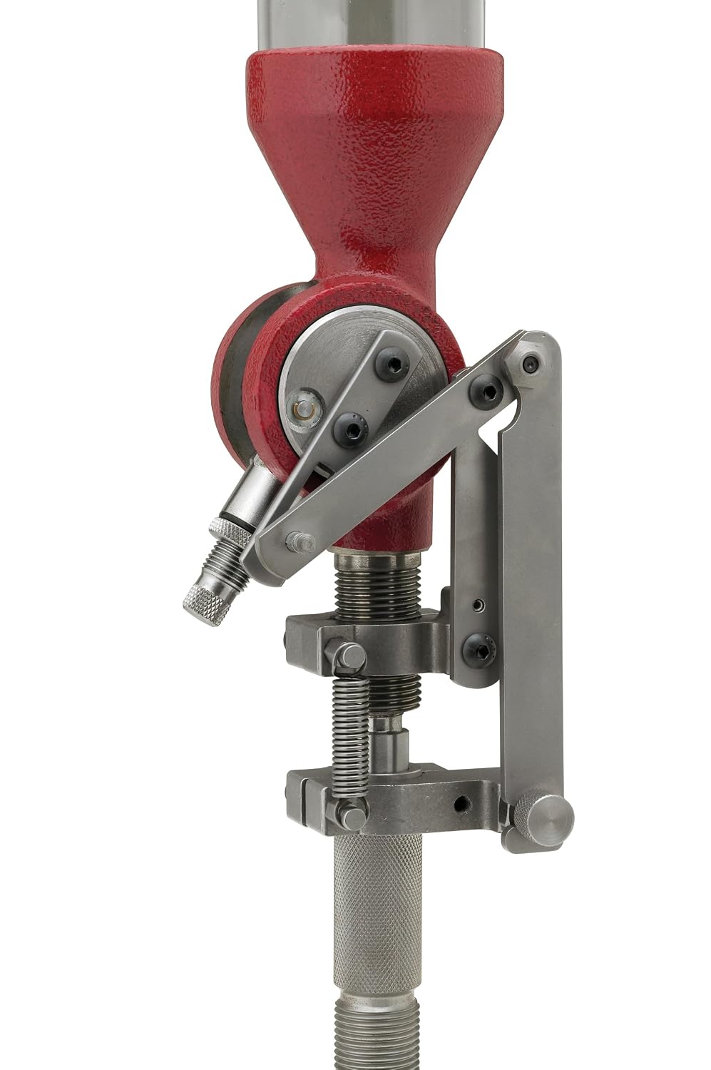

I didnt want to spend too much of this thread listing complaints about RCBS powder measure. But since you asked:
1. Tolerances dont seem as tight. Installing both drum and plunger fit very poorly and "rough" into their respective homes.
2. that spring is way overly strong... difficult to remove/install. Dont see why you need that strong.
3. Baffle costs extra.. are you kidding??
4. Cheap plastic green??? clear hopper that shredded apart when I installed it into metal...
5. baffle costs extra.. deserves a repeat
6. no pistol expander capability? i was going to see if that hornady piece might fit
7. materials cheaper??
8. the screw piece in side of drun that holds plunger in. Hornady has a button that is way smoother
Just my opinion.

no pistol expander capability? i was going to see if that hornady piece might fit.
RCBS has them for pistol now, just no powder measure stop yet,
So yes on the RCBS pistol expanders for the RCBS bullet feeder,  if you don't want to use the Hornday PTX expanders isntead if you are using a Hornady bullet feeder.
http://www.midwayusa.com/product/152982/rcbs-case-activated-linkage-kit-pistol-powder-expander-45-acp
But no on the powder measure stop, and you need to use the hornday unit  until RCBS decides to offer them a well (too busy trying to resolve other problems on the machine like the primer slider, and will take them a while to figure out that a powder messure stop is needed to get uniform powder throws with the pistol expanders in play). Hence the stop is set up so adjustment dial housing, stops just a hair shrot of the top of the slot it rides in, instead of crashing into the top of the slot when expands the case mouth instead.
Skip to :40 if anyone don't know how to set up the powder measure stop correctly,
https://youtu.be/A-t-pgeZYWY

A few years ago, I bought a couple of the Hornady powder measure stops and converted them quite easily to work with RCBS linkage on the Uniflow.  I posted the How-to thread in the tacked threads.
If you're interested:  http://www.ar15.com/forums/t_6_42/402337_.html&page=1
