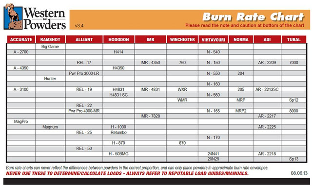

I thought I would post this just for completeness.  It's an excerpt from the Ramshot Burn rate chart.  You can see how many of the powders stack up.  Faster burn rates at the top, slower at the bottom.

N150 is a lot faster than Ramshot Hunter.  Its closer to Big Game.   Hunter is more in the H4831 burn rate which is closer to N160.  Hunter is outstanding in the 243.
Proud deplorable. MAGA!!
6/10/2026 2:04:53 AM EDT
[Last Edit: Trollslayer][Edited] [#22]
I posted a burn rate chart above (see post #15).  They're never perfect but they give the general lay of the land.
It shows all the powders you mentioned, those I discussed and those the OP discussed.
I tried HUNTER in my 6 mm but moved on to MAGNUM, as it was too fast.
