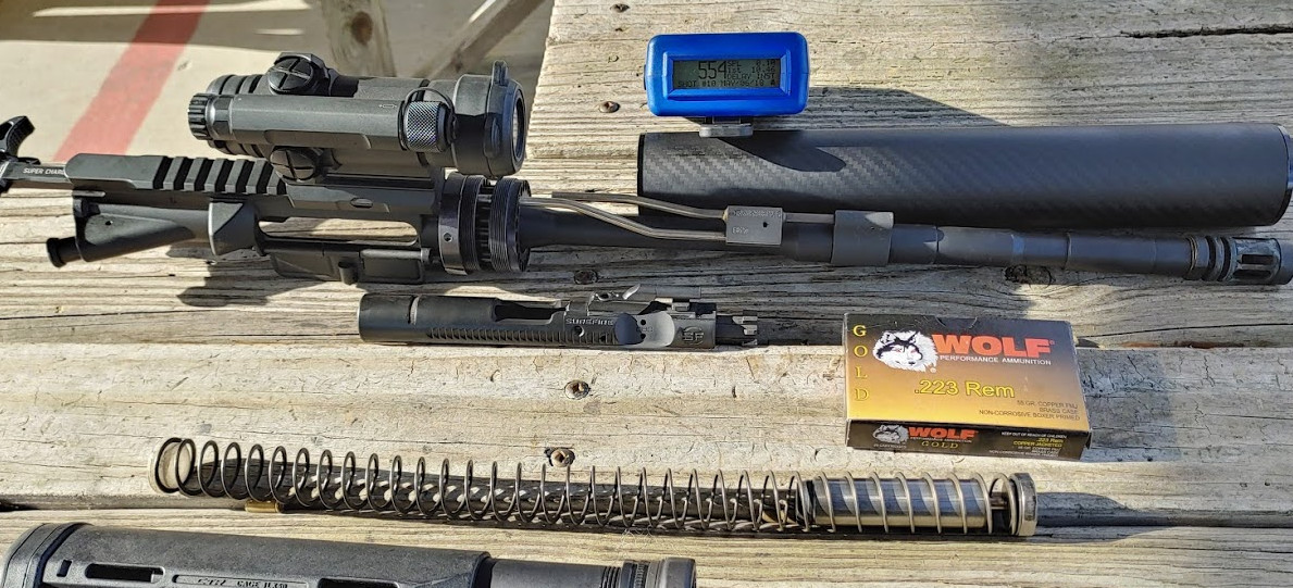

I am thinking about a Lima 6 kit. But they requires a side mounted gas hole in barrel. Why not use an angled gas tube similar to the pig tail type? This would allow you to use just about any AR15 barrel. You would just need to bend it to size.Attached File

I was planning on using a large volume gas tube.  I have TIG welded my own to do 'constant recoil' M16 configurations as I have documented on my site here: https://c3junkie.com/?page_id=1403
However, now thinking about the offset, it maybe good to copy what LaFrance did with a twist.
Below is a picture of one of my LaFrance gas tubes.  Make a box like that for increased volume and do the offset at the same time?
