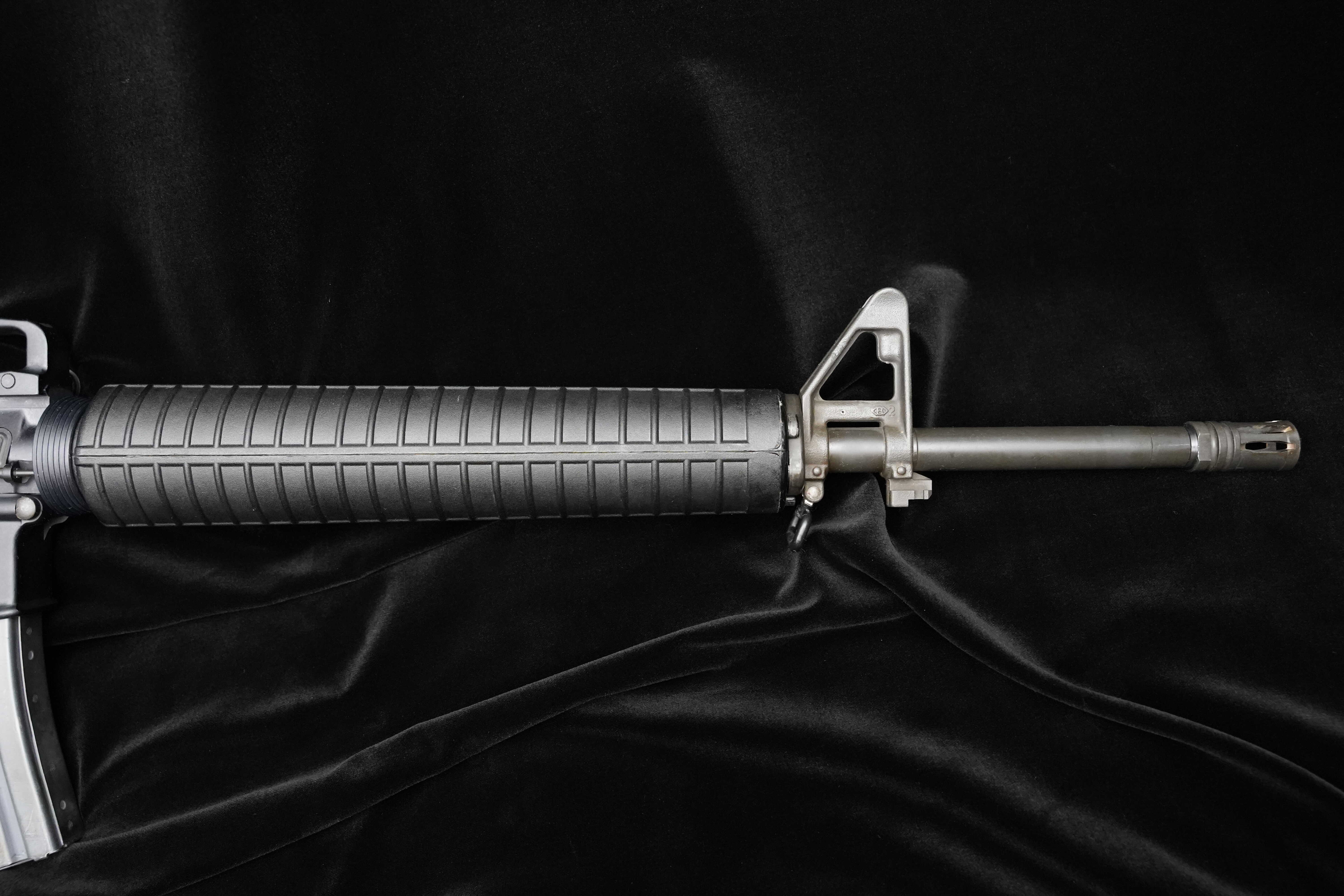

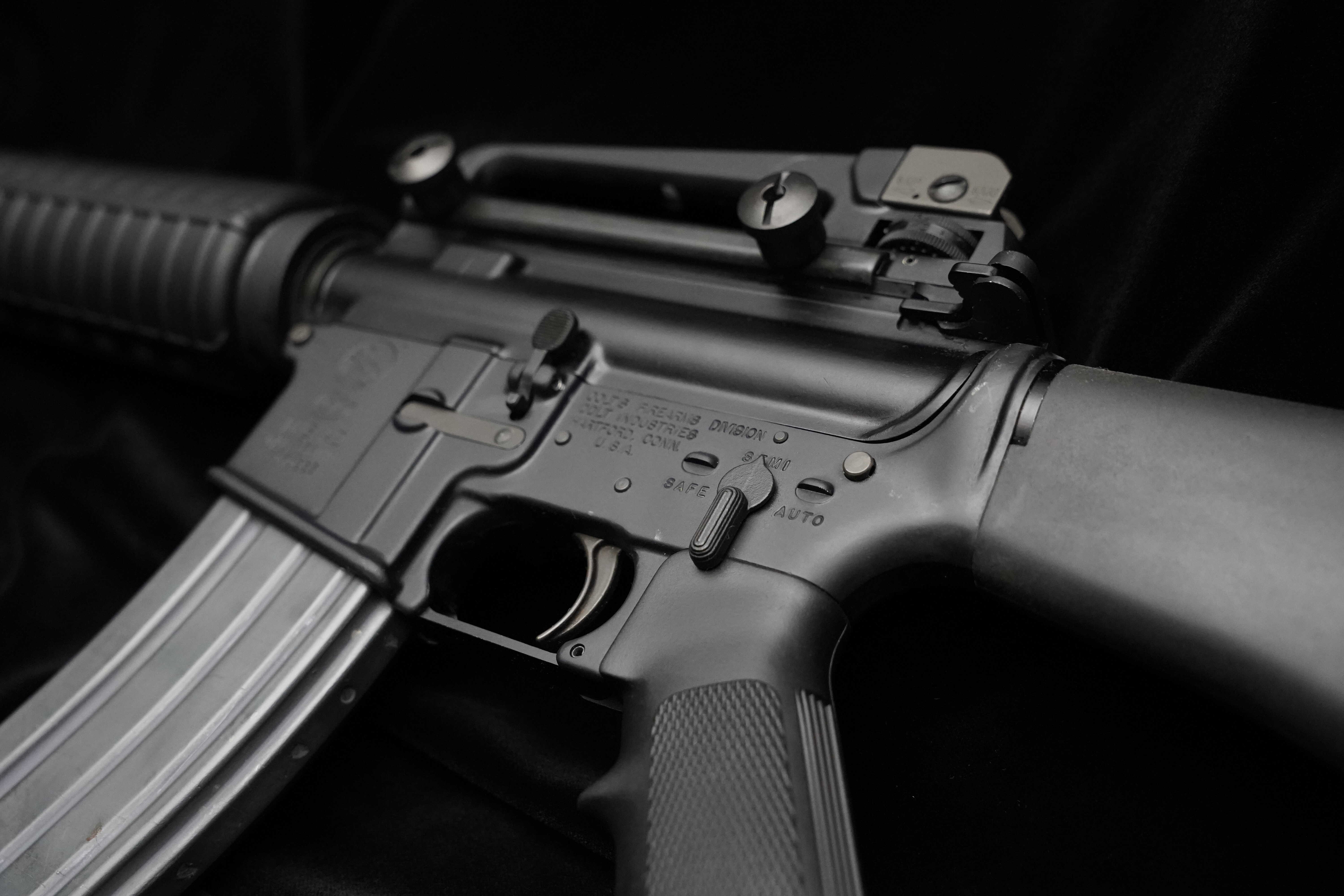

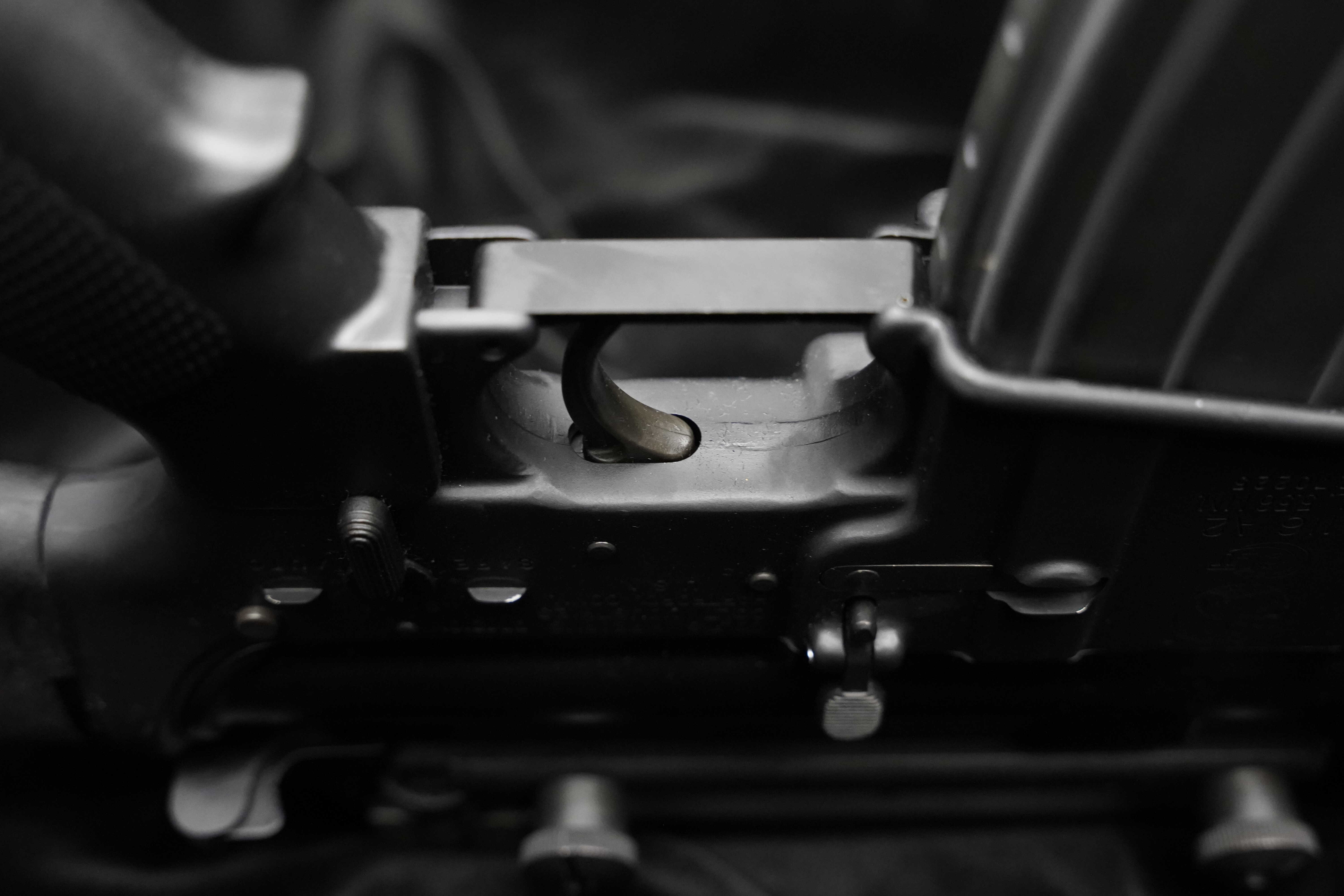

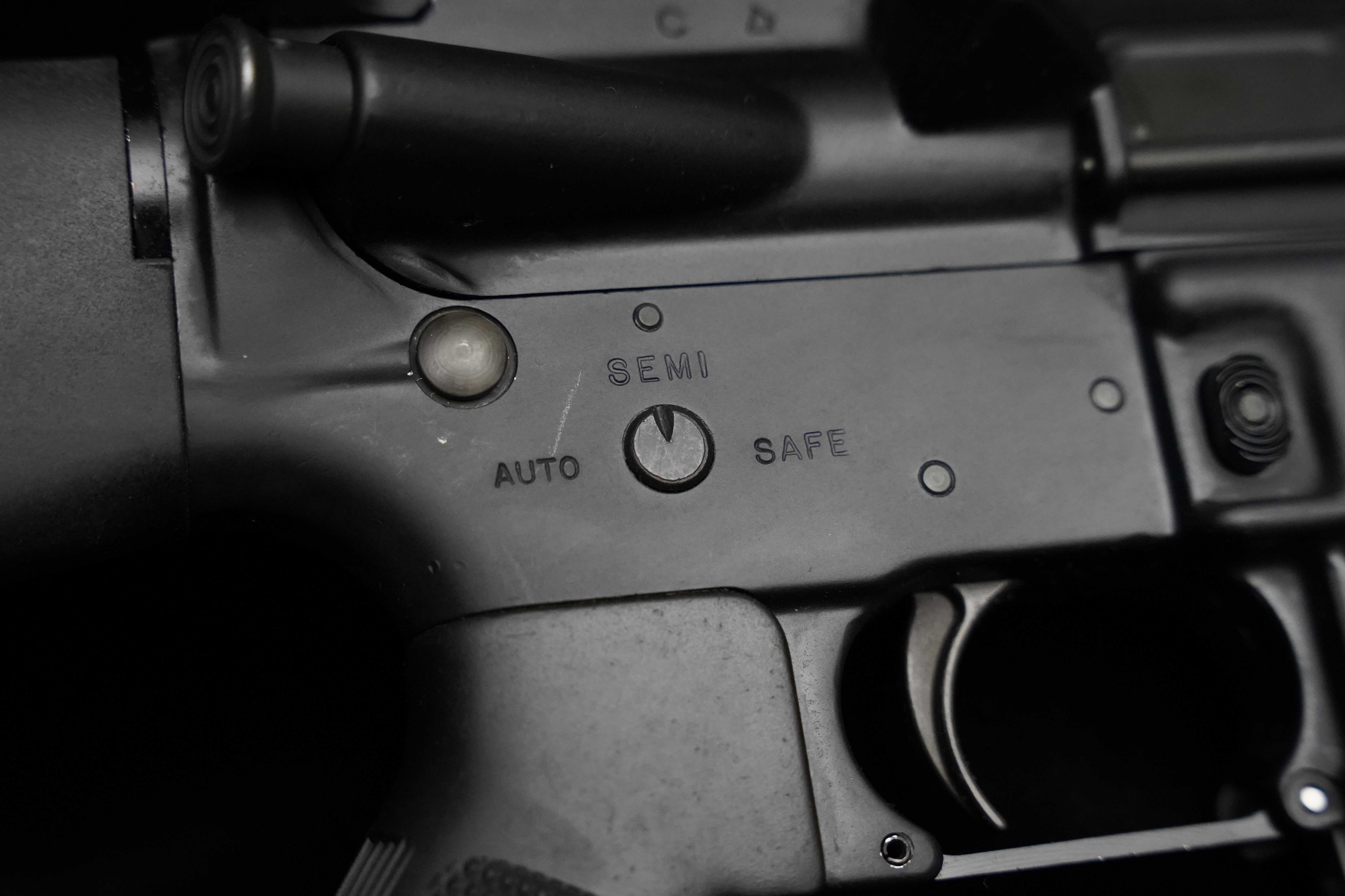

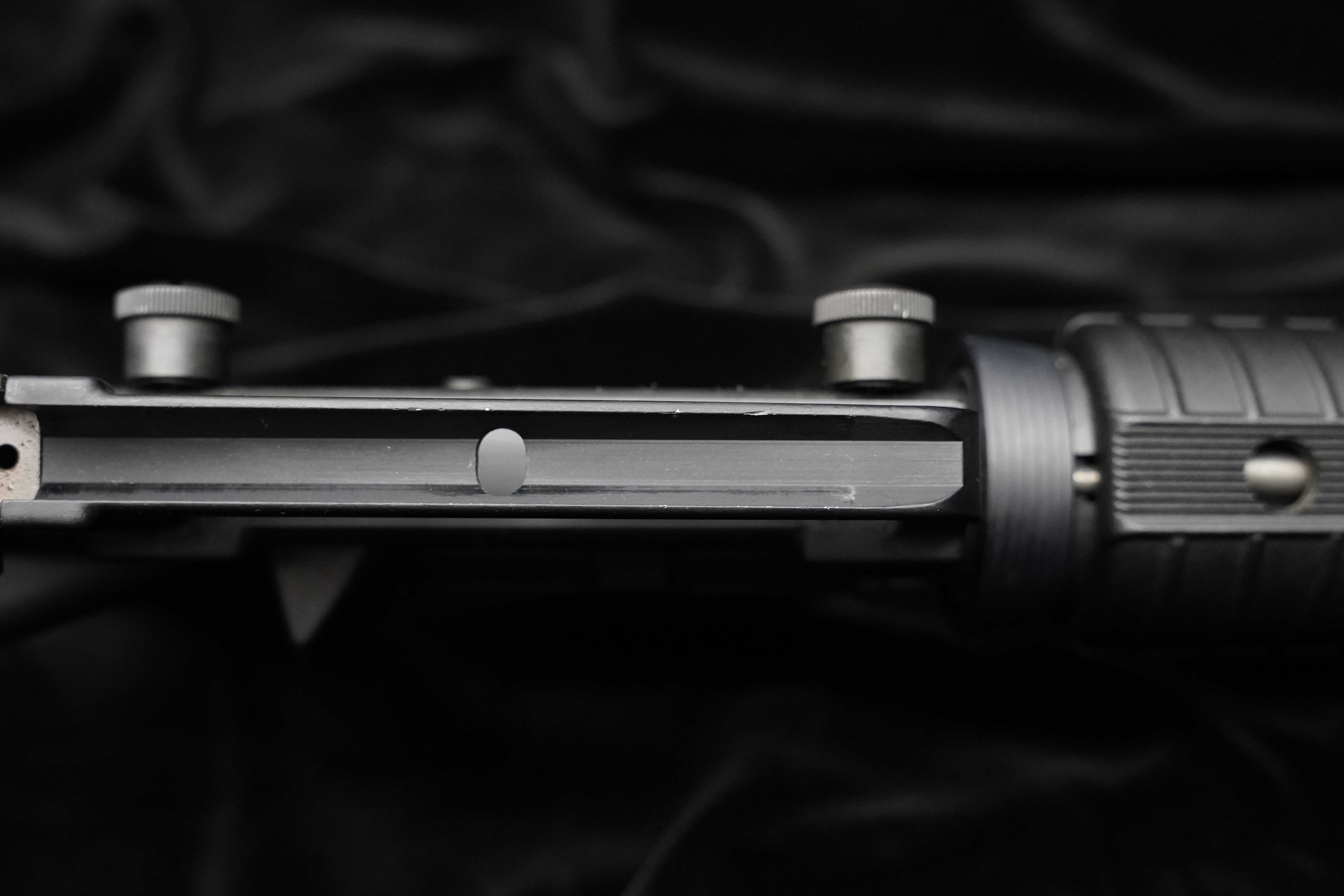

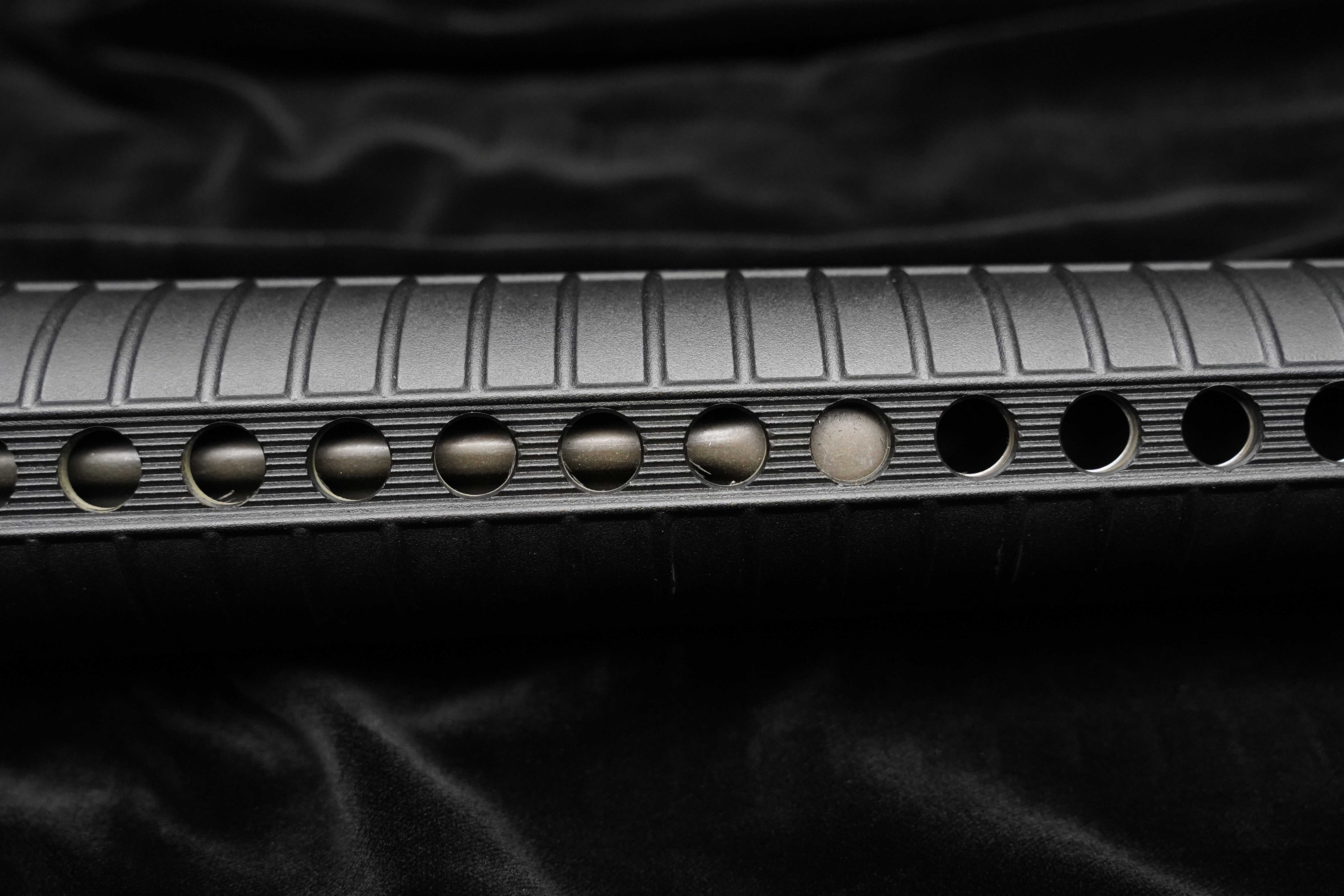

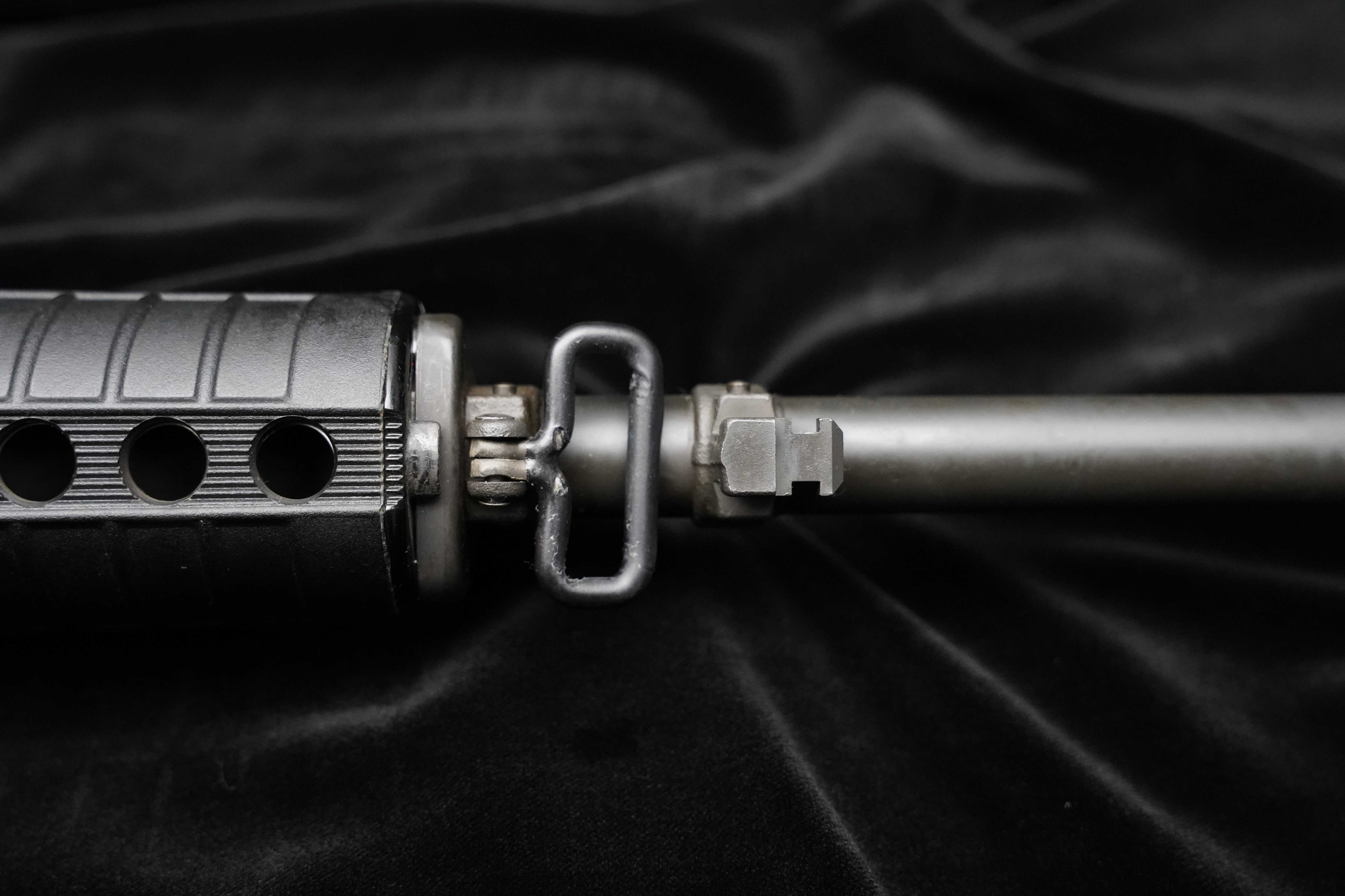

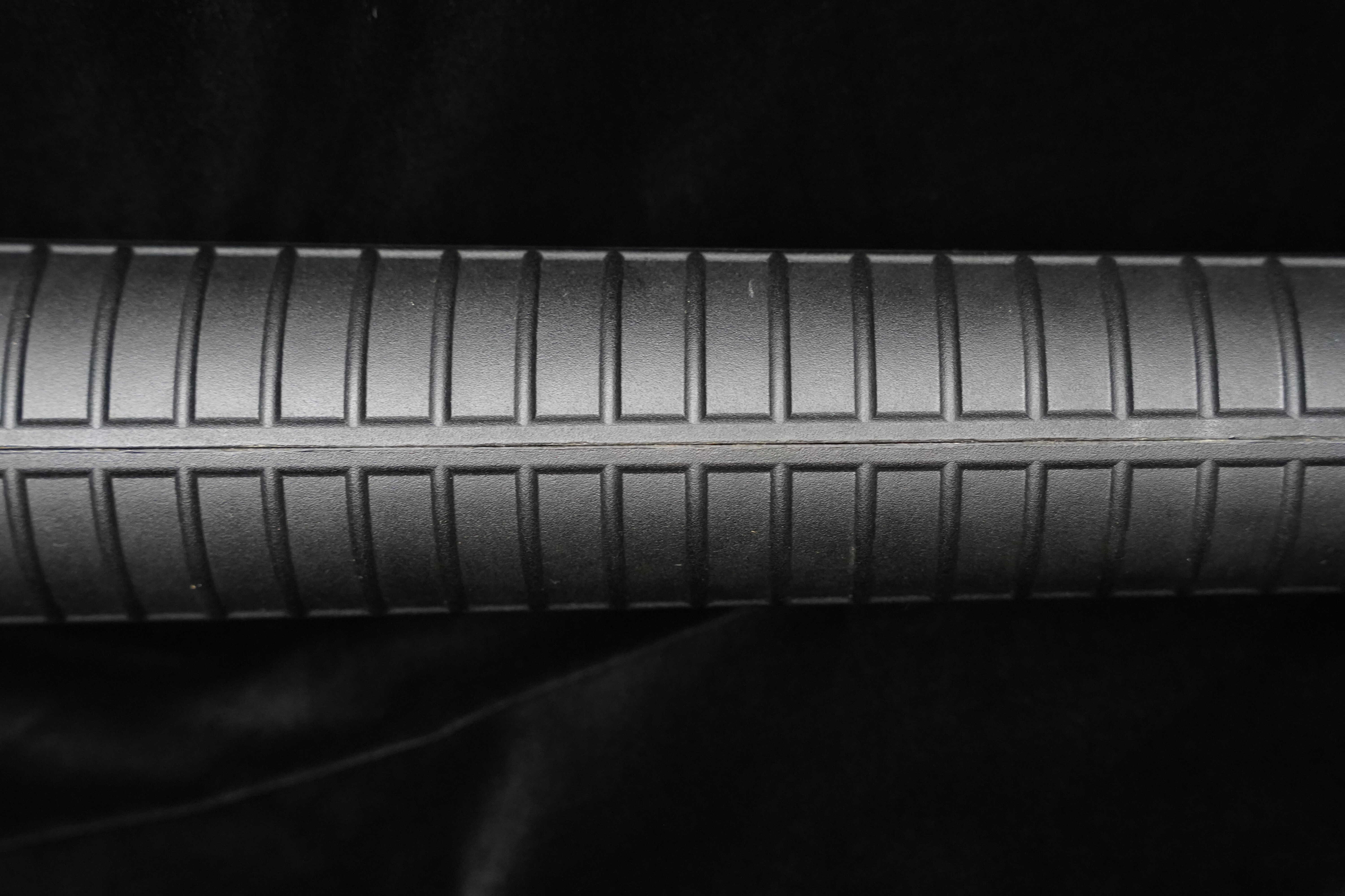

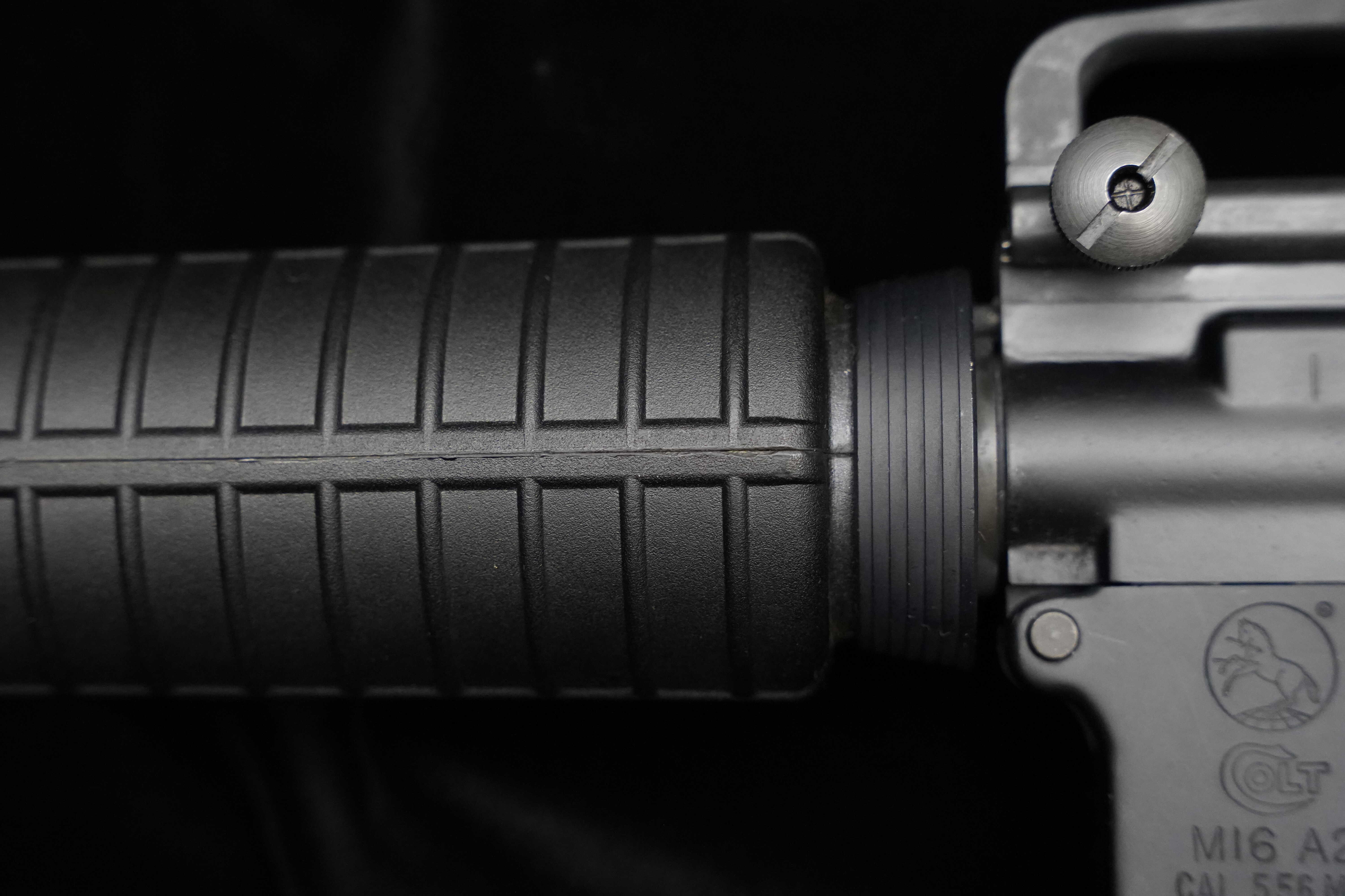

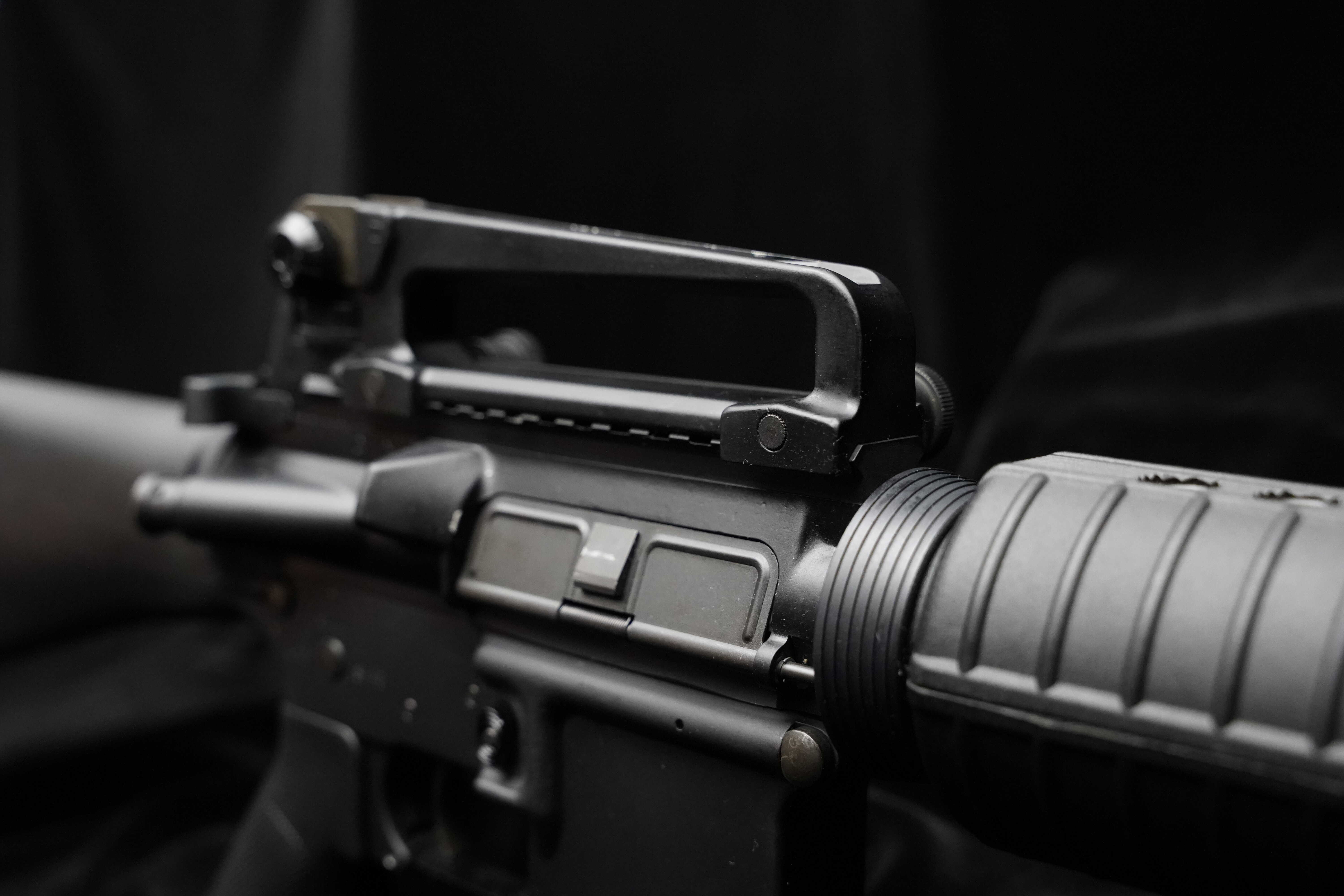

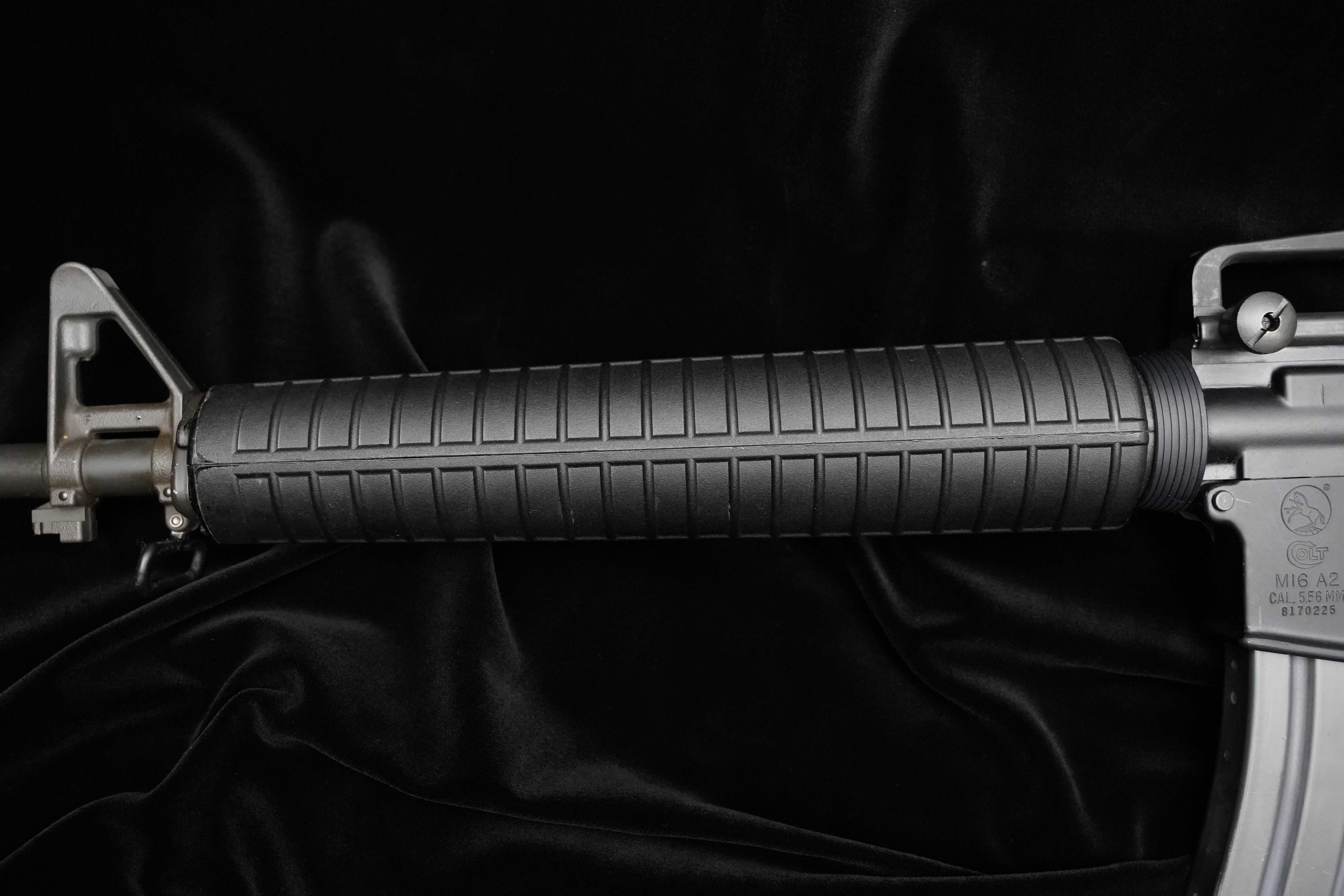

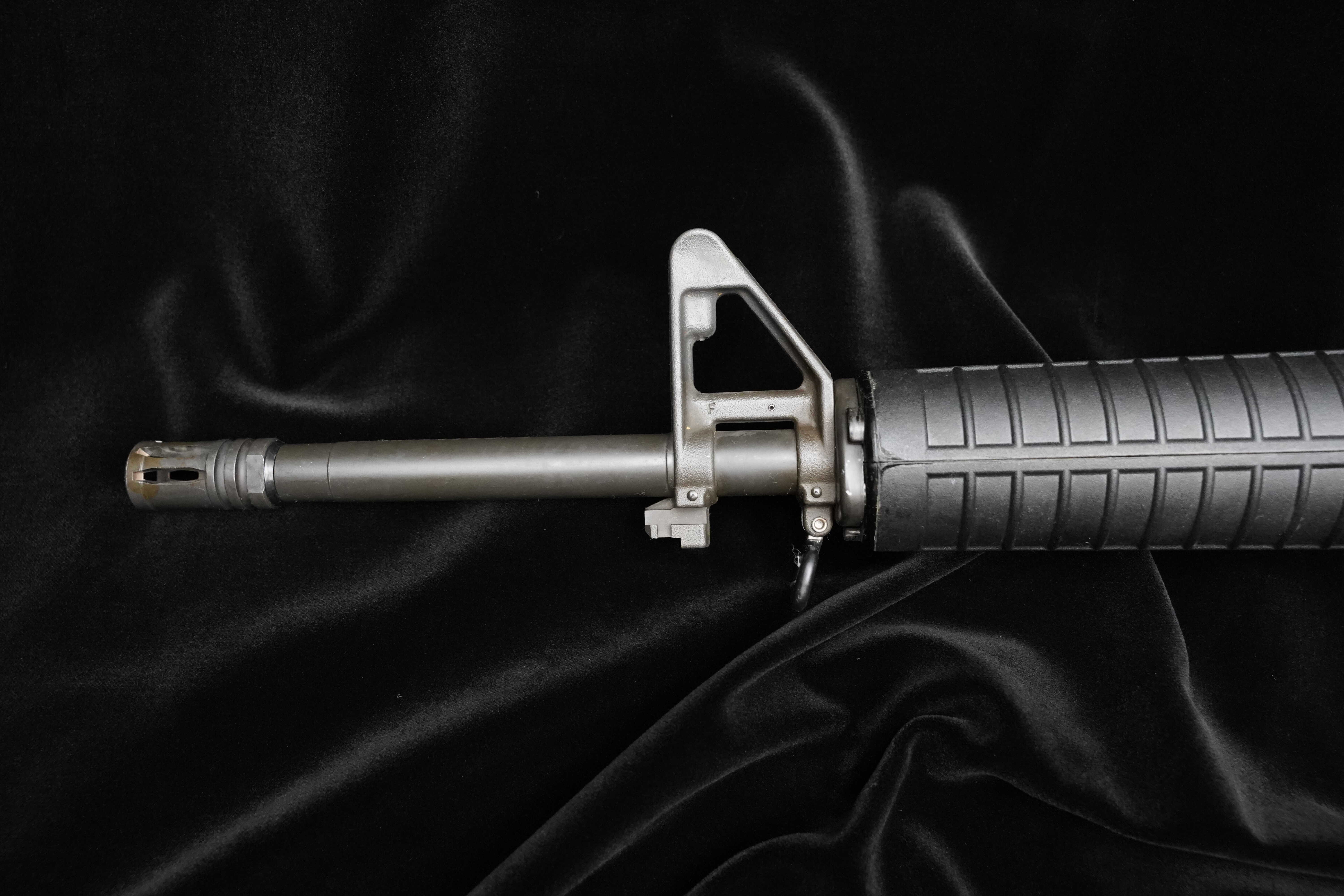

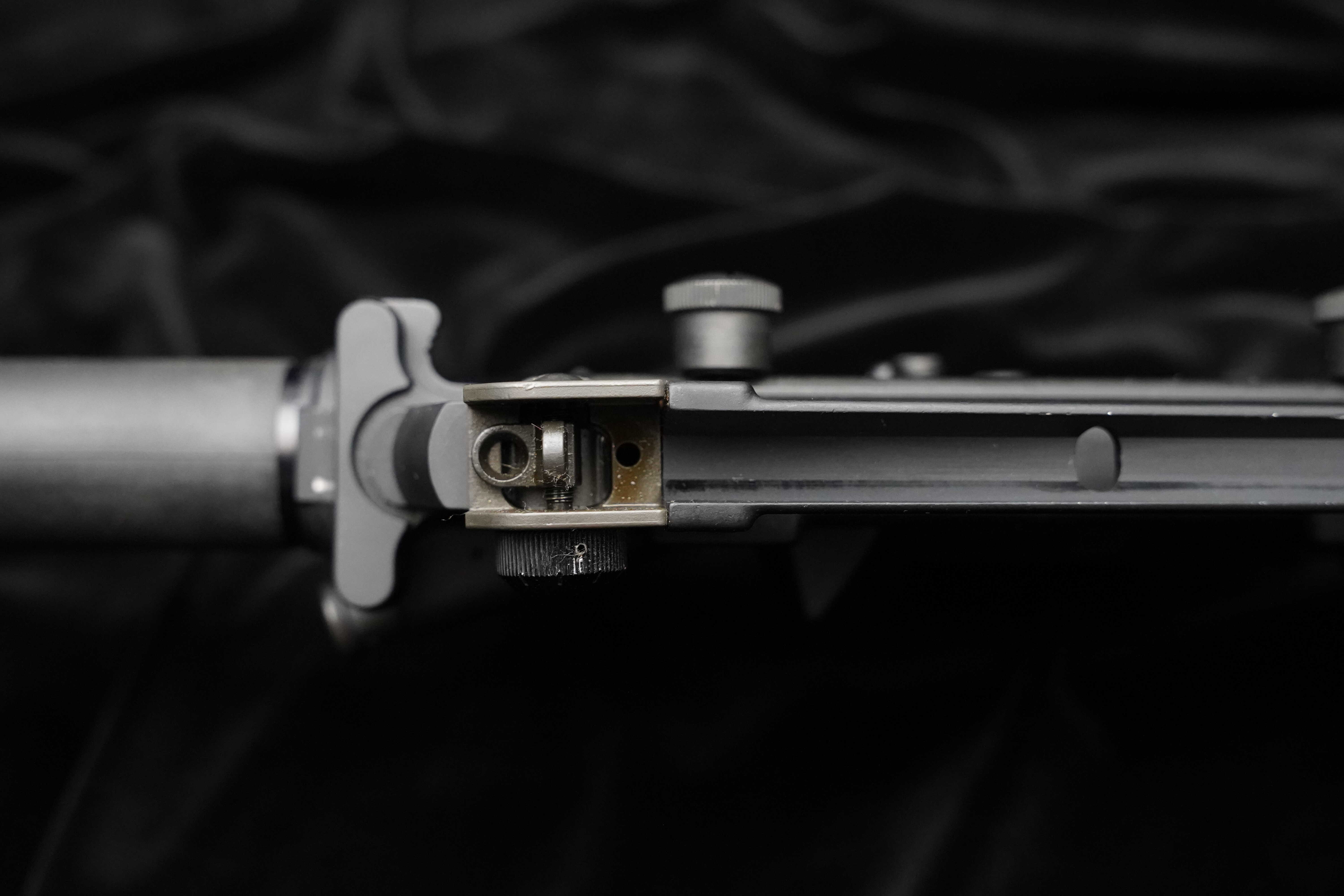

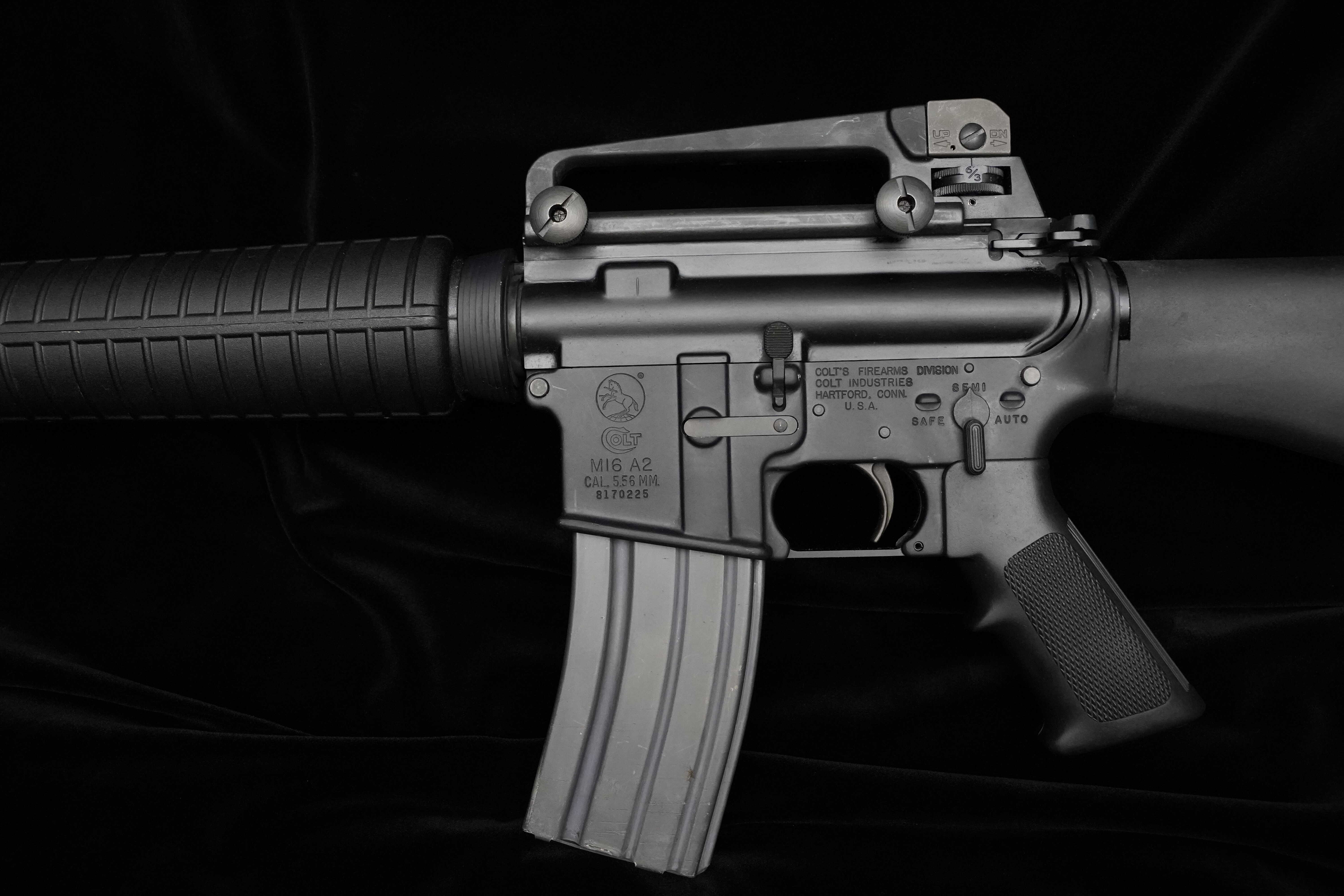

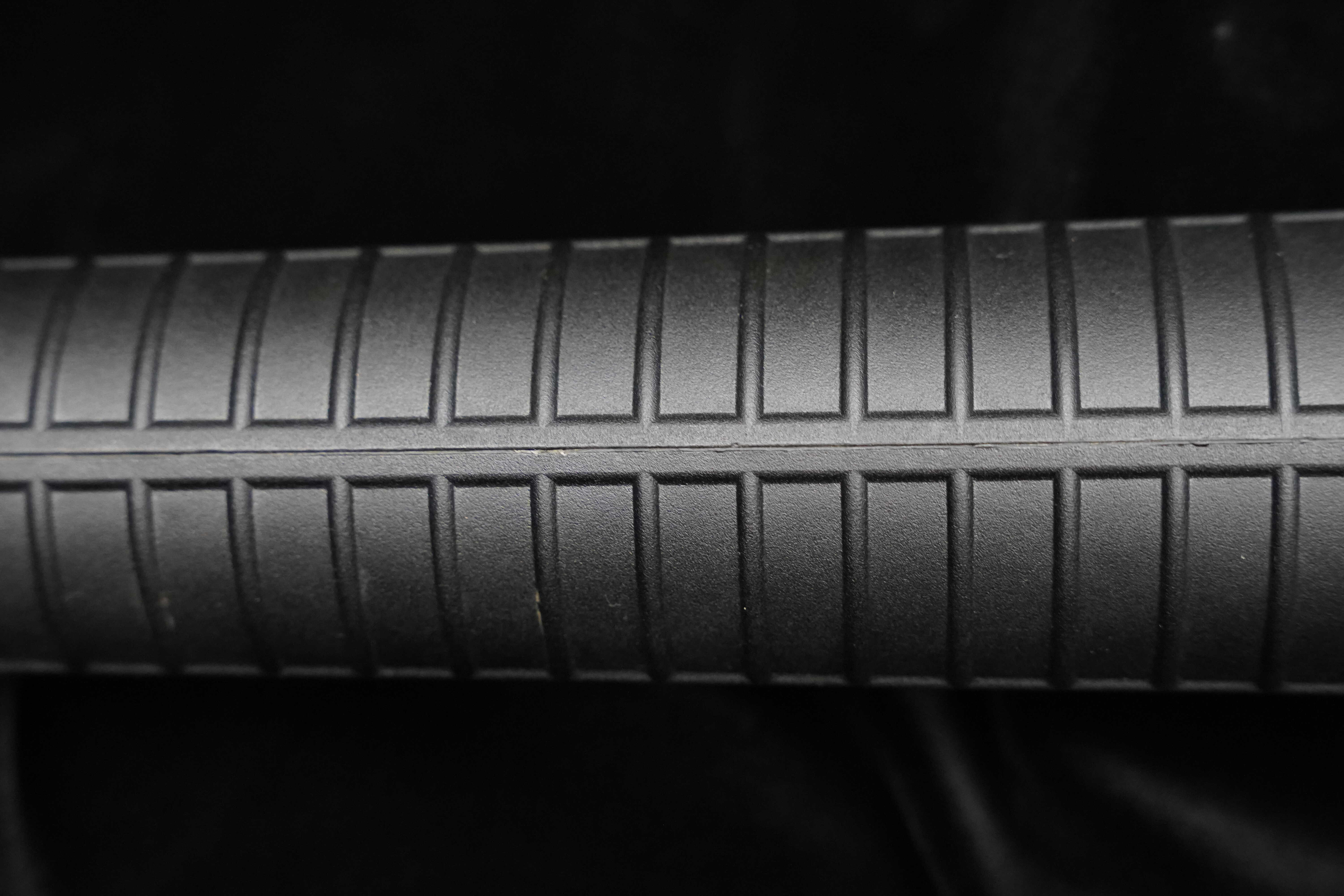

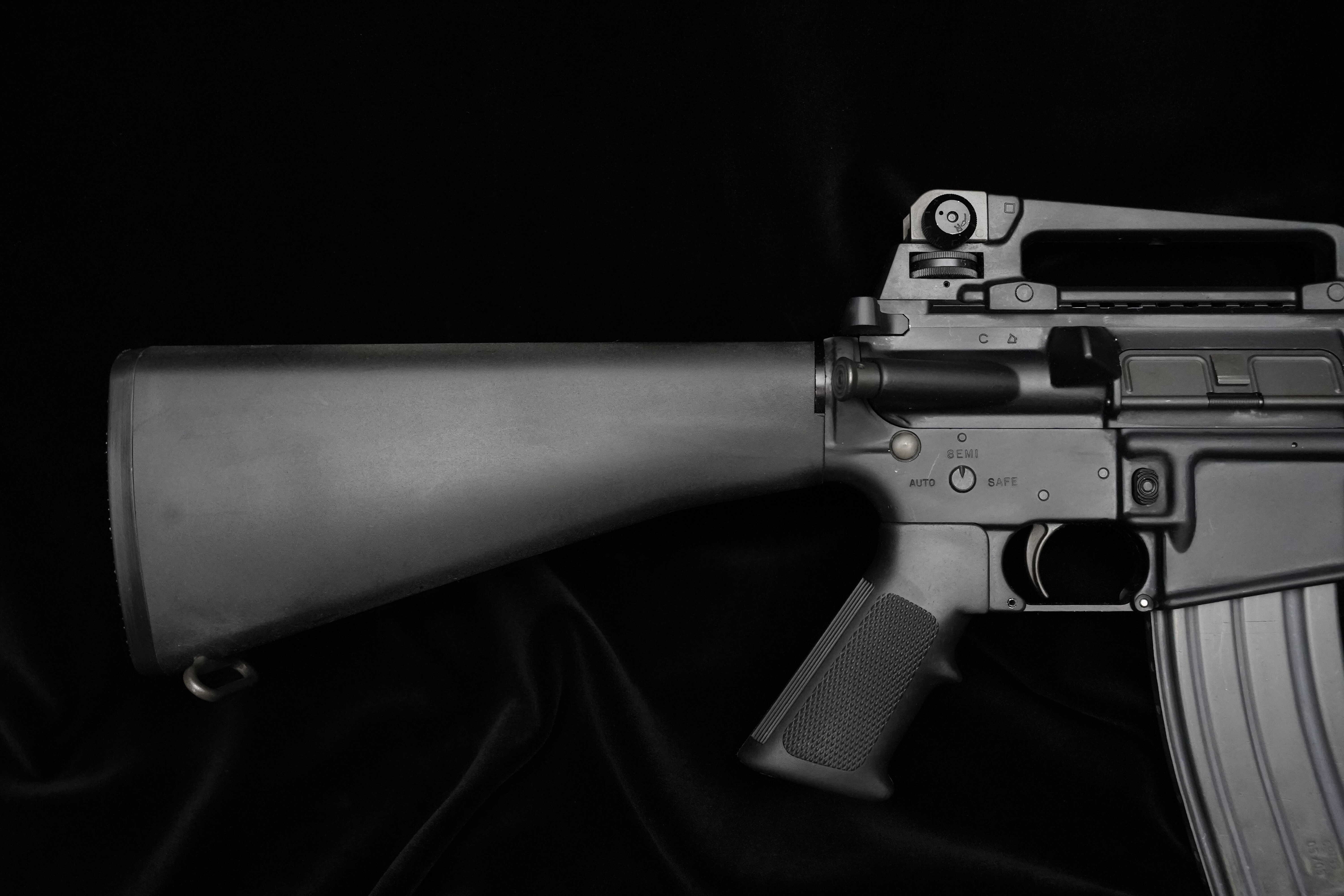

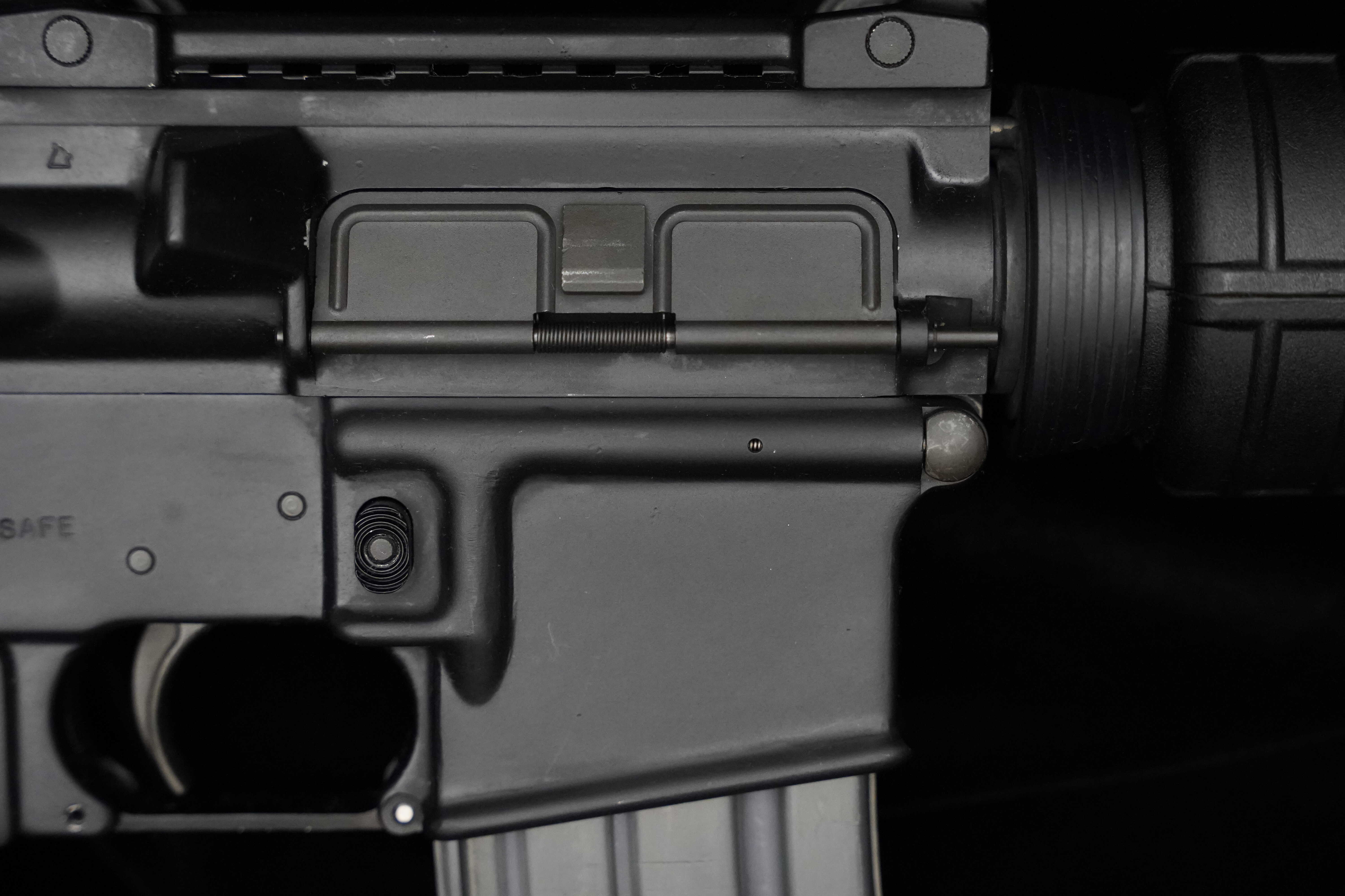

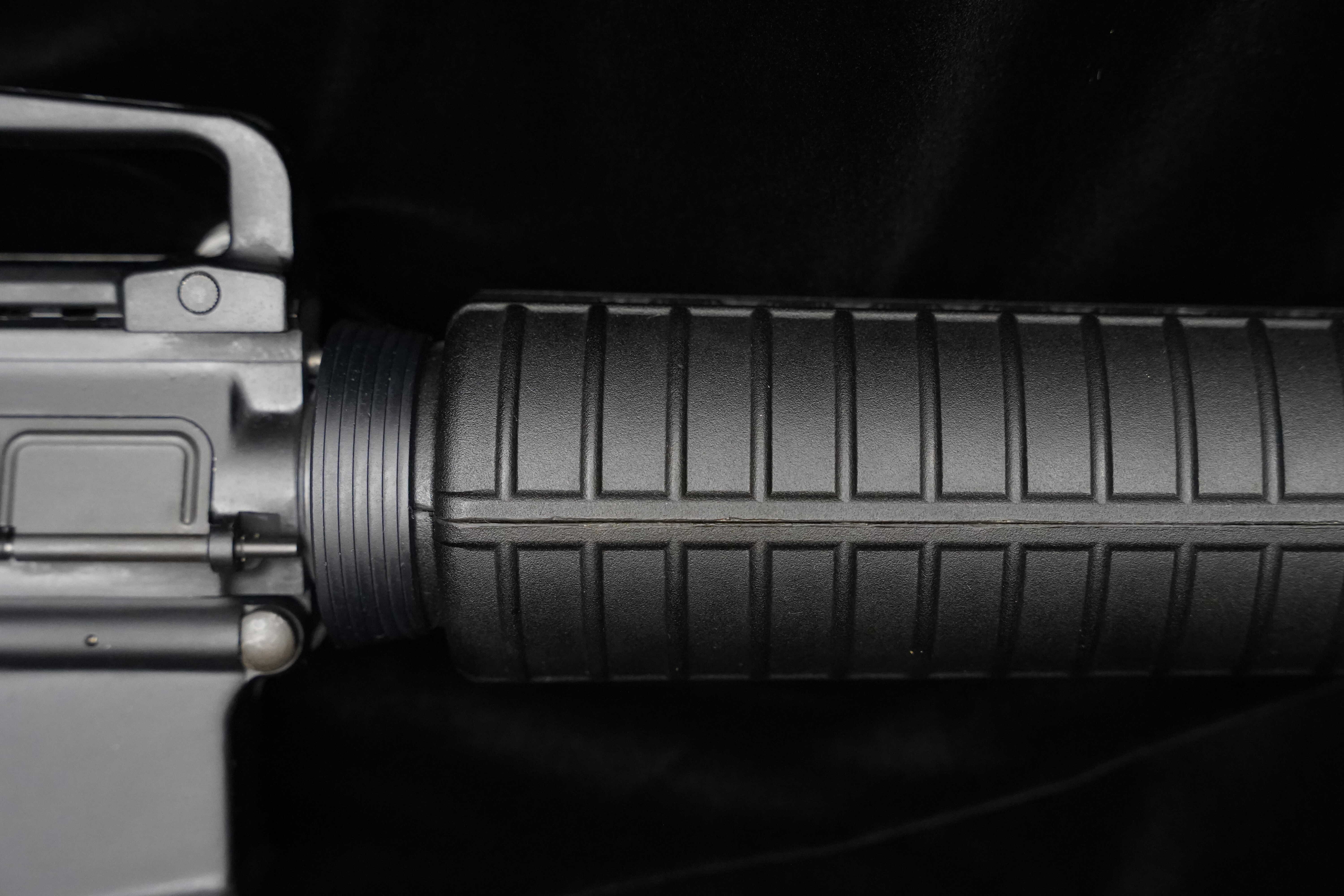

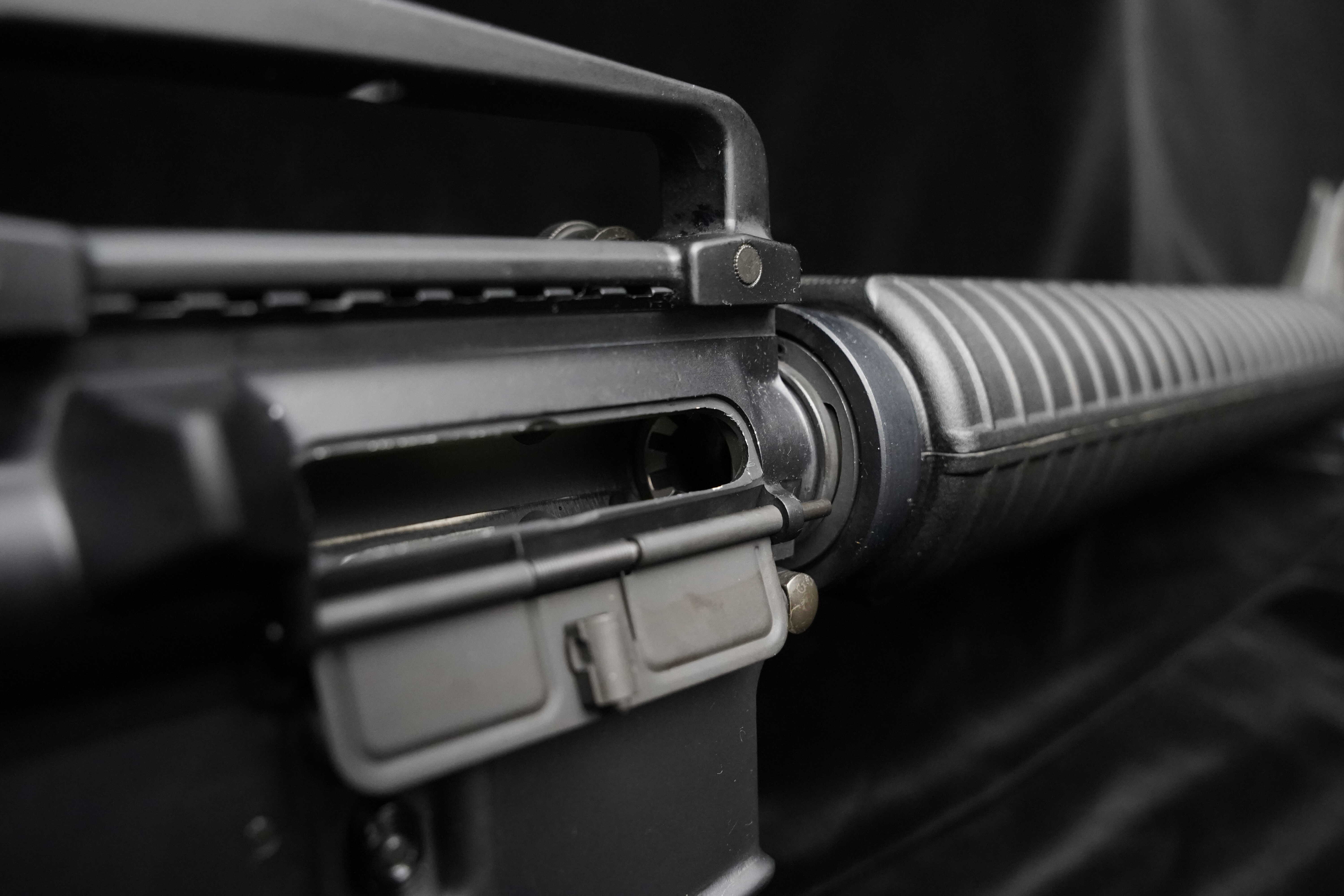

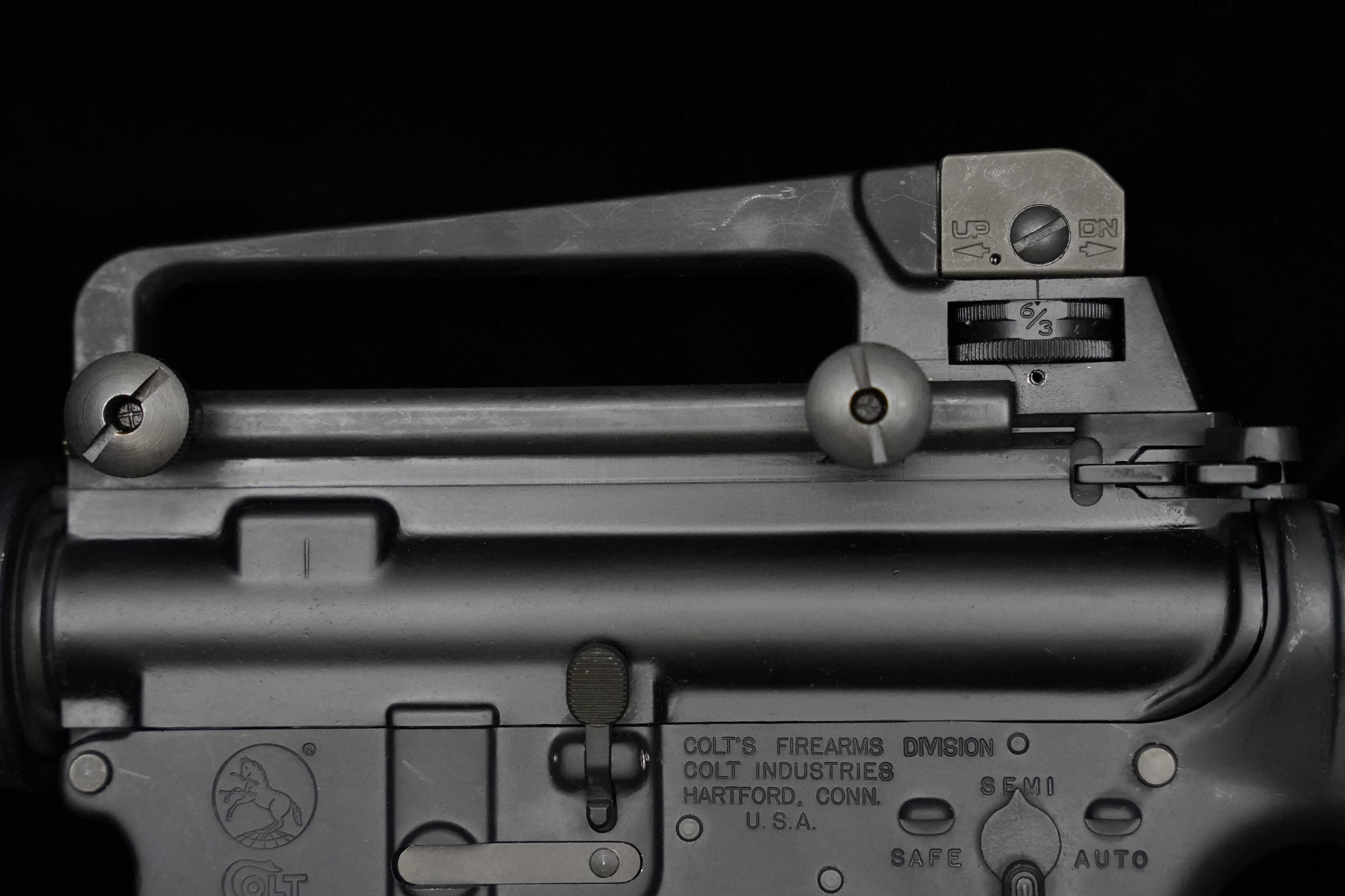

Hi everyone - hope you are all enjoying your weekend.

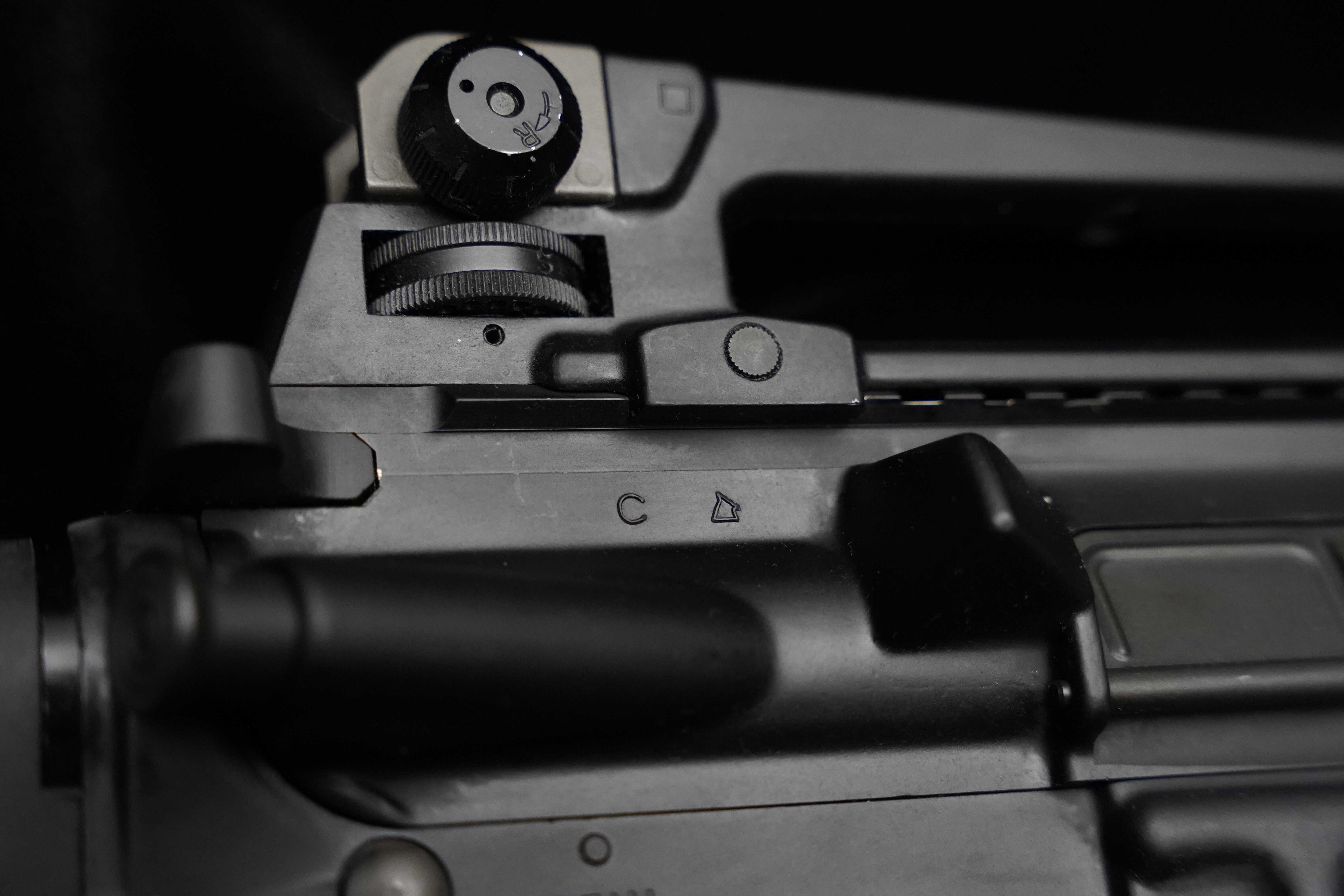

I posted this up in the Retro M-16 thread which was the wrong venue, but got some really great thoughts as I was confused how Colt would have record of this being Mfg in 1995, yet it's fully transferable.

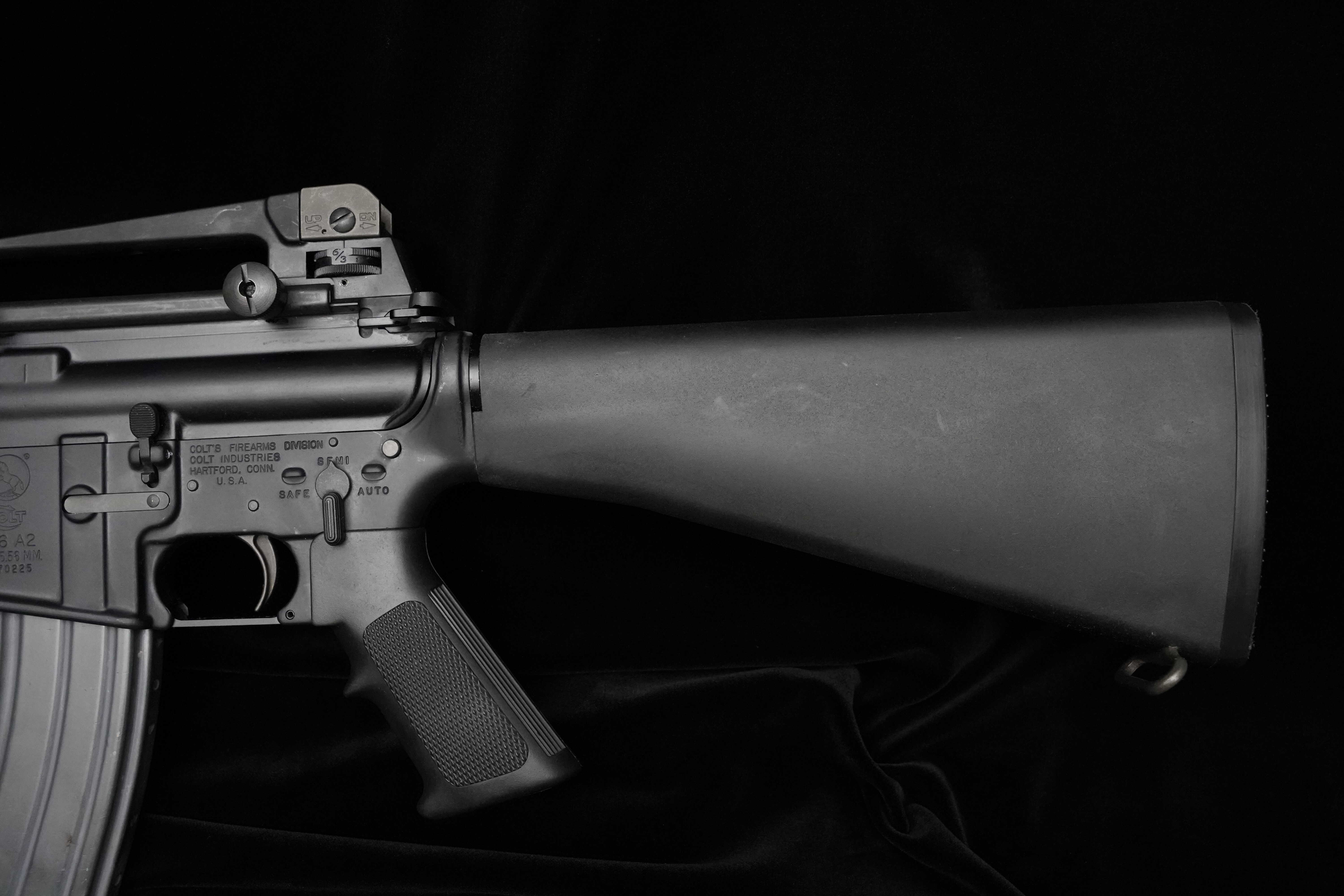

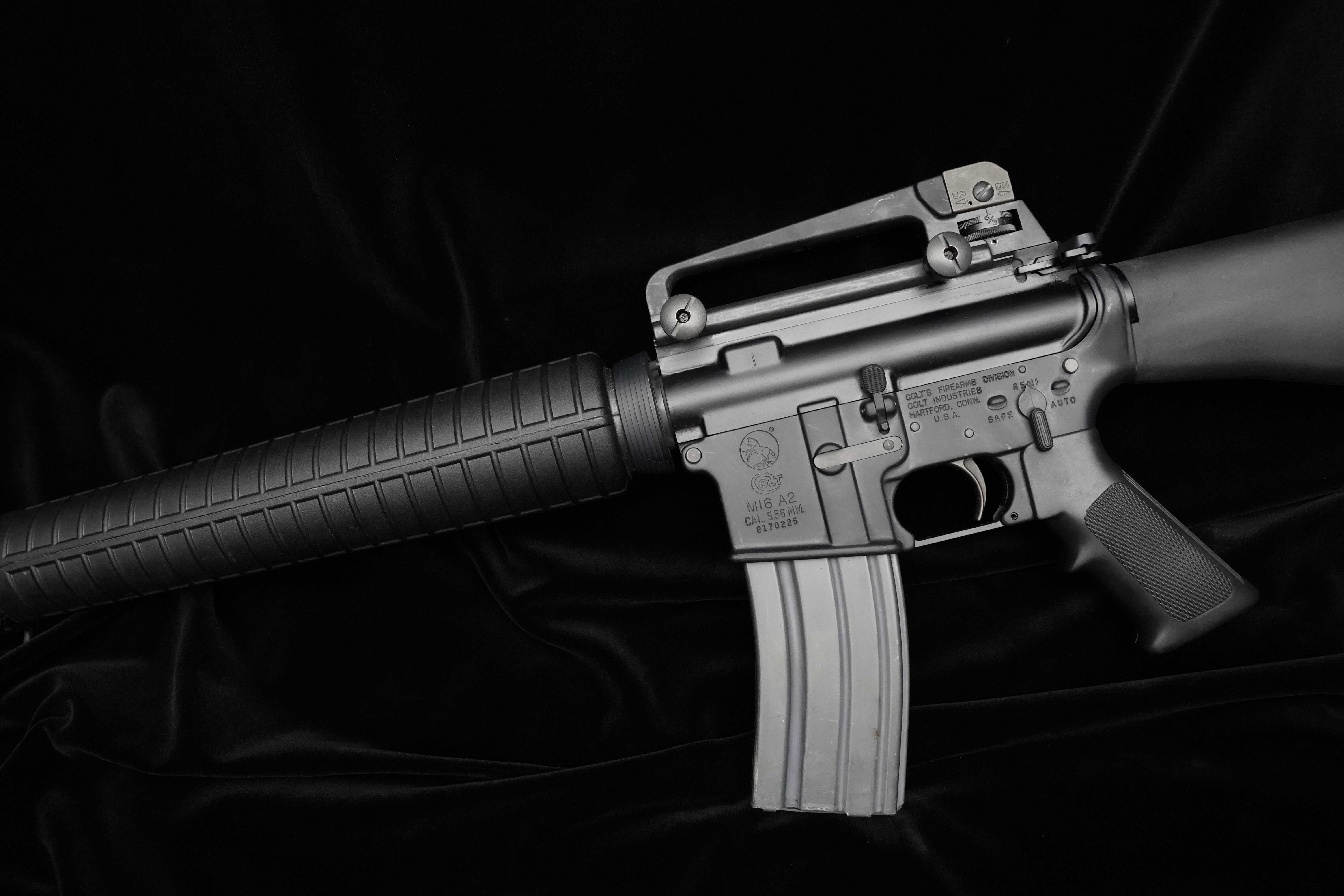

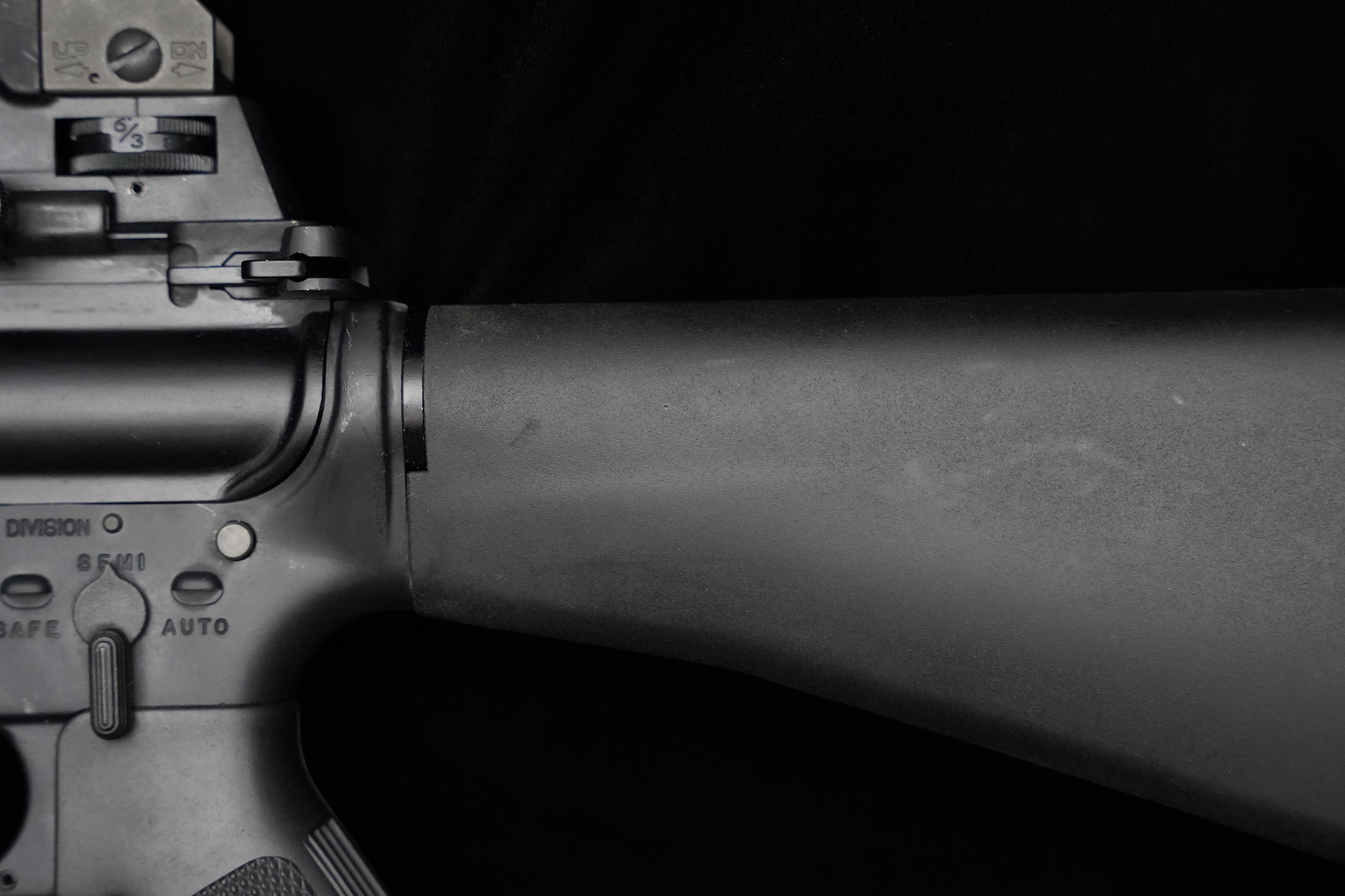

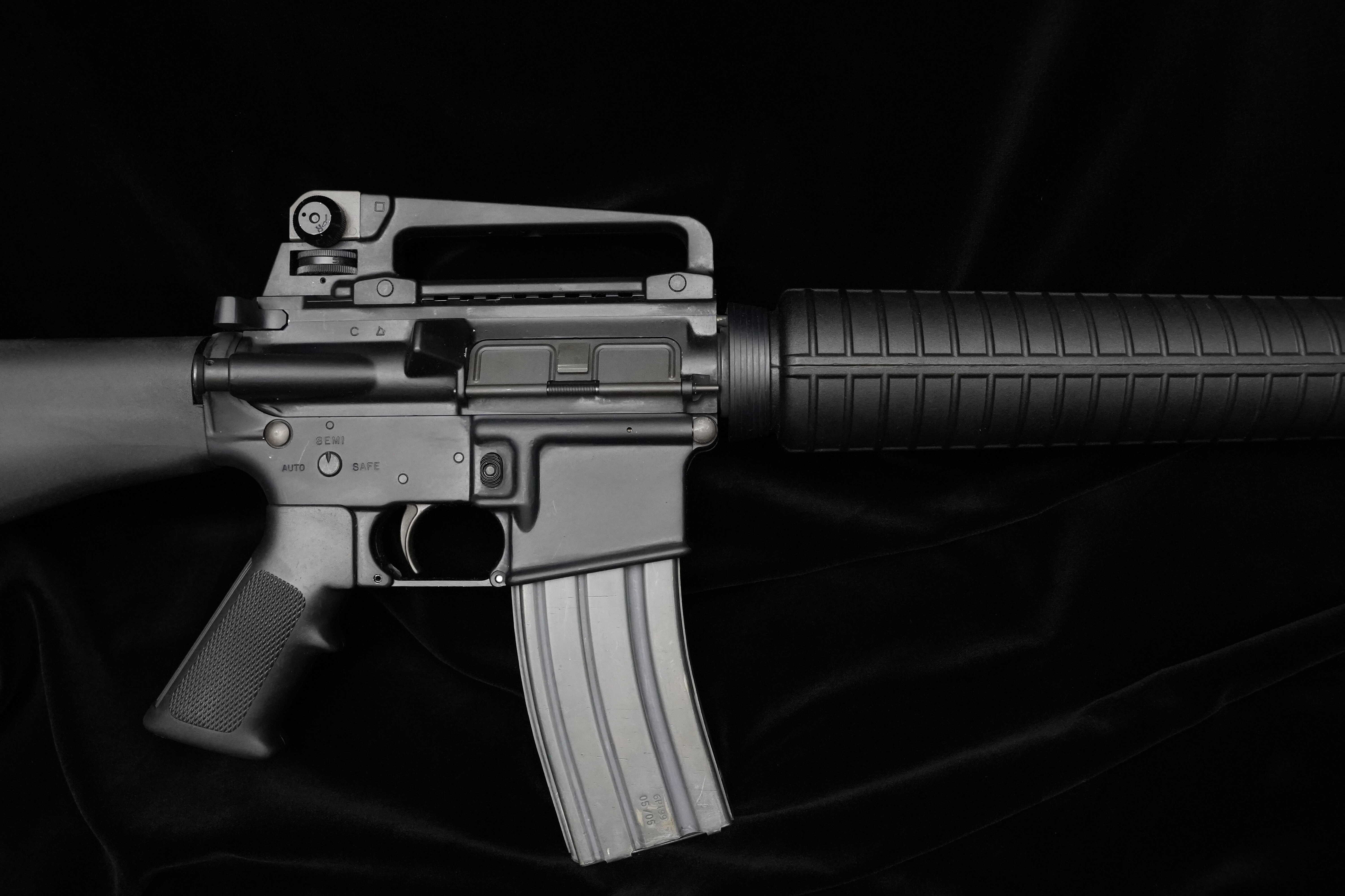

The serial on the A2 lower is 8,17X,XXX as well, which seemed pretty late.

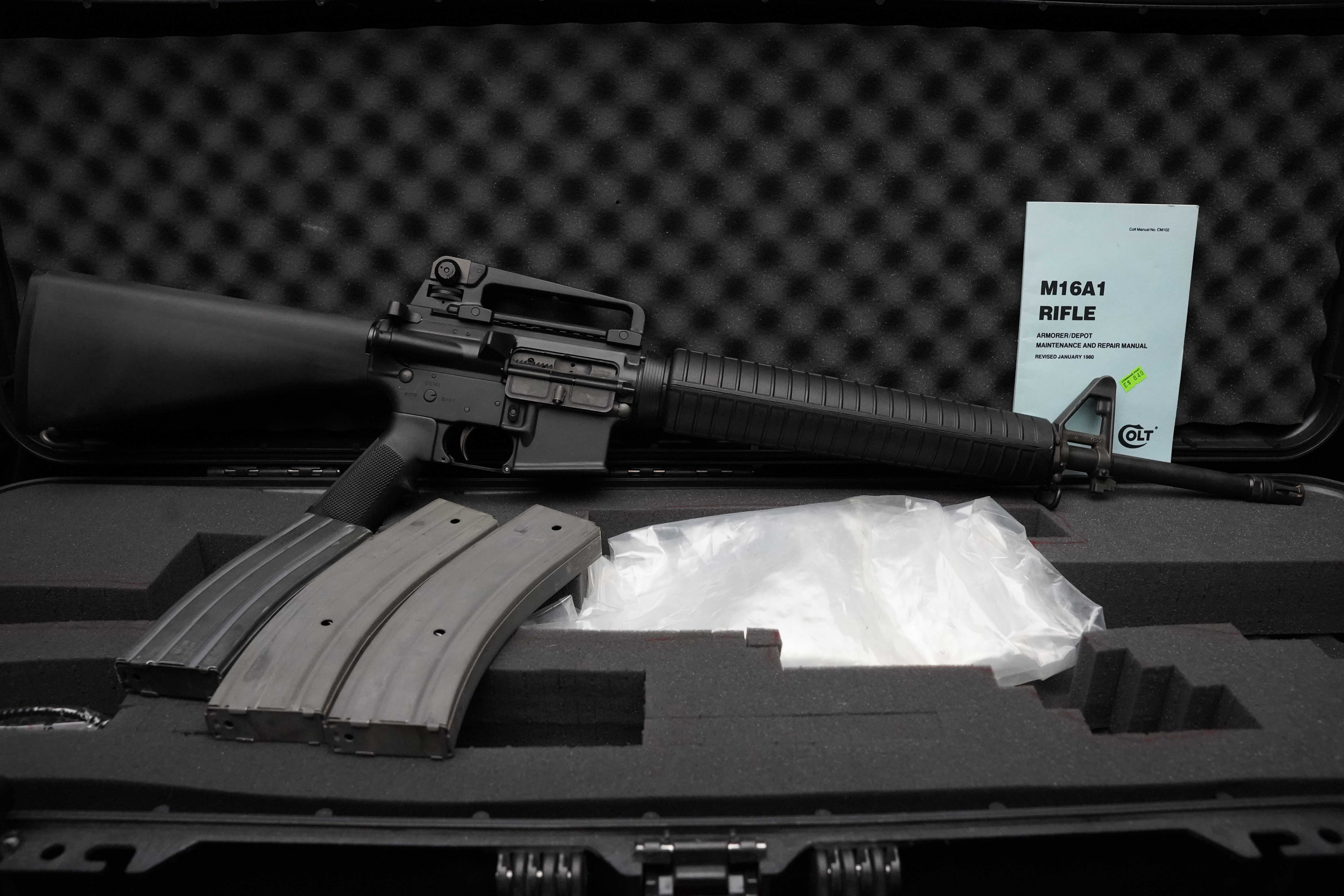

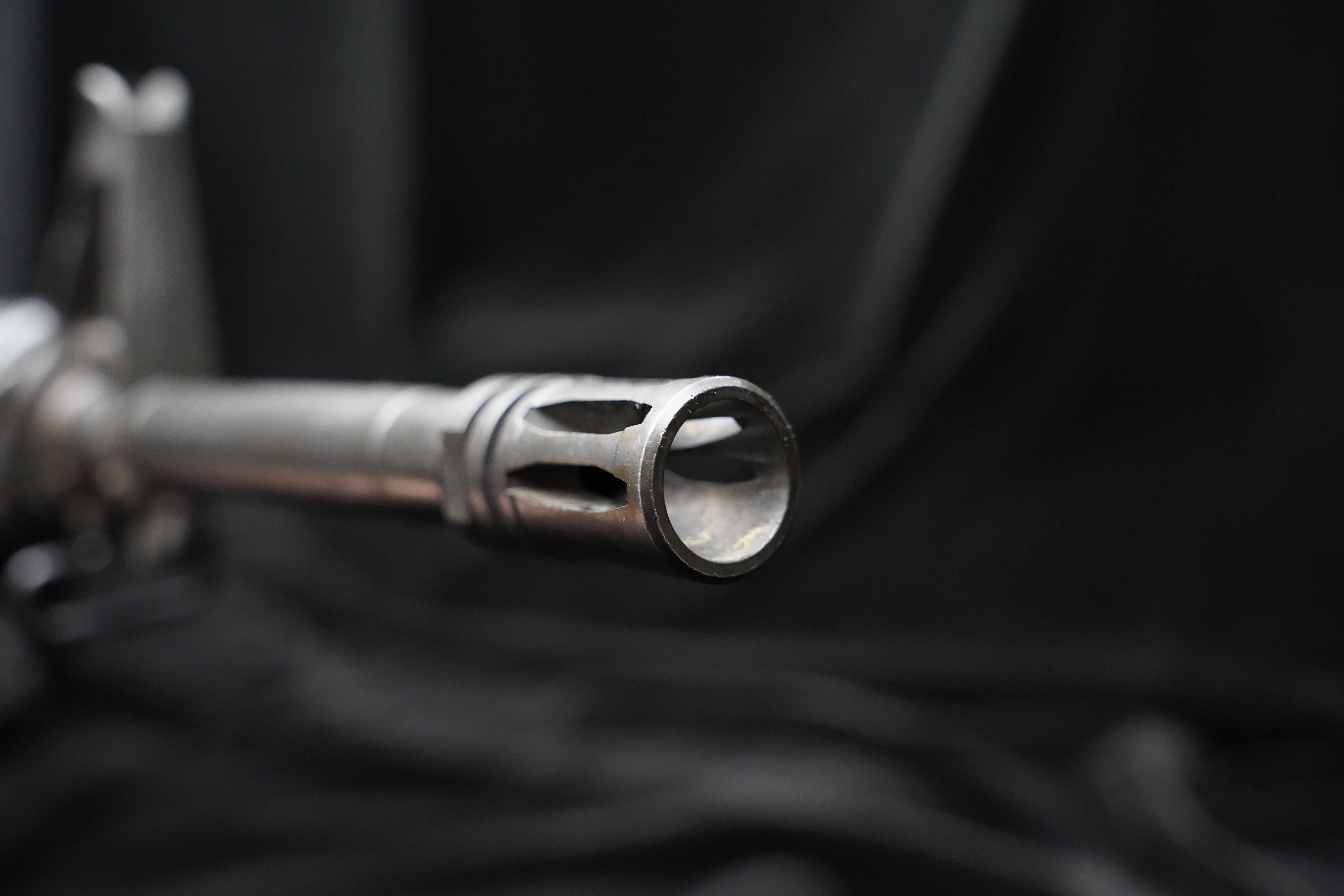

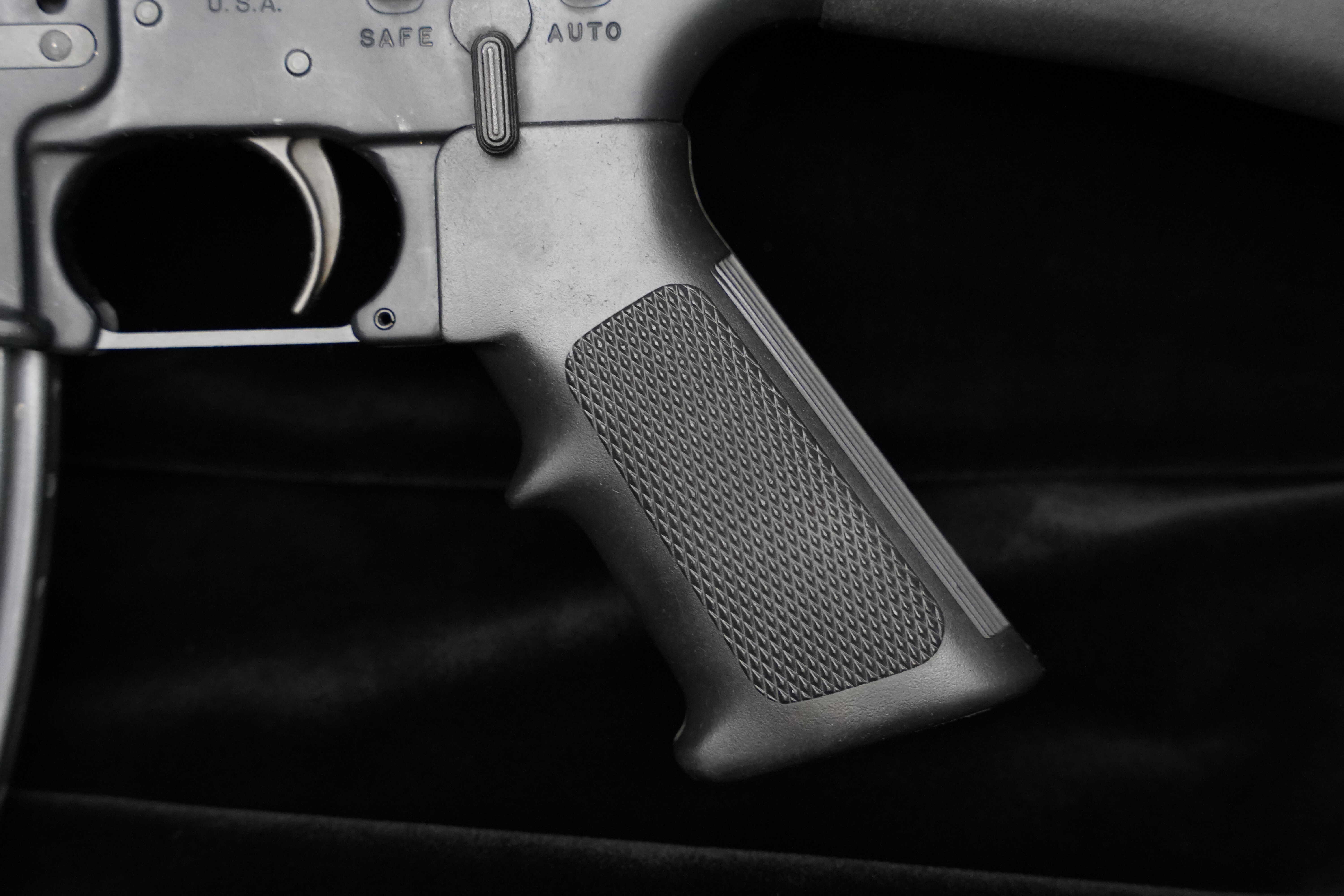

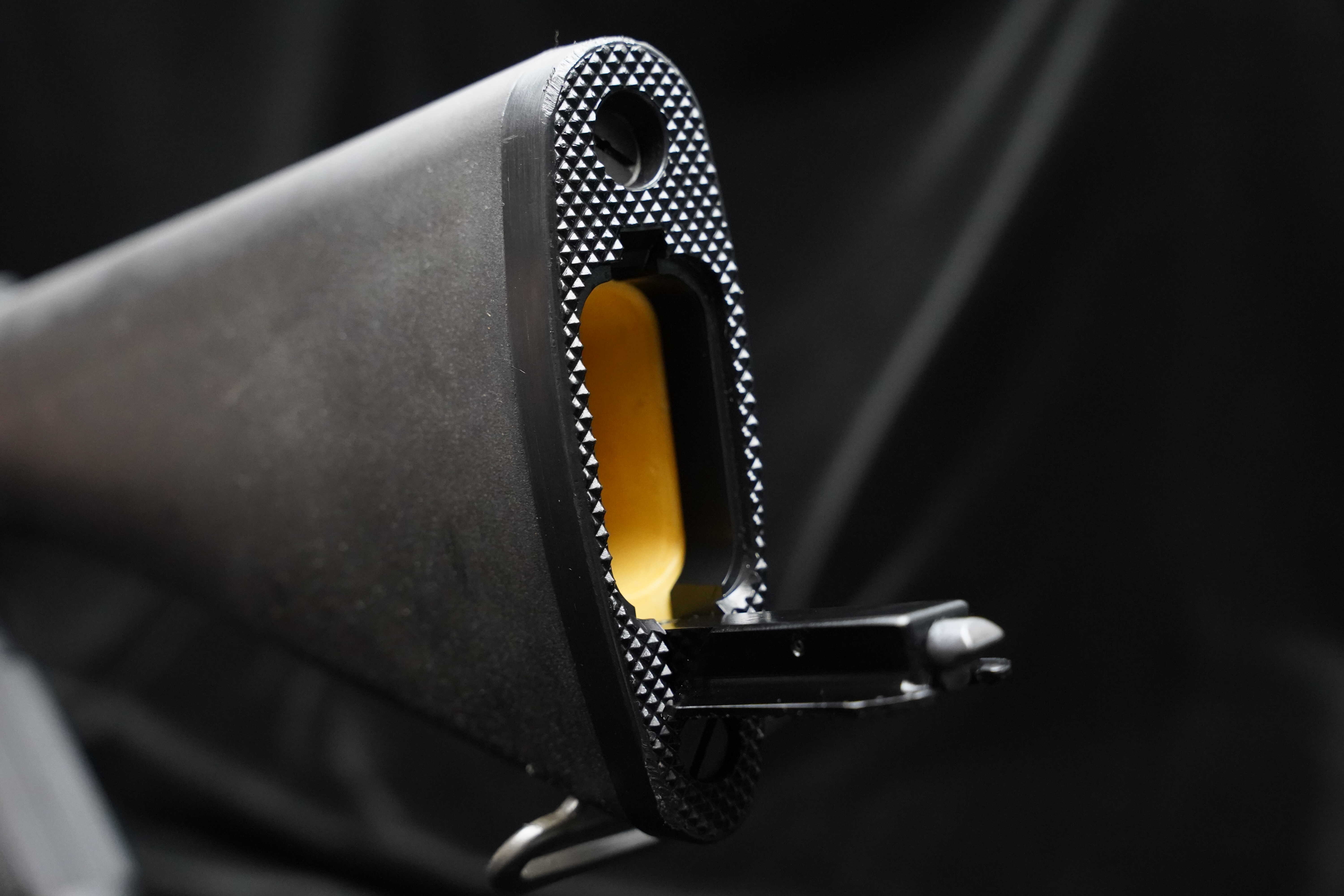

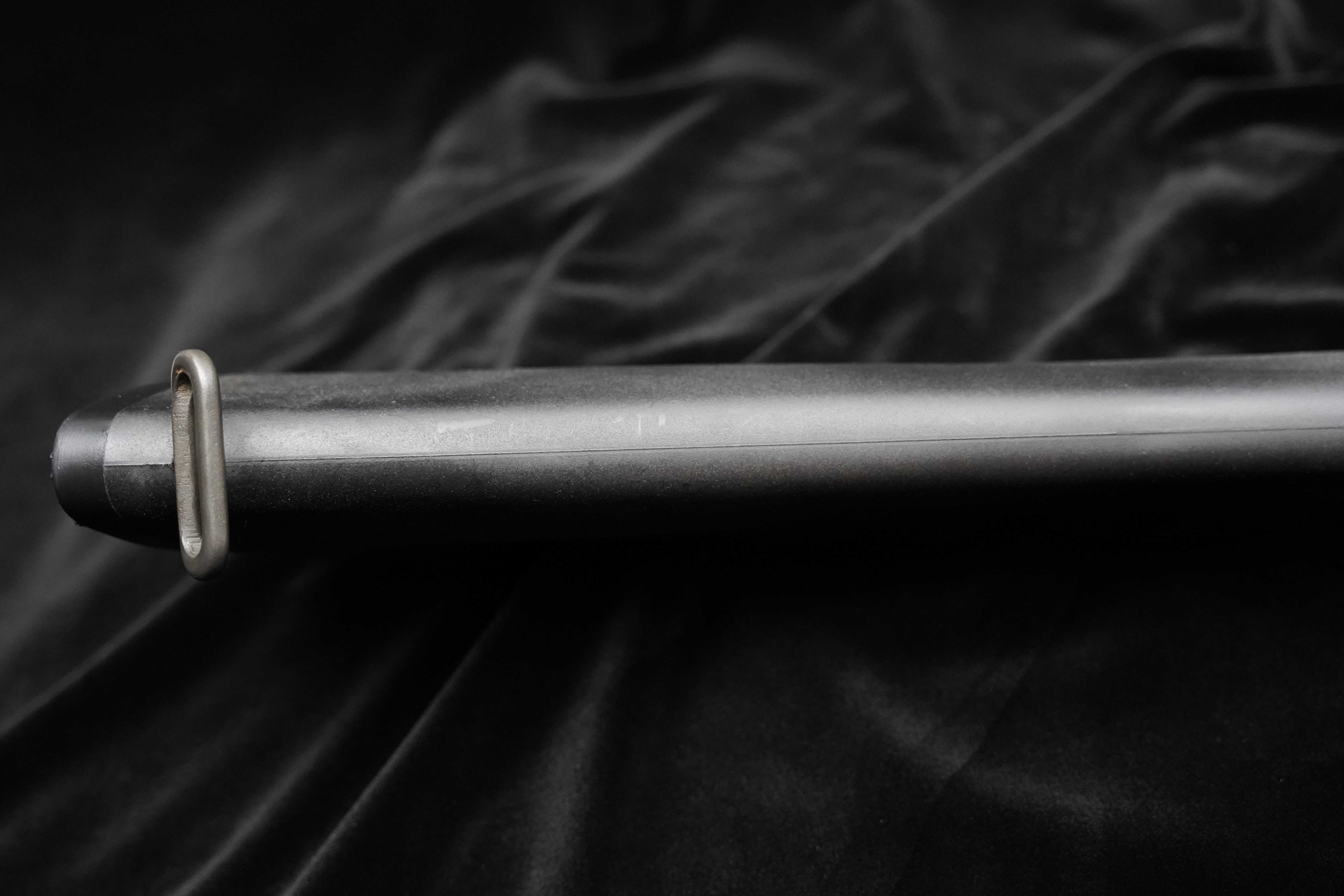

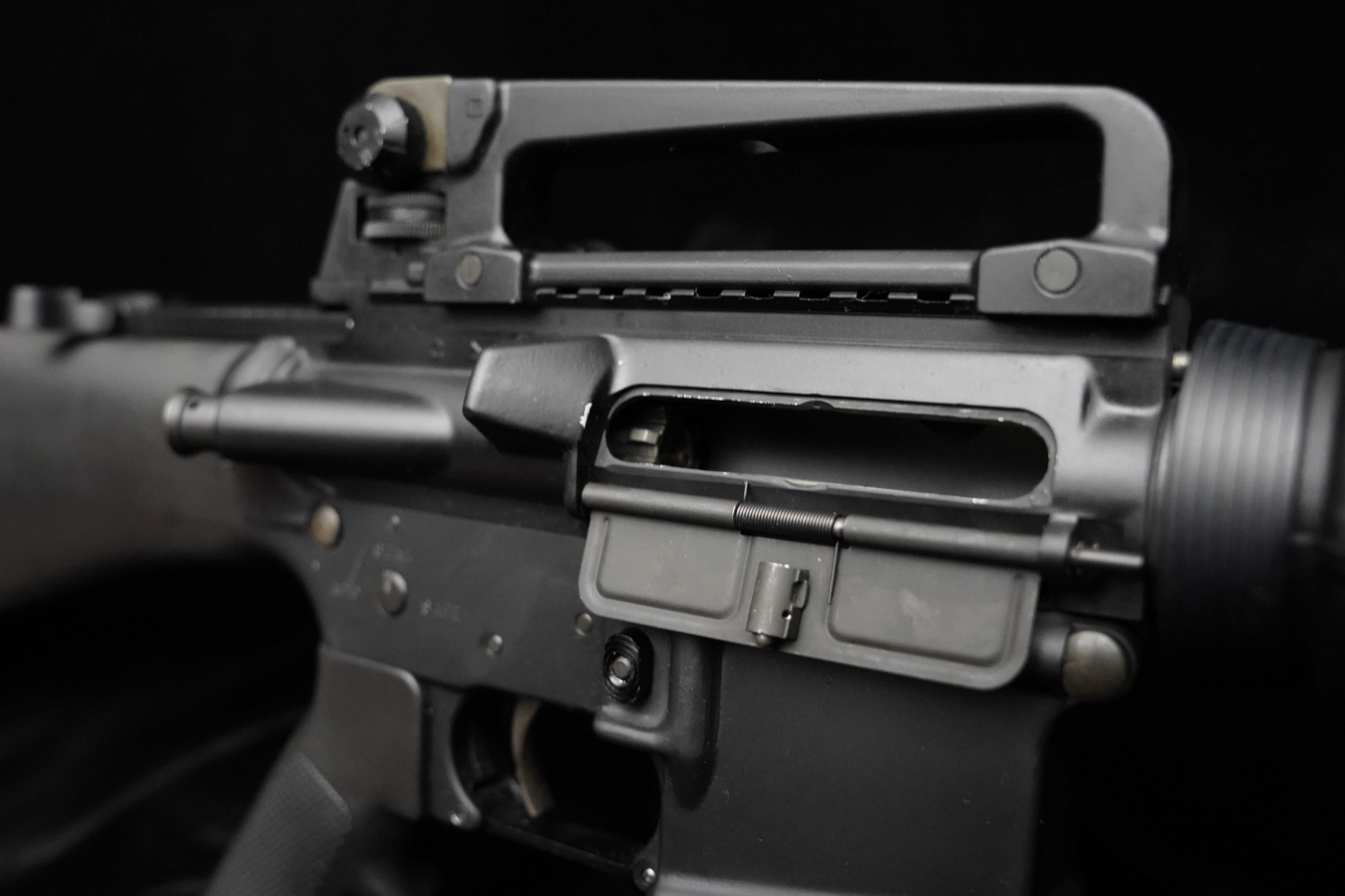

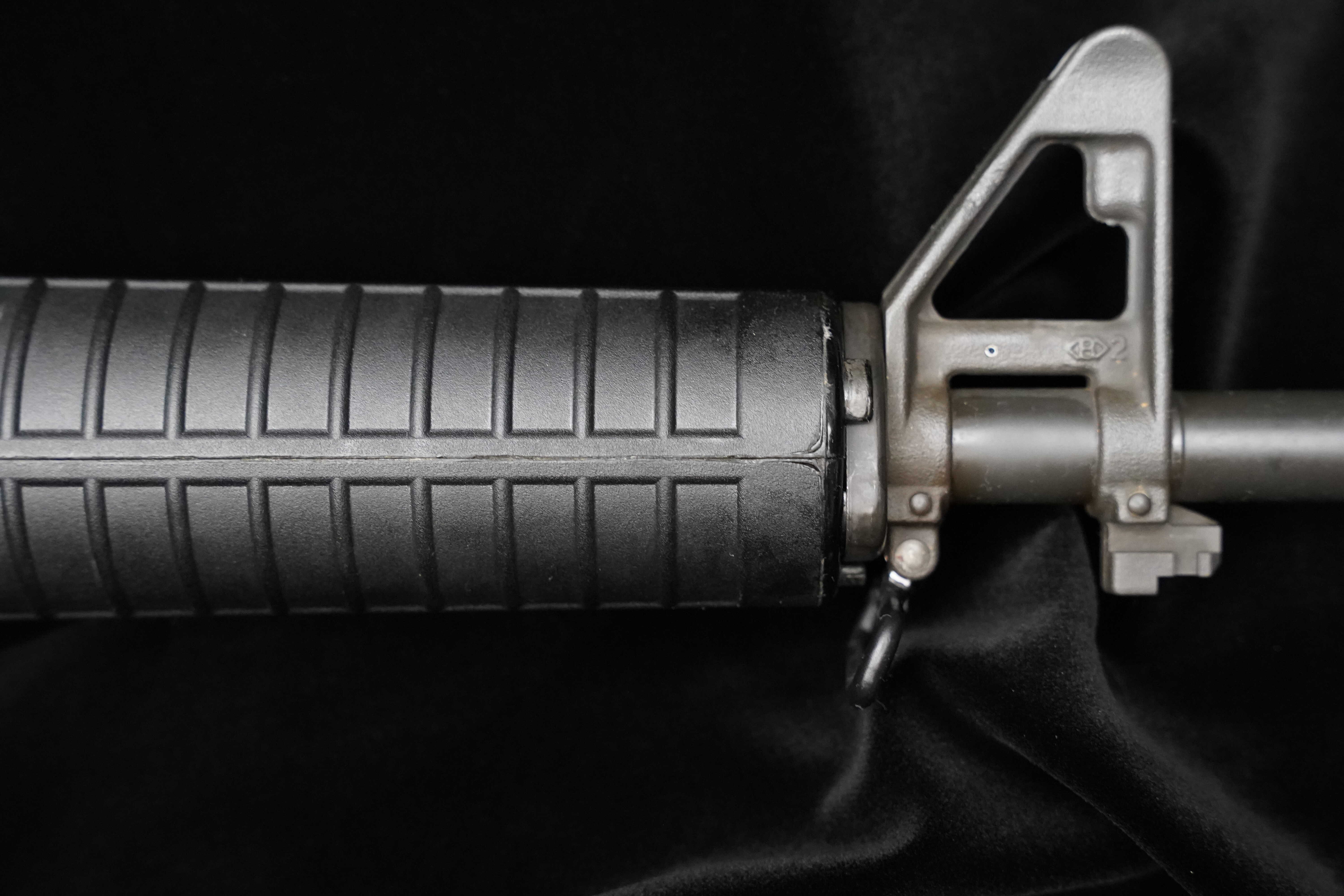

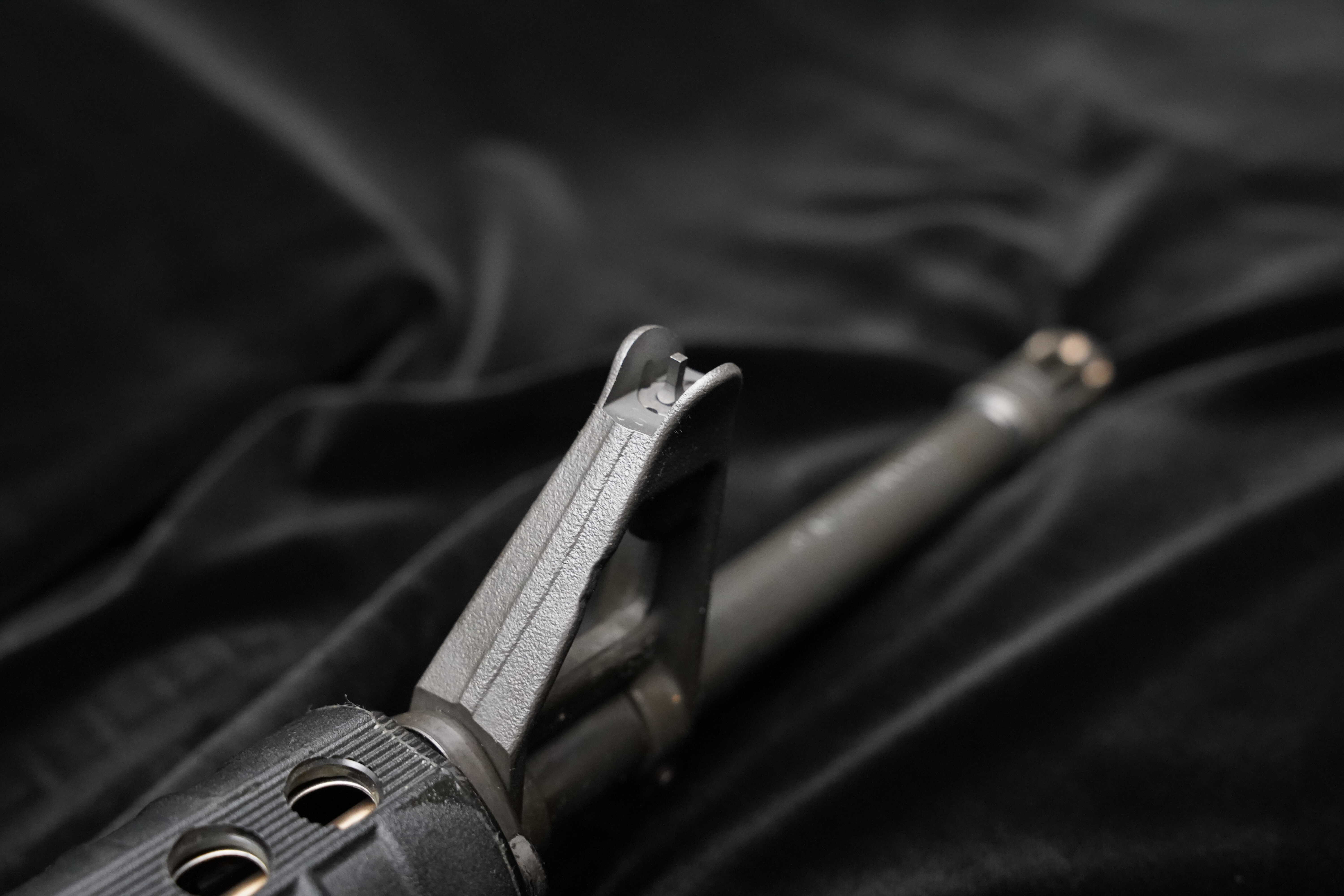

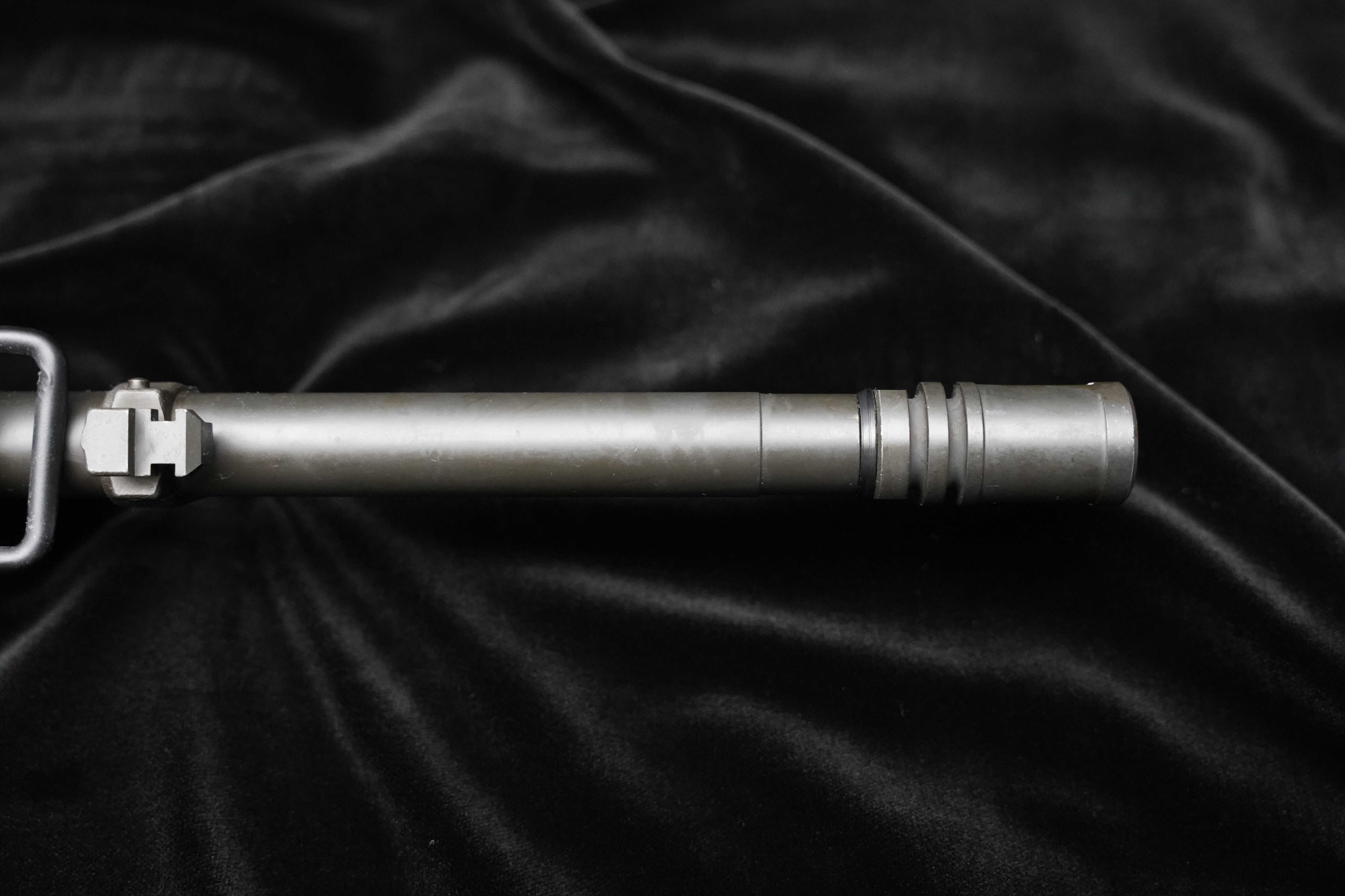

I wanted to post up the full set of high-rez pics my colleague took of the rifle.  It has appx 100 rds through it.

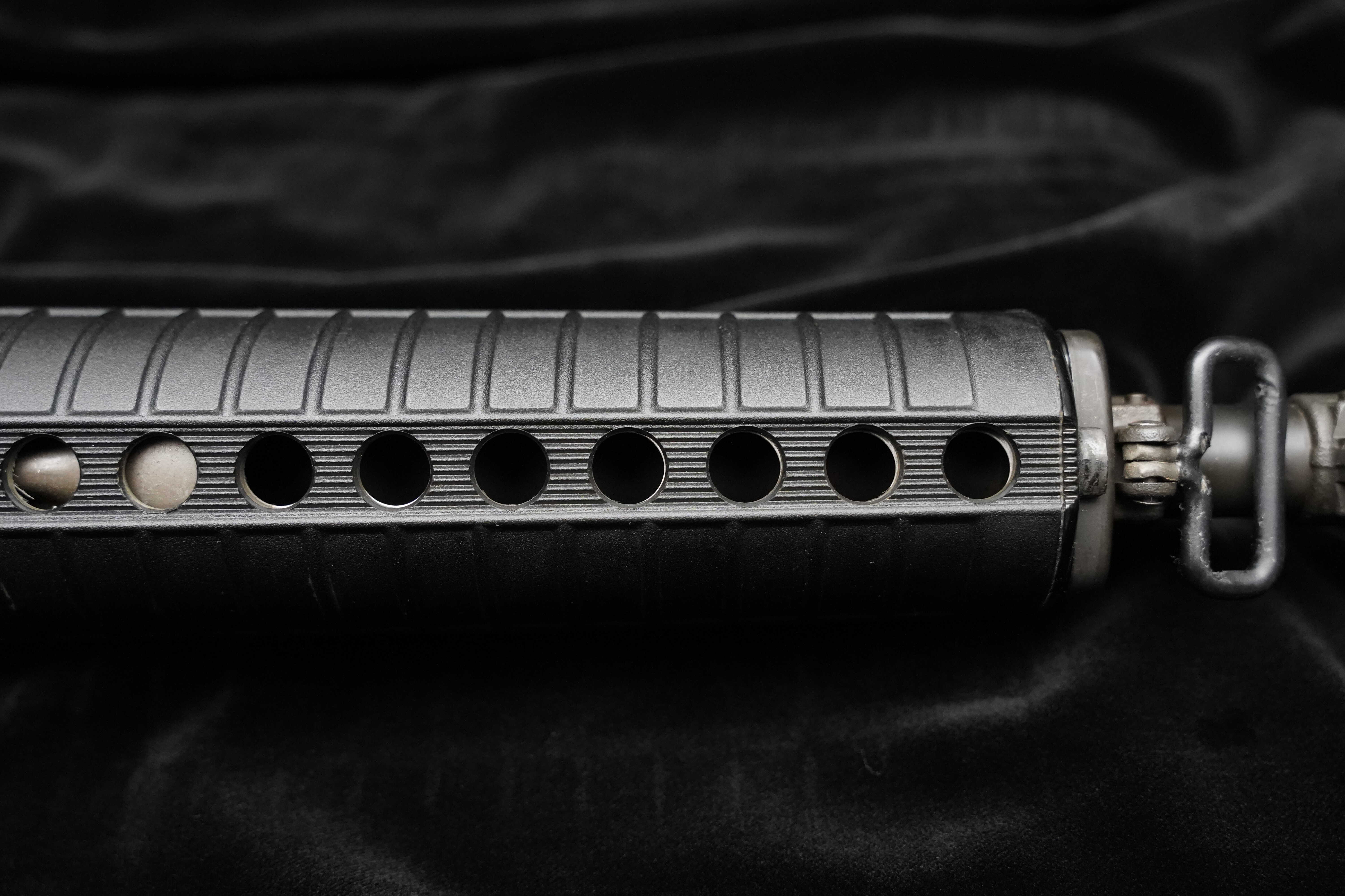

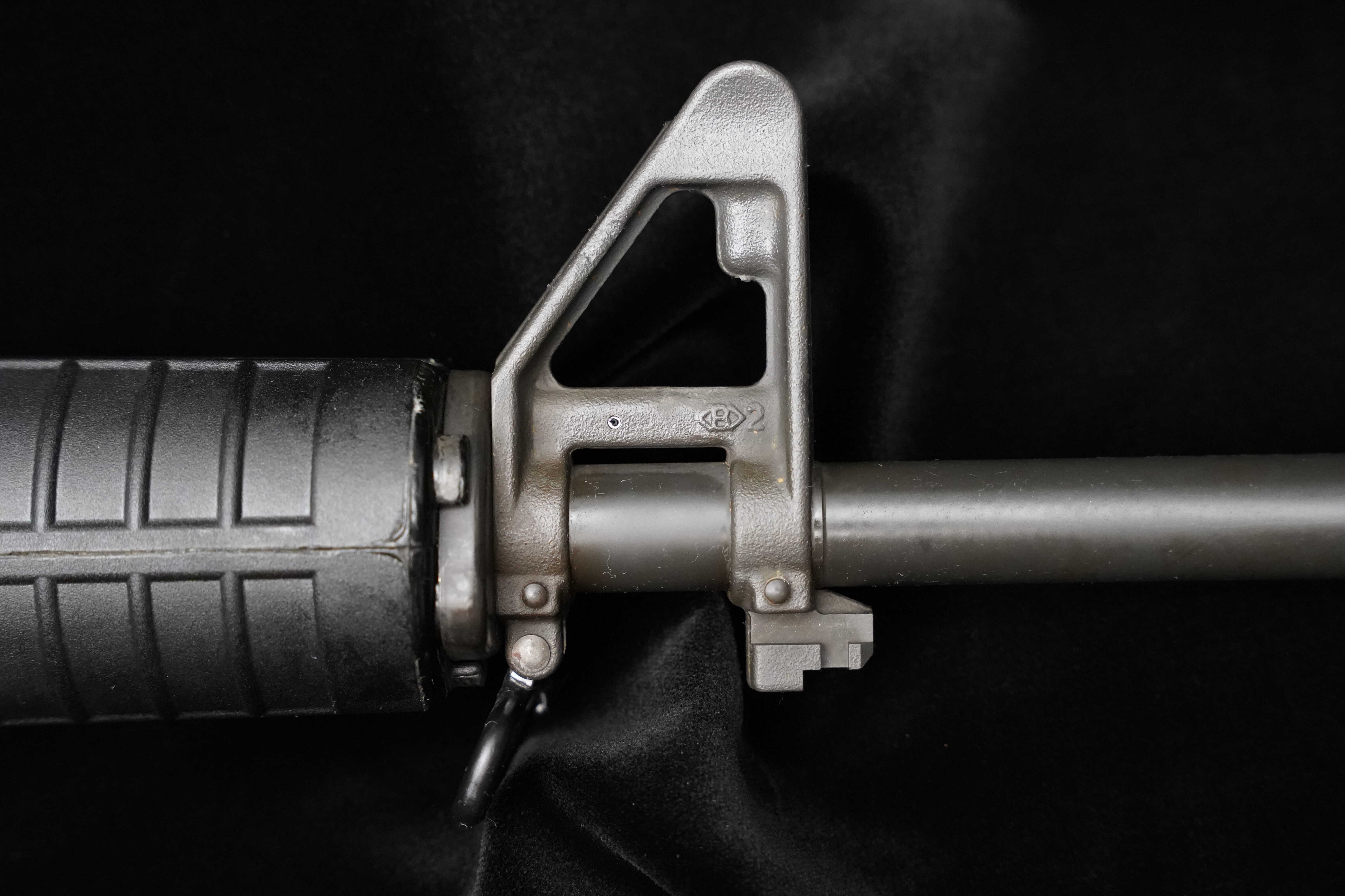

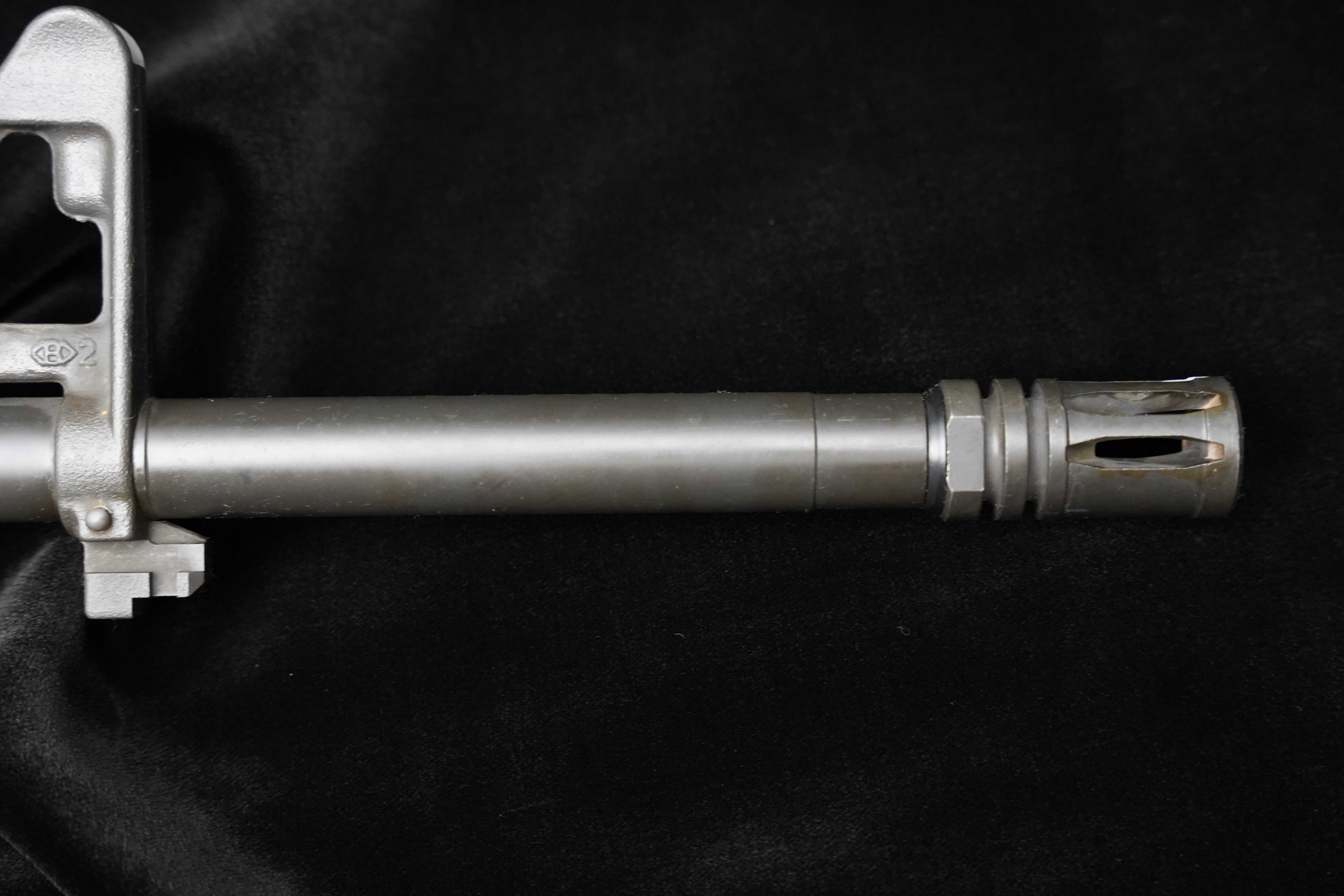

I know there are a lot of experts here.  Any thoughts as to if these parts are original/factory config, and if so, how that would've been possible?  I've read about the 'John Keosayian Collection' from 2008, which was really interesting.
Is it possible that this was also a held-back A2 receiver?  What do you think about the configuration?
Very interested to hear all of your thoughts on this rifle.
Here is the full image set:
7/8/2023 5:39:14 PM EDT
7/8/2023 5:40:05 PM EDT
7/8/2023 6:01:14 PM EDT
[Last Edit: EnablerNo1][Edited] [#3]
That lower uses a common A2 forging type from the correct era for a transferable Colt A2. It’s not an A4 forging. The photos you posted in your other thread show the lower being gray. The lighting in these photos make it appear black.
Where did you find 85 and 95 manufacturing records from Colt? And what exactly did the records show?
The Keyosian guns went through a handful of SOTs up in PA. Chester County Armory has sold a bunch. Target Master had some too. I can’t recall if Dennis Todd had any. All that I’ve seen for sale over the years were black anodized and used the later lower forging type that did not exist prior to 5/19/86. Keyosian had Colt destroy transferable lowers, use the serial numbers on newly made lowers. You could start by reaching out to Chad at Chester County Armory and see if he knows anything about your particular rifle.

Most likely not original configuration, someone probably changed out the upper on a transferable lower.
This.
If seller really wants top dollar I say put the correct a2 upper on it...which is hard to find the correct 1980s era upper...but they are out there.
The fact it's auto marked makes it worth more to buyers, and the fact it is NOT a K collection is a GOOD thing.
55k on GB is a tough sell as then buyer also has sales tax.  Put that on Sturm for 50k and it might sell at that, and depending on GB fees it's prob ends up being same amount in your pocket at the end of the day.

I think someone only changed the upper receiver.
Colt A2 upper receivers appear on the EE occasionally.

Nice rifle, but definitely a re-pop using the old SN#
It's not the latest forging, but it's still different than the A2 forgings from 85/86. You can tell by looking at the area surrounding the front push pin and of course they weren't using black die to color the anodizing bath in the 80's.
As discussed, this was legal and being done by many companies long before anyone heard the name K. Unfortunately, too many poindexters started poking the bear by requesting approval letters or asking too many questions.

That forging type was seen on transferable A2s as well as early post samples. The lower in question is gray.  The OP started a different thread in the retro subforum that had different pics in different lighting and the lower is definitely the correct Colt gray for that era.

As stated, with Colt anything is possible but looking at the other thread and the so called 1995 mfg date I'm even more convinced it's some odd midnight shift quasi-era re-pop. Strange look to that forging around the front push pin, no paint dab on the bolt catch even though they gouged the aluminum on install, super high SN#, it would be interesting to see what markings are on the inside of the A2 grip as the 80's guns all seem to have the same few lot codes.
As a side note - It's been my understanding that Colt wouldn't provide any info regarding machine guns over the phone or in writing via the historical dept, yet they did for the OP (maybe that's changed since the acquisition by CZ?).
Anyhow, I've got some detailed photos of legit factory transferable 85/86 M16A2's I can share for reference and comparison if someone cares enough to post them up. Unfortunately, I don't have a photo hosting account anymore.

The 85 and 95 dates definitely suggest it is a remanufactured/recycled lower. I was just pointing out that the forging type alone was seen on true pre-5/19/86 transferable Colt A2s.
I agree it’s interesting if Colt is offering research services on MGs.

The AUTO marking and FCG never stopped being available, despite the fact that the USMC ended up with BURST (as an internal political compromise) on their A2's.
When Colt rolled the A2 line out for L.E. and Export, you could order it with anything you wanted so long as your money was green.
That's why you see both BURST and AUTO marked A2's in the registry. Whether it's a 20" musket manufactured in 84, a 14.5" Carbine manufactured in 85 or a 11.5" Commando that was built and shipped weeks before the NFA ban.
There are obviously .mil contract overruns that made it into the registry as well. How many, nobody knows for sure, but you do see U.S. Property Marked A1's and A2's pop up from time to time. Just when somebody thinks they have a number nailed down, somebody retires or kicks the bucket and more stuff floods onto the market. Most, if not all of the U.S. Property Marked A2's that I've seen have been BURST marked with the USGI stamp on the magwell...which makes sense.
In the last 20+ years, I've seen A1's marked A2, A2's marked A1, A4's marked A2, M4's marked A1 and then with the K collection, every other re-pop or export example you can imagine. Even Gold plated A2's for the Kingdom of Saud...."Pimp my A2"!!! Some of these are for the collector who has everything I guess.
