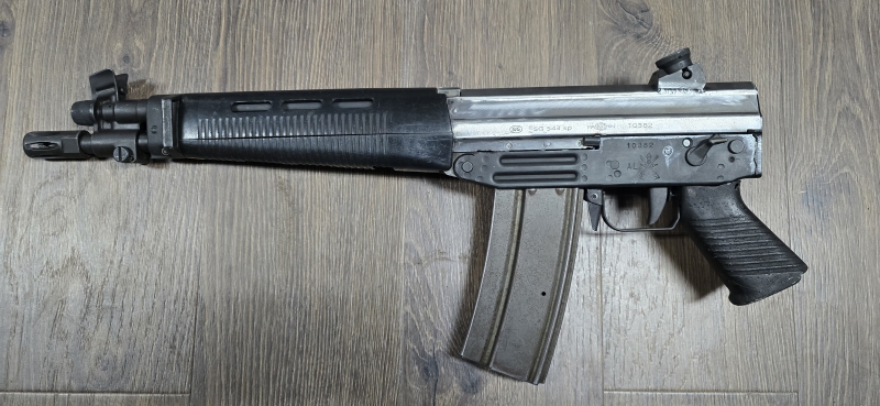

Apex and Centerfire launched some parts kits for sale and had some well used Lebonese surplus Sig 543 kits for $899
Went to the link and all were sold out as luck would have it - What if anything is useful or compatible to Sig 556/550 series without a receiver?
I like the rather primitive looking metal stock and the well used aluminum pistol grips
12/25/2025 11:33:37 AM EDT
At $900 I just couldn't justify something this beat up.
Should be a simple sheet metal shell build though since everything else is intact.

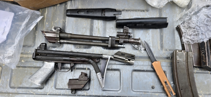

They had a small number of better condition kits from the email I got.  I had one in cart and was waffling and then oos

I got a couple. Both handguards are good and not broken. With 250~ total kits imported they'll only go up in value. Receivers will be avaliable in the next month or so. They may look rough but they'll clean up nicely.

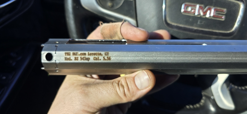

TTE Precision Metalwerks will be making receivers for the 542 and 543.
If you can weld these are easy builds.
Should be similar to building a Beretta AR-70/90.
I picked up one of the 542 kits and a few magazines.
https://ttepmw.com/

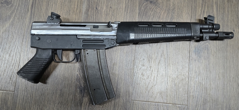

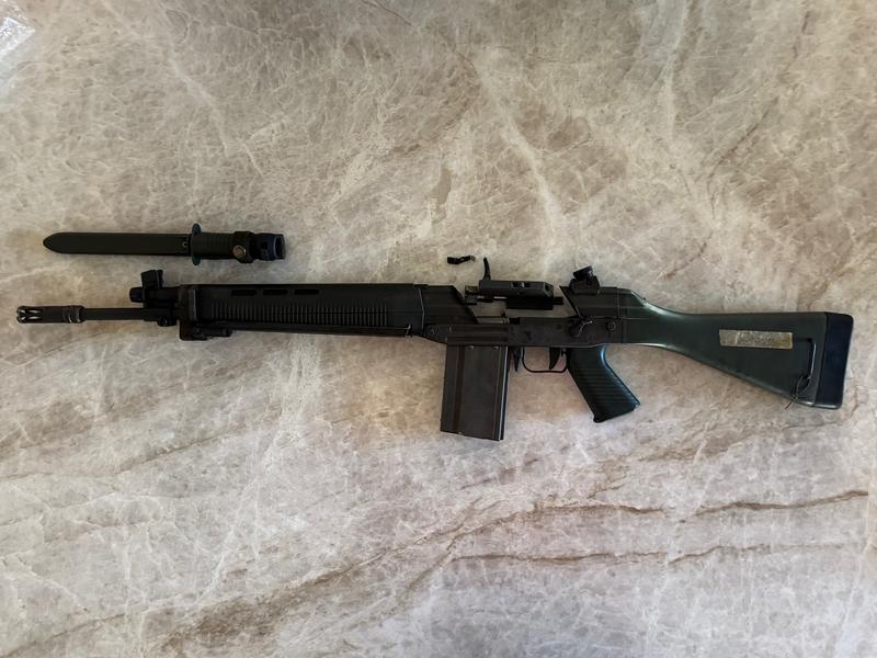

On a positive note, the 542 kit that I ordered from Centerfire Systems arrived.  It came with a new bayonet.
1/11/2026 7:20:56 PM EDT
Originally Posted By ptoguy2002:
Like a barrel removal jig?  Or weld up jig?  Pic?
There is a good video on youtube by "Bloke on the Range" titled "SIG540 vs SIG550 - A technical comparison"
Side by side comparison of two.
Originally Posted By Bye_Felicia:
Are the receivers dimensionally the same as a 550 series? I have a 550series receiver jig I can loan out.
Barrel removal
"My friend, you would not tell with such high zest
To children ardent for some desperate glory,
The old Lie: Dulce et decorum est
Pro patria mori." -Wilfred Owen
1/11/2026 7:40:40 PM EDT
Originally Posted By Bret:
That's too bad.
https://i.postimg.cc/8krPhzDz/IMG-7354.jpg
Looks decent - Especially Given that its had a harder life in the middle east.
Yes.  If I can get a receiver and get it put together properly, it will make a nice rifle.

Receivers will be avaliable this month or next. 543 & 542. TTE precision metalwerks

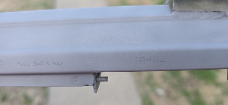

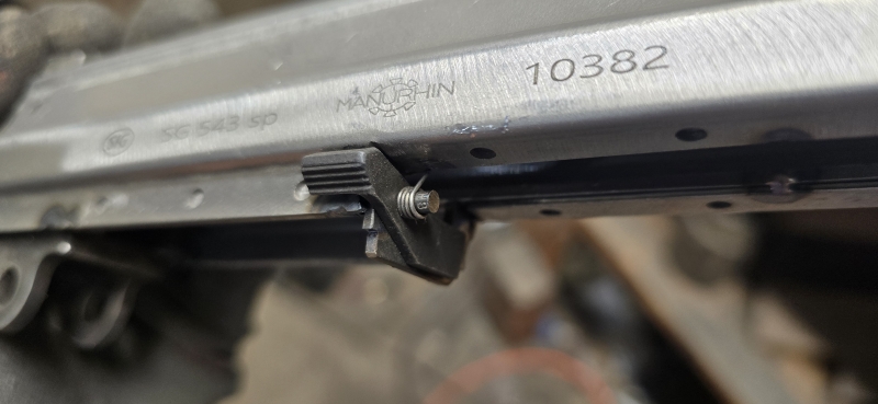

3/7/2026 7:26:48 AM EDT
Any updates with anyone's build process and plans?
@Katzma  Will there be repair sections available or just replacement receivers.

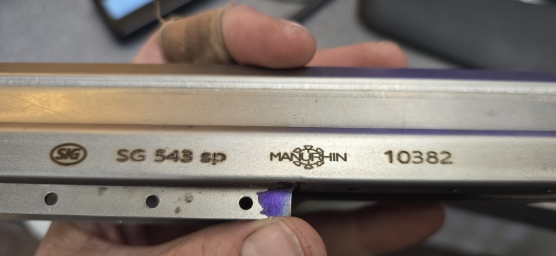

The kits that have original markings seem almost too interesting to not keep original sections - but if impossible/impractical not worth it.
The finish on the kits is a story in itself - hard life, hard region to be used.
3/8/2026 4:20:27 PM EDT
I should have a receiver next week. They'll go on sale the 23rd. And yes Troy (TTE) said they'll do repair sections
3/8/2026 9:42:53 PM EDT
For those that didn’t get the email
3/9/2026 10:45:14 AM EDT
Thanks for the info.  It's nice that they're doing bundles.  I'll wait to order off the website.
3/10/2026 1:35:33 AM EDT

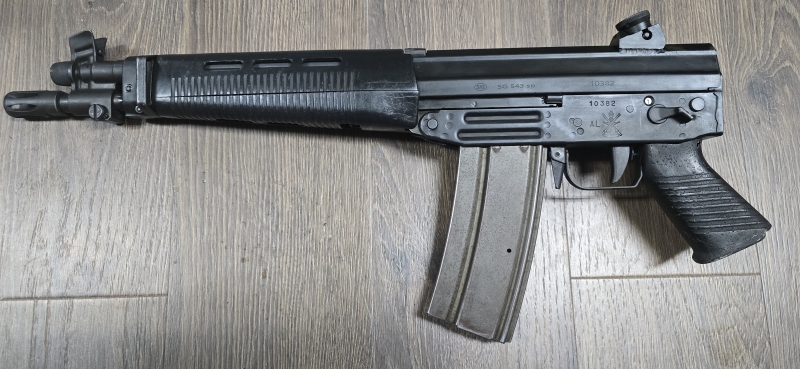

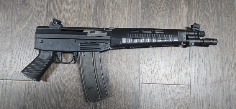

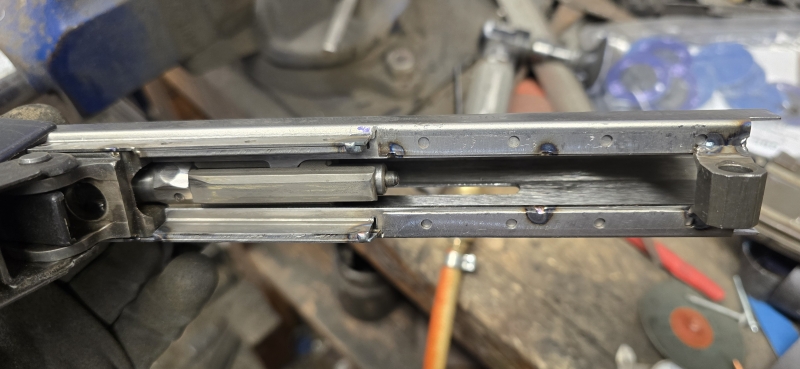

Got my receiver and 543 built. Can't figure out how to post pics now. But I do have a YouTube video.
SIG 543 proof of life
3/10/2026 7:47:39 AM EDT

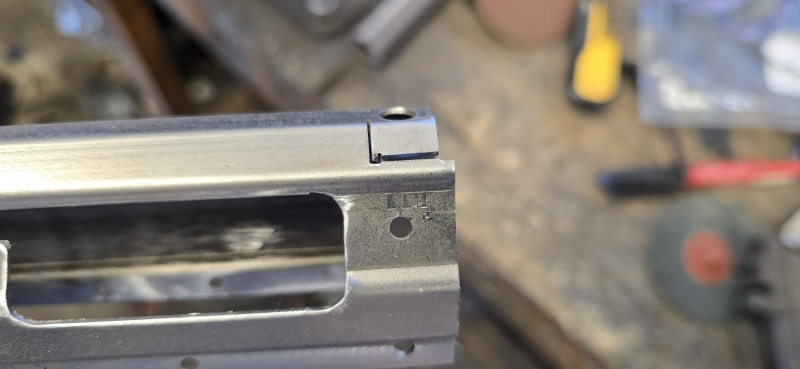

What was the build process for that build?
Did you remove old receiver sections and add the new 100% receiver?  If so did the receiver have the rails already mounted/welded or did you have to align and weld those in?
OR
Did you do a repair section?
I really wished I could weld well.  Its an art I have never mastered!!!!
3/10/2026 9:41:45 AM EDT
Very nice build!!!
Can't wait for my 542 receiver to show up so I can get busy.
3/10/2026 10:36:10 AM EDT
Here's my build tutorial on Weaponsguild
And how do you post pictures here now? Imgur does show pics
3/10/2026 4:00:53 PM EDT
If there is a link to photos for sharing - you can link them with the photo icon in the post editor header.  If a member you can attach from your computer.
I haven't really been on weapnsguild since the AR70/90 build days
It looks like a nice receiver.  I think a repair section would be great if the markings could stay intact.

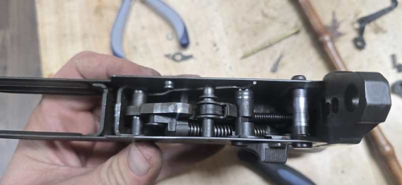

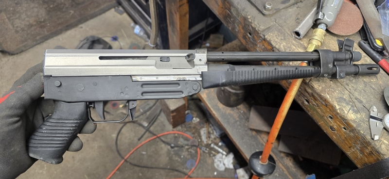

Very impressive

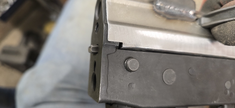

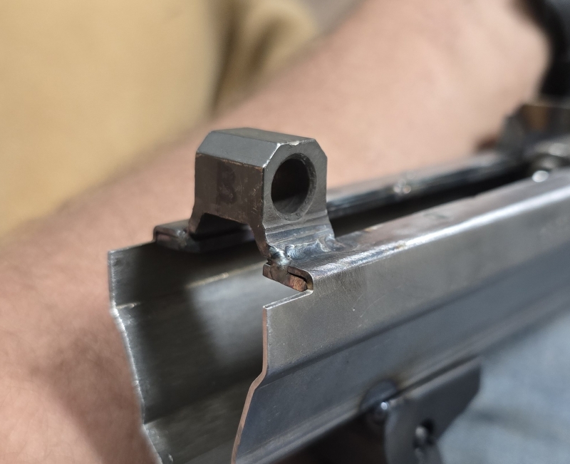

3/24/2026 11:31:59 PM EDT

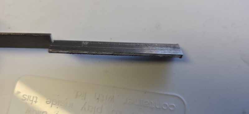

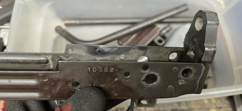

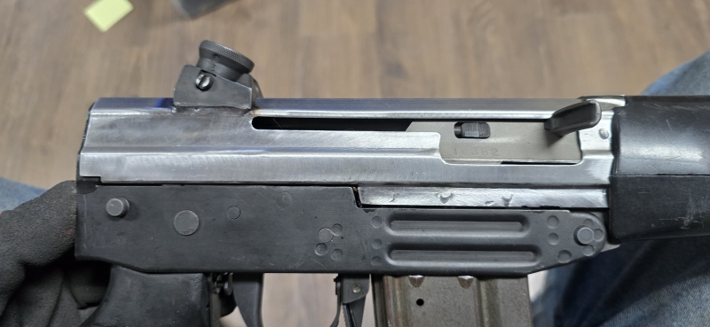

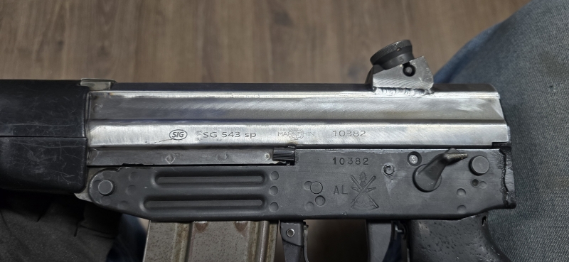

They only send them to FFLs. Mine was logged in and transferred as a receiver even though its a "80%"  guess rules changed. My dealer looked it up and said i needed to be transferred because it was almost complete and had a serial number (from my kit)
And yes you need to weld in rails, rear lug, bolt hold open, rear sight, and weld to the trunnion.
I cant figure out how to post pics now days. But I've got the whole build tutorial with pics on weaponsguild

If that’s your build thread on WG I can link the pics here for you, with your permission

I appreciate the explanation.  It looks like I'm going to have to find someone to finish the receiver.  That's ok.  I appreciate that they even got that far through the receiver manufacturing process.

@katzma Is the 542 similar in build except caliber of 308?  There are some 542 kits left.  Its a battle rifle akin to a FAL
I wished I had grabbed a 543 kit but they went fast.
I  would prefer a build that kept those markings intact but that might be a big ask if its trying to weld a section into the kit.  I didn't see repair sections for sale yet?
Yes they are identical. FCG is identical except for the trigger spring/rod. I have a comparison thread on weaponsguild
542 & 543 comparison

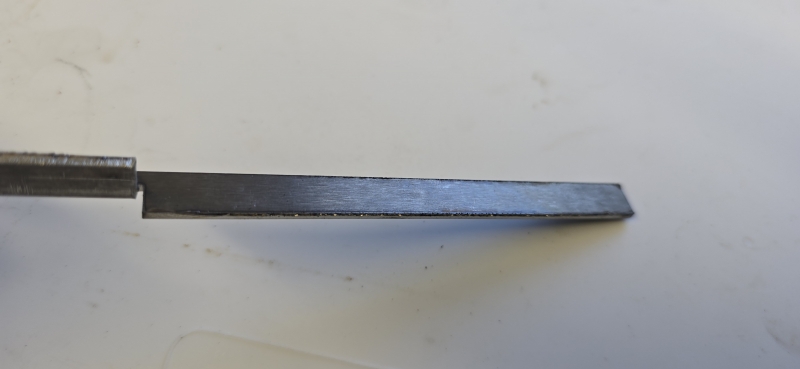

4/2/2026 10:51:59 PM EDT
Yes definitely
Totally forgot about that. Here's selected pics from katzma's build thread on weaponsguild
