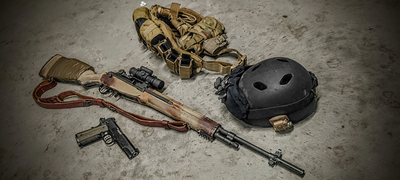

I need more details on specifics for a Shughart m14 build
6/5/2025 11:10:03 AM EDT
theres a few ways, but....
aimpoint 9000sc
leupold or Ruger or wherever u can find a set.....vertical 30mm low split rings
kensight weaver mount
SAI 1990s rifle with GI bolt and barrel
is what id suggest.
i have an arms 18 on this one

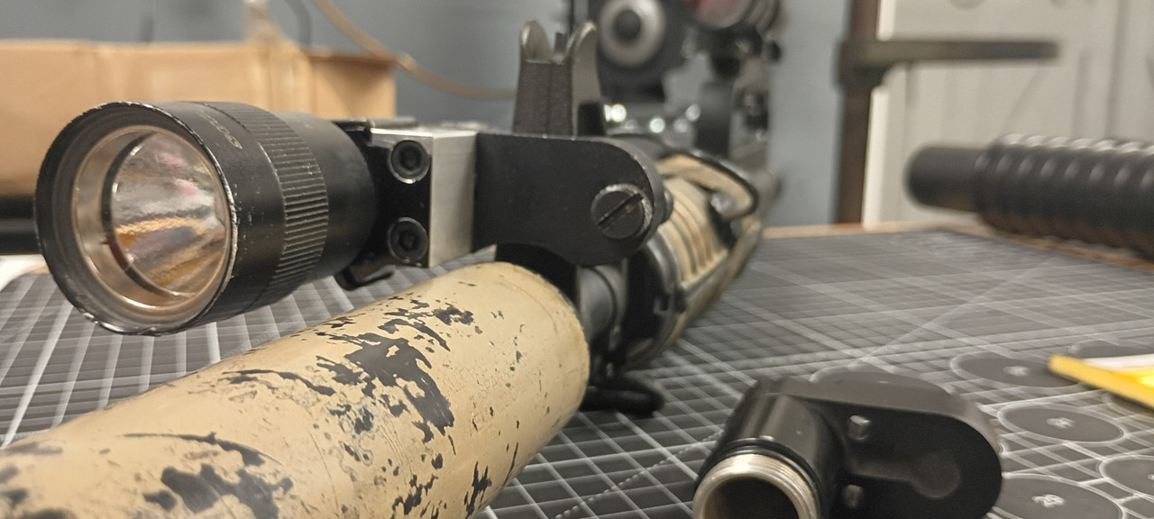

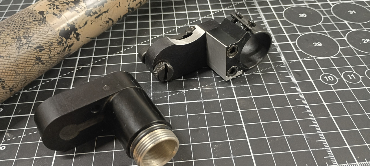

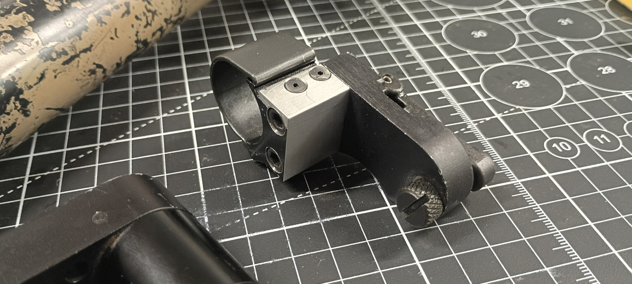

Originally Posted By home_alone1:
i bought a weaver extra high 1" ring and then machined a piece of aluminum for the side and then d&t it for flathead bolts. then i cleaned it up and added the holes for attaching to the m25 mount.
the base for the 17 adapter and the offset light mount is the same
