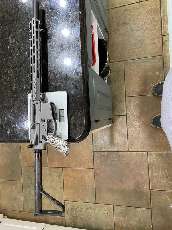

I don’t think I ever posted this one. 4.39 lbs with scope. I love shooting this little gun.
1/25/2022 7:01:58 AM EDT
is that a smoke rail on the front?  The cutouts seem different than mine.
Sweet looking machine there
1/25/2022 7:36:19 AM EDT
[Last Edit: larrys][Edited] [#17]
It’s made by Smoke for BAD. This version is a hair lighter if I recall correctly.

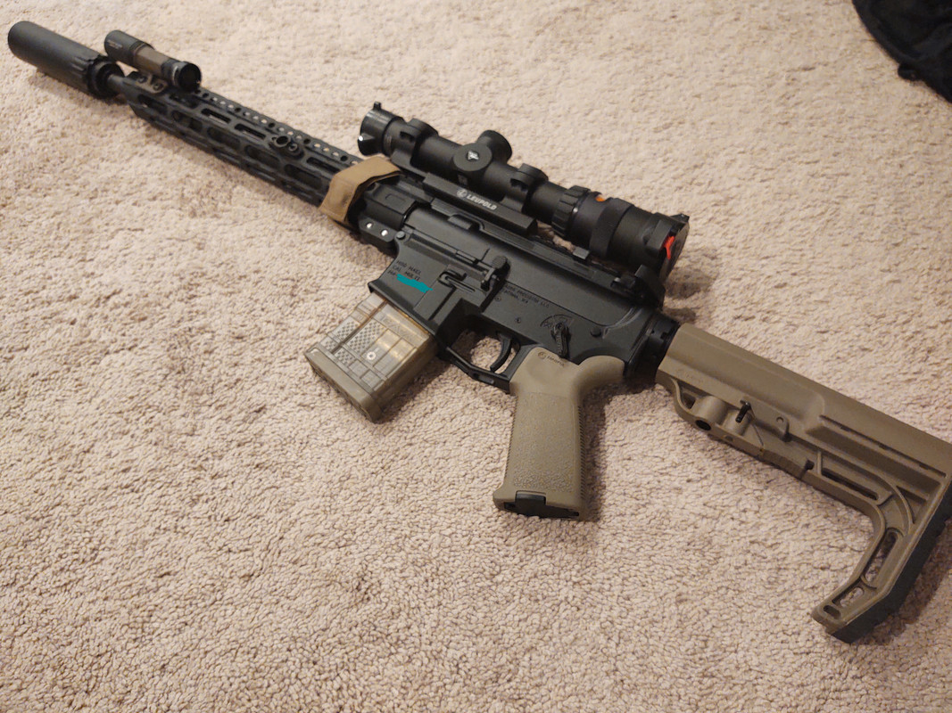

One of the latest builds I did, still deciding on things. Grip and stock are temporary, and I might move the mount and razor to a lightweight .308 build, and shed optic weight. Rifle was right at 4.5lbs and a hair under 7lbs with 1-10 Razor/Badger mount,  and Thunder chicken suppressor. I have a saker 556 with plan B that I’ve been running on it lately for it’s smaller size, but It weighs more than the Thunder Chicken. But the saker is also a overbuilt tank. Both 3 shot and 5 shot groups @ 100yds were all sub MOA like the reports I read when researching barrel specs. Vseven makes outstanding barrels though very pricey.
Gun shoots fast and handles fantastic.
Specs:
Vseven enlightened receiver set
Vseven fluted light barrel assembly with their GB setup, with optional head spaced bolt.
Vseven cam pin
Vseven Hyperlight rail
Vseven titanium FP
Vseven ultra lightweight mag and bolt release,
Vseven h2 buffer
Vseven enhanced buffer tube,
Vseven silent coated buffer spring,
Vseven lw castle nut,
Vseven ultra lw port door with modified receiver rod,
Vseven ultra LW pivot pins,
Vseven ultra LW charging handle,
Vseven 3gun safety one-sided,
Vseven trigger pins for ARGold
Non Vseven parts:
ArGold adjustable trigger
Bootleg adjustable bcg (using Vseven bolt.)
Badger Ordnance 1.93 mount. (J-arm is awaiting an RMR)
Vortex gen 3 1-10 with throw lever
Standard lpk springs
Q cherry bomb (for Thunder Chicken, or Saker 556/plan b)

Standing on a scale with and without the upper gives me four pounds even with the DD sights. Same upper but with a 13" handguard. I haven't shot this one yet but like my first one. @swampfoxoutdoors
Anti-gun, anti-freedom California legislator Leland Yee served FIVE YEARS for running machine guns and rocket launchers to gangs.
4/28/2022 7:38:33 PM EDT
https://www.ar15.com/media/mediaFiles/516916/IMG_20220428_182052347_jpg-2365301.JPG
Looks sharp!

This thread needs CPR so I will update my NFG build from a few posts earlier.
My Nomad Ti finally came home. Added a Griffin Plan-A and titanium shortbrake.
Was hoping to get it all in under 6 and got 5lb13oz.  This is with can, optic, and MBUS pro, ie everything except a mag and rounds.
