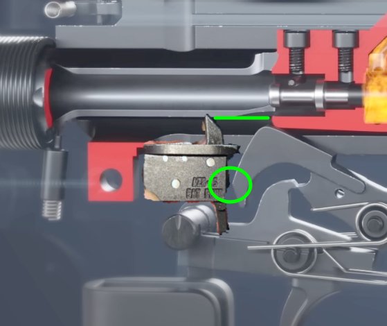

Got back from my range trip today.
Still going FRT mode intermittently in SEMI. I'll have to tear it down and inspect it.
In other news, there was another couple of guys at the range with FRTs blasting away so we all got to try our different versions and nerd-out. We had a Rare Breed, my AZR 3-pos, Super Safety and an Atrius. All did great and were interesting in the different setups and how they ran.
ETA: pics of my regulator at 450 rounds
My 3p AZR with zero shots showing the slightest contact after function checking the rifle for 5 minutes.
I think the flat edge of the hammer on some upper/lower combos can strike the AZR body in two locations. The higher wear mark doesn't affect any moving parts and will self clearance.
The lower wear mark (if any) could appear as an impact. My hunch is the direction of this potential impact (green circle), if forceful enough, could activate the FRT lever before the bolt carrier impacts the trip lever (green line).
In semi-auto the disconnector should catch the hammer. If early FRT activation is happening via the hammer's tail, the early reset could throw the timing off enough to drop the rear of the trigger/disconnector assembly (and disco hook) out of the hammer's reach at the worst possible instant, causing hammer follow and a dead trigger.
It's happening intermittently because that's a whole lot of 'ifs'.
Possible solution: Stone that peak off the hammer's tail.

10/24/2025 2:24:30 PM EDT
Originally Posted By way:
In semi-auto the disconnector should catch the hammer. If early FRT activation is happening via the hammer's tail, the early reset could throw the timing off enough to drop the rear of the trigger/disconnector assembly (and disco hook) out of the hammer's reach at the worst possible instant.
https://i.postimg.cc/bNMPLZb8/maybe.jpg
If I'm understanding correctly (and assuming all other "ifs" line up), contact could happen even during normal semi-auto fire, correct?
10/24/2025 5:21:58 PM EDT
Correct.
