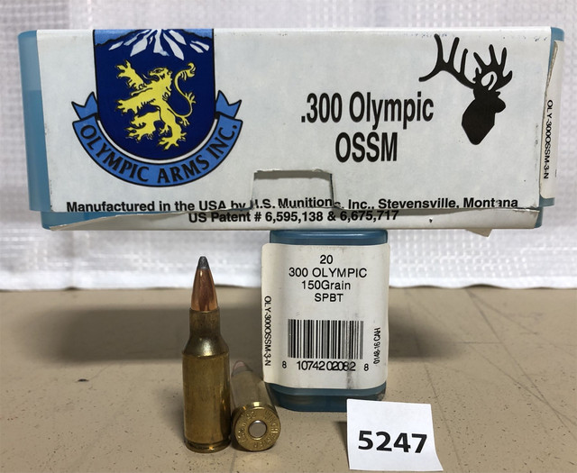

9/24/2026 11:17:52 PM EDT
Originally Posted By sidpost: t
I wonder about a "Grendel'ish" 30 ARC or 30HRT in a 6.8'ish AR-15.  Yes, a pure handload option, but I expect a step up in velocity given the same mid-weight bullet options and enough power to run heavier options well.
You could always go .300 OSSM.

Today 7:53:01 AM EDT
I was going to suggest that (jokingly). I believe the standard load was 150 gr at 3000. I have no idea where you would source a barrel or ammo though, unless you had a barrel custom cut and then built your own brass off Wssm cases. And then you’re obviously single stacking so mag capacity is 10? Or less in a 30.
Today 4:03:22 PM EDT
https://i.ibb.co/bg6MspZQ/IMG-6267.jpg" target="_blank">https://i.ibb.co/bg6MspZQ/IMG-6267.jpg
That and the 30 Remington AR were both interesting and never really caught on. Got even harder to justify when the 308's really shrank down.
