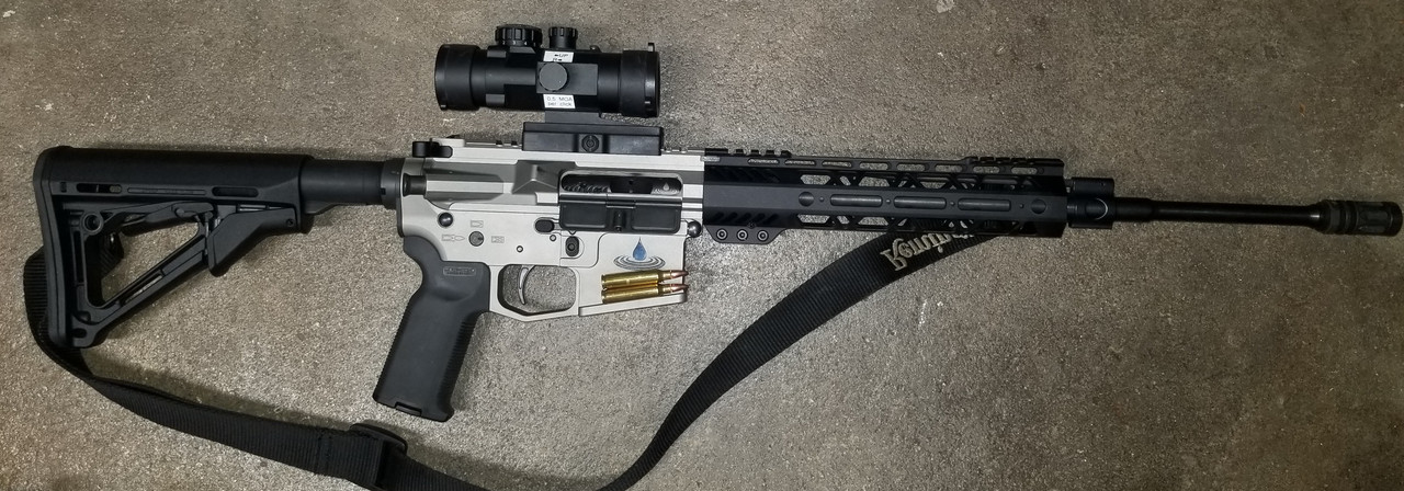

12.5" is not too long, it does not cover the gasblock at all on my 20" .308 SFAR, https://griffinarmament.com/shop/low-pro-m-lok-rail-12-5/
https://www.ar15.com/media/mediaFiles/27966/sfar-replaced-rail_png-3661108.JPG

Good to know.  Thanks for this.
