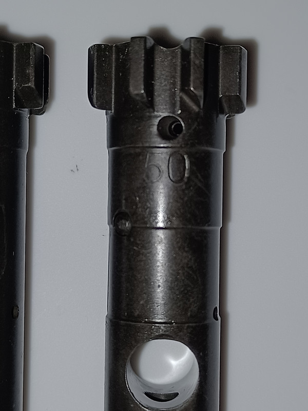

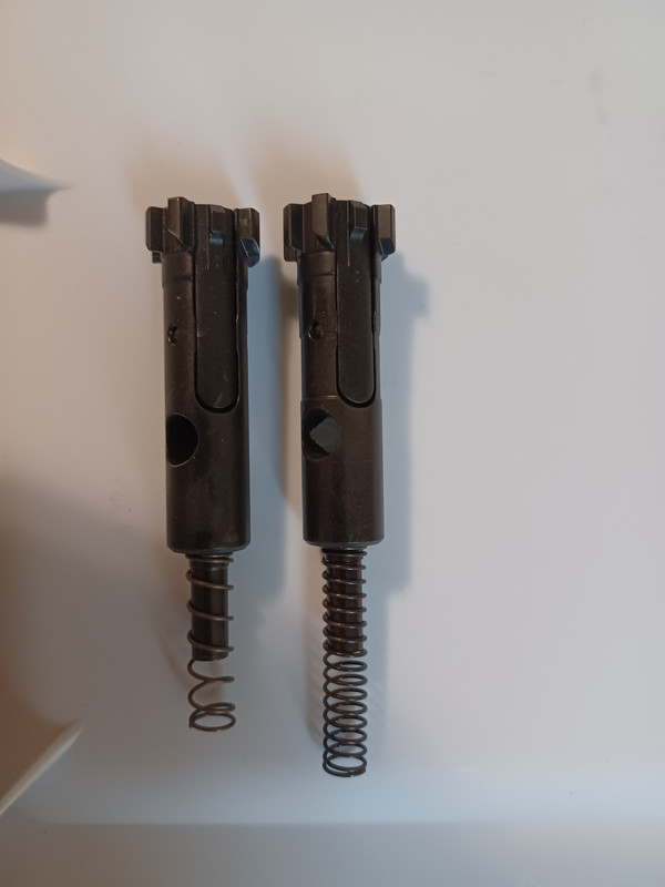

6/23/2023 1:06:44 PM EDT
So I received my replacement bolt in the mail today, right off the bat there are visual differences. The bolt is marked "50" on the bottom of the bolt, right behind the skinny lugs. The lug angle is much shallower and I assume that the "50" marking refers to lug angle. My original bolt has no numerical markings on it and the lug angle is much steeper. The firing pin spring on my original bolt is 1-1/8" long and 8 coils, the spring on the replacement bolt is 1-1/2" long and is much tighter wound, 18 coils. The extractor on the original bolt had a spring and a small rubber bumper, no o-ring. The replacement bolt has a much larger rubber bumper, spring and o-ring. The extractor itself is more dehorned and doesn't have the sharp corner edges. Overall machining is much better, very few machining marks, very smooth surface. The nitride is very smooth also. overall a very nice part. Have not fired yet just reassembled with new bolt.

6/24/2023 9:26:59 AM EDT
I haven’t disassembled mine, but I looked at them again. The 2 on the left are from 7/22 and 10/22 (1 directly from CMMG and in response to the spring issue, so presumably current at the time) and are new. The one on the right is, I’m guessing, 2019/2020 and used. I’ll be the first to admit my eyes are bad, but there’s no numbers that I can see on any of them. I do notice now the diameter difference in the 2 parts of the bodies on the left. The angle of the lugs looks the same to me. @SSTPAC got any pics?

Interesting...
So the only bolts I've seen marked are the 40SW and 10mm.
.40SW are engraved 60 and 10mm is 67.
I have a CMMG RDB in .45ACP as well but don't think it is marked since it is obvious it is .45 w/ the large bolt face.
Makes sense to mark the 40SW and 10mm since they share the same case head and make identifying easy.

6/25/2023 9:05:26 AM EDT
[Last Edit: CJofFL][Edited] [#19]
Originally Posted By amphibian:
I've guessed the numbers represent the number of degree's off the bore's axis but I never bothered to actually try to measure it.
I think you’re right, makes sense with the angle increasing with the cartridge energy. I used a 10x pocket optical comparator to measure various lugs on all 3 of my 9mm bolts and all are 50 degrees off the bore axis.
To be specific, if anyone cares, I set the corner of the lug in the corner of the reticle, lined up 90 with the long side of the lug (0 at the backs of the lugs), and they measured 40. 90 minus 40 equals 50 off bore axis.
While I was at it, I used a micrometer to measure the length of the lugs opposite the extractor and adjacent to it (not the feed lug) on all 3 of my 9mm bolts too. I didn’t expect anything by measuring it, just looking for an obvious difference between the new and old bolts. The old, used one which I did NOT clean was .279 and .279. One new one was .277 and .276 and the other new one was .276 and .276. For reference, the spec on an AR15 bolt is .278 +/-.002. I didn’t expect these measurements at all because it looks like the angle cut on the lugs of the 9mm bolts has some of the corner missing, but apparently not.
ETA: like I previously posted CMMG claimed ‘a slight change in the angle on the lugs’ as one of the differences on the new bolt they sent me. So, the new bolt doesn’t look very promising so far for fixing my spring issue considering one of the claimed differences doesn’t seem to be there.
6/27/2023 5:38:18 AM EDT
This is what I received.

I received the new bolt on Monday.
I can't see a difference in the extractor lip.

Did those of you with new bolts note any improvement?
8/7/2023 1:01:56 PM EDT
Thanks. On your old one, that’s not wear I see at the edges, is it? I think its just the camera angle, but you seem to shoot a lot of full auto, so I thought I’d ask.

Thanks. On your old one, that's not wear I see at the edges, is it? I think its just the camera angle, but you seem to shoot a lot of full auto, so I thought I'd ask.
Yes, there is some wear but it seems to just wear to a point and stop....don't see them getting worse.
