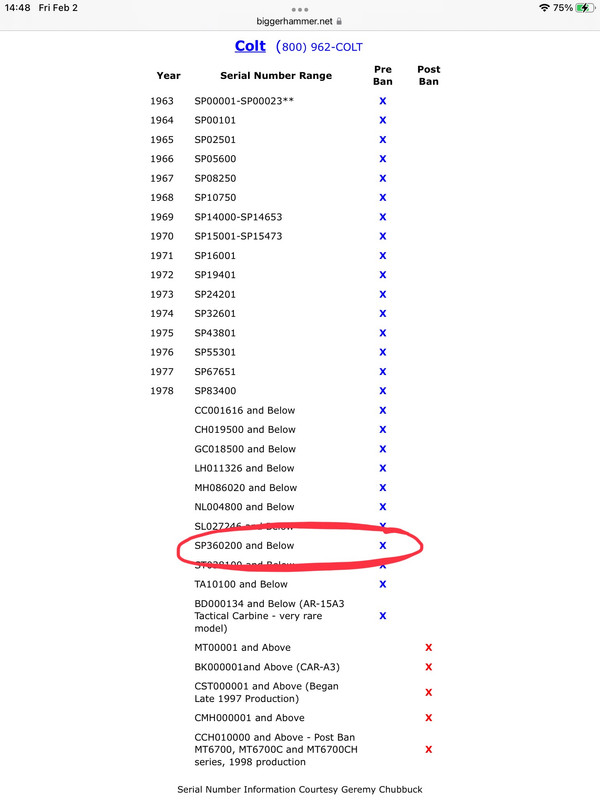

Sporter II Serial numbers start around SP 300,000 and supposedly end at SP 360,200 and we're all Pre 1994 Clinton Assault Weapons Ban.
At least 1 gun, 360,190, marked SPORTER falls in this serial number range but is not a Sporter II. I can only assume there are others.

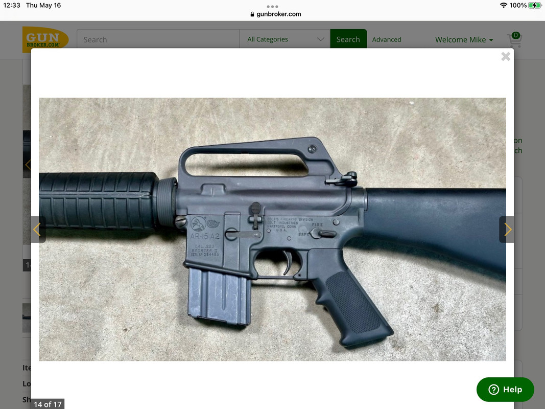

All Sporter IIs appear to have slick side lowers with large double screw front takedown pins and are roll marked with the Prancing Horse atop the world next to the Colt Logo and:
AR-15A2
CAL. .223
SPORTER II
SER. SP 3XXXXX

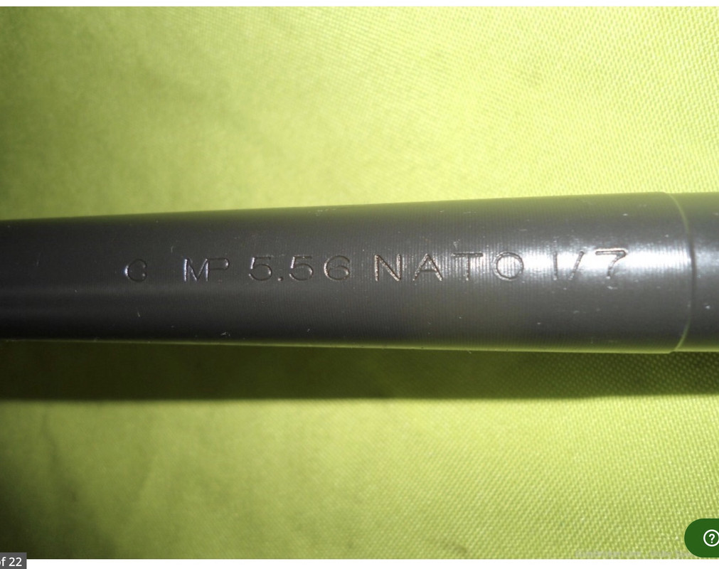

Carbines seem to have gotten a pencil profile 16 inch 1/7 Barrels Marked:
C MP 5.56 NATO 1/7

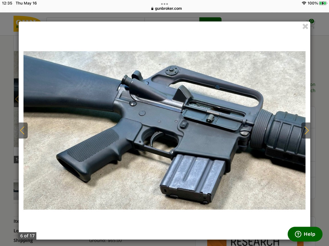

Earliest Sporter IIs with slab side uppers and small pad port doors.
Next A1 type Forward assist uppers with teardrop F/As and small pad port doors appeared. Some guns may have received large pad port doors.

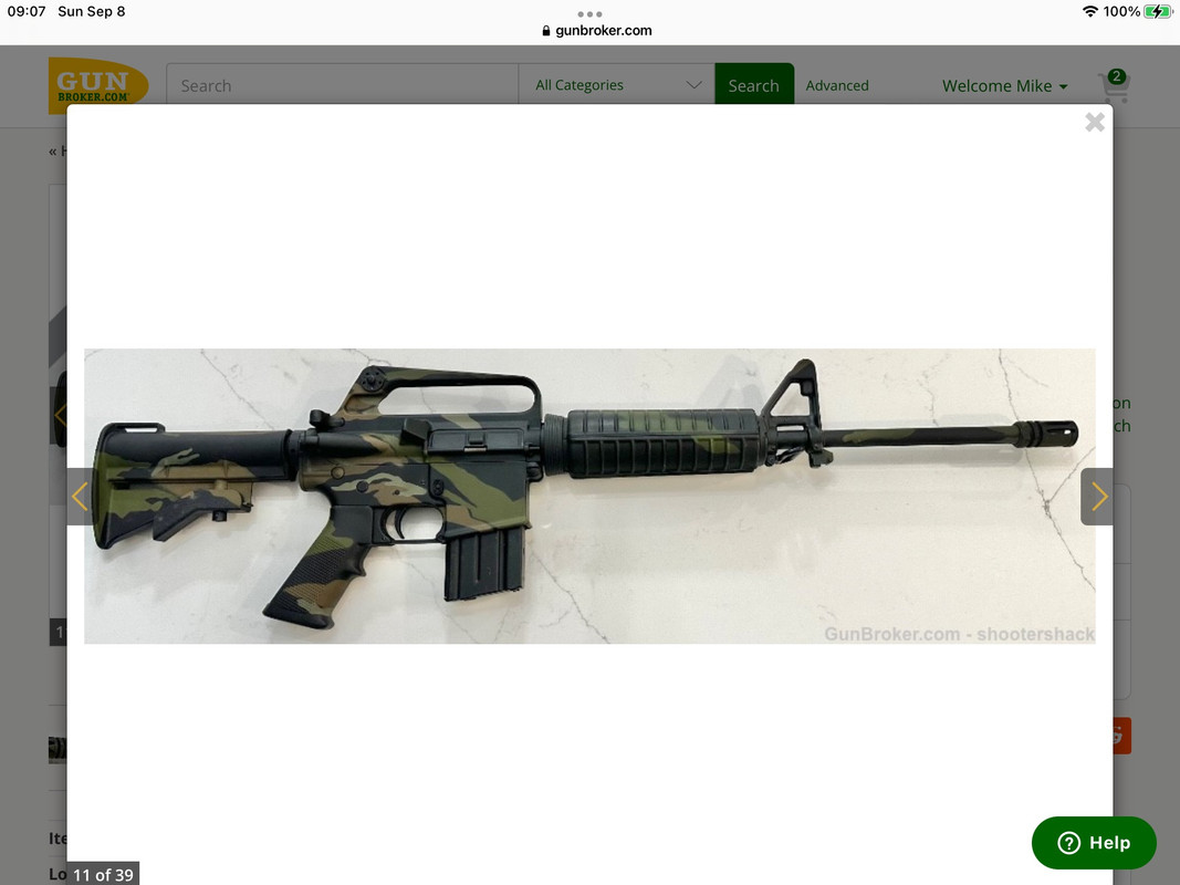

C7, Big D F/A, Large Pad Dust Cover, Carbine, Z-Cote Camouflage, (1987 date in GB Listing)

Just noticed this Rifle on Gunbroker
Interestingly it's SP 360,190 makes it one of the last 10 Preban guns made with the SP prefix according to Bigger Hammers preban serial number list, yet it's rollmarked as a SPORTER and appears to be a .222 export gun. I wrongly assumed they were all Sporter IIs up to 360,200.

I recently picked a Green Label R6600 AR15A2 HBAR Sporter also.  My first factory made AR (outside Govt service)!  All my others starting in 87' I've built.
SP2241xx
HBAR, 20" C MP 1/7, FSB w/bayonet lug, A2 flash hinder
A2 funiture
Slickside lower
Delta Ring
A2 upper, A2 rear sight, Large D Forward Assist
Thinking mine is from 87-88'.
Sling that came with it not USGI (I corrected that) but cleaning kit in buttstock.  Two Colt black follower 20 rd mags.  No box or manual.
C marked Bolt carrier shaved down.  No sear block in lower.  Large screwed front pivot pin.
R6600s made 86-89'. The R6600K model came with the Colt .22LR conversion.  In 1990 the Blue Labels came out.

Just came across 344213 on Gunbroker.
Its interesting for 2 reasons.
1) It's the lowest serial number Target sight (A2) upper I have seen.
2) It has a Colt Archive letter stating the date of Manufacture was 11/1987
Thats the first date I have seen other than the 1994 guns and 1984/1985.
Its also the second Rifle I have observed with an A2 upper and a Big D forward assist around that serial number range.

This Sporter II showed up on Gunbroker recently.
Serial number 354,485
Its interesting because it's the second one on my list that has a c7 upper and an A2 Forward Assist within a couple of hundred serial numbers of each other. The other is 354,298
It also seems very original, including the green label box.
These are very late in the Serial number run that ended at 360,000 and After A2 target sight uppers had started to be used. Somebody probably found a bin of C7 uppers and decided to use them up with the existing A2 Forward assists instead of the Big Ds, which had probably run out by that time.

345,380 is pretty cool with the Z-Cote Camoflage.
Ad says there's supposed to be 150 Sporter IIs made like this in 1987.
Probably sequential serial numbers.
