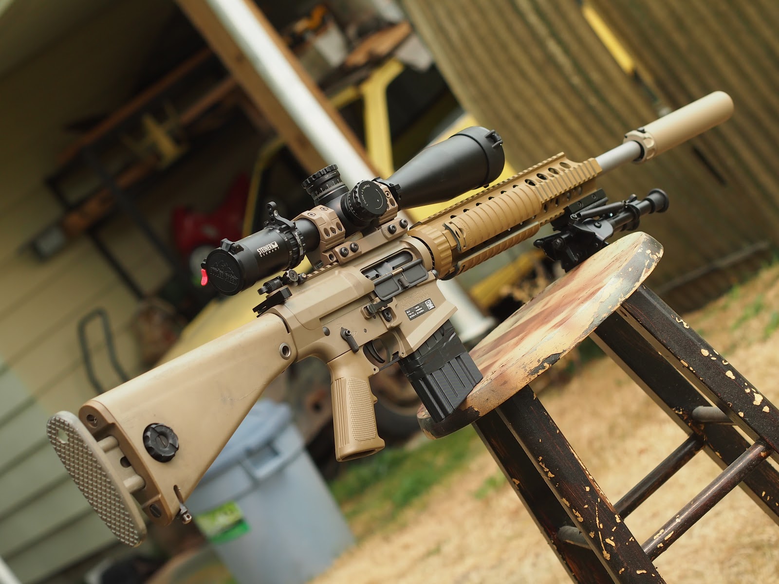

Here's what I had when I started this endeavor, which wasn't much, lol!
I really wanted to build a Mk11 Mod 0, Mod 1, M110 clone, but wasn't sure any of the KAC parts would fit, but I wanted my rifle to look something like that.  The problem was, I had no experience with anything AR outside of the standard 5.56mm AR.  When I started to research AR-10s and DMPS pattern rifles, it boggled my mind, trying to figure out parts compatibility.  My first speed bump on the path to building the rifle I wanted was the hand guard.  I had no idea if the KAC hand guard barrel nut would fit the 102s threads, let alone other parts.
Clone correct glass on the M110 was the Premier/TT, but that is beyond me.  I wasn't keen on putting a Mark 4 on it, because I wanted something with more magnification, but there was no way I could afford a TT or used Premier.
I also decided that other KAC parts would run the cost of this build far higher than anything I'd previously attempted (The correct A2 butt stock from KAC runs about $400 USD) so I decided to give up on the idea of building a spec-clone and just go with something close enough.
I still wanted the cheese-grater look and surprisingly, that was a lot harder than I imagined.  Finding quad rails nowadays isn't exactly easy as it used to be.  Armalite has apparently discontinued their quad rail free-float hand guard for their Super SASS so I had to source a used one.
Anyway, more to follow.

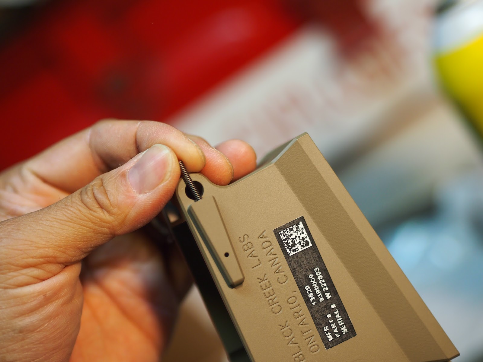

One other thing I noticed was the grip screw hole was not drilled all the way through like on AR15 lowers:

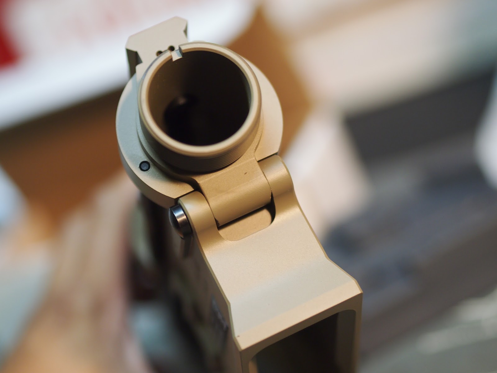

As I mentioned earlier, the receiver extension I had would not capture the buffer retainer.  I may try my buddy's and if necessary, order another one from MidwayUSA.
I noticed I was not the only one who experienced this
https://www.canadiangunnutz.com/forum/showthread.php/1674821-BCL-102-stripped-receiver-set-thread?p=14874930&viewfull=1#post14874930
Ryan from SFRC stated the hole is in the right place so maybe the cerakote is a bit heavy on the back end of the lower.

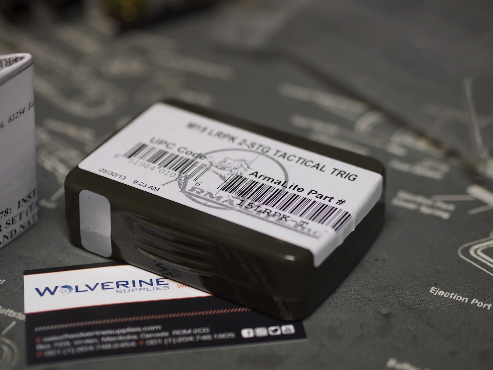

The Armalite trigger dropped right in, using AR15 size pins.  I have heard that lighter AR15 triggers might not have enough mass to move the firing pin on AR 308s, so we'll see if this one will work or not.

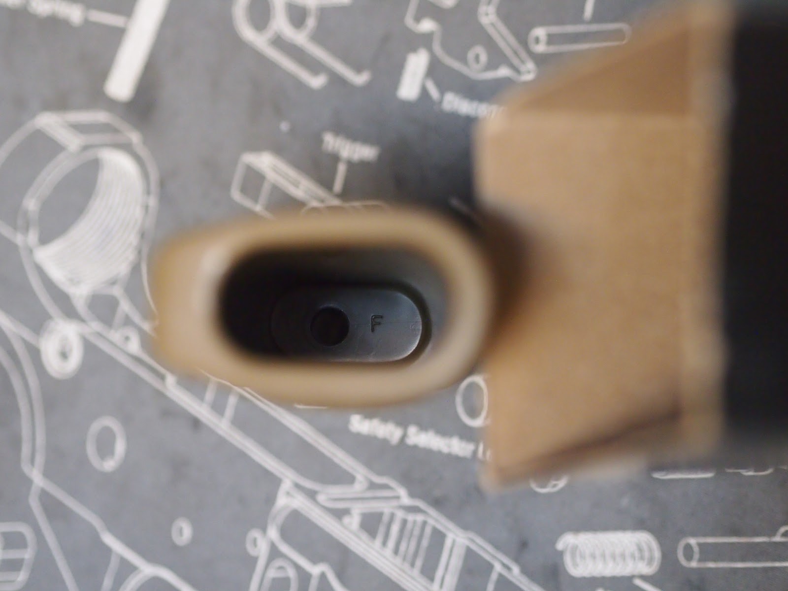

KAC M110 Taupe A2 grip.  It cost roughly 5 times as much as a regular A2 pistol grip up here, the only difference is it comes in a KAC box....and it's taupe.  Near as I can tell, it's basically identical to a regular A2 grip.
It has an F stamped in there, but I have no idea what that means.  I know my Diemaco ones have the Diemaco mark in them, and I also have a Colt A2 grip with a C in it, but I have no idea what the F stands for.
The KAC grip didn't color match the BCL receiver set, as expected.  And I doubt the spray paint I bought for some of the other furniture will match either, lol!

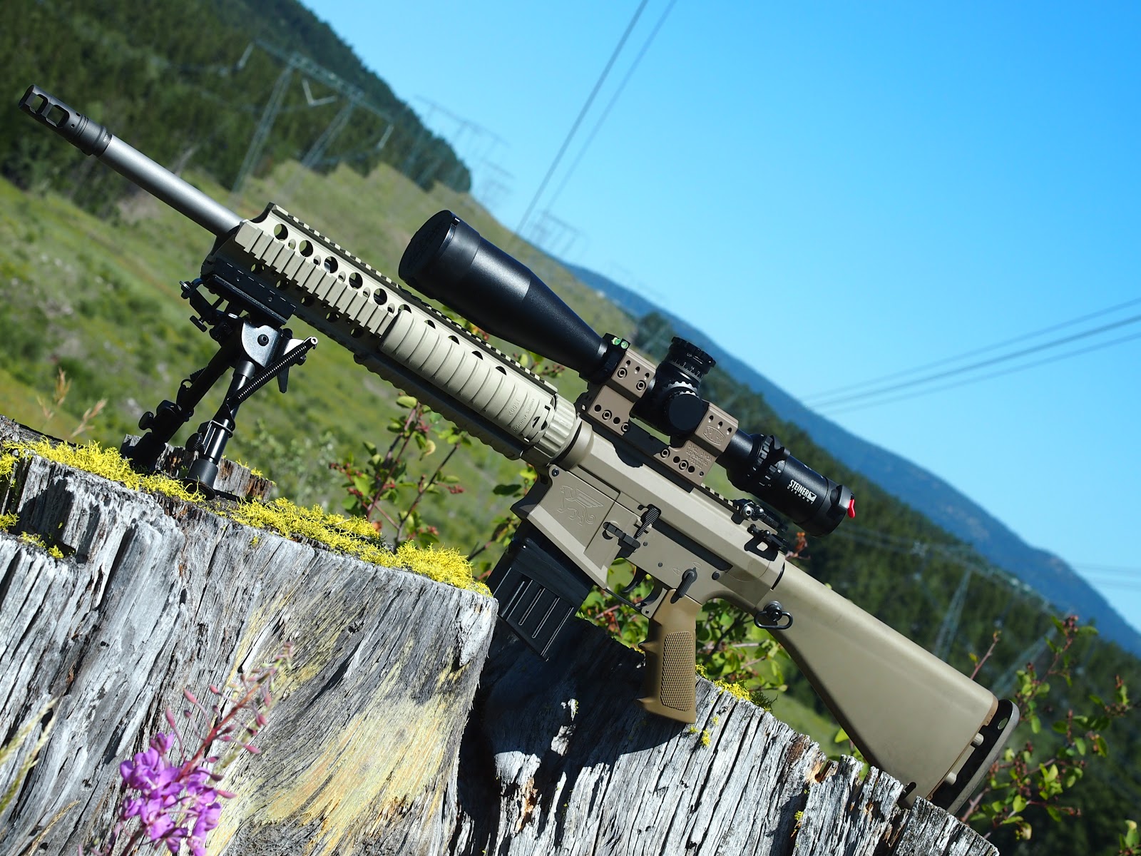

As suspected, none of the colors match, unlike the real M110, but at this point, I have accepted the fact that I not only do not have the funds to make it clone correct, some of the parts will probably be difficult to source in the US, let alone Canada.  Not to mention the fact that I still don't know if the KAC hand guard would work with the BCL receiver (barrel nut threads).
Anyway, it doesn't look too bad I don't think.  Actually, I also liked it with the black hand guard, grip and stock, but I was curious how this would turn out and to be honest, I'm fine either way...if only I could have two of these.

I let the OCD (and Secret Squirrel) get the best of me and I ended up sourcing a KAC M-110 SASS buttstock.  I certainly didn't pay full retail for this item as it's been previously enjoyed, however it was still not cheap.
http://www.operationparts.com/kac-knights-armament-m-110-sass-buttstock/
In fact, my example was pretty beat up, but it's all functional and nothing was seriously wrong with it apart from being very, very used.  So, what makes this thing so special?  I have no idea.  Can someone please tell me why one would pay $476.88 USD for one of these brand new when not on sale, lol!  Anyway, here are some of my observations, there is probably more, but maybe someone else with more experience can chime in.
From what I can see, it comes with QD mounts on both sides of the stock.
But the most noticeable thing would probably be this massive adjustment knob.  It seemed pretty straight forward, but in my sleep-fucked state, I could not figure out how to extend the buttstock for the life of me.  I couldn't even find a youtube video or a review on this stock, so I had some coffee and finally figured it out.
For those of you who are like me, and have a two week old baby at home who doesn't like to sleep at night, here's how to do it.  Turn the knob counter clockwise (there's an arrow and the word lock molded into the plastic of the knob), then depress the knob, then you will be able to adjust the length of pull on this thing.  Turn the knob clockwise to lock it up.  It's actually pretty straight forward, but sleep deprivation (or if you're the lowest common denominator like me) may cause difficulties in the operation of this buttstock.
I'm assuming this was rack #14 some unit.
There is no trap door for this stock as the empty space that would normally allow for the storage of a cleaning kit is used up by the mechanism that allows the buttstock to extend.
The standard sling loop has been replaced with a stud where I suppose you could add a sling loop.
I got the color on my A2 stock wrong, Rustoleum khaki came out a little on the light side.  That being said, the KAC M110 stock doesn't exactly match the KAC A2 grip either.  Doesn't bother me though, I'm used to things not color matching, just look at the Canadian Average Green on our C7s, lol!
So, this is something I'd never noticed.  The KAC M110 stock is actually shorter than a standard A2 stock.  It's overall length fully collapsed is probably about the same length as an A1 stock.  It slid right over the A2 rifle length receiver extension, however I had to take the spacer out....
I also had to use the shorter screw that came with my A1 stock.  Good thing I had one.
Anyway, one more step closer to the look I'm after, but it will never be spec-clone of the M110.
That's all for now, will have to figure out what else will fit.

The ejection port cover spring came undone and the ejection port cover just flops open rather than springs open.  The way the receiver is designed, the factory hand guard would capture the ejection port cover pin, however I am using an Armalite hand guard so the pin is not captured and can shift loose.  The end of the spring that rests against the receiver also was a bit on the short side.  I'm not sure if the location of the assembly was too far away from the receiver, or maybe the DPMS spring just had a really short leg.
Anyway, I think I've resolved this issue by straightening one coil from the spring and made it longer so there was more meat to grab onto the receiver, and I also dropped a dab of glue over the pin to capture it.  Let's see what happens.

The Midwayusa NiB BCG
There was no give whatsoever when pushing the area with my thumb.
There was a bit of give here when I pushed the area under my thumb.  I have no idea what other differences to look for.  Yes, I realize the rings are lined up here, but I always make sure they are not aligned like this before firing.

Hmmm, I bought the LPK from Wolverine Supplies up here in Canada.  It was brand new and sealed in package, so I hope it wasn't tampered with:
The thing with the BCL 102 is, it's a brand new platform, and the specs are a huge fucking mystery.  The manufacturer hasn't been forthcoming with what's compatible and what's not, so no one really knows what works.  What we were told was the thing takes a standard AR15 lower parts kit, and the only thing that's proprietary is the front pivot pin, and the ambi side of the bolt catch:
The other side of the bolt catch is supposed to be a standard AR-15 one.  I should check to see if an AR-10 bolt catch will fit into the slot, because I'm guessing they're made a bit beefier?

That bolt catch sheared because its an AR15 bolt catch. You got an M15 LPK, not an AR10 LPK.
AR15 catches will definitely shear. Armalite or not.
PM me, I might be able to help you out.
