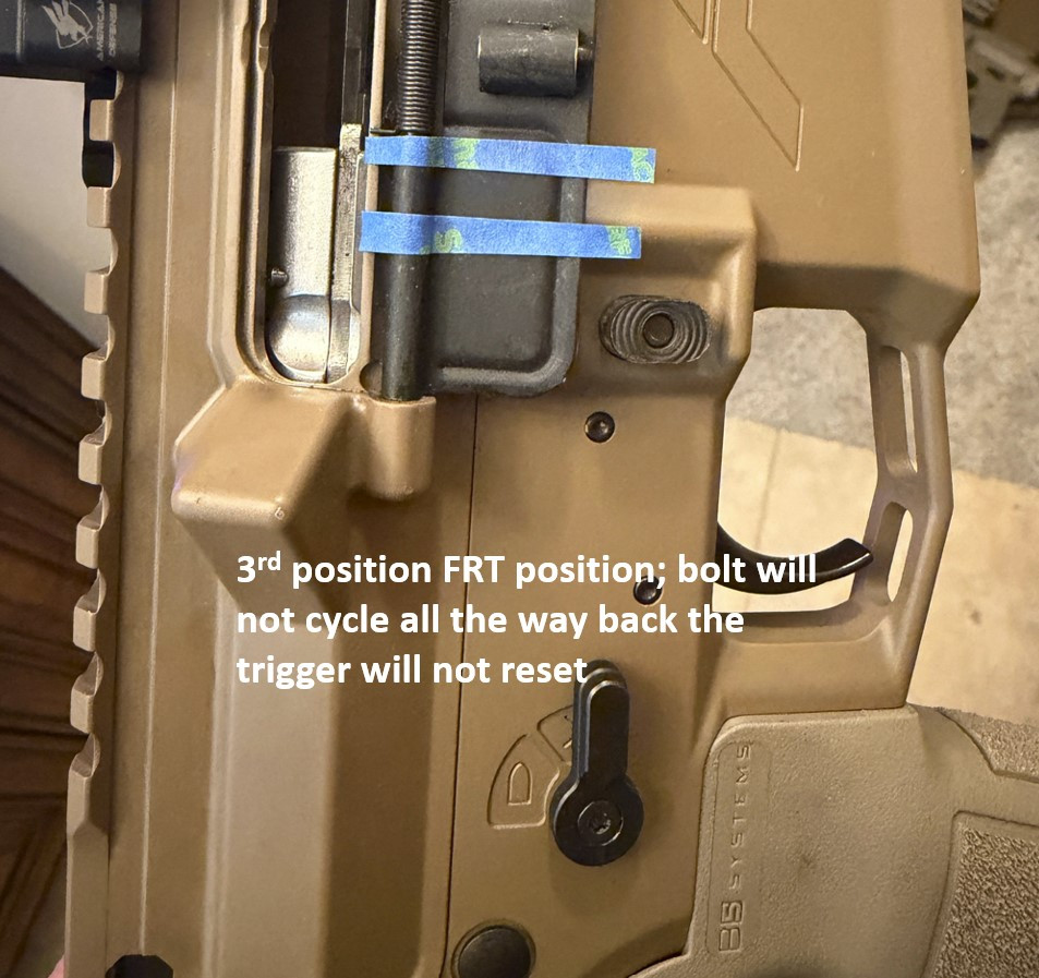

Recently picked up another Atrius Forced Reset Selector (I have 2 already that work great with no issues in regular 5.56 rifles) but this time I wanted throw one in my 22 built so I also grab one of the Bore Buddy Adjustable Super Safety & Selektor Trip Kit that supposedly works well with the Atrius safety. Threw it all in with the hopes I could have this up and running as a self Christmas present but I am having issues with the 3rd position "FRT" mode not working.
In regular fire/semi (safety vertically pointing up) position the gun cycles fine no issues. When I flip it the full 180 to the FRT mode it fires one shot then the bolt will not cycle far enough back to reset the trigger. When I pull back on the charging handle there is a very distinct hard stop that is short of where it normal stops in semi mode. Its like the lever is falling out of place and getting in the way of the bolt from fully cycling all the way back to reset the trigger.

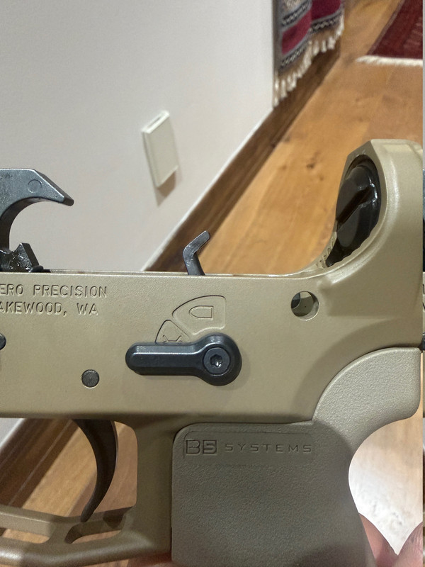

I hope this explanation kind of describes what is happening, also here are some phots. I put tape to mark how far back the bolt travels  in regular firs/semi position. And then another picture show how the bolt will not travel far enough back to re set the trigger in the 3rd FRT position.
Does any one have any suggestion for what is going on or how I can solve this issue. And yes when I am closing the upper and lower together I make sure the little safety hook/lever is going inside the Bore Buddy trip kit as shown on the Bore Buddy instruction. I have also tried probably a dozen slightly different adjustments of the set screw, even though I don't think this is the issue I still tried many settings.

That's typically a trigger side issue with the hammer binding on the reset lever.
You can duplicate it with the upper off by pushing back on the lever gently by hand with the hammer down, and then starting to cock the hammer.  You want the lever to begin to move freely before the hammer moves too far down.  If the lever unlocks very late (close to when the hammer catches the sear) you may run into an issue where the bolt begins to act on the lever prior to hammer clearance, which jams up the system.
22 bolts have a much shorter throw and more aggressive hammer reset surface, so they start to act on the lever via the trip a bit earlier than a centerfire BCG does.

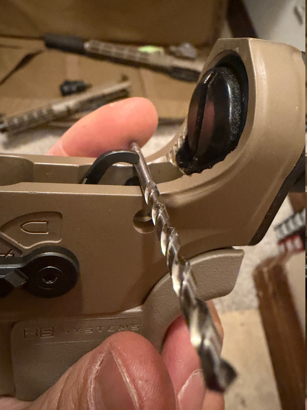

The lever could also be binding on the rear of the auto sear pocket on the upper. It's not uncommon for some uppers to need material removed to give the lever clearance.

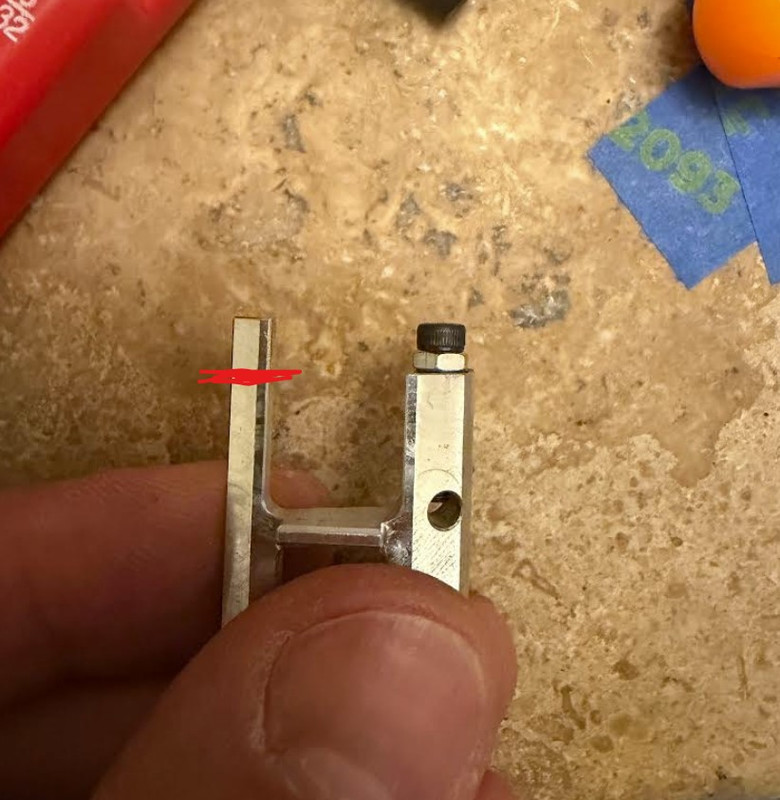

Well I tried backing it way way out like I had it almost 3/4" out (turns out that set screw is really long) but this actually made it worse the bolt was binding even sooner that where it was before. So I tried the reverse and actually removed the entire set screw to gain more clearance that way but no joy. Same thing its binding up still.
I am not 100% sure I fully grasp your drill bit trapping test but here goes my first attempt and that is a 1/8" drill bit:
12/24/2025 7:21:05 PM EDT
Close, the lever should be able to trap the drill bit under the curved portion. Re thinking this, it shouldn't be an issue when using the bore Buddy trip, the lever dosen't move as far as it would for say 5.56...

Ok, this was my experience when I switched from a SS. I had the screw pretty far out to get positive resets on the previous SS setup. When I switched to the MARC/Atrius style lever I had to run the screw all the way back in to eliminate bolt binding. But, like I said eariler, some have had to run that screw pretty far out when using the MARC/Atrius lever style FRT.
Ahh I gotchya, the lever should really be almost "laying" on top of the drill bit.

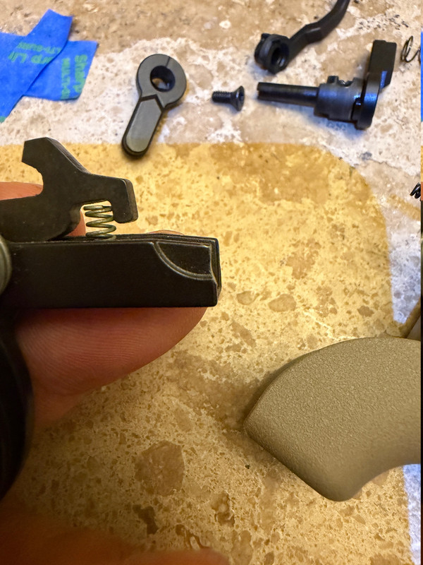

I've been playing with my setup trying to figure out where your issue may be. With the hammer not reset, if I position the lever where it would be in relation to the trip opening with the trip touching the rear of the bolt as it should be so I can close the upper still leaving a slight gap so I can see what's happening as I pull the CH back(shining a flashlight in the gap helps see things more clearly) as I watch the the mil spec hammer come back is gets really close to crashing into the lever before the trip moves it out of the way...
I'm wondering,is the SSA-E hammer is just enough taller than a mil-spec hammer that the very top is hitting the lever before the trip moves it? If I'm right, the very tip of the hammer is hitting the lever and with the lever held by the trip this would certainly bind up the works.

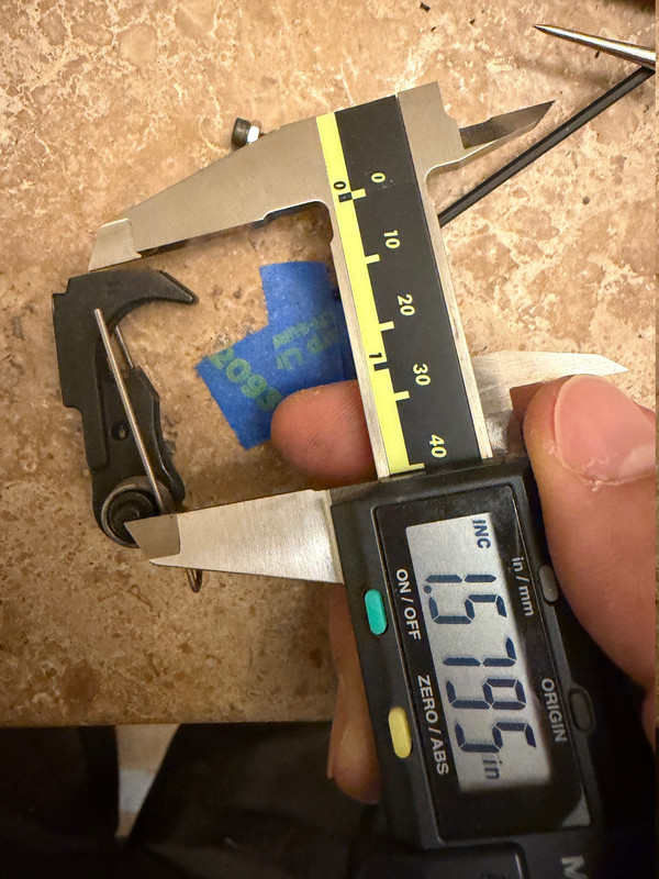

I have been trying to do the same thing, trying to shine a lite through the small crack to see what is going on and also looking at it with a regular 5.56 BCG to see when it engages. From what I can see while trying to cycle the gun with the rear take down pin out and just a mico gap so I can see a little bit it seems like the BB trip kit is trying to activate the FRT hook too soon as the hammer as not been fully "clicked" into the sear so now its binding up on the FRT hook that is standing strait up. From my very limited experience with FRT setups to me it seems like I need to some how adjust the timing of the trip kit so it engages the hook a little bit later once the bolt has actually fully reset the hammer. But this would mean I need to shorted the aluminum block on the trip kit. I dont know if i really want to already start hacking a slashing a brand new expensive trip kit I have only played around with for a couple hours.
But right now looking at the trip kit my thought is to remove the set screw and cut off a little from the other side so it actually engages a little later letting it move that much more with the hopes that this would allow the hammer to be reset and the trip kit to then grab the "loop'" force a reset.
Think of trimming this and remove the set screw to gain a little more time on the trip kit. Am I dumb????

I went garage digging and all I could find was a super old school colt hammer (one of the large pin ones) so I can't really try it I think I will have to go check my storage unit for stock triggers I have more boxes of junk parts there. But just for fun I kind of half a$$ measured the height of the mil spec colt hammer from center of pin to top and it was actually larger than the SSA-E one. So I dont know if the hammer is really the issue either. I'm still thinking its the trip kit timing.
https://i.postimg.cc/6pZsgJxj/Screenshot-2025-12-24-211519.jpg
Damn, I thought the hammer being to tall would be the issue.
No,  you're not dumb. As is, removing the screw then shaving the nub would be the only option to keep the trip from hitting the lever to soon. I wouldn't flush the nub without atleast trying to tune first. I'd remove the screw and file a little off the nub then test, repeat until you hopefully get function. If, you end up not needing to flush the nub you could maybe put screw back in sans nut and keep the trip surface true to the bolt.

Is the hammer blocker possibly interfering with the lever and not allowing it to move a touch more forward towards the hammer?
Yes no clearance issue here. Plus I think if this was the issue it would not work in regular semi mode.

Yes the more and more I tinker with it the more I am thinking it is a 22 trip sled issue. I just don't think the timing of it is correct and the adjust that the BB trip kit give you only goes the wrong way.
I just can not figure this timing thing out. I now tired removing the extra part on the sled and removing the set screw but now that is to far the wrong way to the point where it does force your finger to rest. It does not bind any more but it does not force your finger to rest. I just works like a regular "semi" you have to lift your finger you can hear is rest then pull, bag.
I threw the set screw back in with out the nut so that there was a little extra and the playing around with different micro adjustments of the set screw. I can get it to where I pull the trigger it drops the hammer and I hold the trigger pinned back as pull the charging handle to cycle the bolt I can feel it lifting my finger almost to rest but then I am out of stroke on the bolt/its maxed out. So it never actually fully resets the trigger but its almost there, all I have to do is lift my finger ever so slightly and then it resets. But then if I give the set screw just a hair more then I am back to the same issue where it is binding up. I just can not find that fine line it is either does not force reset or is binding.
Next I am thinking of maybe removing some material from the trigger where it engages the Atrius "lever" so that it is engaged later giving the hammer more time to reset and the lever has more play to be out of the was of the trip sled to no bind on.
