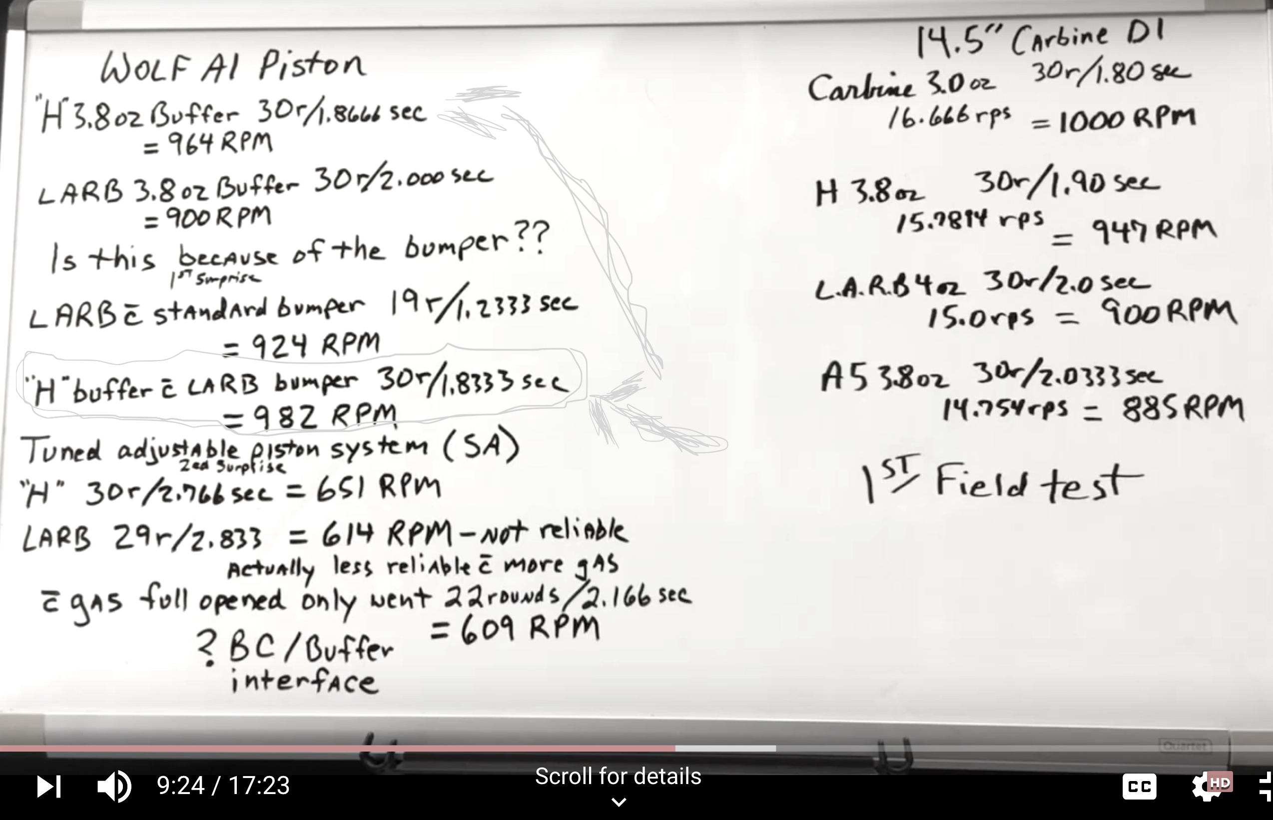

20% reduction is quite different in terms of ROF reduction then what the regular LARB tip + H buffer did in Mbell's testing:
https://www.youtube.com/watch?v=zOmpH-UcZlQ
The LARB bumper seems to have increased ROF by 20rpm, I assume due to 'bouncing' back with more force then a standard bumper due to the increased compression vs the regular, less compressible bumper.

Yep. Hence the firmer durometer we started using. But the thing is, when the cap is used on the LARB buffer as a system, that is eliminated. As it was designed to do. And again, not every component in the recoil system will “help”. “Joe May put a LARB cap in his Bushmaster 16” carbine and see great results. Then “Bob” put the same cap in his Colt 16” carbine and get totally different results. We typically see good, seared results, but that not 100% the case. That’s no ones fault, that’s just machines. There’s never a replacement for physically trying the components oneself. No matter the brand or part. Try it. That what we all do, see how it feels and don’t worry too much about the “details”, engineering, design, marketing, hype or fancy graphs. There’s a absolutely no substitute for seat of the pants testing.

We've seen up to a 20% reduction in ROF/bolt velocities with this cap alone. Up to 30% when used with our LARB buffer. It’s a very simple design modification to the LAB tail cap. Most designs that work well, are simple. Don’t over complicate or over engineer something just for the hell of it. This is a simple design, yet is is engineered, tested and evaluated. It works well, mbell has one of these as well...
https://i.ibb.co/Lk9MDJz/633029-C1-032-F-4290-9-E13-8-B69983-E8232.jpg https://i.ibb.co/QpnjNCk/4-BC2414-B-21-D8-4-E33-91-FC-3-F8-DFE7-F4228.jpg photo album upload" target="_blank">https://i.ibb.co/Lk9MDJz/633029-C1-032-F-4290-9-E13-8-B69983-E8232.jpg https://i.ibb.co/QpnjNCk/4-BC2414-B-21-D8-4-E33-91-FC-3-F8-DFE7-F4228.jpg photo album upload
I didn't notice the double taper the first time I read the above post.  The point on both ends obviously adds more gradual decel to the weights in the buffer and to the buffer itself, sort of a mini effect of what happens in the DPM rate reducing setups with 2 springs.  Makes sense it would work.  Simple.  I'm itching to try it.

interesting #'s. I just checked the TDP and for the buffer bumper OD it calls for 0.574"-0.578" dia; buffer ID 0.564"-0.568" and for the hole for the pin to be 0.240" from the end of the buffer tube. the hole through the buffer body should be 0.126" + 0.004 dia and the hole in the bumper 0.120" + 0.004 dia

Just got back from the range. Test gun was a M&P 15X upper from early 2000s with 1:9 chrome lined m-4 cut barrel, A2 flash hider, and carbine gas system with 2 MOA Sig Romeo 7 put on an Aero/M&P lower (original lower was SBR'd for my work gun). As expected the carbine buffer with no changes to it had the most dot movement and perceived recoil both from bench resting on mag and standing. All three buffers performed about the exact same from the mag rest on a bench so much so I could tell no difference. I'm a LEO so mag rest shooting and standing are the most likely positions I'll shoot from in my city anyway. The LARB equipped buffer when standing felt to be a sharper straight push back into my body but dot movement was maybe by eye 25% less roughly (wild guess) in all than standard carbine. The EAB was the same on dot movement reduction of by eye 25% but the push while also more straight back like the LARB it felt softer but not drastically so, just enough I could tell. Between the LARB and EAB I would have to go EAB for the softer feel and easier install considering the issue I had with my LARB but YMMV. I'll have to try both on my A5 buffer guns I use for duty but not till I can fix the LARB's roll pin hole. For me in my job that lesser dot movement is worth it. Of Note I shot much better groupings with the LARB and EAB when keeping up the same rate of fire so it seems they made it easier for me to properly line up my shots in an event where I have to fire faster than a static range.
EDIT: I was able to fix the damage carbine buffer, though the hole is oblong now on one side to fit the LARB a larger pin worked to put the old bumper back on. Still working on making a fixture out of wood to fix the LARB hole alignment. That will have to wait as my lunch break is ending and my partner is covering for me.
