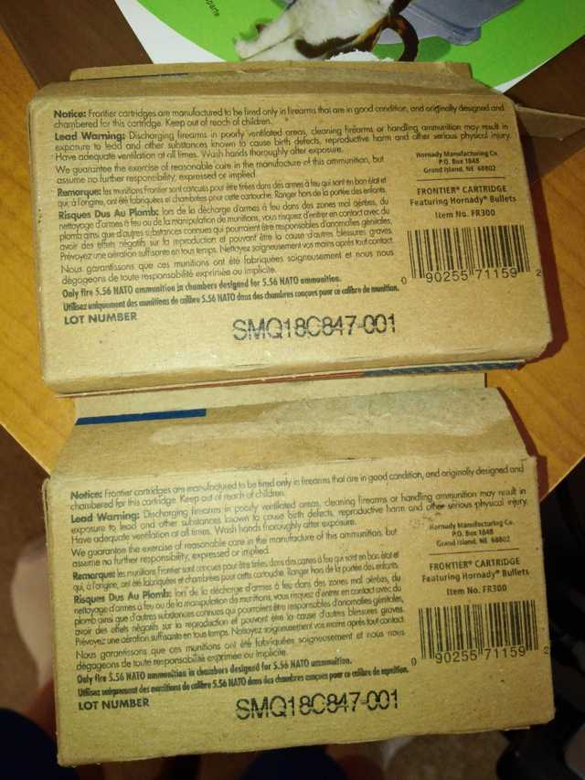

I found another lot number to add to the list.
https://www.ar15.com/forums/AR-15/My-AR-exploded-in-my-face-today--Can-anyone-tell-me-why-/66-731445/
SMQ18C847-001

Thank you for posting the lot numbers.
Now post the results of whatever test you are going to do...………….

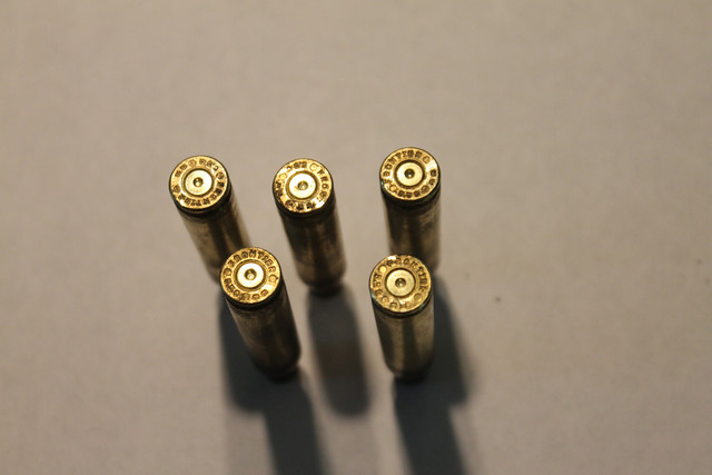

I'd like to add something technical to this thread.
I carefully read the thread where the guy disassembled and weighed his Frontier Ammunition.
https://www.ar15.com/forums/topic.html?b=1&f=5&t=2235264
He loaded 5 rounds with 27.8 grains of powder. I''m assuming this is the typical charge he found when he weighed the rounds he disassembled.
Quote from his thread.
"So here's what I did:
Weighed every powder charge in every case. Low was 27.4 grains, High was 28.1 grains"
Anyway, when he posted a pic of the rounds, there were ejector marks and flattened primers.
Both are pressure signs.
As I suspected, this ammo is loaded hot.
https://i.ibb.co/NZS0CTY/I6Licnl.jpg
When I shoot mine, I'll post pics of the brass as well but I'm fairly certain that I'll have the flattened primers as well.
I'll be surprised if I don't.

Sir:
I stopped looking after finding 5 published-in-manuals- open to the public- loads which meet or exceed 27.8 grains of powder for a 55gr FMJ bullet.
Two of which max out at 28.5 and 28.6 grains respectively...……...
You cannot determine if a load is too hot by:  shaking it, stirring it, looking at it, talking to it or weighing it.
There are 2 ways of doing so and they are far beyond your capabilities...……….
BTW..... those cases look fine to me.  The edges of the primers are rounded, there is no firing pin hole flow and those are not ejector swipes. (except, maybe, just maybe one).
Those cases are fine.

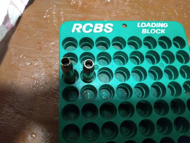

I pulled two bullets from two random cartridges in the box.
They were easy to pull. There appears to be little to no crimp.
The bullets weigh exactly 55 grains on the nose. The diameter is perfect.
Both cartridges contained 27.4 grains of powder.
They were originally both seated to 2.200. When I reseated them, I did to 2.240. ( where my die is set)
I didn't crimp.
I have those cartridges, along with 18 more loaded in a 20 round mag;for the next range trip.

Sir, I respectfully disagree with your statement; as far as weighing the power goes.
Once you have the weight, then all you need to know is the type of powder to make a determination.(or at least an educated guess)
As far as shaking goes, it was a preliminary test to see if the case was full and or compressed.
It was not full and or compressed; so the shake test has some limited and legitimate uses.
According to the OP, he had ejector marks on all of the cases . Perhaps they aren't clearly visible in the photograph.
The primers look a little flattened to me.
