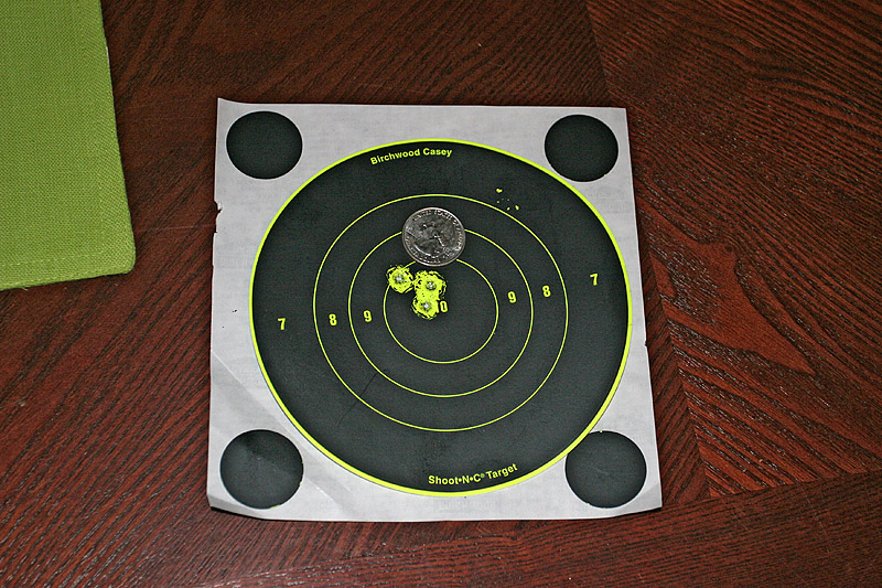

I built this one a few months back. Its all new parts ordered online and normal pricing and I'm a bit under $1100 including optics and everything seen, right down to the 20rd mag.
If you're interested in the specs and where it all came from I am more than willing to share. I've also looked at the RRA Varminter and when Keith's runs his little sale on them they aren't much more money for similar rifle if you don't want to build.
Shots 7, 8, and 9 out of the rifle at 100 yards.

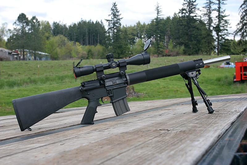

The few 24" I've held are very heavy.  My 20" is much more managable IMHO.
20" bull barrel - Gackman insists I need to free float it -but it shoots great with Varmint ammo.
(Old picture, now lives on a RRA NM Lower/A2 stock.)
