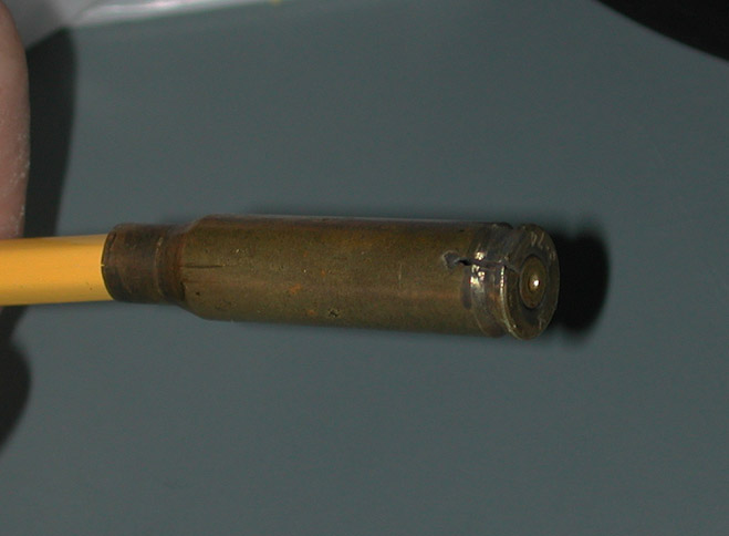

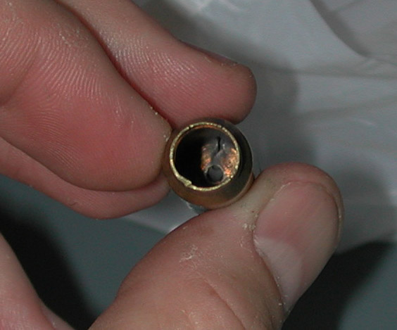

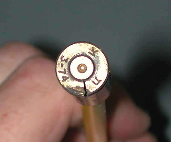

Gah, ditch the izzy surplus! A bunch of that stuff came in that had problems. I had a round kaboom on me in my L1A1 several years ago; thank God it held together. Because of that, I never go to the range without eye protection anymore. It cured me of that oversight.
It might work for you, or it might just kaboom on you. If you have to shoot it through something, pick up a beater boltgun with a strong action. I wouldn't shoot it through a semi-automatic rifle of any kind, though.
