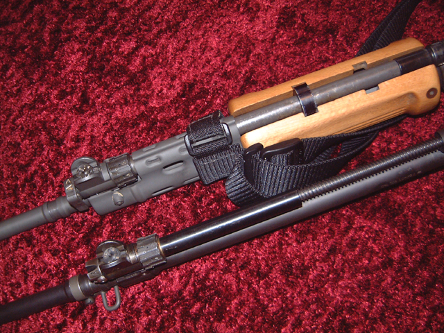

have to agree w/ Critter on the barrel thing.....i'd mothball the minty, matching STG barrel and find another for your carbine length, especially considering the fact that if your STG barrel has a short fixed gas tube as most do it will be incompatible w/ your izzy HGs....
often you can find a good deal on barrels with minor pitting or wear near the muzzle end which are perfect for such things. $30+/- for the thread work.
i built a 16.5" that ran fine w/ gas port at .109" (if you drill out the port be sure to protect the bore w/ a cleaning rod or dowel) but this was during the ban so no threads. 16.5 is pretty dang short tho so i put a chopped / threaded 18" barrel on it. it's my favorite.
not really a  an izzy clone, just furniture, mag release & rear sight but here's a general idea what you'll look like
16.5
18" w/ shorty stoll

FALna45, that's a killer looking 18" with the shorty stoll. SweeeT!
Lee

+1  Very nice.

thanks fellas! that's my first build and i'm pretty fond of it.
coonan T1, DSA HTS & piston, alloy lower (+dustcover, triggerguard) WBBob PG.
just a few more tweaks now...i'd eventually like to swap out the FH for a MrBonecrusher type, need to dial it in with & evaluate the KNS front sight i just got for it and then i just need to get off my a$$ & get set up for phospating.
