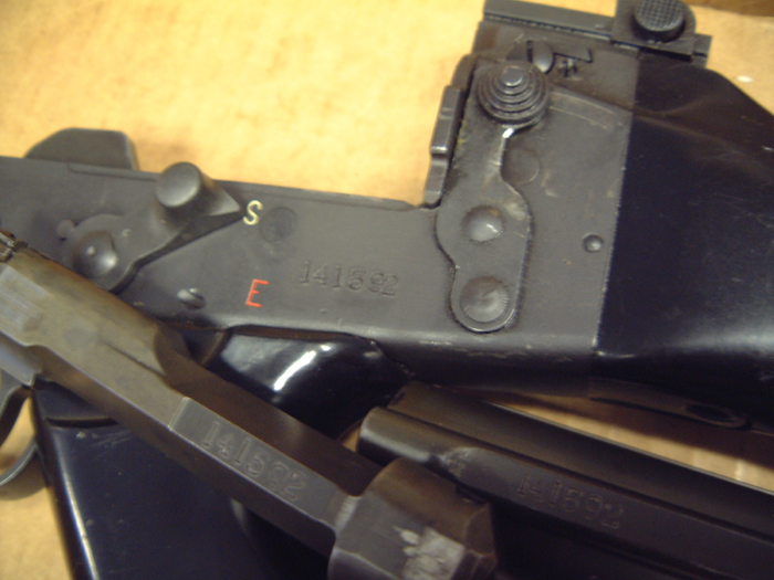

It was obviously a new rifle before they took the bandsaw to it (I cry just thinking about them cutting up all those beautiful rifles).
The kit is beautiful, and will build up into a new condition rifle.

I got my kit from the man in brown today.  Looks brand new, with the exception of a few spots of finish wear.  If anyone is looking for an FAL kit, these are the way to go.

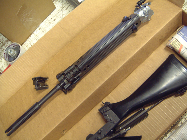

Ok, I am new to FAL type rifles.  If I buy the kit, what do I need after that to build the complete rifle?  Just the reciever?  And what is the cost of the reciever?
Thanks.  I am very interested in getting one, but I am clueless to how this works.  I shot a friends FAL once, and I was in love from the first squeeze of the trigger.
Thanks.
1/30/2005 9:49:40 PM EDT
You'll need a receiver and enough parts to be 922r compliant.  Typically this is the receiver, hammer, trigger, sear, gas piston, and muzzle device.  You could also change out the furniture, the magazine floorplates and the pistol grip (I think).
Receivers run anywhere from $100 to $200 at FAC.  I've read that the lower cost receivers will require some modifications to make them useable.  DSA also sells receivers, but their website doesn't list prices.
There are some special tools needed to put these together.  I barrel wrench, gauge pins, go & no-go gauges and some calipers are probably the minimum.
I haven't tried the build yet, so I don't know for sure how difficult it actually will be.

Since you have your kit, grab a rec.  I went with an Imbel from TDW (179 + 8 s/h)  since my bro's work schedule won't allow him to get to FAC (175 + 9.50 s/h).
2/1/2005 11:09:24 AM EDT
I'm in the process of tooling up and getting my US parts.  Then I hope it's just a Saturday project to assemble, assuming I can use the same locking shoulder.  Now I just need to lineup someone to urban camo it for me.
2/1/2005 11:57:23 AM EDT
Urban camo-  Mister right hand with help from mister home depot can do that for ya
Don't forget pin gauges ( for locking shoulder)  if your headspacing yourself.
